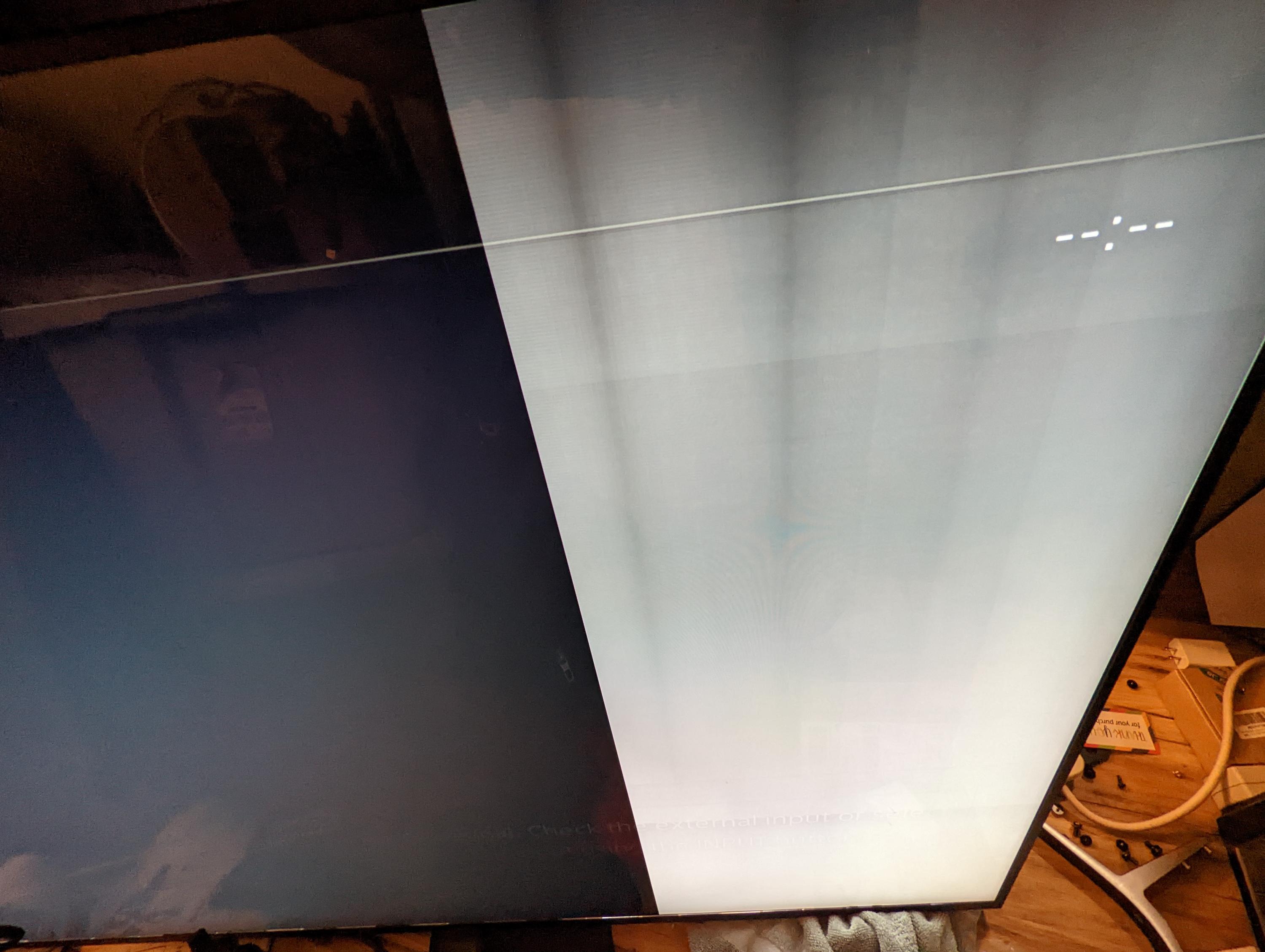

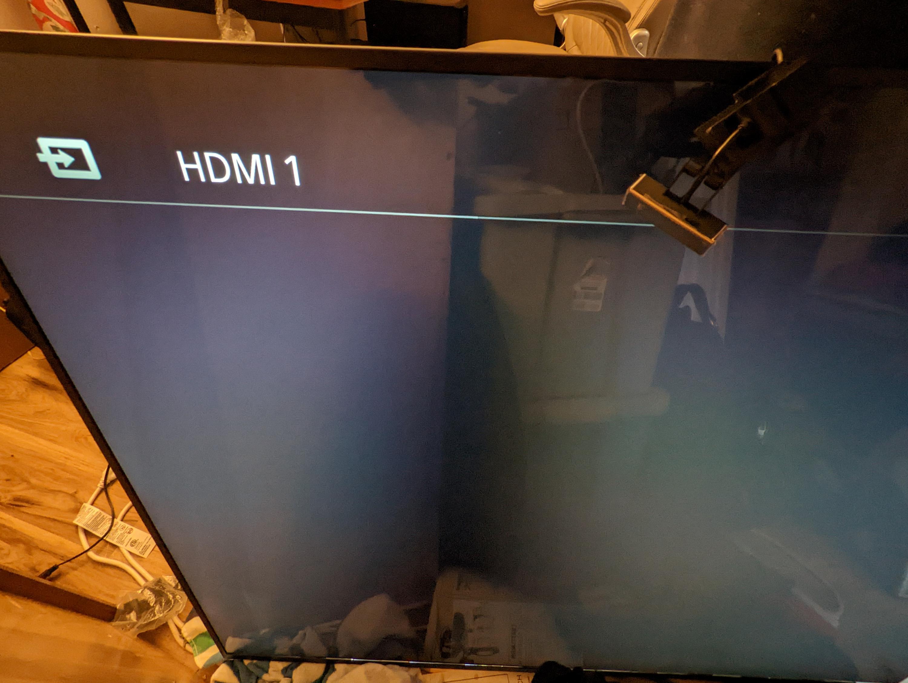

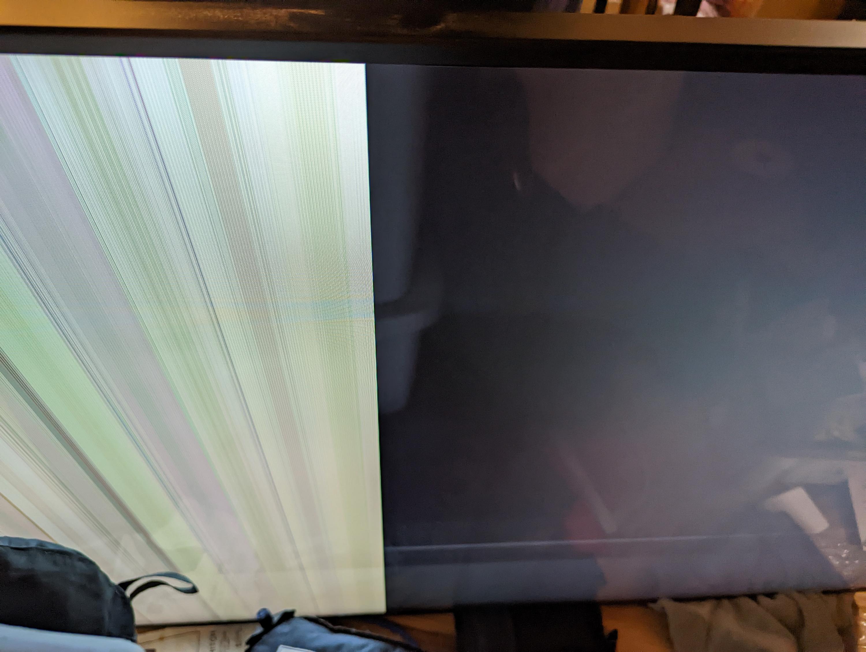

      The TCON board has 4 ribbon cables that go to the panel, 2 up and 2 down.
      When I only plug one ribbon in with everything else stock the TV comes on and the back light comes on. Here it what it looks like with only the top left ribbon connected.
      I started adding in more ribbons one at a time, after I get to 3 ribbons connected it starts restarting and clicking like originally.

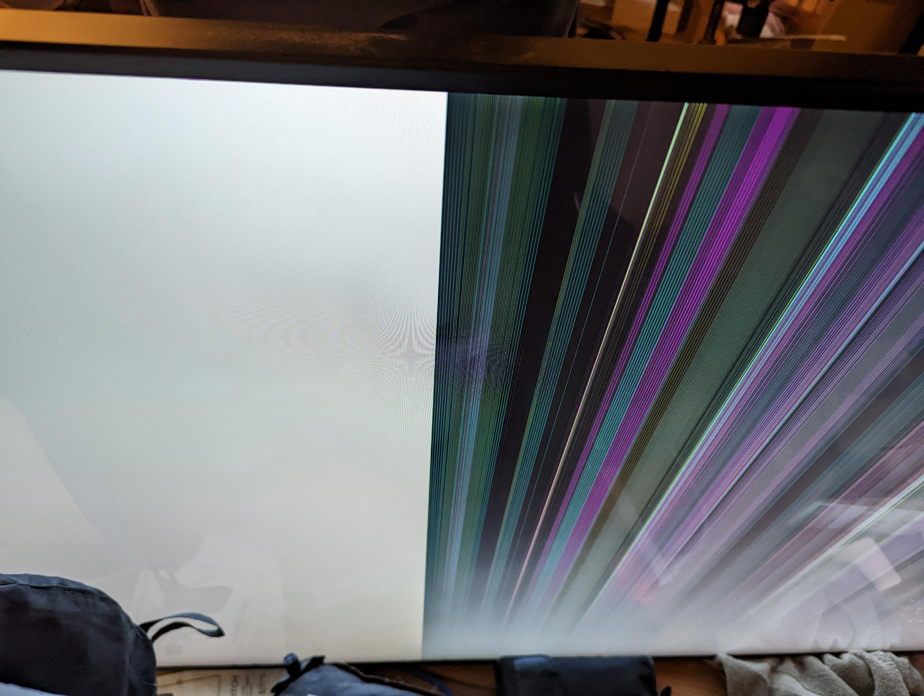

        Re: Sony Bravia XBR-65X850B Clicking On and Off
        Here is the top right and bottom left connected. I can hear a rapid clicking sound coming from the TCON board, possibly from one of the ICs.

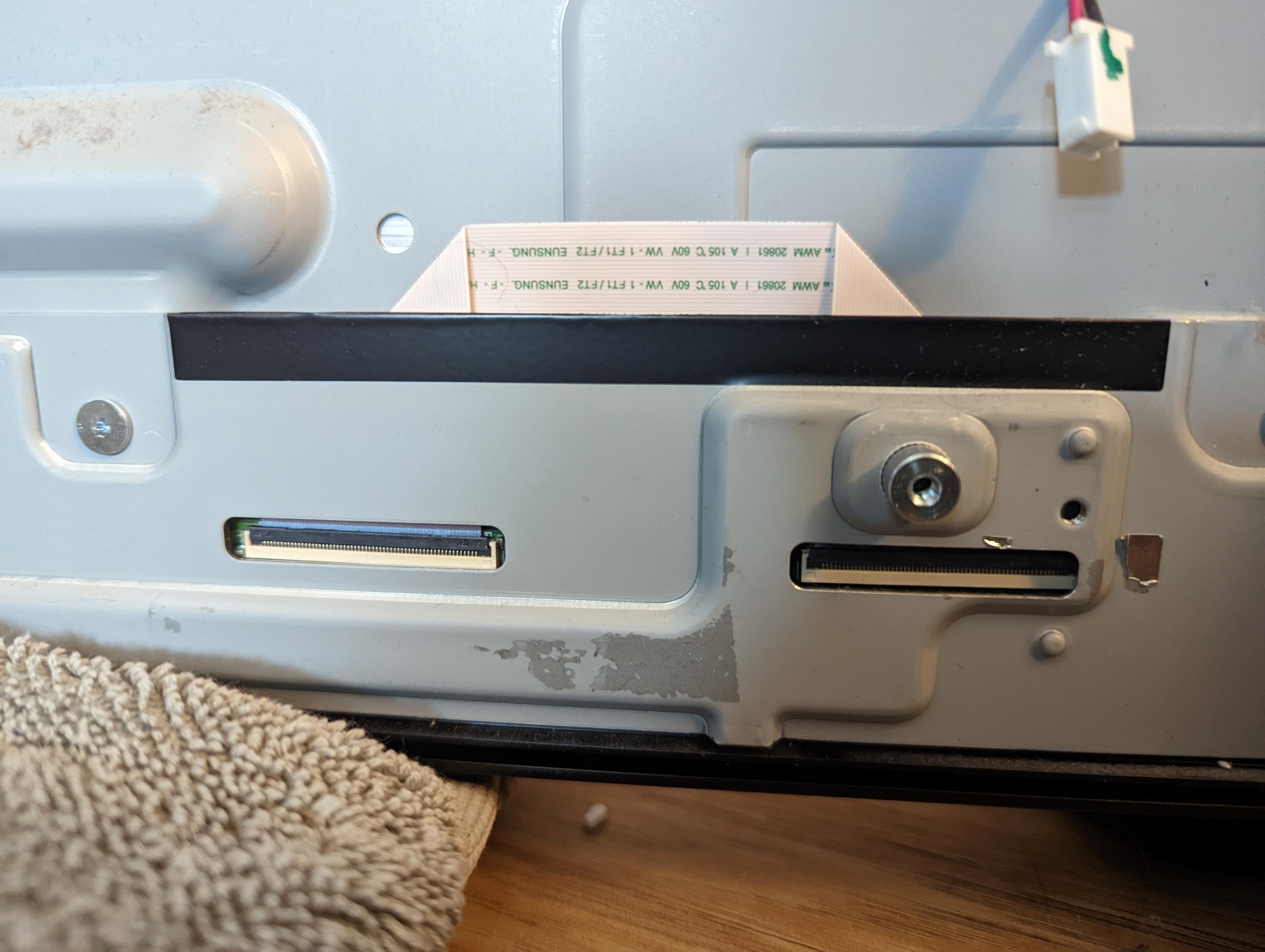

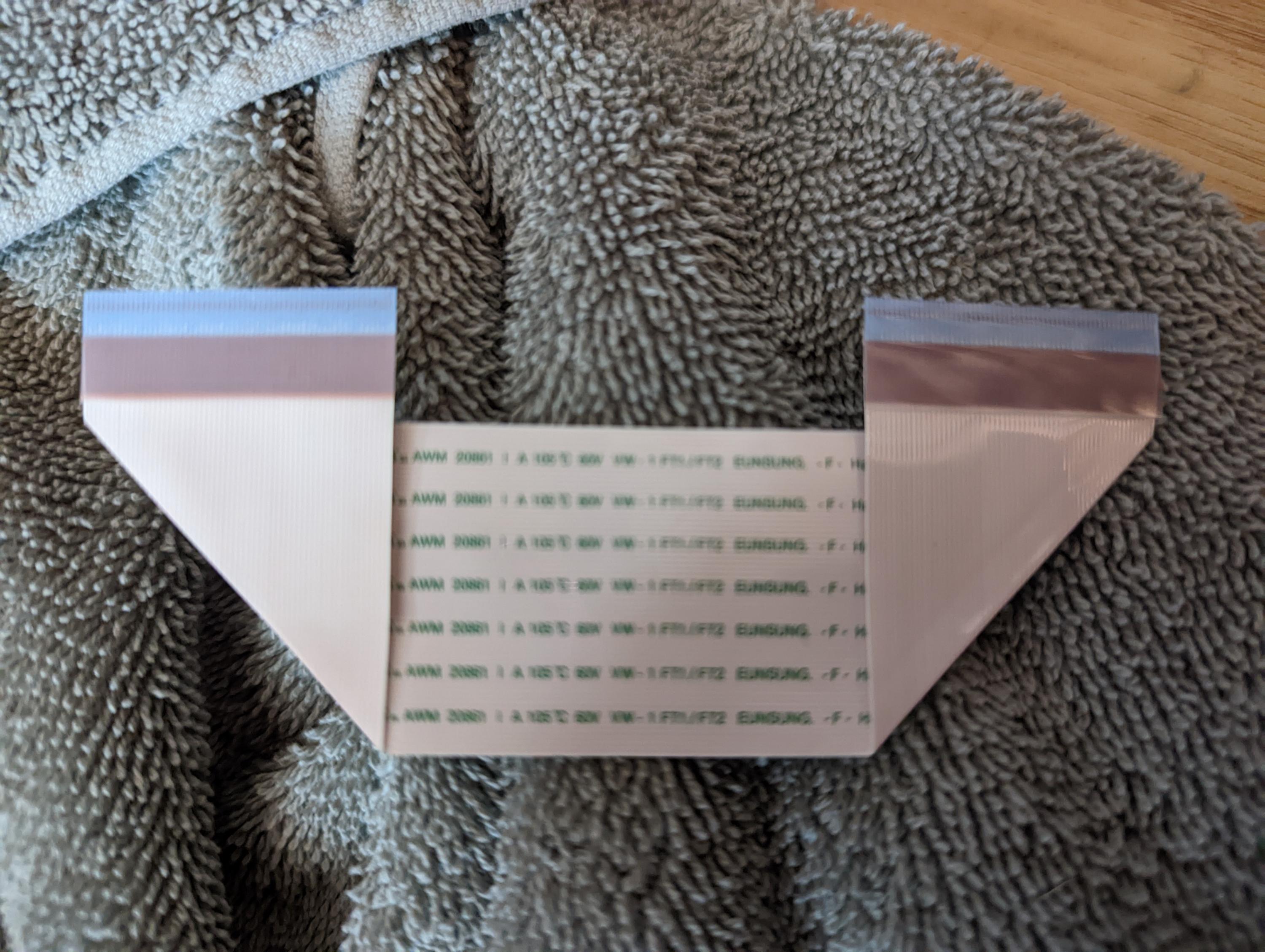

              Along the bottom and the top of the panel are little tcon ribbon "jumpers". I removed the bottom left one and the TV started turning on with an actual image. Does this look like something that can be repaired?
                It sounds like you've ripped of one of the flex cables. A photo will confyorm this.
                  can we see a picture of the "tcon ribbon "jumpers"?

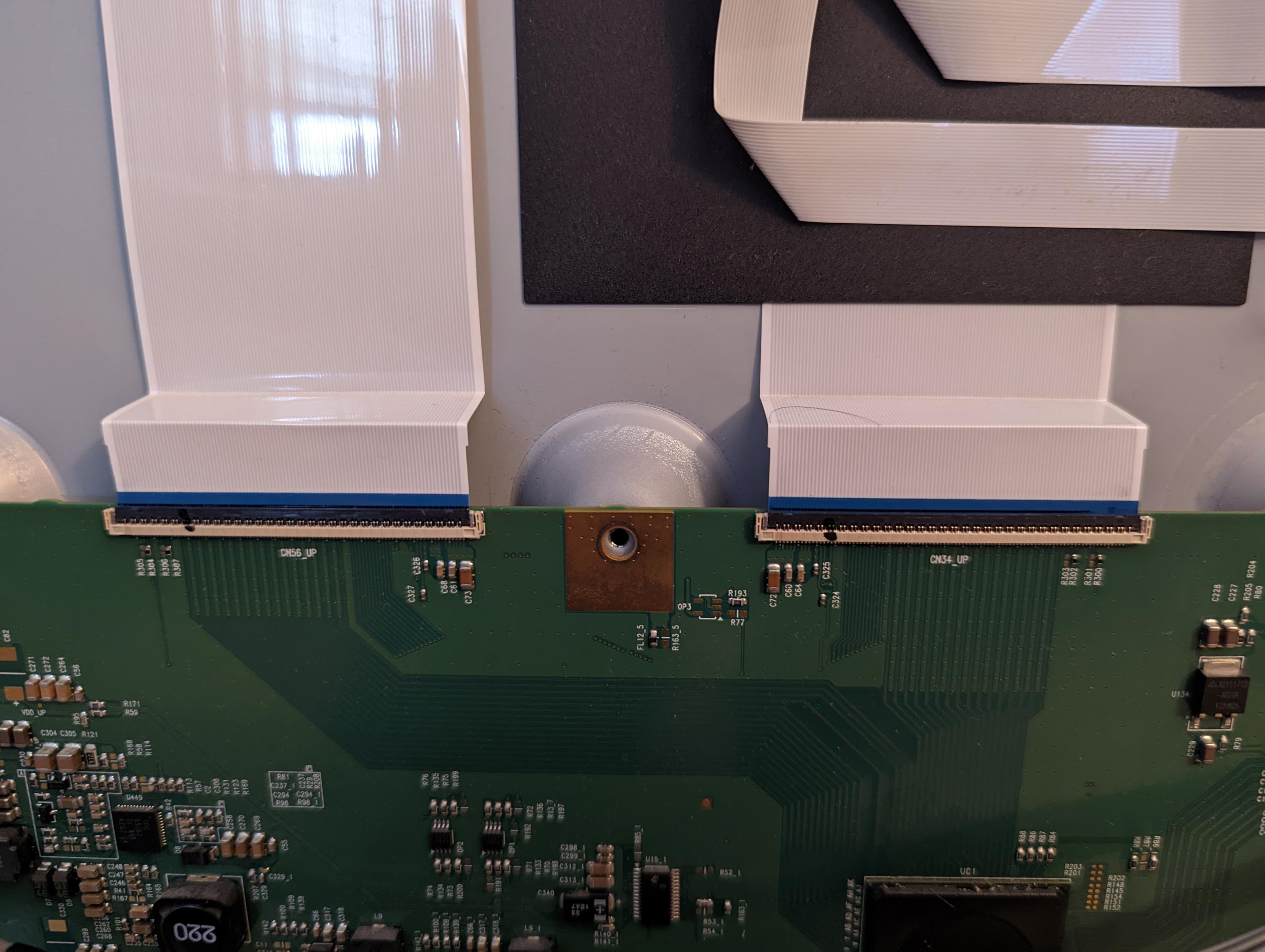

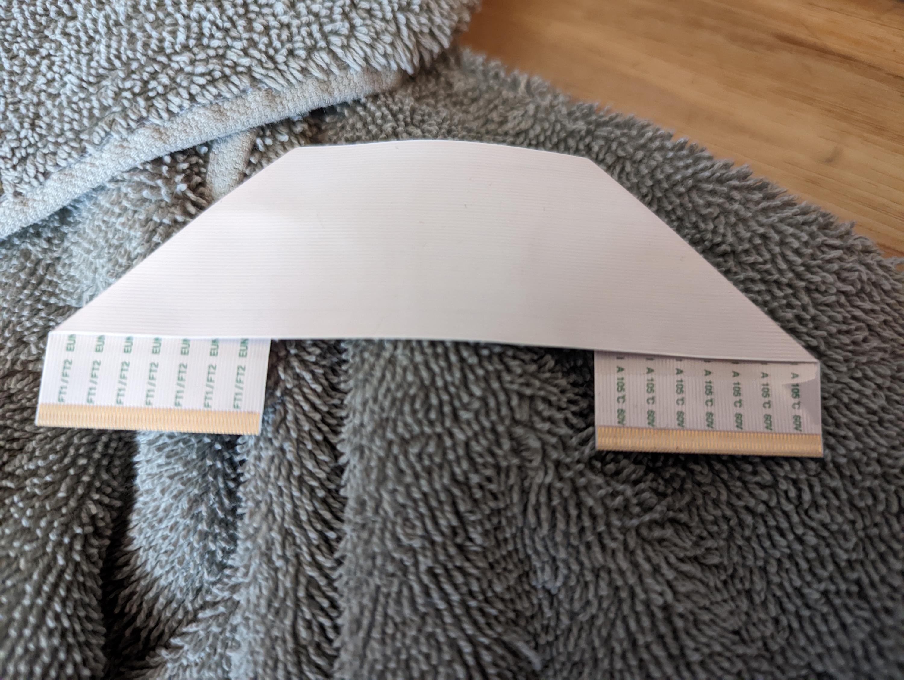

                  • powerblackout
                    • Feb 2018
                    • 109

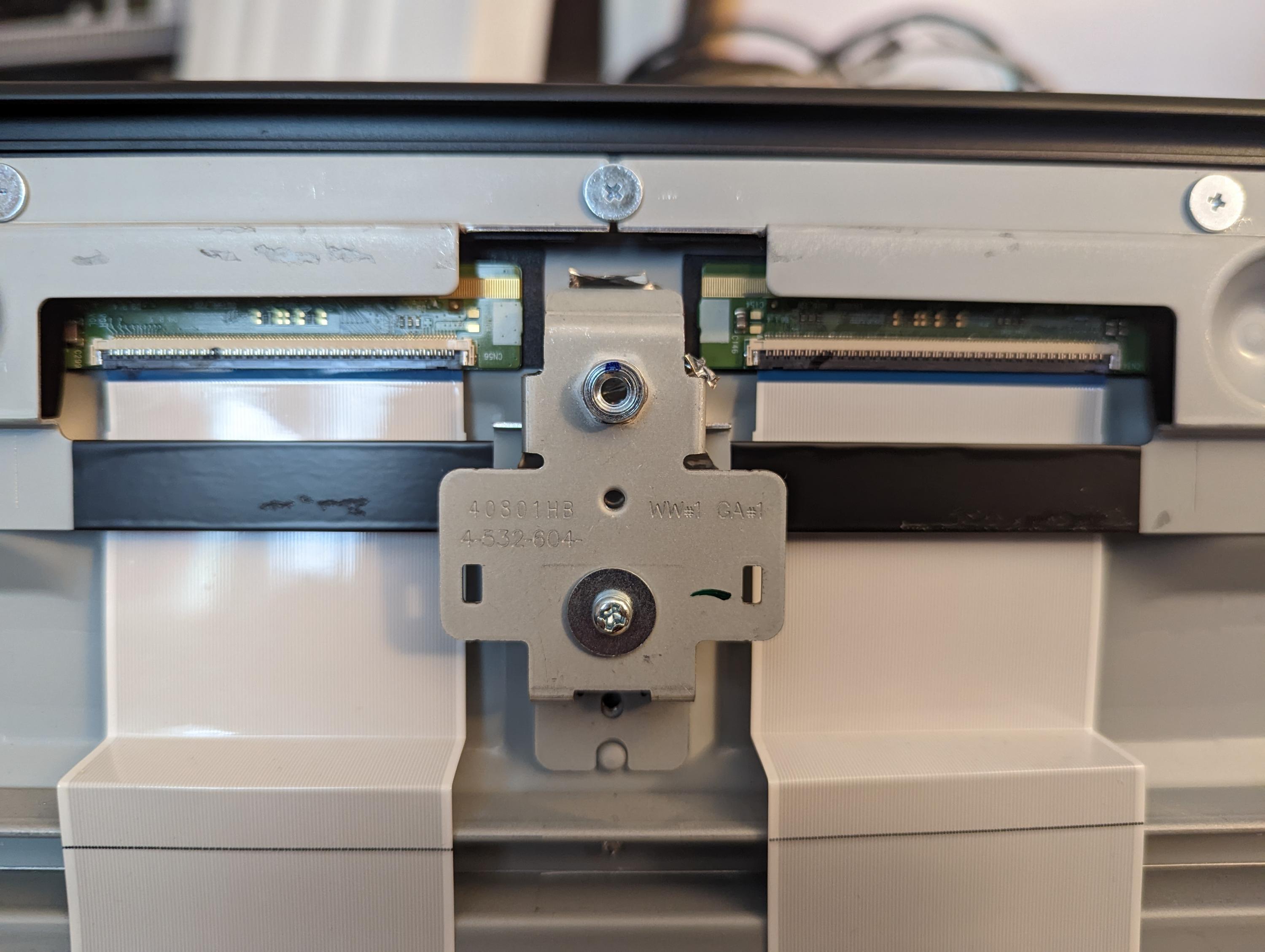

                    I have been very careful with all of the TCON ribbons, here are some pictures.
                    When the bottom left jumper is connected the board has the original symptoms. this was happening before i even opened the tv.
                    I pulled all of the ribbons out and wiped them down with IPA and a q tip incase there was any dirt on them.
                      The cable connects to a PCB, remove the metal shield that's covering it. There are components on the PCB, with luck you will find one shorted.
