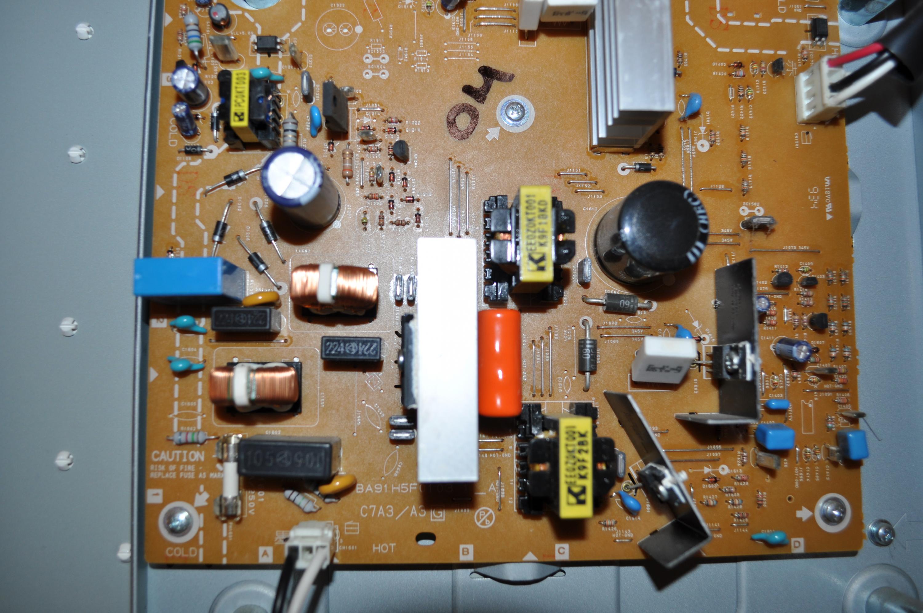

    Phillips 42PFL3704D/F7 Totally dead. Check main fuse its good. I have 90vac at the fuse. No DC voltage present. With set on there is 30vac at all 4 pins of the bridge rectifier. It seems everything I test on the hot side has 30vac. Not sure where to start on this one.

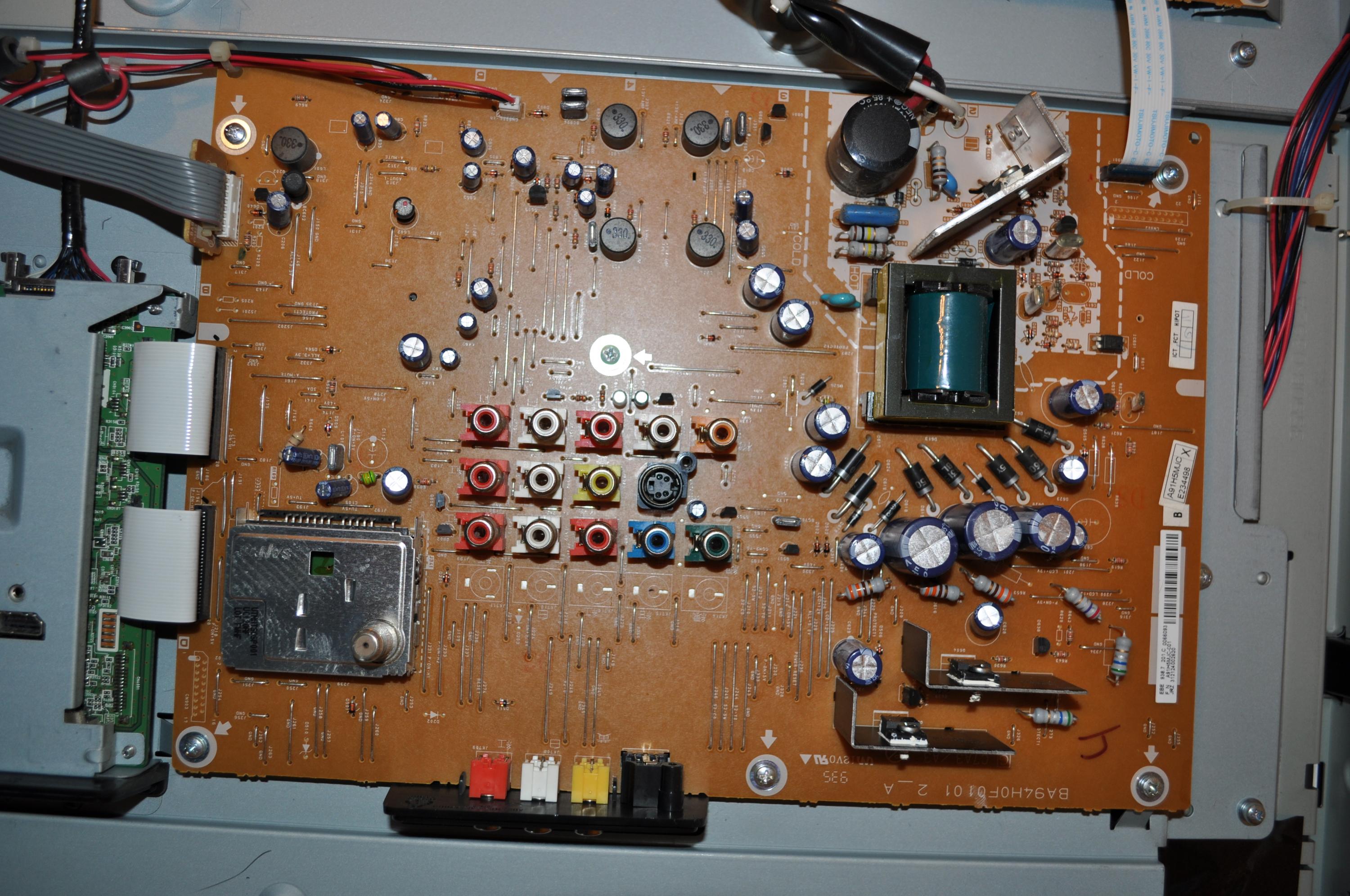

    2nd pic
    https://www.badcaps.net/forum/attach...4&d=1376511088
    Big orange cap near bridge rectifer, on volt DC range, what do you see?
      Re: Phillips 42PFL3704D/F7 Dead
      Make sure to use the negative leg of that large black filter cap as the Ground ref for the voltage measurement in the primary section, not the chassis. To measure the incoming AC you will use AC meter on the White Neutral wire where the AC power cord is and the Main AC fuse. You are reading 90VAC because you are using the chassis as the ref point.
        2.7VDC across large orange Cap

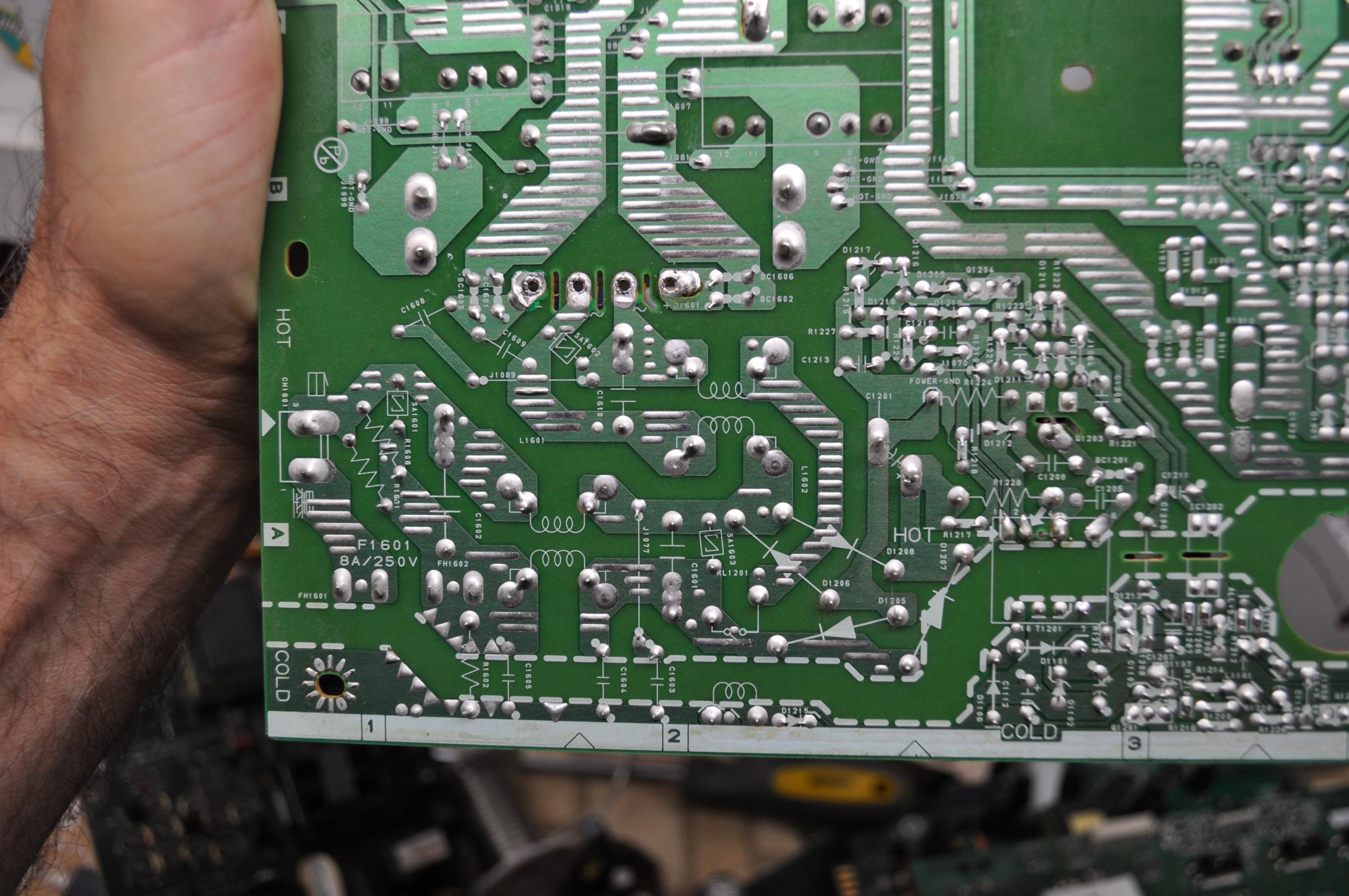

                            Underside Pic
                              OK, in the holes of where the bridge rectifier was test voltage between the two middle pins, volts AC.

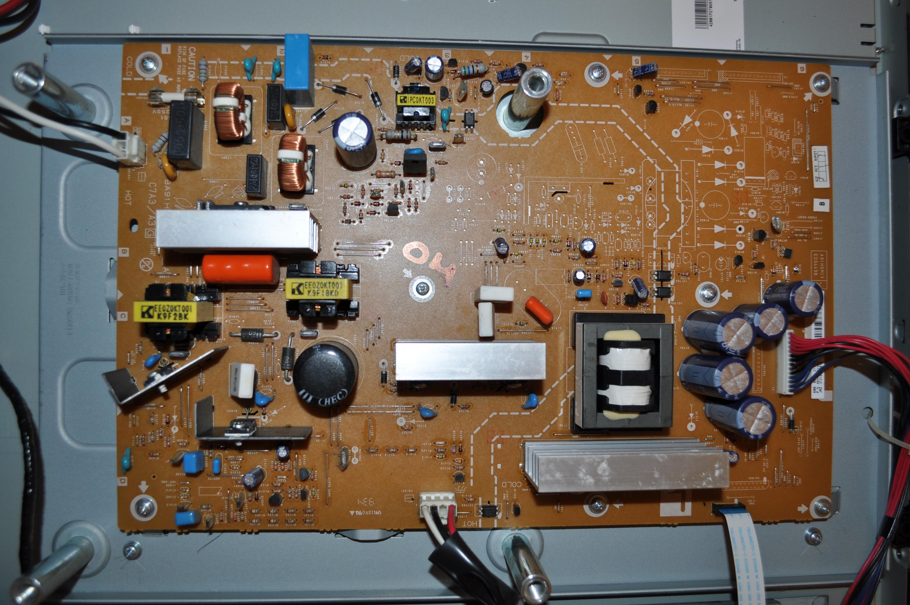

                                  You are not going to get any AC on the two pins of the bridge until the main board sends the signal to turn on the BLUE power relay. Need to check the STBY power supply section first.
                                  What is the chassis number?
                                      AH! I did not notice the relay. It looked like an X-cap. But I did not know why there was an X-cap to ground...
