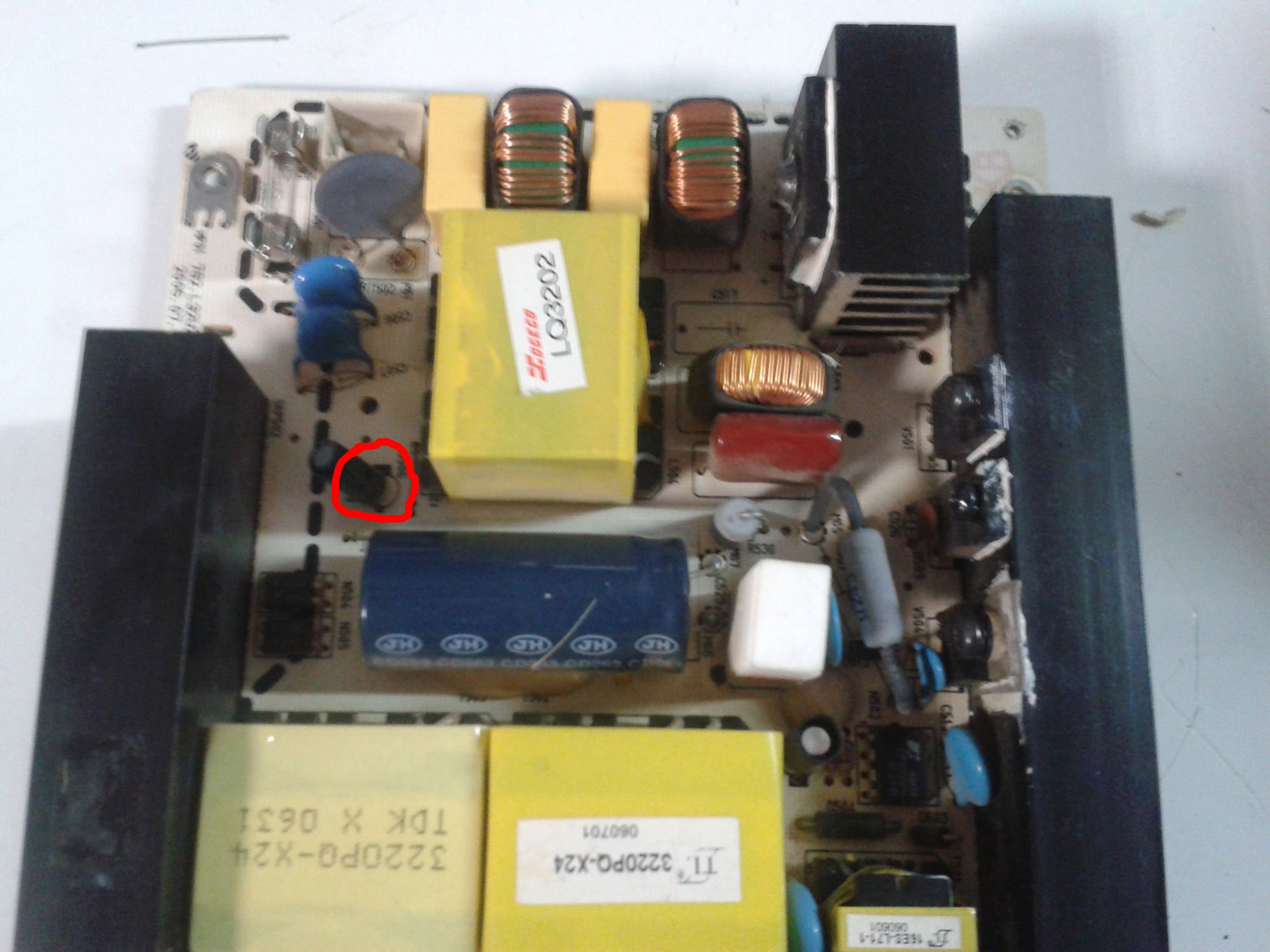

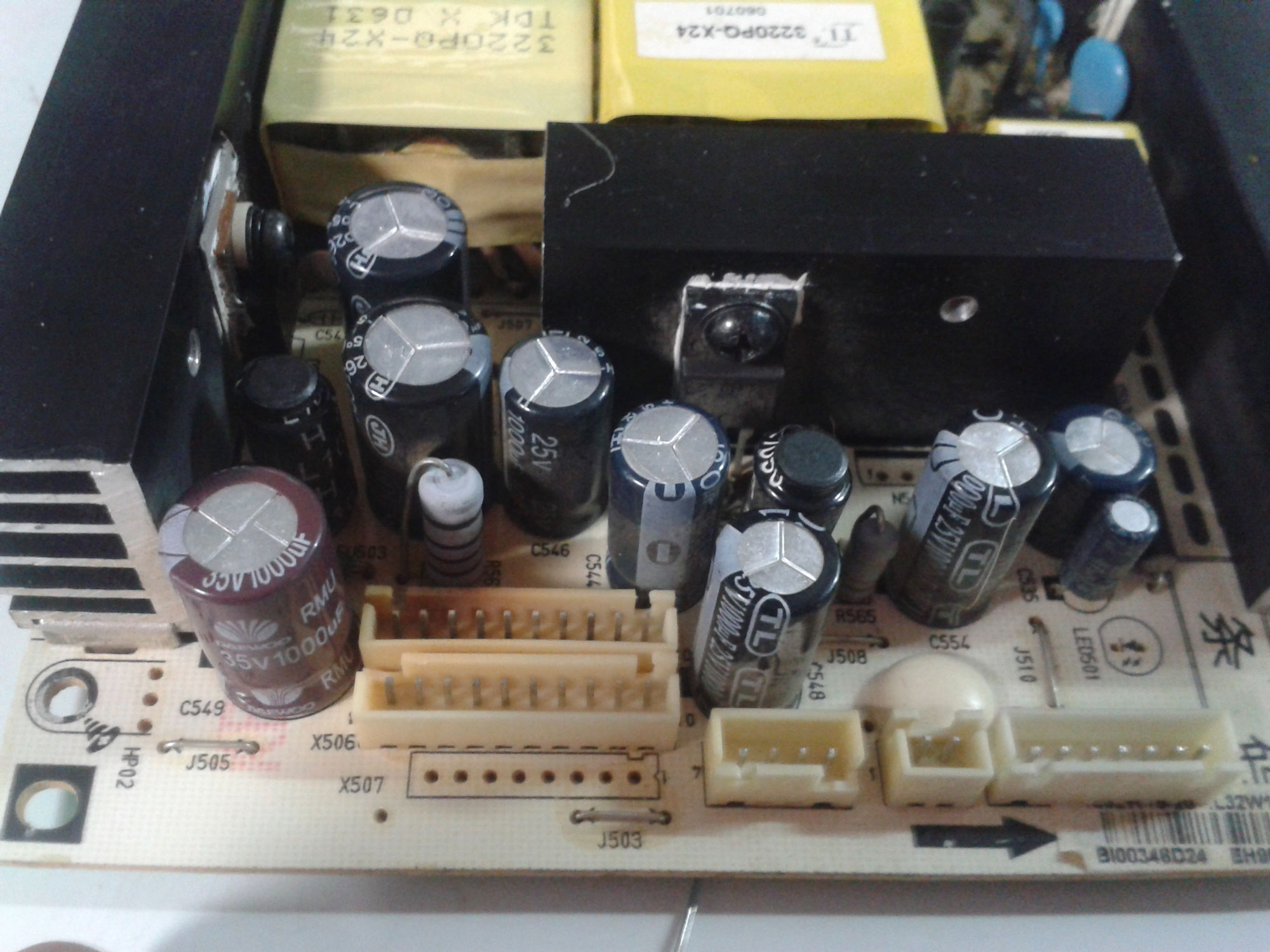

    I picked up this tv today.
    The power supply board have this reference L32W19-20.
    When I push the power button the screen turn on and off very fast because it clicks on and off quickly. (the backlight turn on and off very fast repeately).

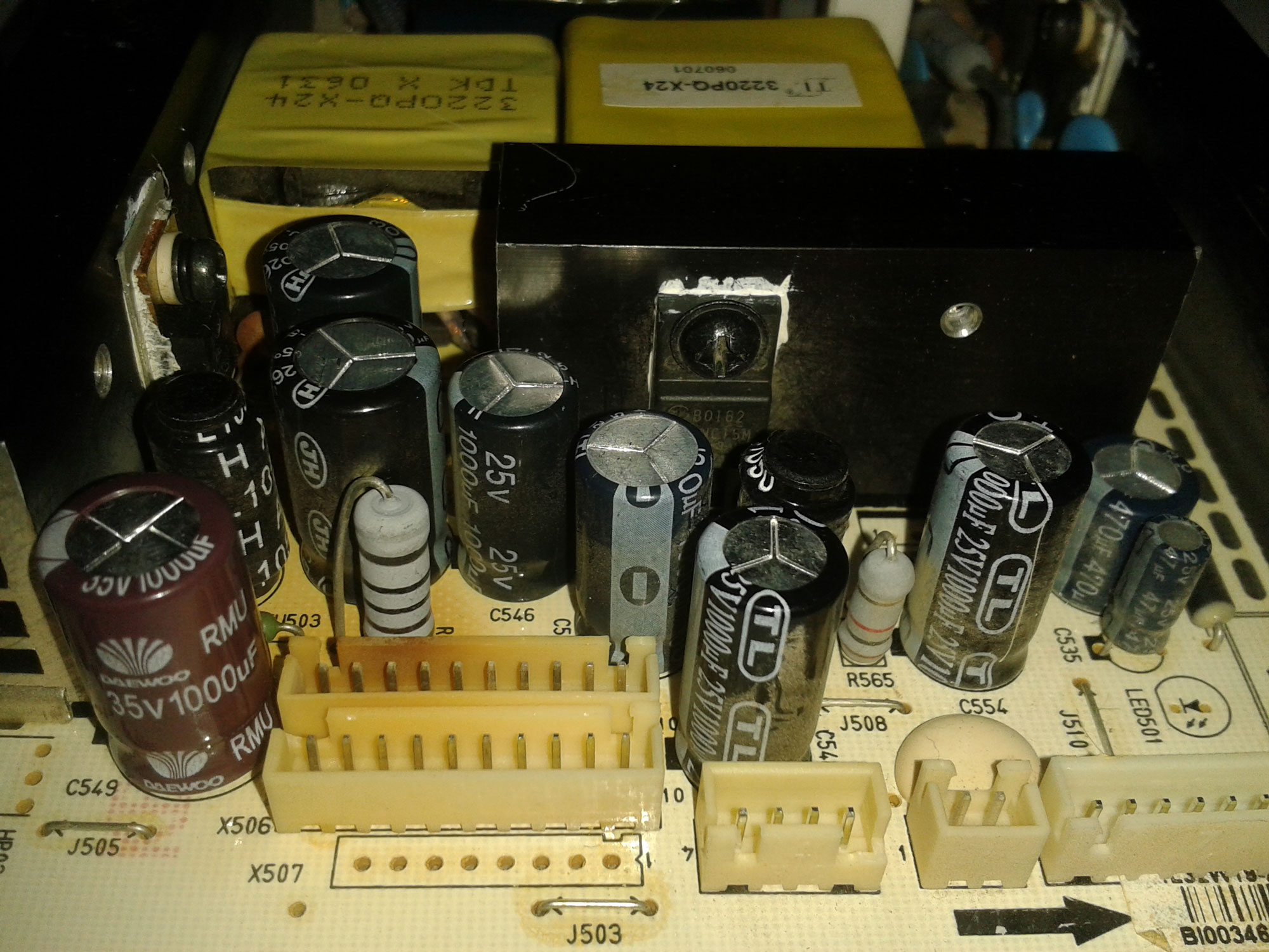

    There was a visible blown capacitor which I changed.
    Near of this capacitor, there is a 3W resistor which have symptoms of overheating and the colors are not distinguishable. This resistor measure 450ohms but I think it should be 1K.
    I measured the output of the connectors and it output +5VDC in standby but when I turn on I don't see any other voltage than +5VDC.
    Any advice what to check on the power supply board?

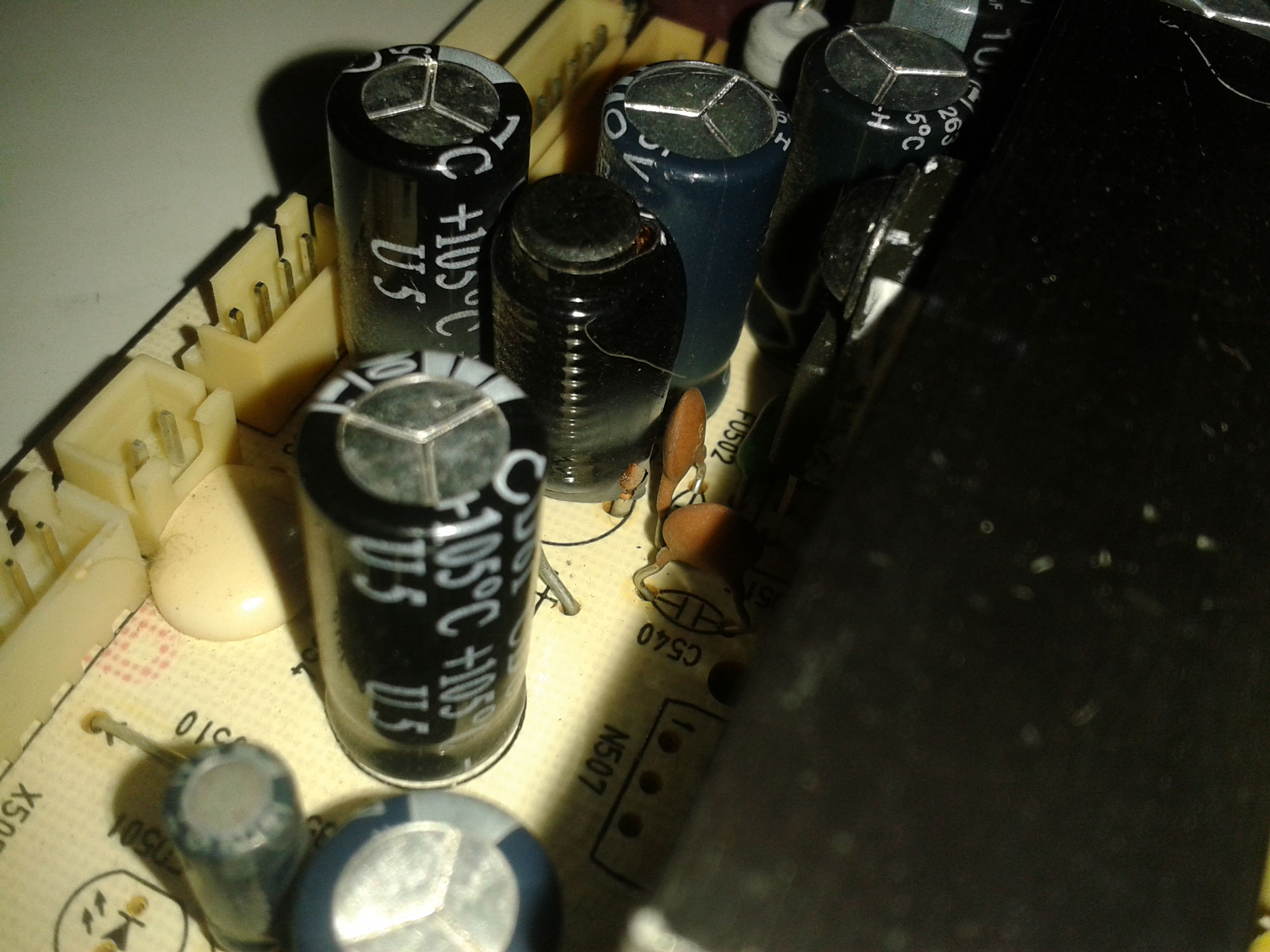

    Check F0502, it is just barely visible in your second picture.
    Also, replace the rest of the capacitors. The 'TL' and 'JH' ones are crap! Is that Daewoo capacitor the new one? And is it low-esr? I sugguest using somthing better like panasonic or nichicon capacitors.

        I have checked continuity on FU502 and FU503 (first picture) and both are ok.

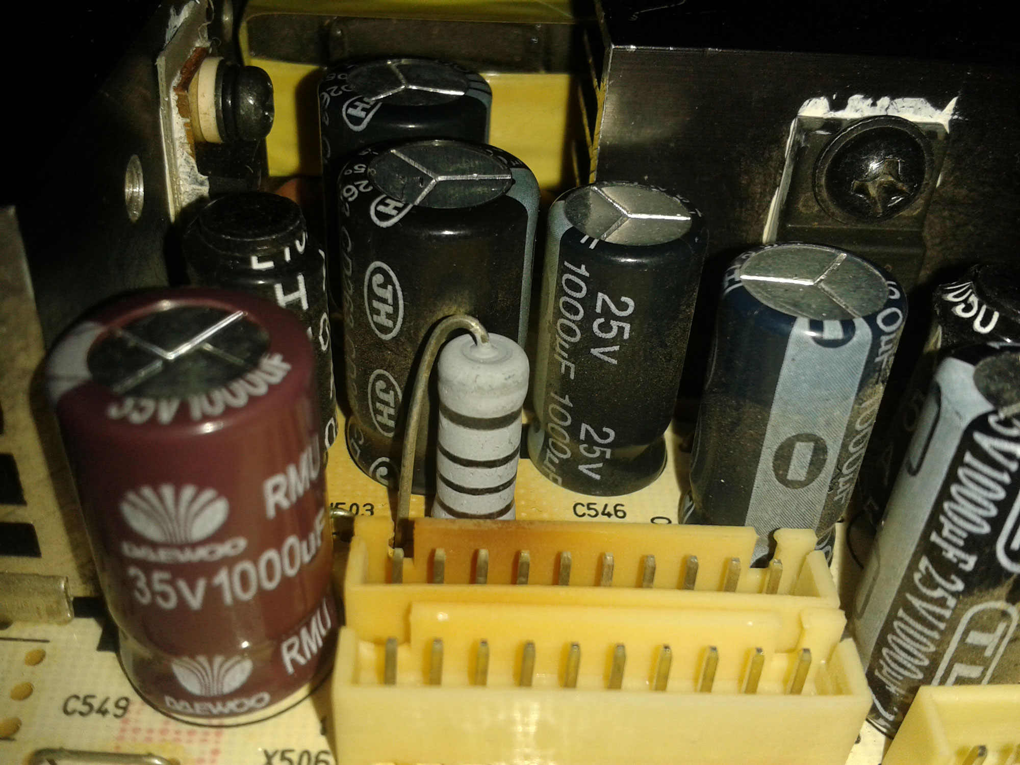

        Yes, the Daewoo capacitor is the new one. (Daewoo RMU Series 105º Standard).
        I bought these capacitors at the local electronics store. Let me know if these are ok.
        How can I safely check the voltage across the high voltage capacitor?
        The 3W resistor should be changed?

          The Daewoo is probably not suitable, the RMU series is not low impedance and will likely fail
          Testing the voltage across the 450V cap is done with two probes and two steady hands. If you slip, you will get a loud bang and blow the mains fuse or trip the main circuit breaker, but other stuff will probably survive... Just be careful.

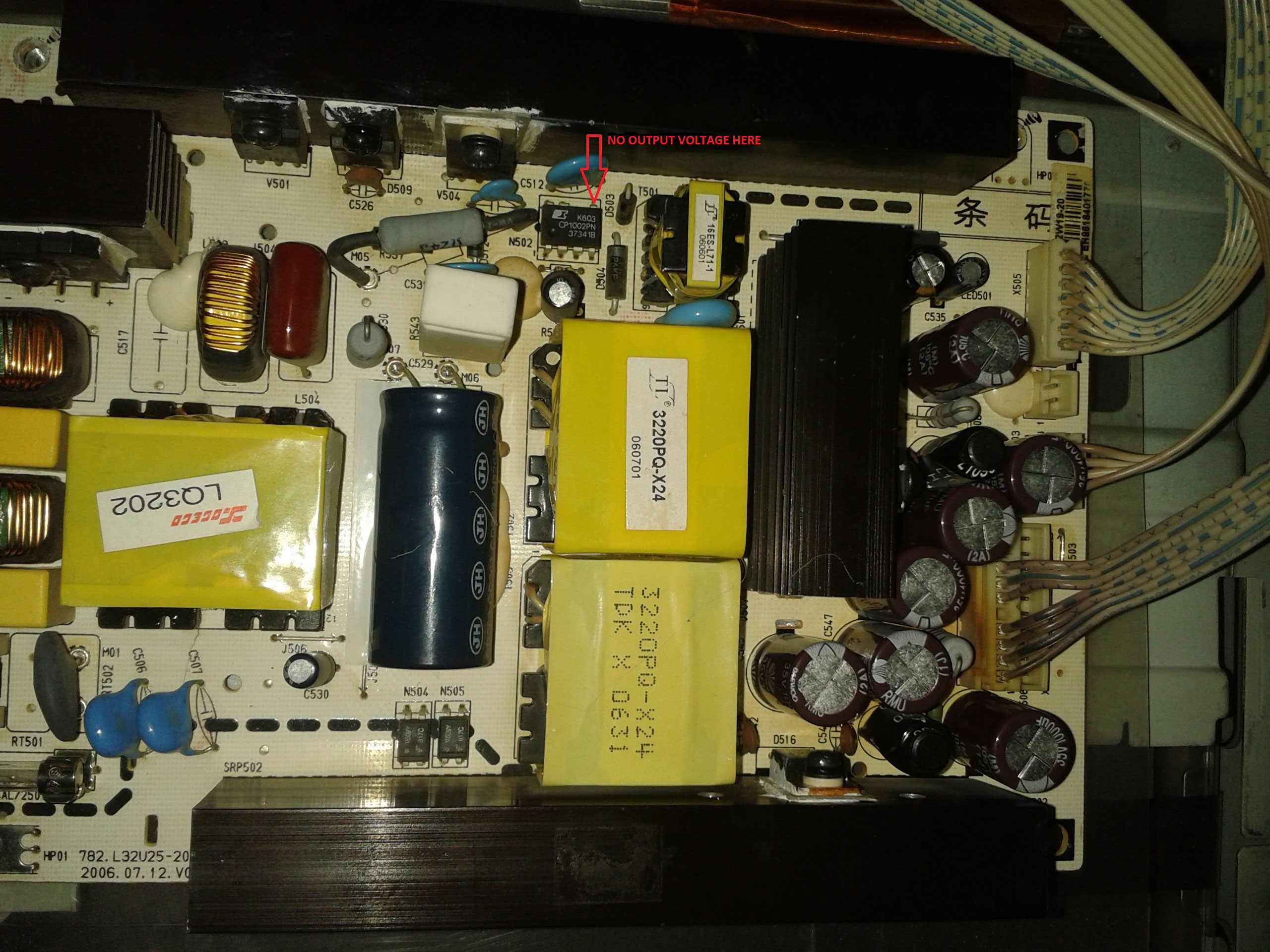

            Re: PRIMA LCD 32" TV clicking on off

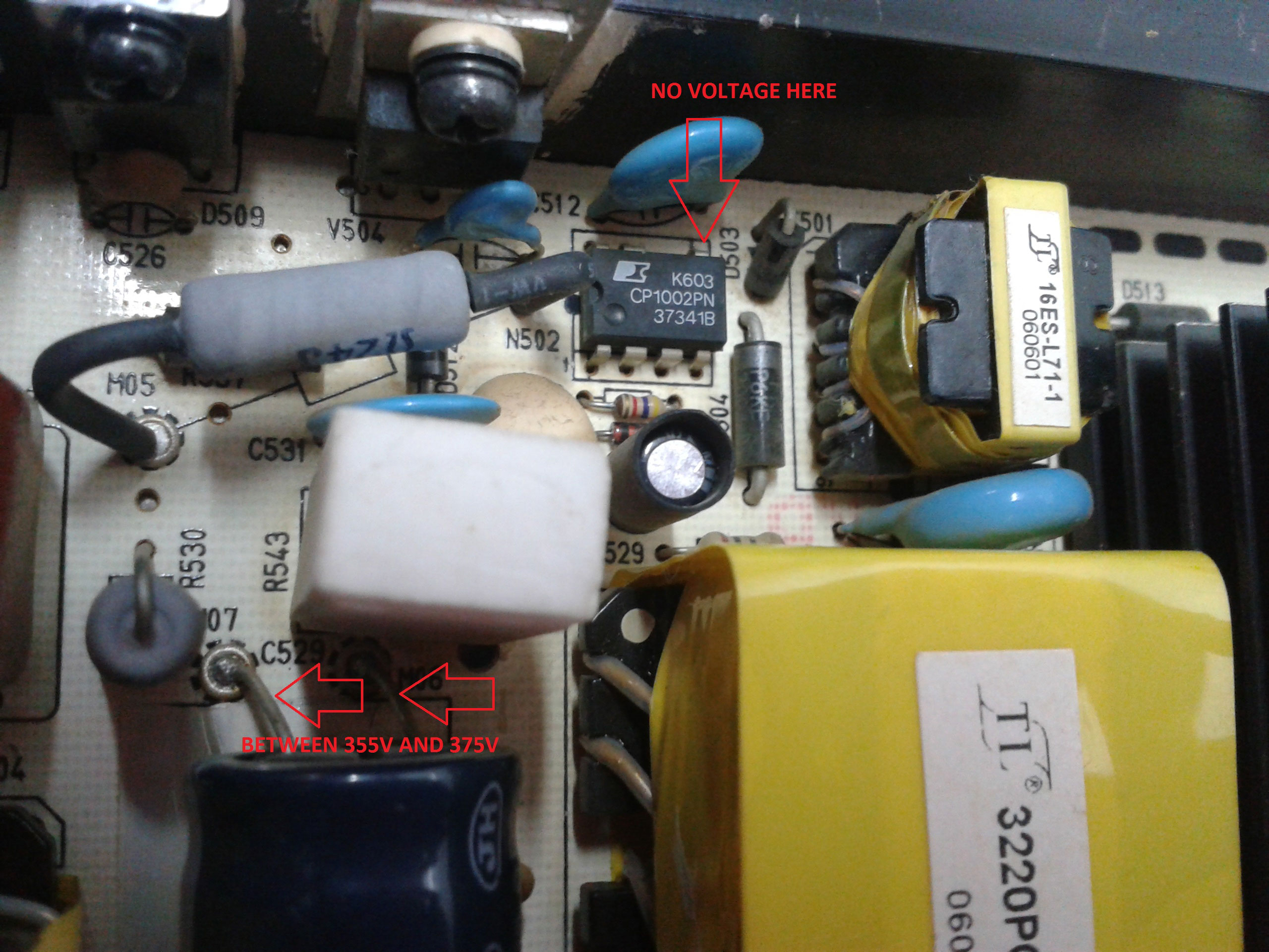

            I have tested the voltage across the 450V capacitor and is ok too. The power supply continue to click on and off and the backlight turn on and off.
            I see a IC with the reference CP1002PN (with Power Integrations Logo). How could I check this IC?

                I checked again across the big capacitor and show 375 volts, this is normal? I used DVM at the 600VDC scale.

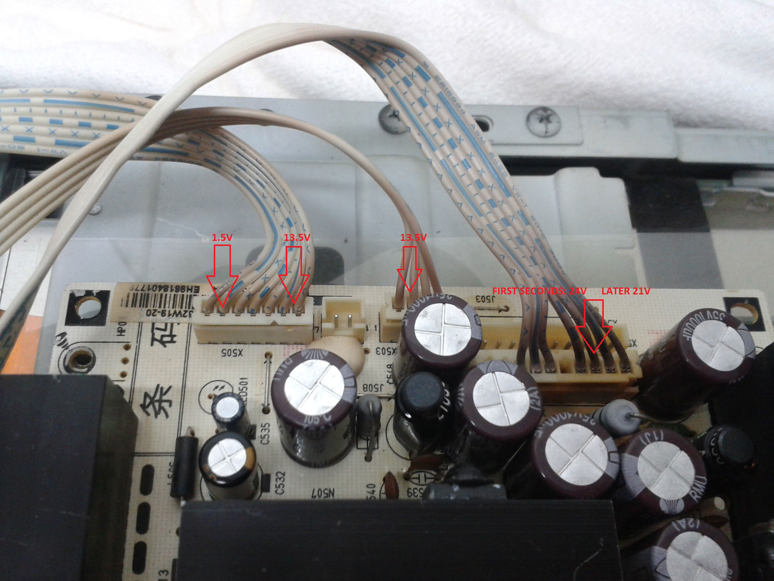

                  I checked output voltages and I see 22VDC, 13VDC and 1.5VDC. The 1.5V is normal?
                    375V is OK, but is it stable as the screen flickers?
                    Where, which pin, are you measuring the 1.5V DC?

                      Today I measured big capacitor voltages again and it show between 355V - 358V DC.
                      I post some pictures where I'm measuring these voltages.
                      what can I do?
                      Thanks.

                          355 to 358V is too low. Can you check what your local AC mains voltage is?

                            local AC mains voltage is 235V AC.
                              Check the voltage across this capacitor.
                                the voltage across the capacitor is 13V DC
                                  Does it fluctuate, or is it steady?
                                  • pyrosster
                                    • Aug 2013
                                    • 43
                                    • Spain
                                    I'm measuring voltage again and dont give any reading. only 0.02 volts and fluctuate.
                                      I'm confused, are you saying it's fluctuating by 0.02V, or is only 0.02V now? Is clicking on and off still happening or not?
                                      • pyrosster
                                        • Aug 2013
                                        • 43
                                        • Spain
                                        yes. yesterday I measured 13V DC and fluctuating +-0.3V DC. Today I'm measuring the same capacitor and dont give any reading, only 0.02V DC.
                                        The clicking on and off is still happening.
