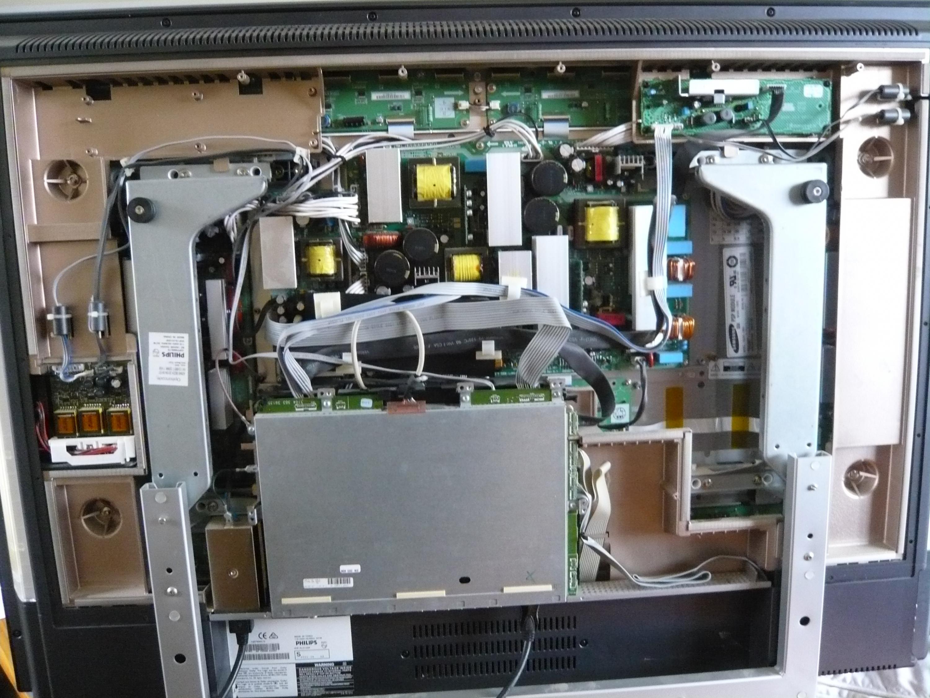

    hello all i have a problem with a phillips 42pf9766/99 plasma with a chassis model ftp2.2a aa About a month ago we heard the odd crack from behind the set then the other day the sound went off shortly followed by the picture.Now when i try to switch on the power switch i get a blue light for a couple of seconds then a flash on the red led and set shuts down .When turned on the 3 green caps on the board all light up for a few seconds but the top 2 go out after the red flashes leaving the lower one on .. My first thought was bad caps in the power supply but after a visual check i dont know all look in new condition no bulging or leakage hoping someone can steer me in the right direction cheers shayn

    It would be very helpful if you could post some pictures of the boards inside your set so we can see what there is inside, who made the plasma panel and how it is all connected.
      Re: phillips 42pf9766/99 plasma

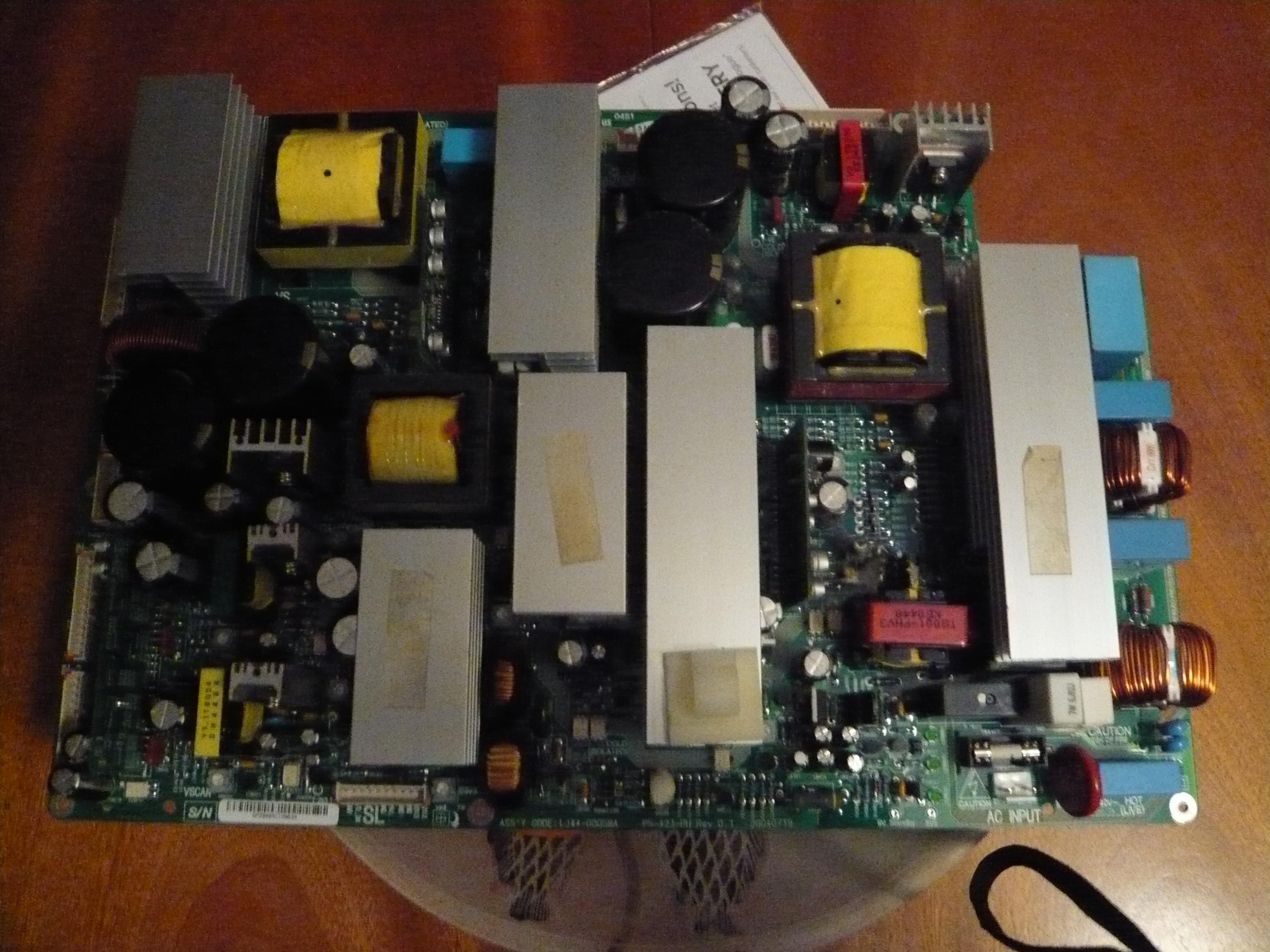

      Here are the photos of the phillips 42pf9766/99 plasma panels looks like samsung. Hope you can help. cheers, Shayn
        Where are the "three green caps" you say light up? Can you highlight them on the image?
          hello all i said in my original post that 3 green caps lit up i ment to say 3 green leds lit up you can see them on the left of the ac input and fuse, the transfomer on the left of the board looks as it may have been hot at some time

            Do the indicators have labels near them?
            Can you see a part code starting with BN44, BN9x or LJ9x on the board? I may be able to locate schematics.
              hello all..the leds are numbered from the top 801 ,802,803 the only code starting with ljx
              on the board is ass y code:lj44- 0058a cheers Shayn

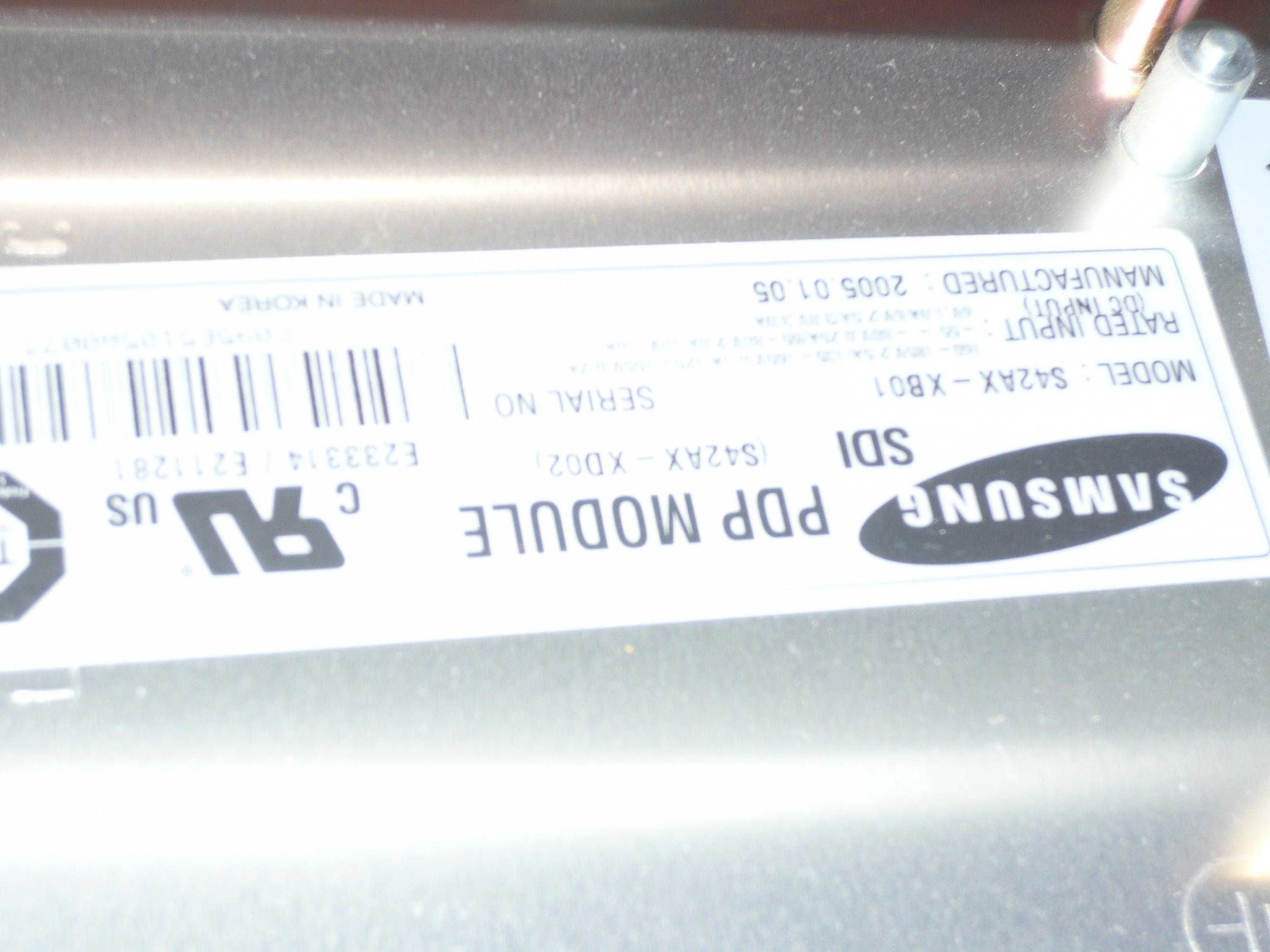

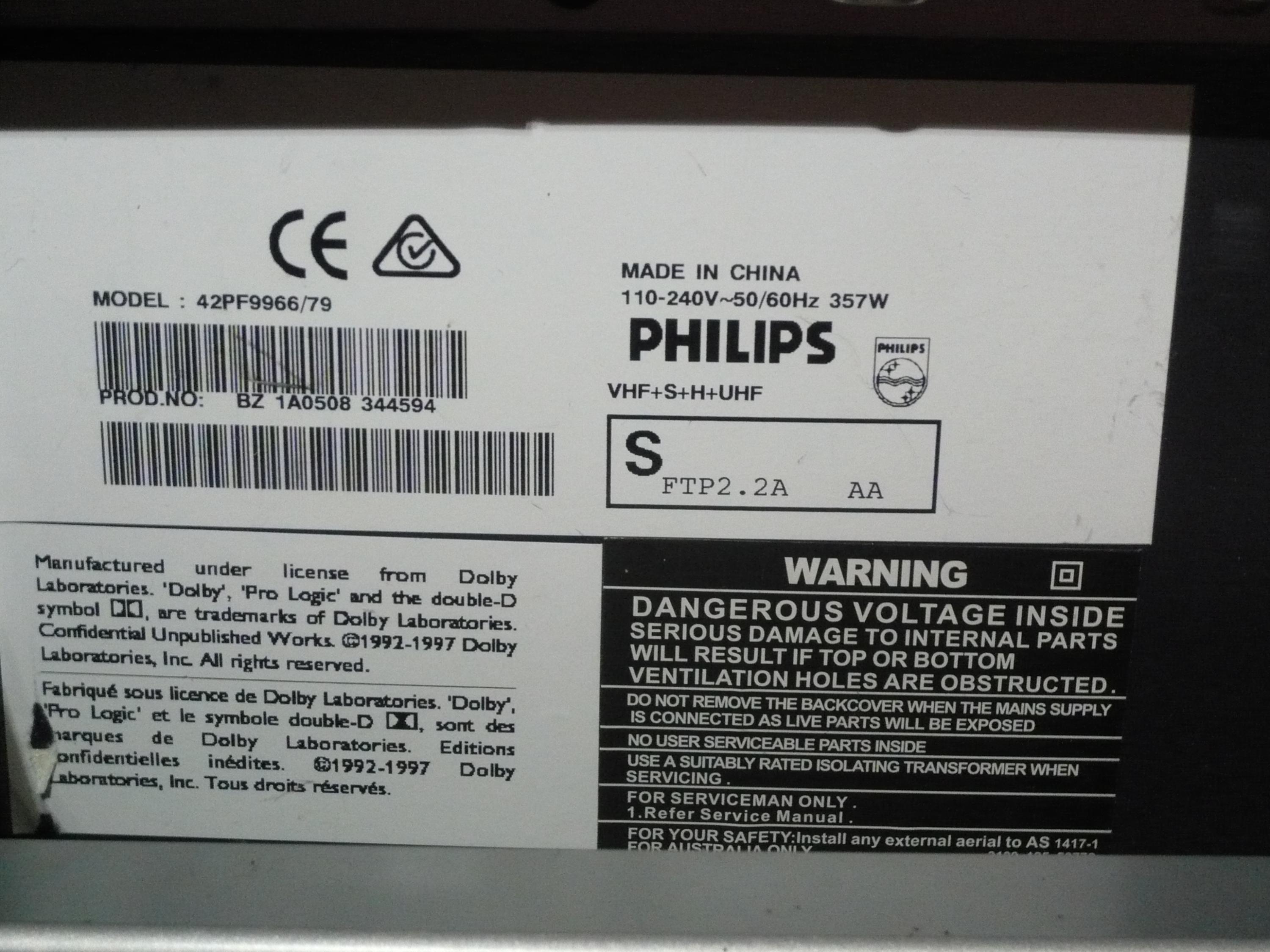

                    Can you post a picture of the model # sticker (on rear of TV case) so I can find the chassis number. Ohm Supplies sell the power supply for £40 plus VAT. http://www.ohmsupplies.co.uk/POWER-SUPPLY-LJ44-00058A
                      hello tom i think the info you need is in my second post top pic but have taken the other id tag in this post cheers shayn
                        Hello Tom after some web research i think the phillips tv model s42ax-xbo1
                        FTP2.2a aa has the chassis manual 3122 788 14860 which i am unable to locate any help to locate this chassis manual would be very much appreciated

                            update on phillips 42pf9766/99 plasma checked voltage on psu board
                            my voltage silk screen
                            vs 7.1 175v dc
                            va 71.5 70v dc
                            ve 2.6 160 dc
                            vset -0 173v dc
                            vscan 0 60 vdc
                            d5vl 5.2 5.2 vdc
                            d3v3 3.5 3.3vdc
                            vcc 15 .07 15dvc
                            5v2 5.2 5.4vdc
                            pfc 372 370 to 400 vdc
                            vccs 102 18vvdc
                            with that voltage difference do you think that it could be a transformer fault ke0447a seemed to have been hot at one stage and has a slight browing but without a shematic for the board i am a bit in the dark any suggestions woul be great cheers himinshed

                                      Re: 42pf9766/79 plasma
                                      hello tom by the way thanks very much for all your paitence and help just a update on my model its a phillips 42pf9766/79 plasma not a /99 as i first posted.. yes i disconected x-main & y-main no change in the voltage on
