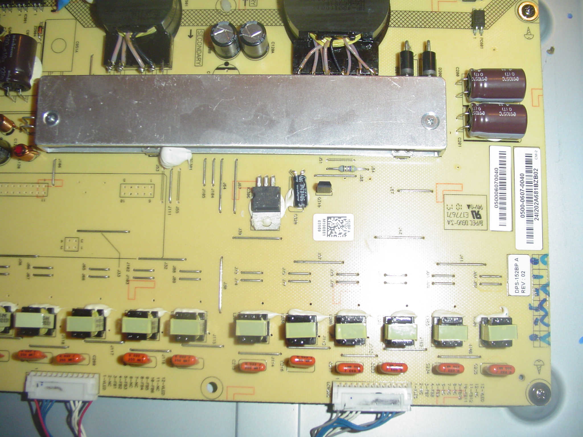

              on my power board it has the two plugs with letters,vled nc fb7 fb8 fb9 nc nc nc fb10 fb11 fb12 nc vled, duplicate on other side no ledger for voltages

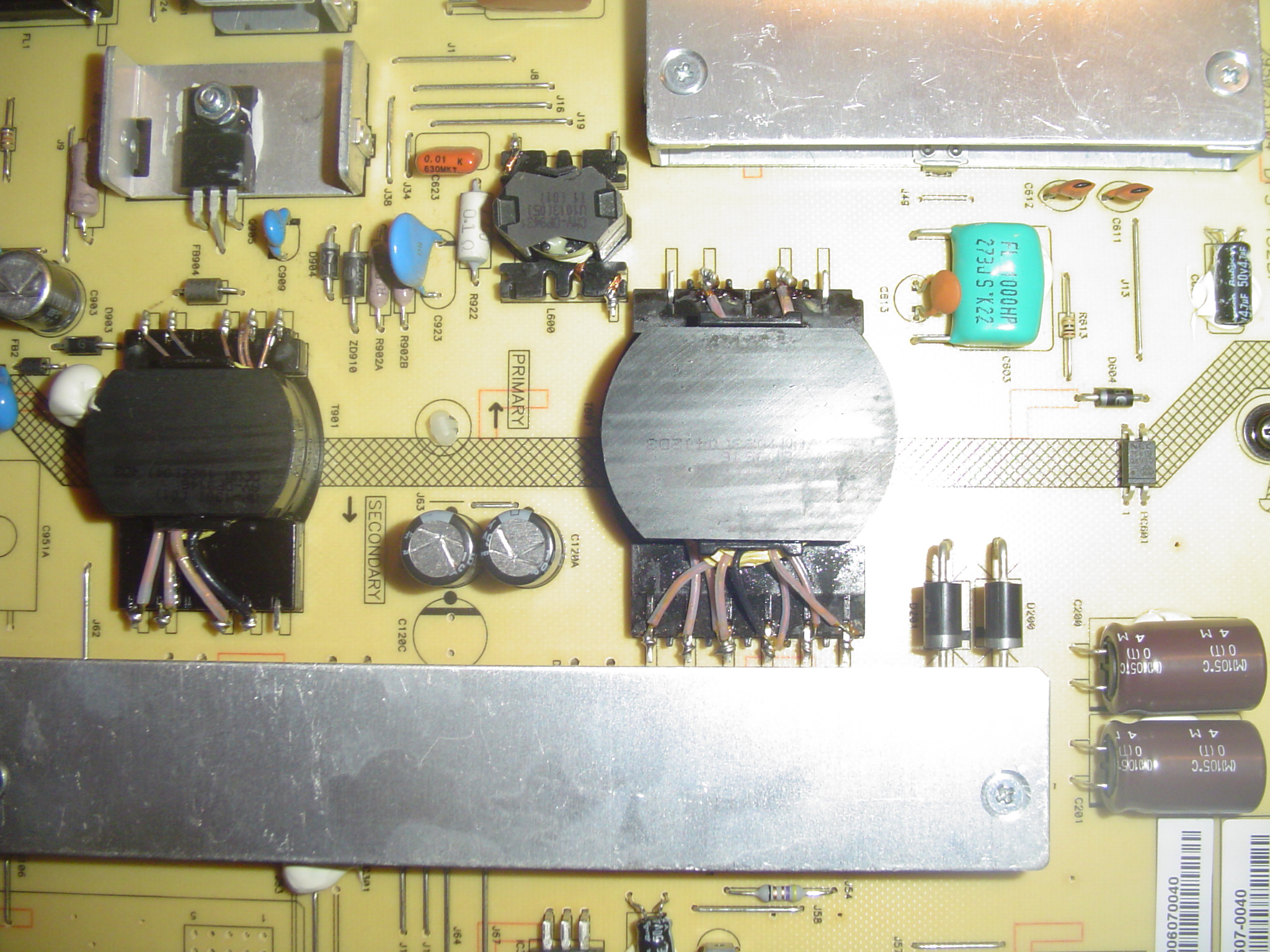

                Try to locate the VLED voltage spec, they usually have it printed some where on the board.

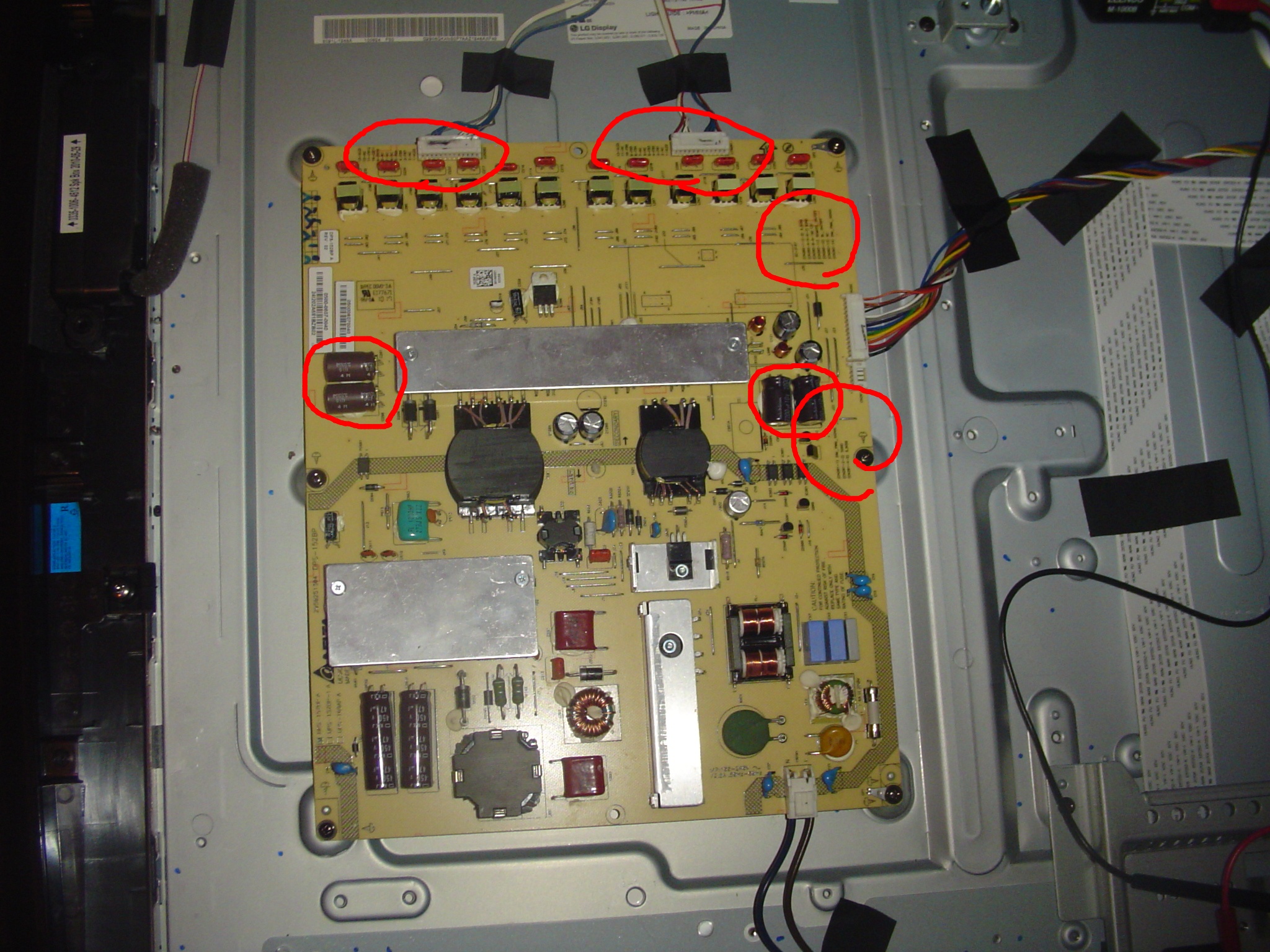

                Also what are the other labels on the board. Check the DC voltages on those brown caps.
                It may have shorted out LED wiring also. Do you see the backlights even flash for seconds?

                    no volts on brown caps,label pics

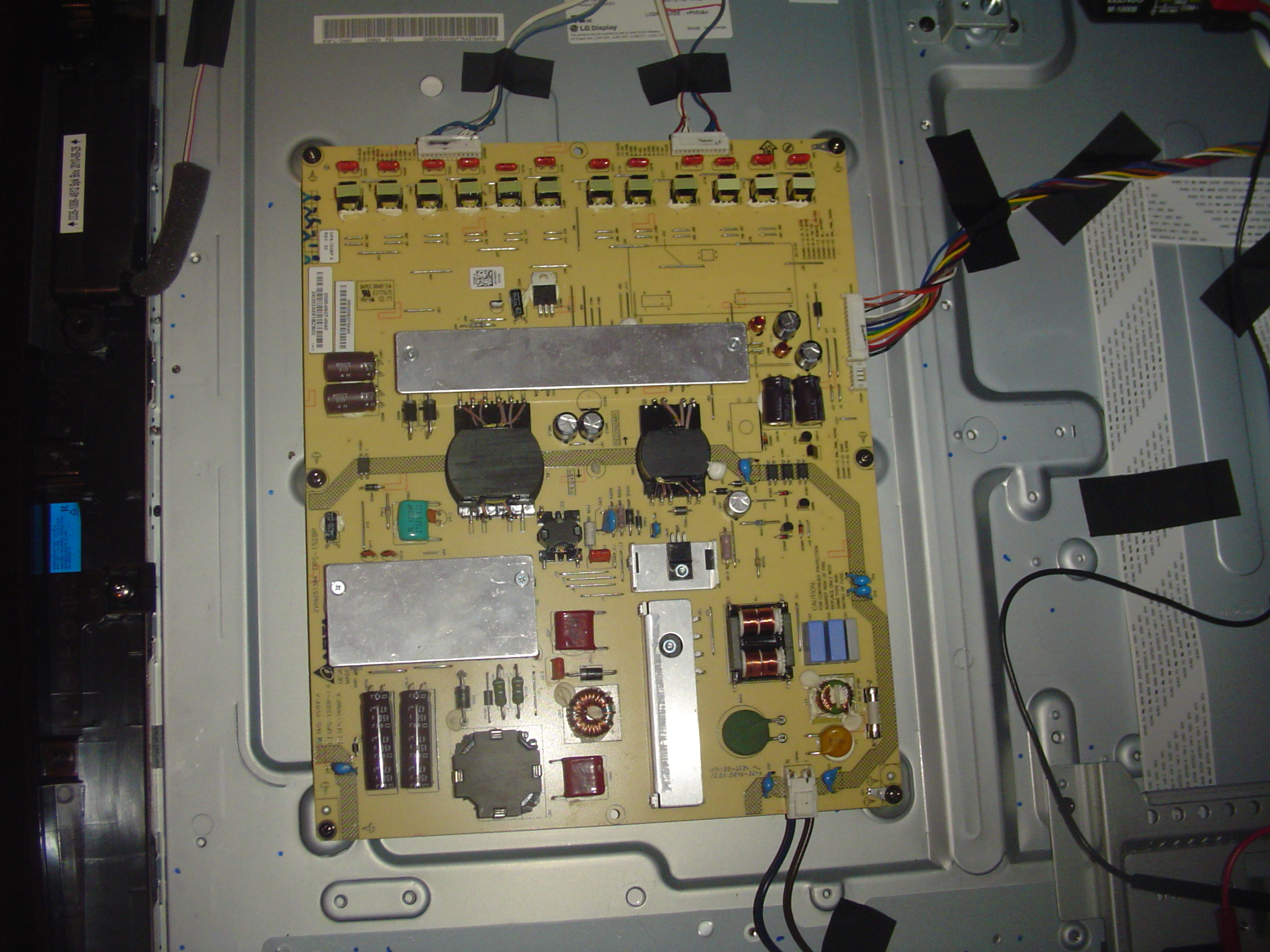

                      thanks for all the help,Im figuring that if I get power supply everything be ok,thxs again
                        Re: vizio m420nv,no backlight
                        no joy,either got bad power supply or it wasnt the problem to start with
