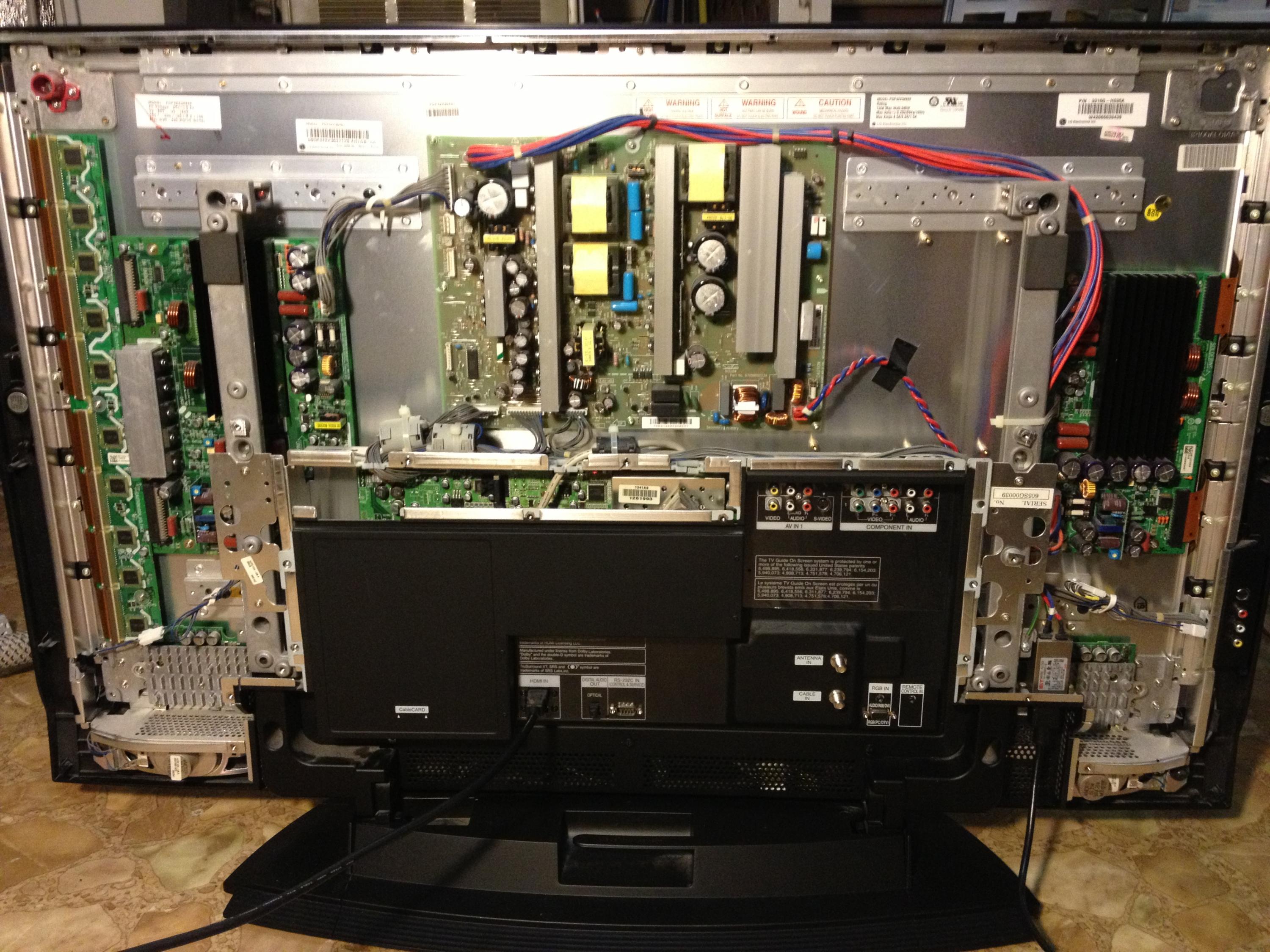

              Re: LG 42PC1DA distorted pinkish when turned on
              Finally was able to get back to looking at the tv.
              I opened up the back of the tv. Did not notice any caps that looks bulged.
              (a LOT of dust though)
              When I turned on the tv it looked crystal clear they I heard some slight pitch changes coming out to the power supply, and the image become distorted and pink/purple hue.
              I applied heat using a blowdryer to all components one by one, no effect.
              I have made a video of the tv when it is distorted: http://youtu.be/32y5i0lhZdw
              What are the next steps in this diagnostic???

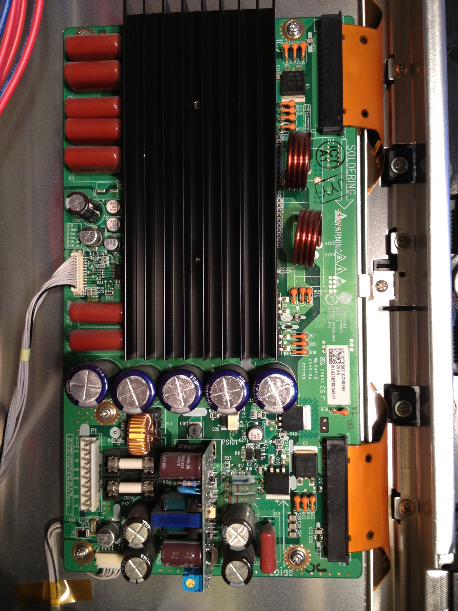

                You will need a multimeter, one can be purchased for under 10 dollars in good hardware shops. It must be a digital multimeter capable of measuring up to 300V DC. Unless you want to shotgun it. I'd say the Z-sus IPM has failed. The IPM is replaceable but requires expensive tools. You can order a new Z-sus or send your old one off for refurbishment. I cannot be sure though, as you cannot test anything without a multimeter.
                The Z-sus is the large circuit board in the right of the picture above with the two orange ribbons coming out of it.
                  ok. I will buy it today. Once I get it, what should I look at?
                    A closer picture of the Z-sus should reveal a place marked Vzbias. The voltage across here is to be measured and compared to the plasma panel specification, printed on a label marked PDP42X..... in the top corner of the plasma screen.

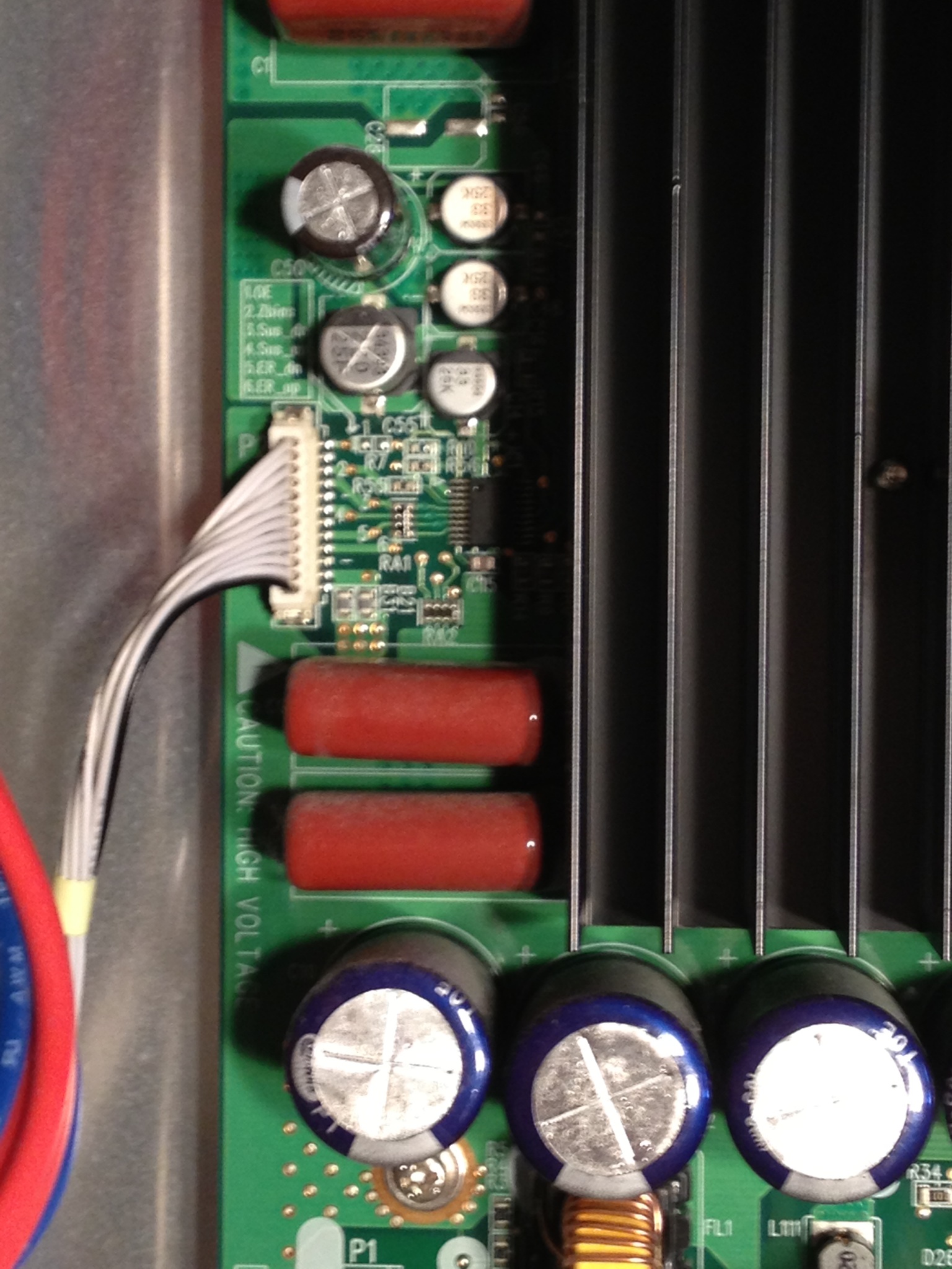

                      OK here is where I hope you bear with me.
                      I have never used a multimeter.
                      I purchased one today.
                      I have taken pics of the z-sus board.
                      I have identified where it says Vzbias. it is towards the bottom of the board on the first picture.
                      I will try and take a clearer picture tomorrow.
                      Can you explain how I would test?

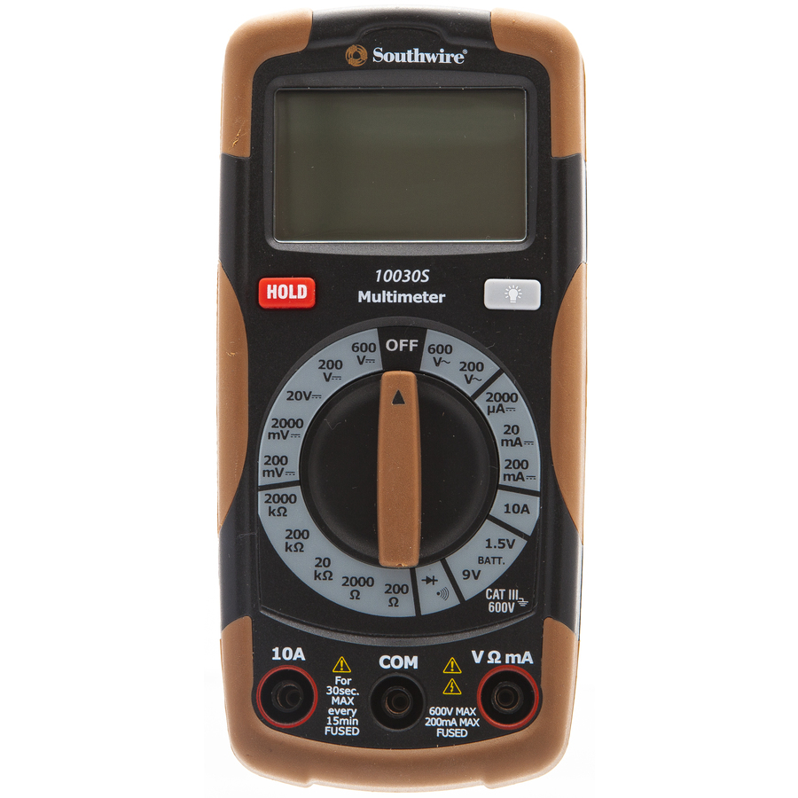

                        Can we see a picture of your multimeter?
                        • zango123
                          • Jul 2013
                          • 23
                          • usa
                          this is the multimeter i have.
                            Good multimeter.
                            You see the scale running on the left side of the dial, with "=" next to 2, 20, 200 etc? This is the DC V scale.
                            Set it to 600 DC V.
                            Place the black probe into the COM socket. You should not need to change that.
                            Place the red probe into the V ohm mA socket (ohm represented by horseshoe.)

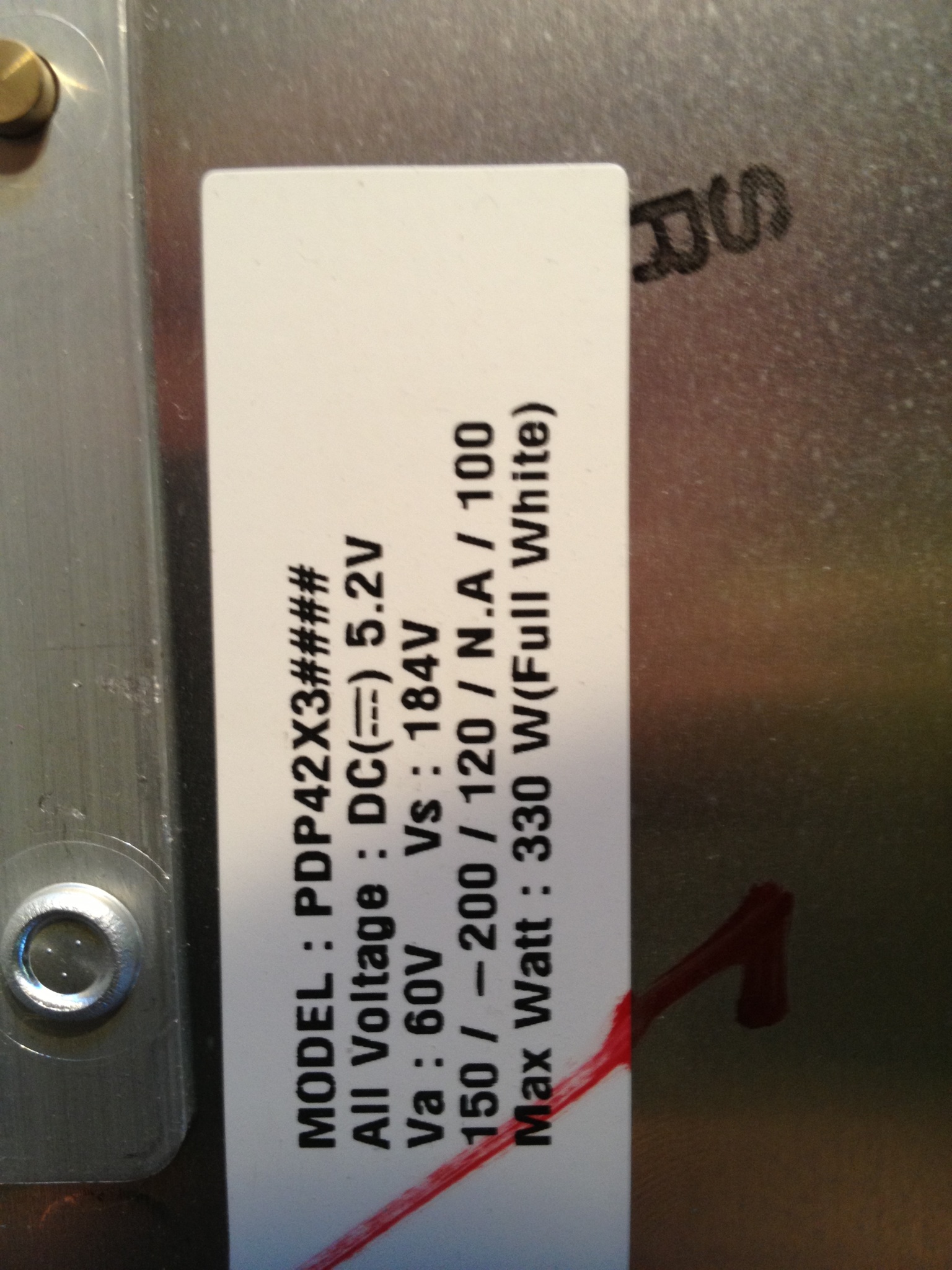

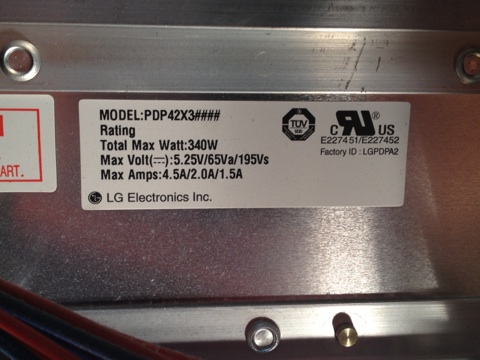

                            Find the points on the Z-SUSTAIN mentioned previously marked Vzb. If you need me to highlight these, post a clear picture of the Z-sustain.
                            Vzb should be around 90 to 120V on these, exact voltage written on the panel sticker marked PDP42X#####.
                            e.g.
                            Vs: 185V Va: 65V
                            N/A / -170 / 190 / N/A / 115

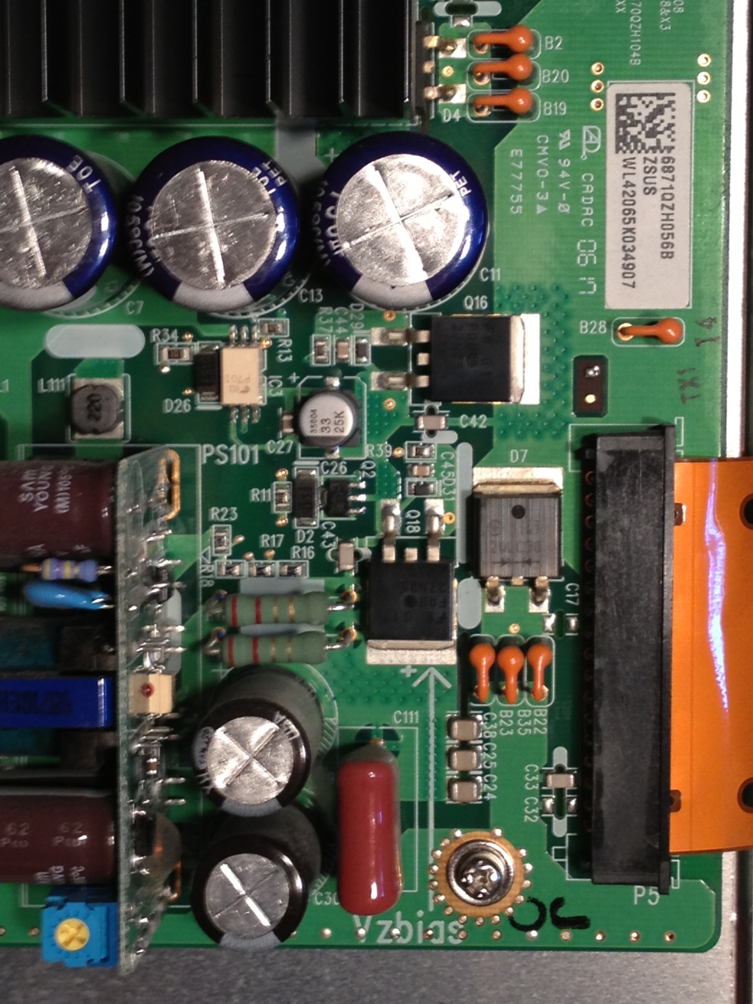

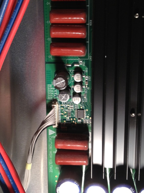

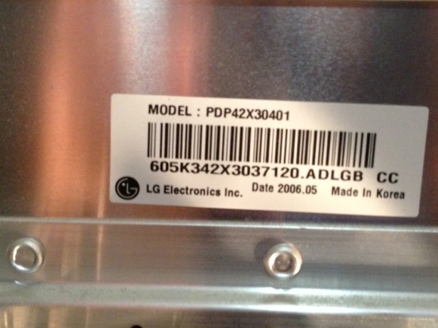

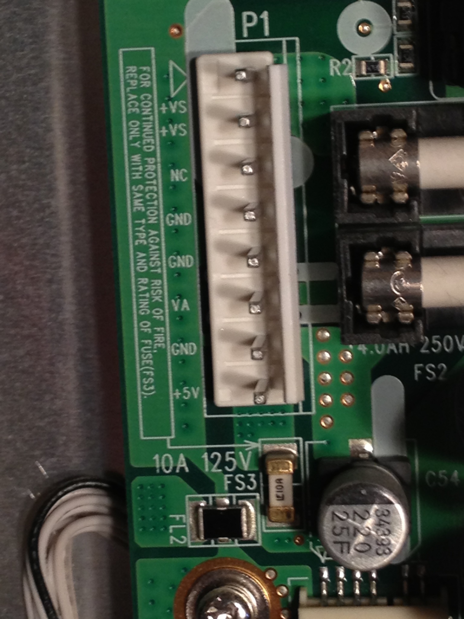

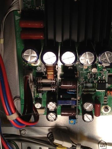

                              Here are some clear pics of the z-sus board and the panel sticker.

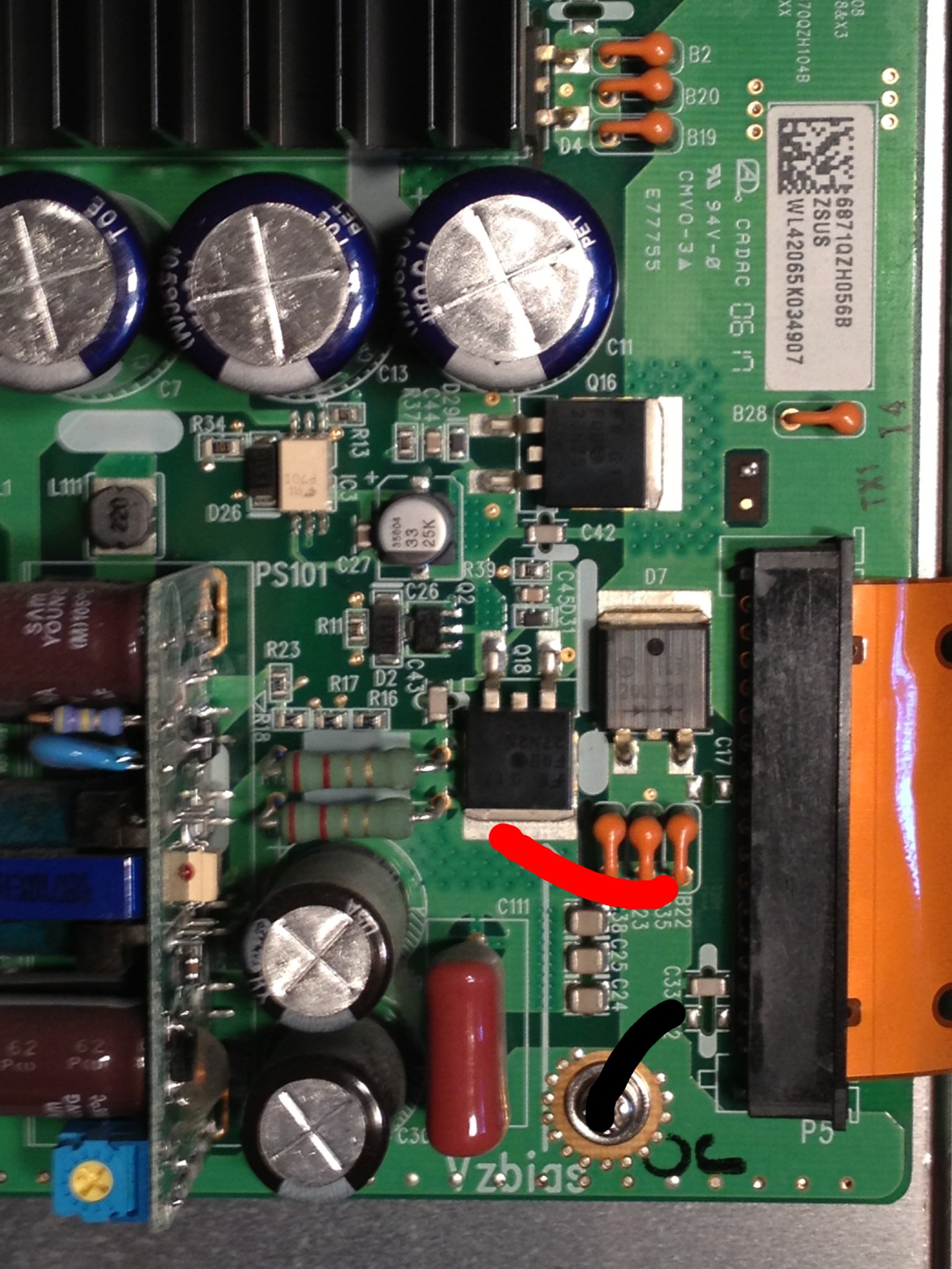

                                Here. Red probe goes on the metal contact of the highlighted device, black probe goes on the screw.
                                  ok so the red probe should touch the black square and the black probe should touch the screw... ok. But, is this with the tv turned on? (novice remember )
                                    Red to touch the bottom metal portion of the black device below the label "Q18" (this device is called "Q18" for future reference.)
                                    • zango123
                                      • Jul 2013
                                      • 23
                                      • usa
                                      tv connected to power outlet when I do this?
                                        Yes, screen lit up with fault symptom visible.
                                        Be careful not to slip with the probes!
