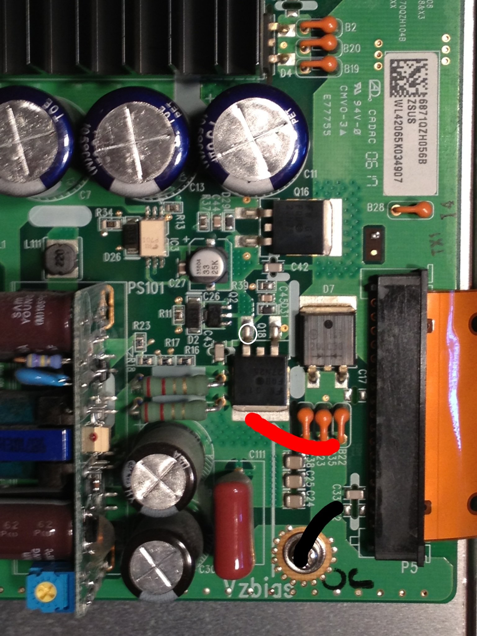

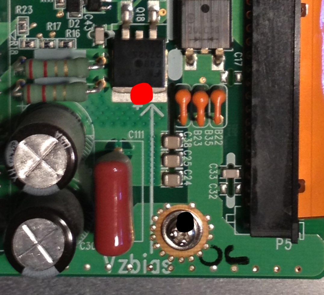

    A little paranoid as I do not want to get shocked...
    So I am touching the metal circled in white?
      Re: LG 42PC1DA distorted pinkish when turned on
      Let me clear this up. Probe the marked areas.
      Your Vzbias should measure 100V steady -- hold reading for several seconds and see if it is stable.
        held contact 20 seconds. multimeter read steady at 99.
              ok retested during the fault. the voltage is not stable.. it stays at 99, then every few seconds jumps randomly 122, 130, 219, then back to 99 for a few seconds, then it repeats.
                That is definitely bad though I was expecting it to drop out while the set was running not increase. Can you make sure your meter is away from the display while operating (just in case the interference created is too much.)
                  So tried it again with the meter away from the tv...
                  First I got a steady reading for a good 20-30 seconds.. I figured the I had gotten interference before. But, then I took the probes off and back on and was getting the erratic readings once again. It goes up wildly... 155, 220, 300, then back down and steady...
                  So at this point I'm a little unsure.
                  By the way, I had my phone in my pocket and now its dead... coincidence?

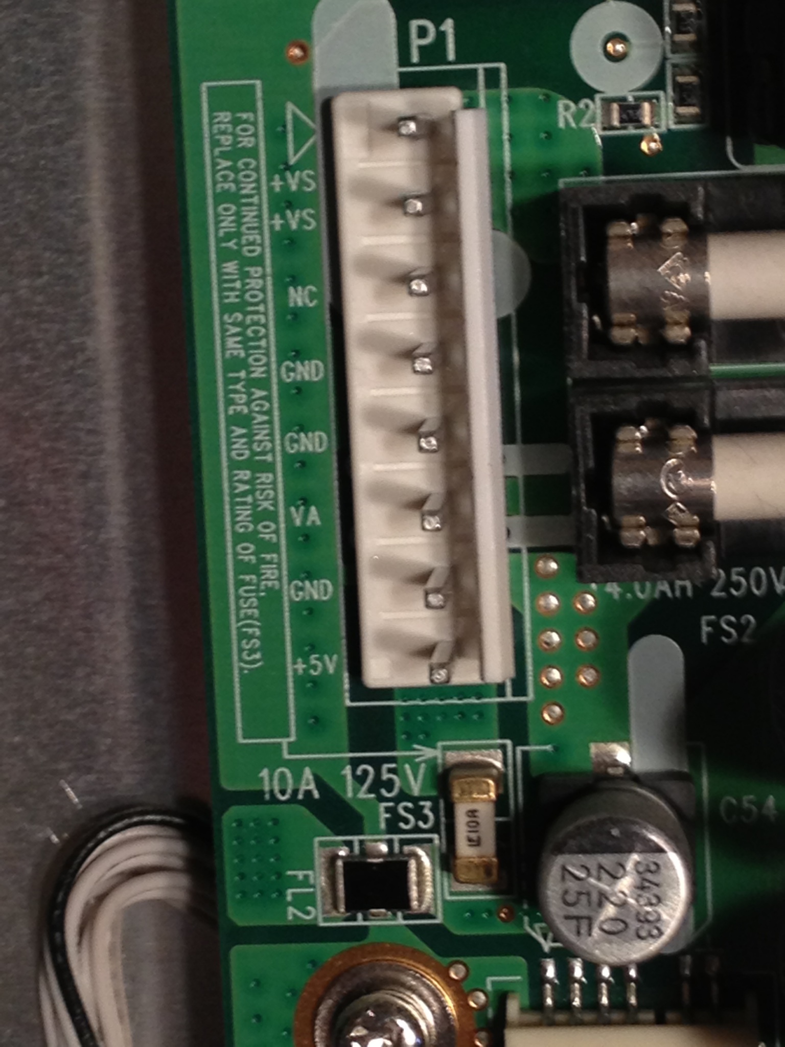

                    OK, right now I am thinking the Z-sus should be replaced.
                    One thing to check: On the Z-sus, there is a power connector which brings the voltages Vs, Va. Can you see it? Can you measure what you see on those pins?

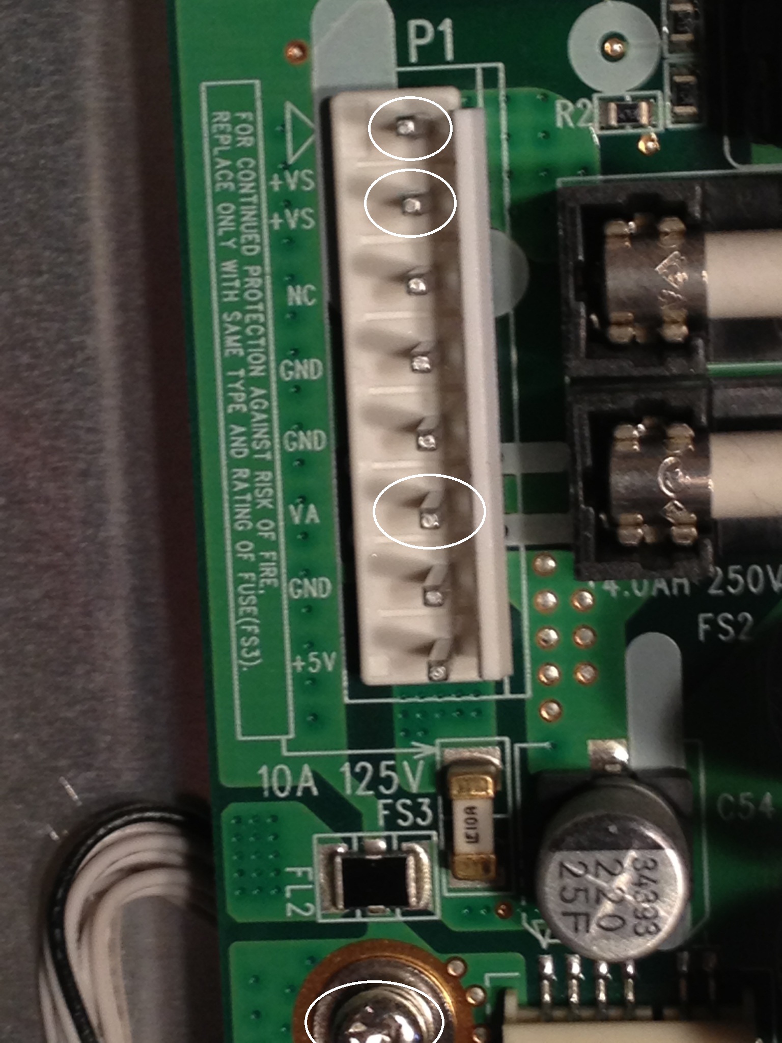

                      #30
                      Can you show me how to scope it. Here is a picture with the cable unplugged.
                        #31
                        Connect the cable (but NOT when the TV is on - wait a few minutes if it has been recently switched on) then stick your probe in the exposed metal around where the wire goes into the connector crimp. Ground (black lead) in same place as before. Expecting around 185V.
                        • zango123
                          • Jul 2013
                          • 23
                          • usa
                          #32
                          OK, so with the cable attached I will scope the circled points.... look ok?>
                            #33
                            Yep. You only need to check one of the VS points, they are the same.

                              #34
                              got it thanks... I'll check tonight...
                              • zango123
                                • Jul 2013
                                • 23
                                • usa
                                #35
                                I'm going to ground on the screw nearest the VS, VA connectors... not on the scree I used last time.
                                  #36
                                  That's fine,.
