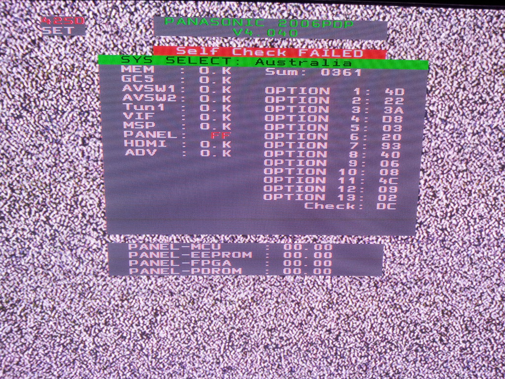

    Well my good old Panny plasma is playing up again. I should throw it out but I feel attached to it for a number of reasons, including the fact that is used to be my late beloved grandmothers and despite its age it still shows a really nice picture.

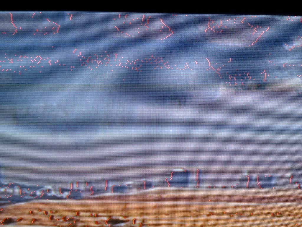

    So it all started when about a week ago I began noticing red patterns appearing along certain contrast changes on the picture. This was regardless of input source. Check out the first picture for an example.
    So I did some reading and found that apparently things like this can occur due to incorrect voltage adjustments. So I opened her up and checked the voltages. The Vsus and Ve voltages were a bit out so I adjusted them back into spec. While I was in there I decided to check all of the other voltages, including the 15V supplied to the SS/SC boards.
    Since I live near the ocean corrosion is pretty significant and it's hard to get a good contact with the multimeter probes. I accidentally slipped and shorted out the 15V onto the base of a transistor on the SS board, completely frying it with a base to collector short. It turns out that this was one of the IGBT drive transistors and as such is a really high frequency part (5GHz). I was able to find a suitable replacement (BFQ149) which arrived today and I installed it tonight. To my elation the TV now works again, but I'm back to where I was before the self inflicted damage.
    I did some more investigating and found an interesting result on the self-test. As shown in the second pic, the self test failed on the panel. Also note that none of the FPGA, EEPROM, MCU or PDROM versions are being reported.
    I looked through the schematics and these all communicate with the main MICOM IC through a paid of I2C lines labelled "PANEL SCL 1" and "PANEL SDA 1" so I reckon it's safe to assume a connection issue. Especially since I have screwed around on that board in the past. I'll bring a scope home from work tomorrow night and do some probing.
    The purpose of posting this here is to ask whether you guys reckon that the red patterns I'm experiencing would likely be related to the panel communication issue or something else? If something else do you have any suggestions?
    Thanks for reading!

    I would say it's more likely to be a loose connection between the A board and D board due to corrosion or being mis-seated. I'd recommend reseating all cables between the A and D board. It's possible the connector carries other lines, such as I2C, which are also going astray.

      Thanks Tom. I looked at the schematic some more and decided it should be an easy enough operation to just beep out the connections with the meter. Found that one of the 0 ohm jumper resistors had gone open circuit. I'm guessing I had physically damaged it during my last adventure inside the set and the recent cold weather had caused it to move just enough to go open circuit. So the self test now passes again, but unfortunately I've still got the red patterns.
      Do you have any suggestions for them?

            In which case, the fault is either on the A board, the connection between the A and D board, or very rarely on the D board itself.
              Re: Panasonic TH-42PA60A Self Test Failed
              This set has H and DG boards rather than an A board. Since the fault is occurring on all inputs - including HDMI - that would indicate an issue with the DG board, or more specifically between the output of the video processor on the DG board and the D board. I wonder if perhaps there is an issue with the LVDS connection?

                2. In an attempt to try to further qualify the mode of the error I tried displaying the HDTV test pattern shown here. At first I received a vertical red line through just the yellow bar at around 170, but then it disappeared and began displaying on the red bar in about the same location. It's like the issue is caused by just a specific red value (since red values in the red and yellow bars are identical) but in that case you would expect it to be showing on both bars simultaneously.
                3. The remote control has a freeze frame button on it. When pressed while playing a movie with the red pixels showing up (as shown in the first post), the red pixels remain on the screen and even sometimes move slightly. Would this frozen image function likely be performed on the DG (A) board or on the D board?
                If the fault is being caused by the D board, is it possible that the test patterns generated by the D board don't show the fault because they just don't generate the kind of colour gradient that produces it?

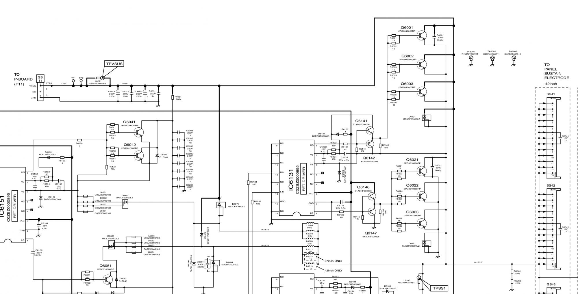

                4. There are two blown ceramic caps on the SS (sustain voltage) board: C6001 a 5.6nF 630v cap across the Collector-Emitter of IGBT Q6001. Here's that section of the schematic, parts of interest in the top right:
                There are actually similar capacitors across Q6002 and Q6003 (the one across Q6002 doesn't look too healthy either), not shown on the schematic. Ultimately they're all in parallel anyway. I assume these are just for EMI suppression rather than any function of the panel's operation? I could source replacements, but 630V ceramic caps aren't exactly a common item so I'd rather wait until I know I can sort the main issue first (unless of course it's possible that this is causing the issue).
                Any suggestions on how I can further try to diagnose this down to a component level or is it time to give up?

                  Does this happen on analog sources, HDMI sources or both? It sounds like dithering, which is performed by the D board, and something with the dithering is going wrong.
                    All sources. A problem with the D board would be a pain...
