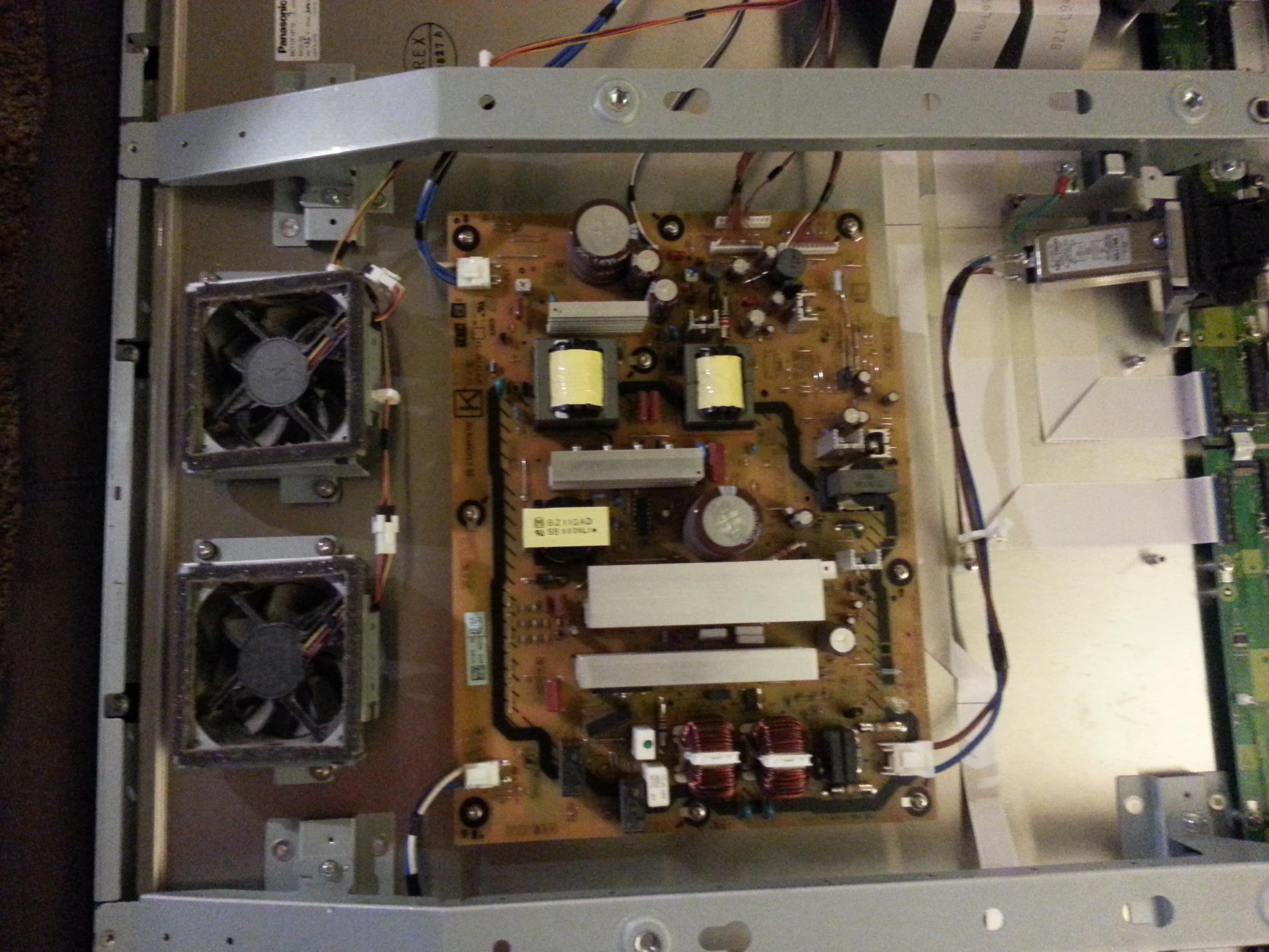

    Last week my Panasonic Viera TC-P46G10 plasma TV stopped working after a short power outage caused by a storm. I have read everything I can find on this forum and just want a professional opinion on my situation because I could not find my model or my exact issue.

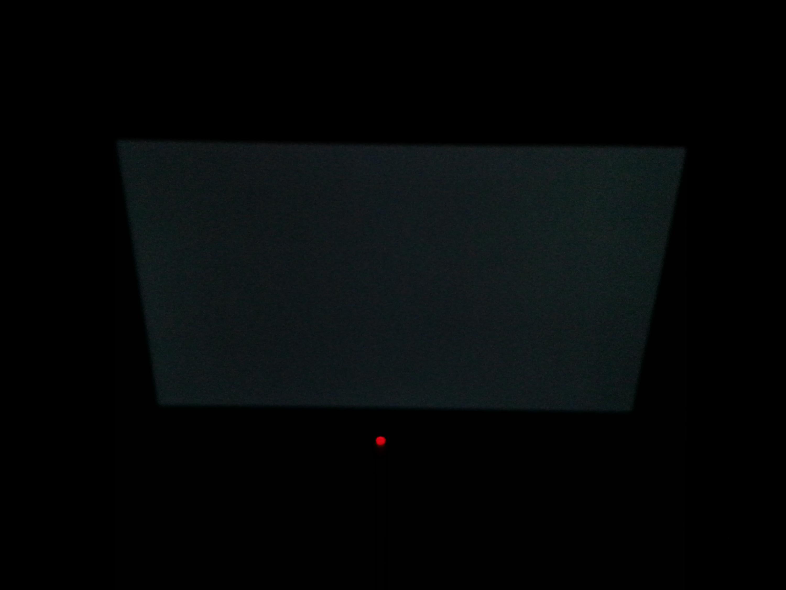

    When I power on the TV, the relay clicks and the red LED lights up like normal operation. After a few seconds, the screen lights up...there is no picture and it is dim put you can tell it is lit in the dark. Pressing any keys on the system or remote has no effect and nothing is placed on the screen (menu, input, channel, volume, etc...). The screen will stay lit up until I power off the tv. Also, the fans never turn on.

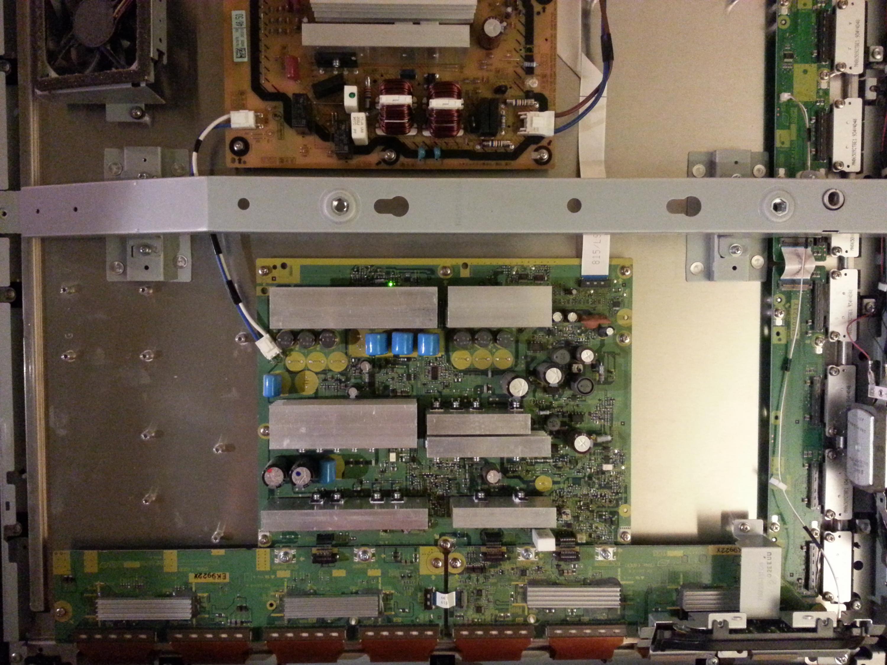

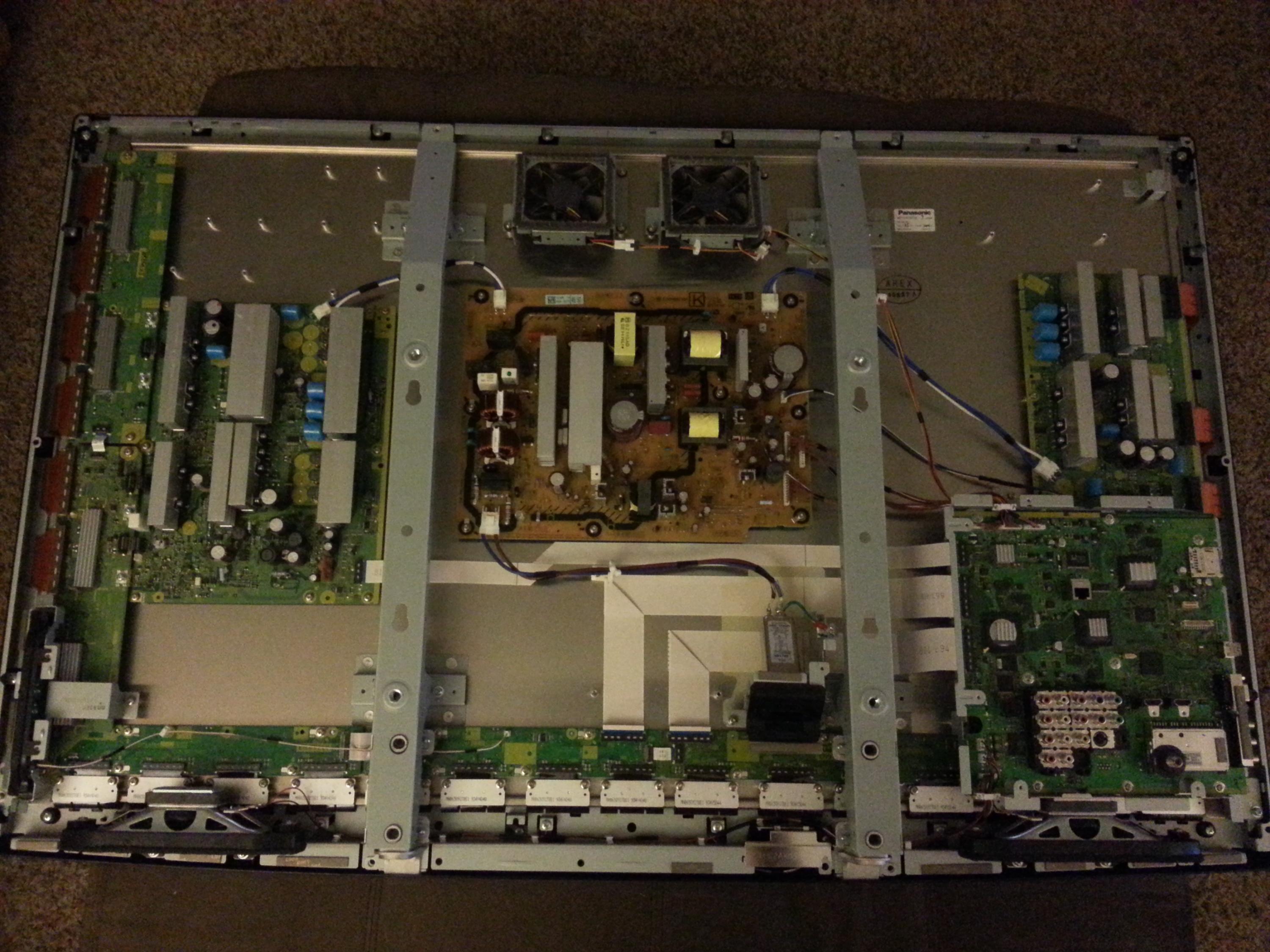

    I opened the tv and looked around and there are power LEDs lit on SS and SC boards. I am going to check the voltage on P25 pin 9 for 5V tonight when I get home as the service manual suggests.
    My educated guess is that something is wrong with the 'A' board since fans are attached to it, menus do not show up, the screen appears lit, SC and SS have power LEDs, and there seems to be nothing wrong with power since TV stays on.
    Let me know what you all think...is this a good assessment and I should get a new 'A' board? Is there a test to verify that the 'A' board is the issue? Is there somewhere else I should start? Am I way off and just plain stupid for existing? Any help is appreciated as this is the first TV I have worked on. (I'm a computer guy).

    A board would be my diagnosis as well, especially since the fans aren't working.

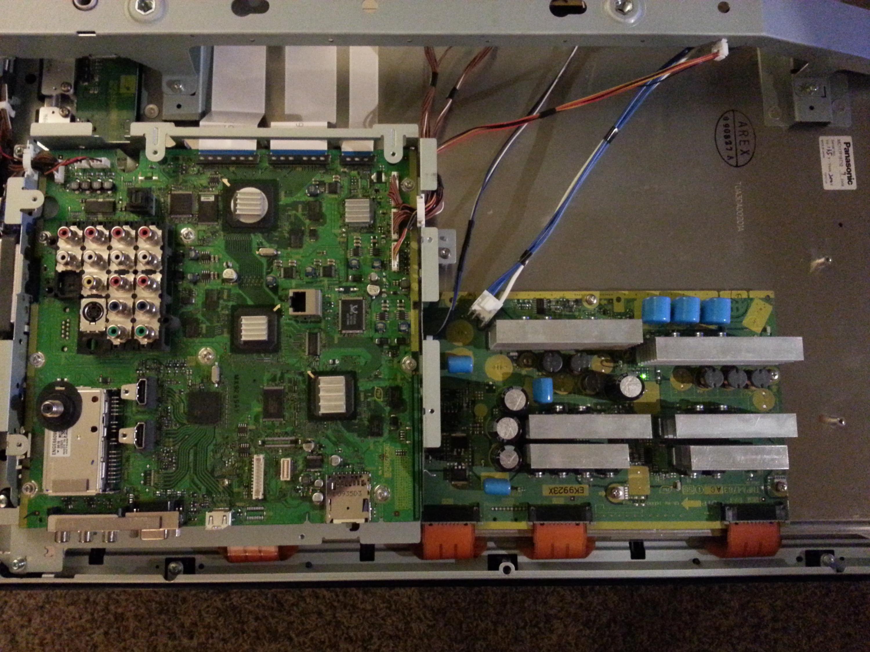

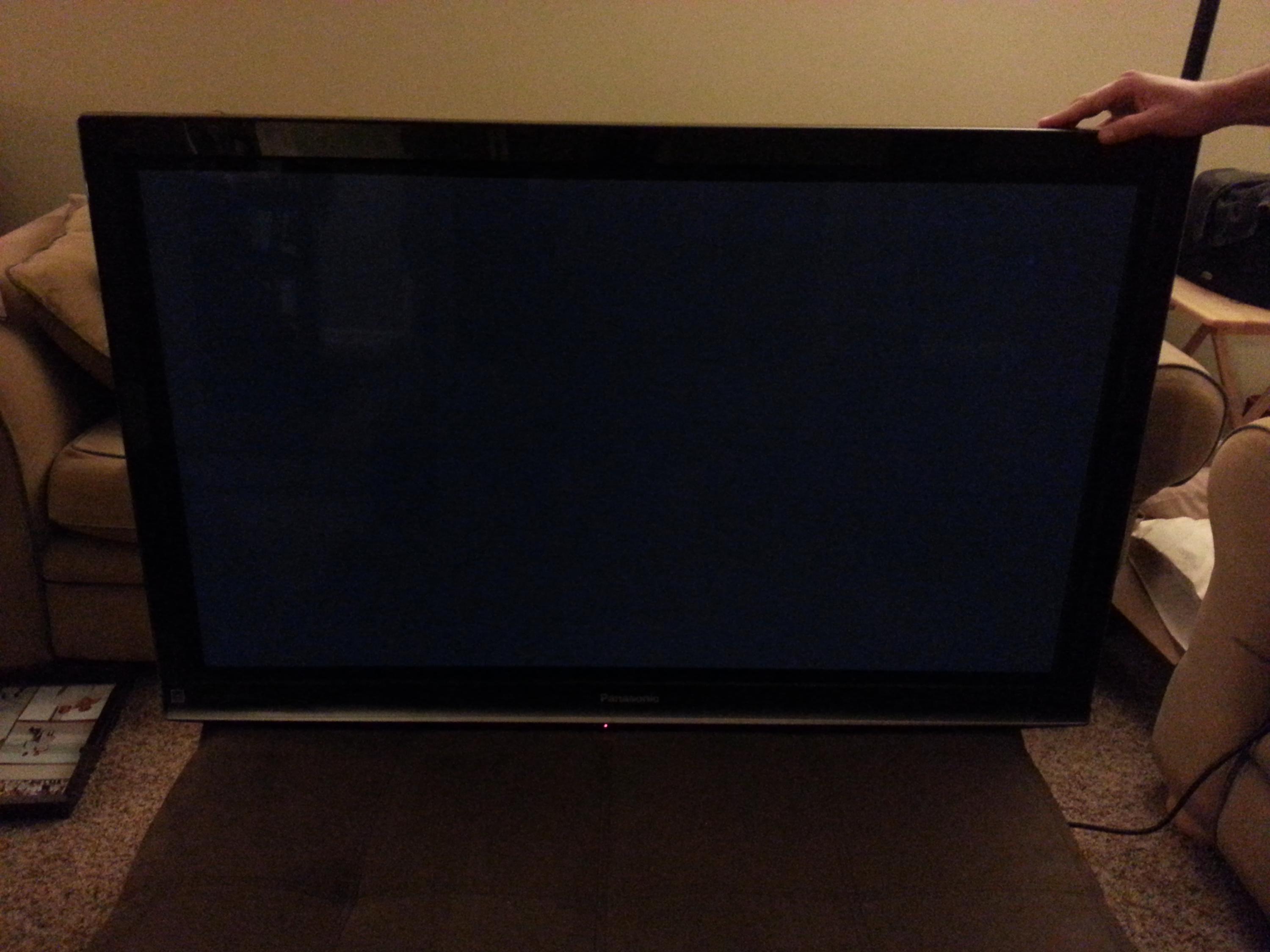

          Please find attached pictures of original 'A' board. I did not add pictures of the replacement board as no LED's on SS and SC boards lit up. Nor did the display light up, so there was not really anything to show. Note green LED's lit on SS and SC boards. Note also that the screen is dimly lit and the red power LED is lit. TV stays on until I hold the power button for a few seconds and it cuts off.

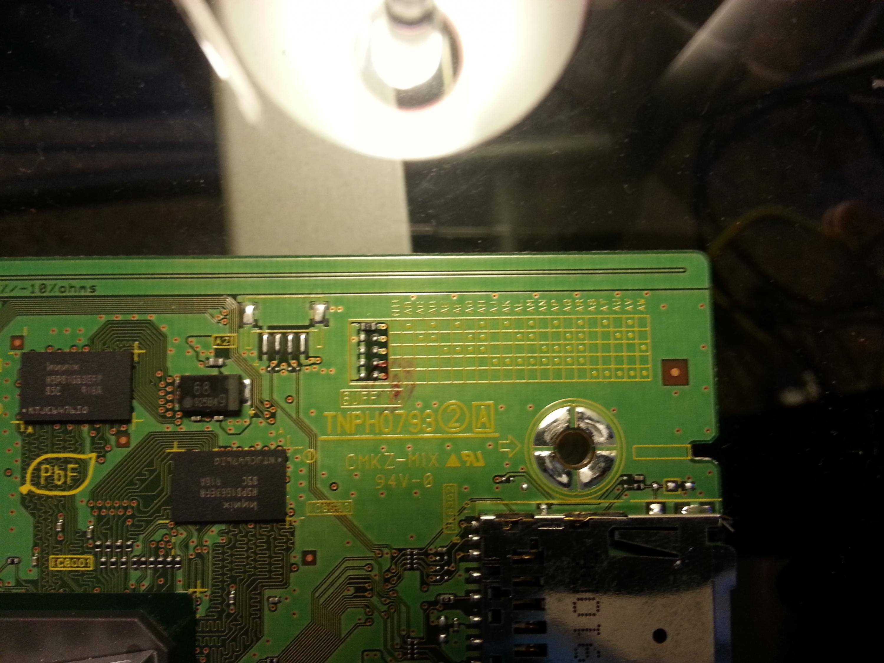

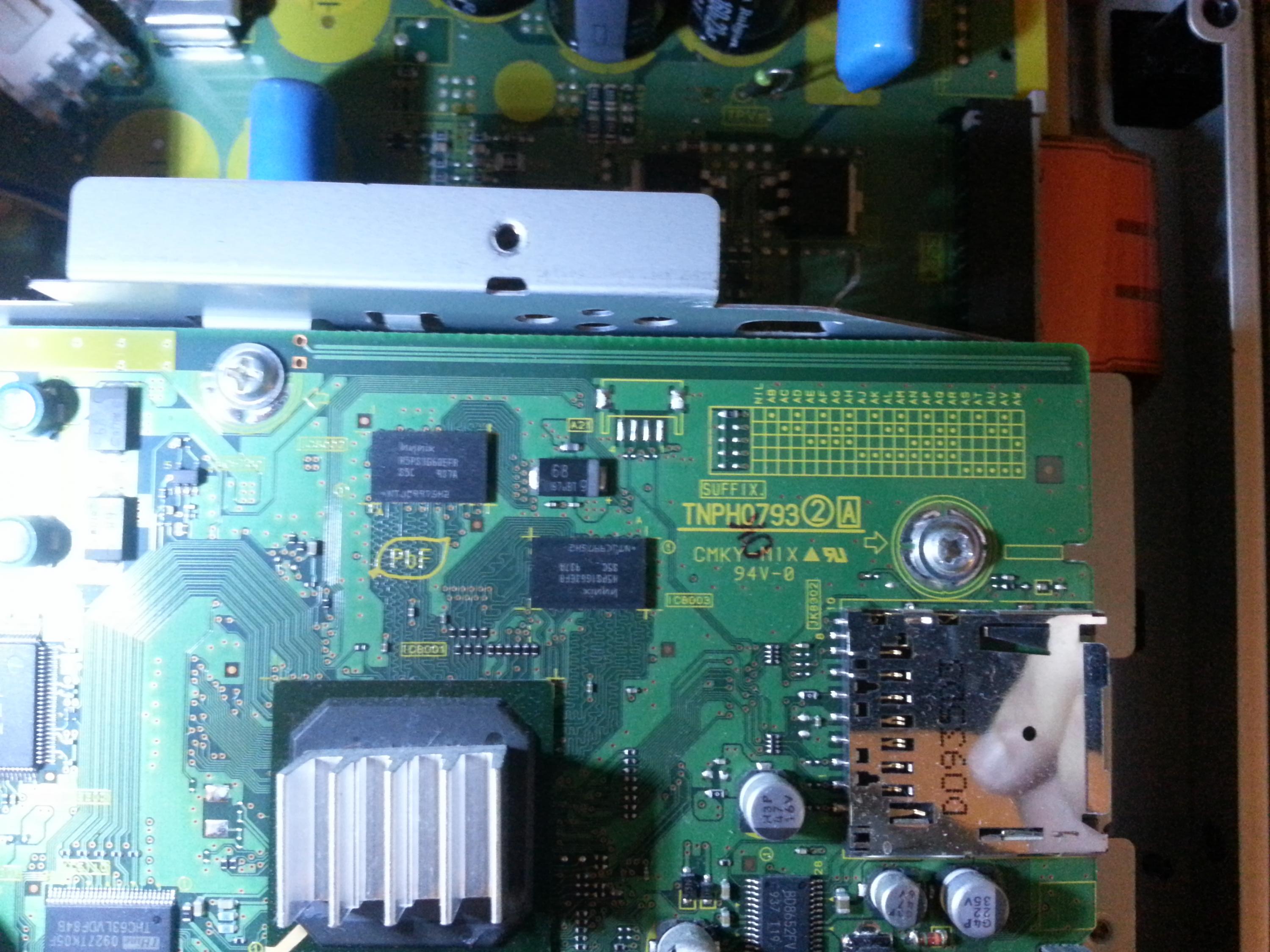

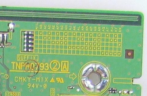

            TNPH07932A is the bare printed cct board assembly number.
            For yours, the A board is TNPH0793 AB. The suffix AB can be worked out by a series of jumpers just above the TNPH07932A print on the board.
            I think there's about 10 different revisions.

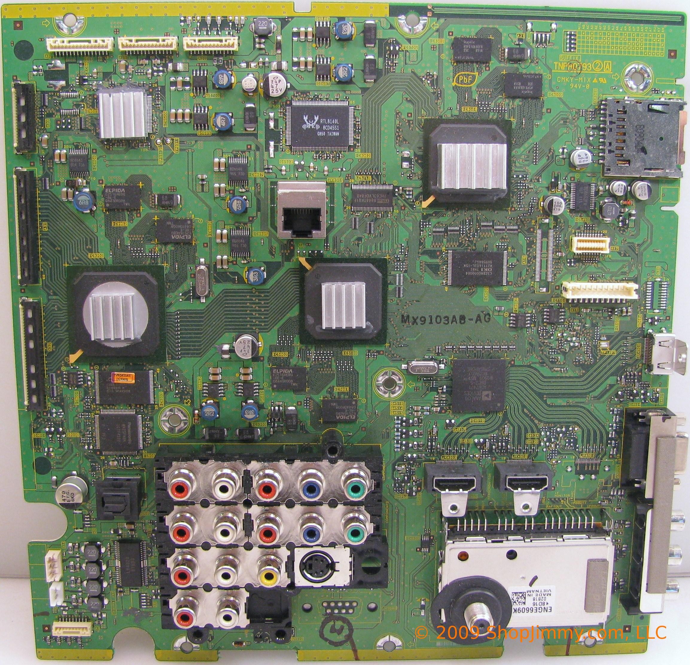

            http://www.shopjimmy.com/catalogsear...lt/?q=tnph0793
            I don't know if what you have is a complete dud board or simply not compatible.
            You might as well post a picture of the replacement.

              Looking at the little board with dots above the assembly number, both boards have the same pattern.
              I had directv connected through HDMI when the power went out for a few seconds. When it came back on, no picture and no sound. I am unable to change the inputs because nothing comes on the screen so I don't know how I can test anything but HDMI 1.

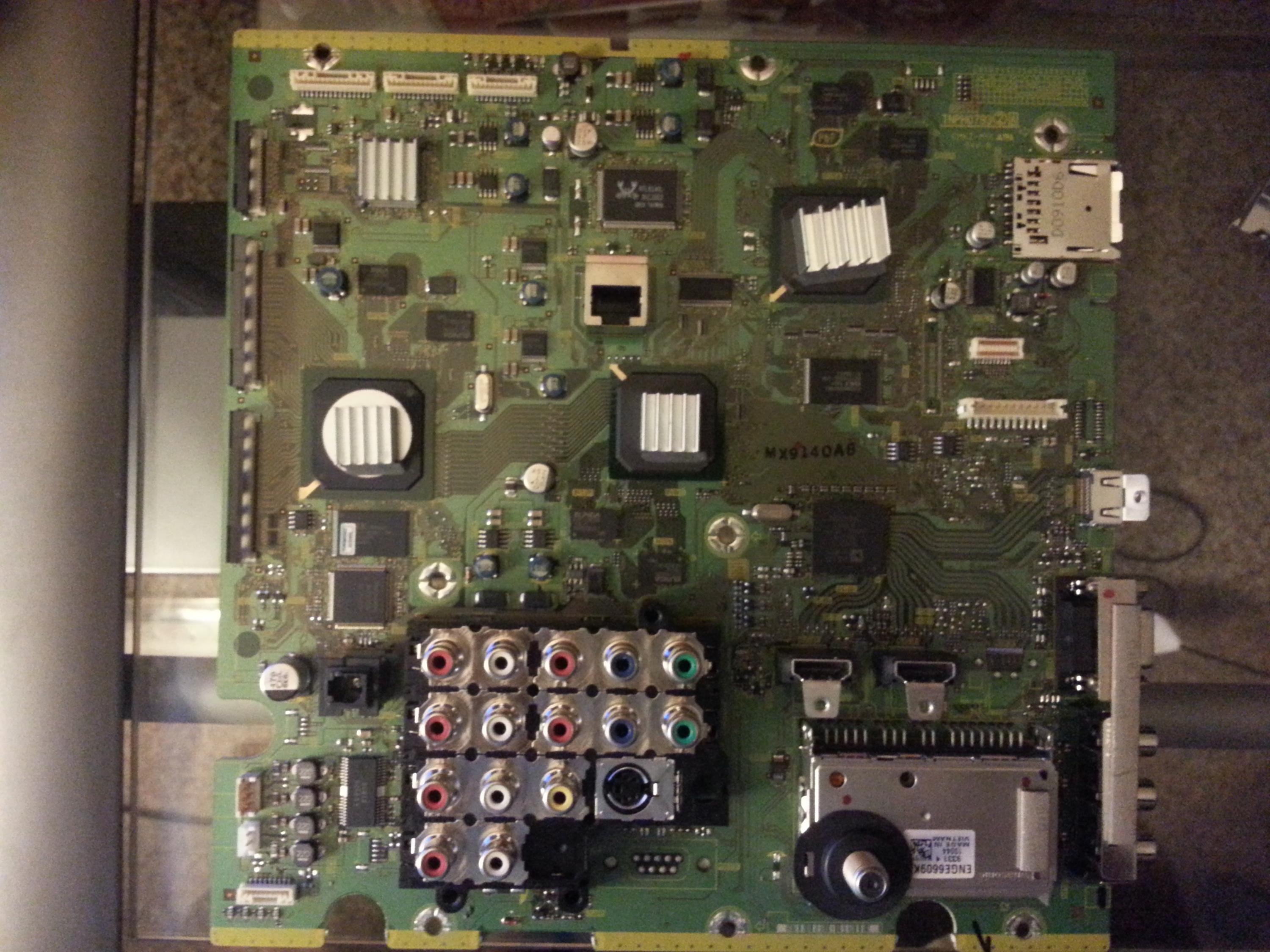

              I have attached a few pictures. The first and second are the "new" board and the third is the original board.

                I am getting another board as the only explanation I can come up with is that I got a dead one.

                    Received the replacement 'A' Board on Saturday and it fixed the issue. Thanks for all the help!
                    **SOLVED**
                    'A' board was bad. After replacing the 'A' board the Television is now working again.
