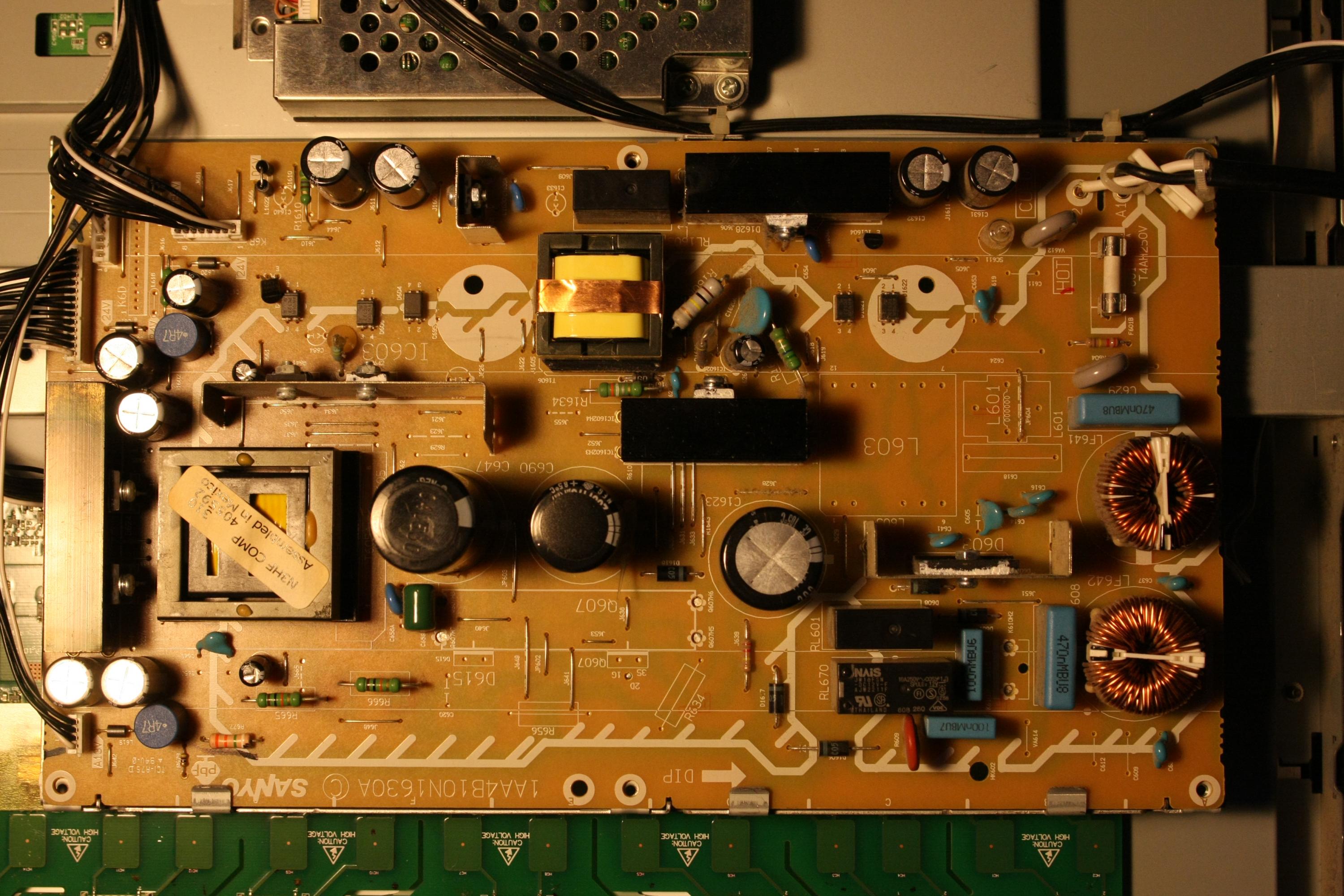

    So of course, I crack it open and don't find any blown caps. I thought maybe the two main [640?]uf/[250?]v caps on the PSU were bulging, but when I replaced those with some spares sitting around it didn't change anything.

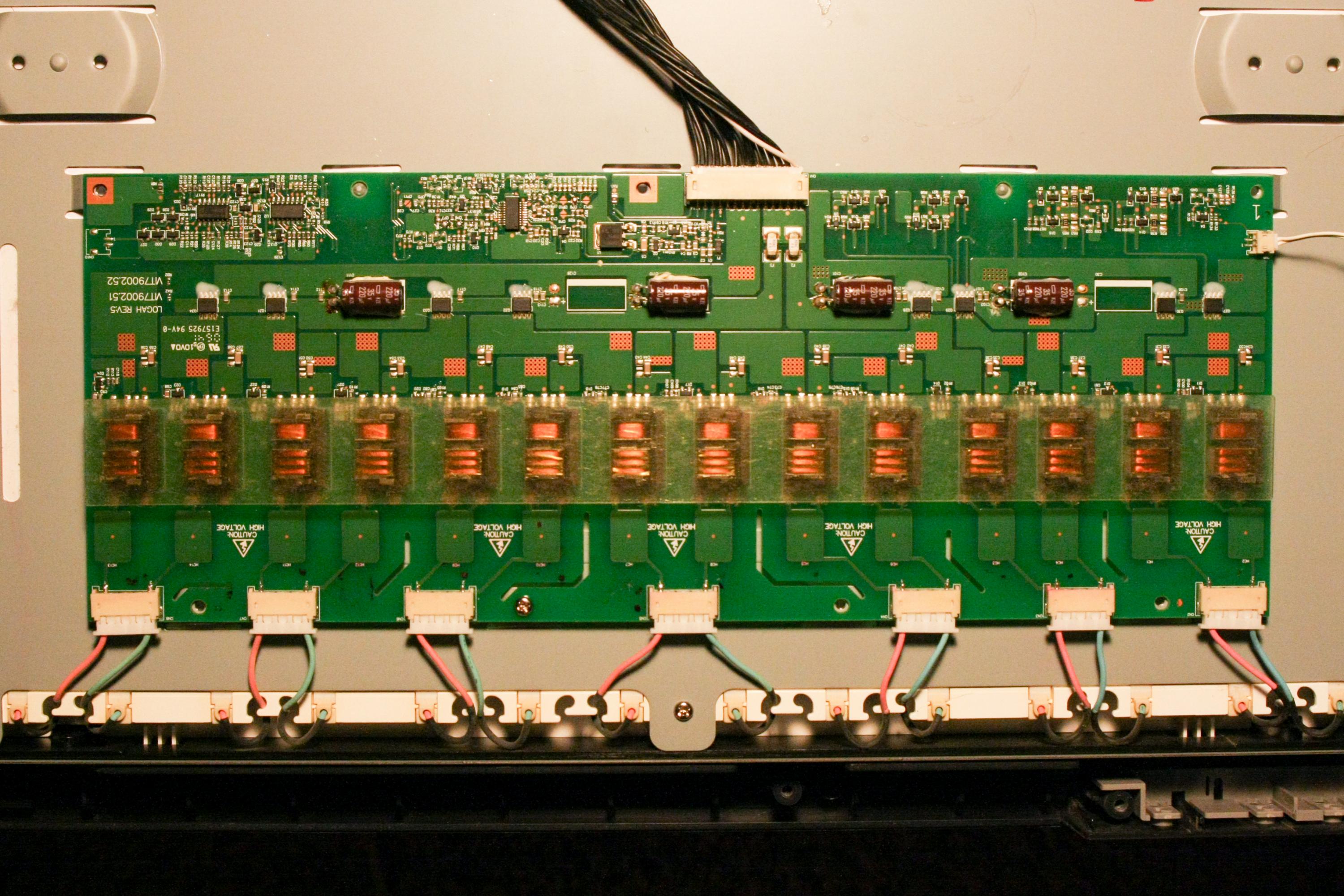

    I learn the inverter board has a couple of SM fuses. For the record, getting to the inverter requires some chassis deconstruction, which makes working on this one a huge pain in the rear in comparison to other more modern/streamlined models. Fuses check fine. There's 8 mosfets (but oddly... only 14 transformers/CCFLs? Weird. I didn't care enough to study the layout and figure out why they didn't just do 7 (1 mosfet for 2 transformers/ccfls), but whatever.

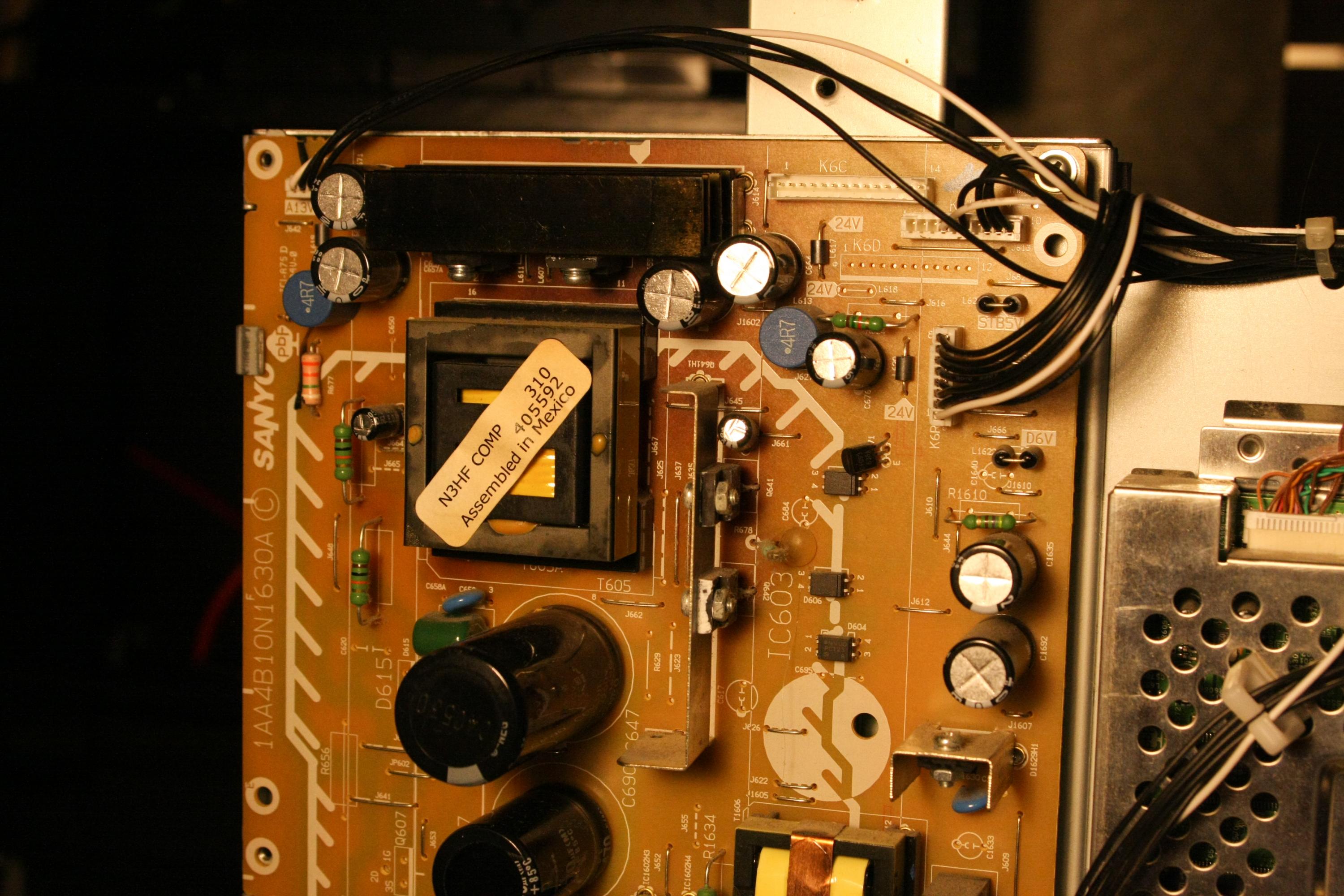

    Using the test points on the power board, (top left of picture)
    24v - 23.8v
    5v standby - 5.14v (sorry this one is behind the 8-pin cable)
    Then there's two more but they're weird?
    6v?-5.47v (very top, to left of leftmost capacitor)
    13v?-14.20v (very bottom left)
    It's not easy to see in this shot, but the pcb is actually a bit darker around the leftmost heatsink and transformer. Check the auxiliary shot and its pretty apparent.
    Also attached is the inverter board. Not a whole lot to see. It's a Logah Rev 5 VIT79002.51/VIT79002.52

              After a DOA inverter board from eBay, I did more testing (why didn't I do this before? I mentioned in the first post that I started doing this and totally flaked-out... I feel like a fool!). The transformer on the "dead" bulb's line was reading infinity on the output coil (if that's the correct term). Well. I swapped the allegedly dead coil with another on the same board and though the overall status didn't change the dark spot moved to that new position of the dead coil. Luckily for me the corresponding mosfet appears to check out fine.
