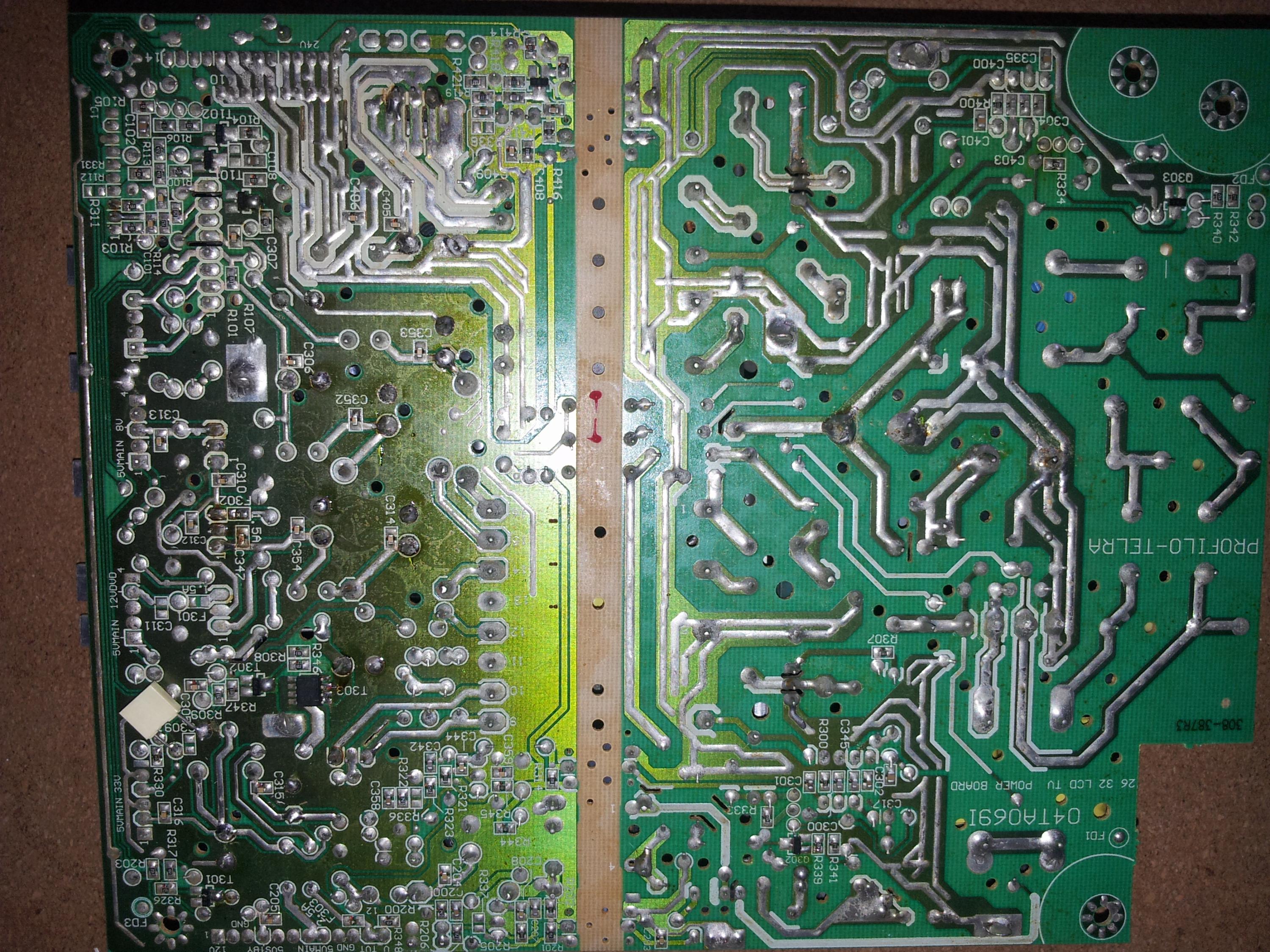

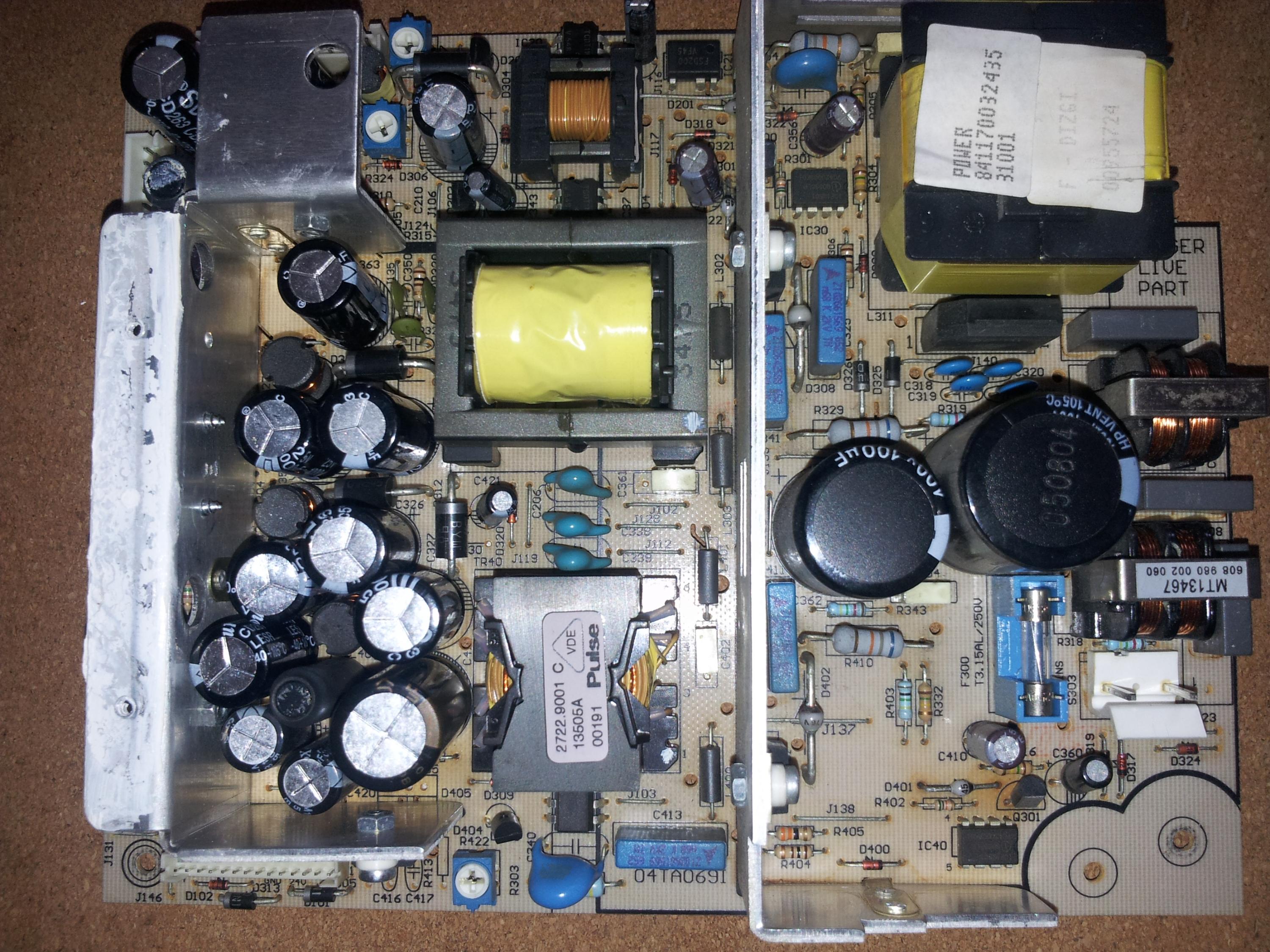

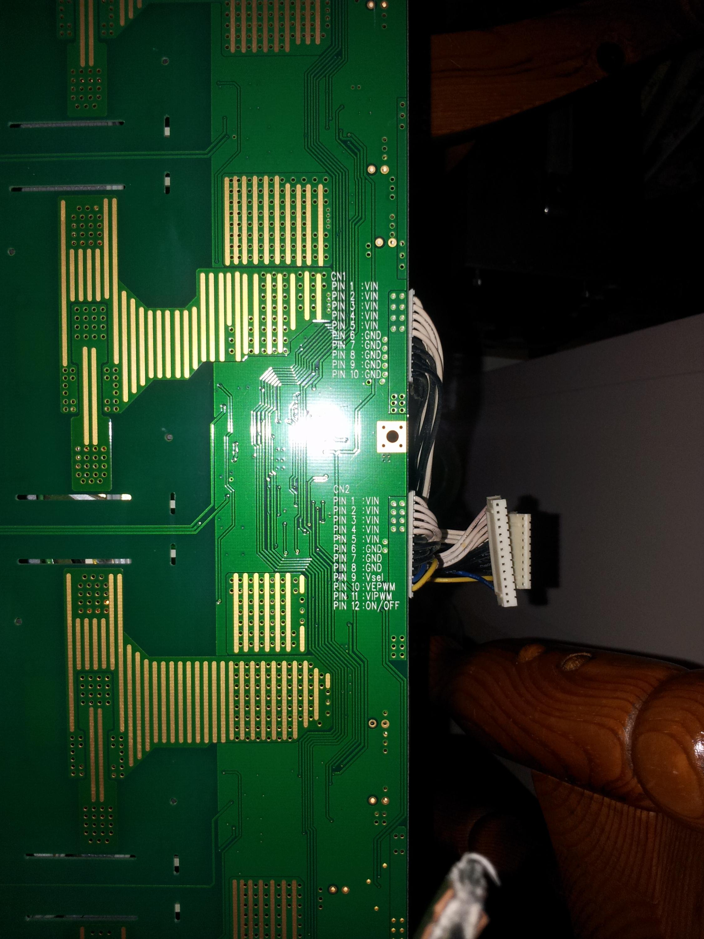

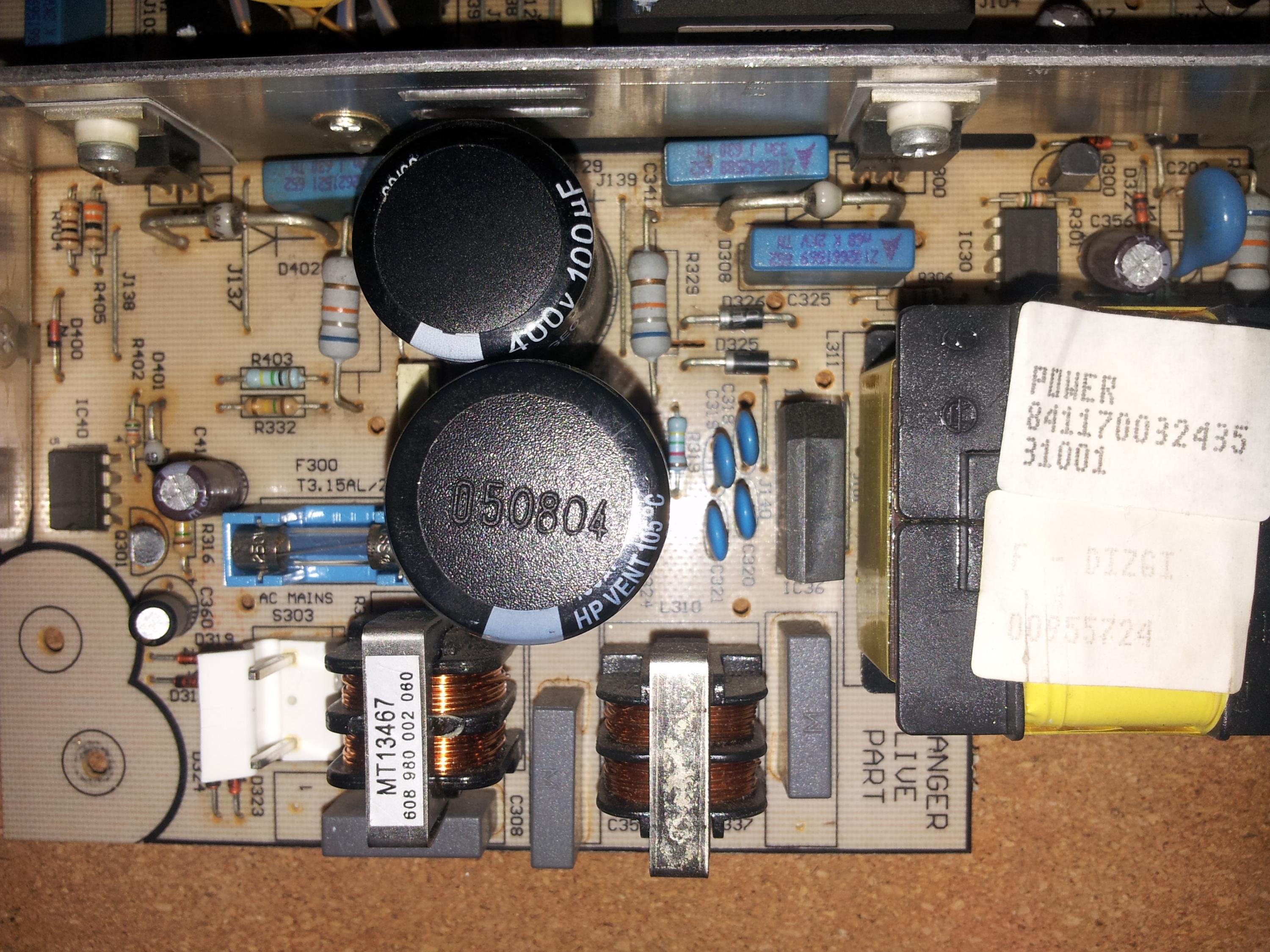

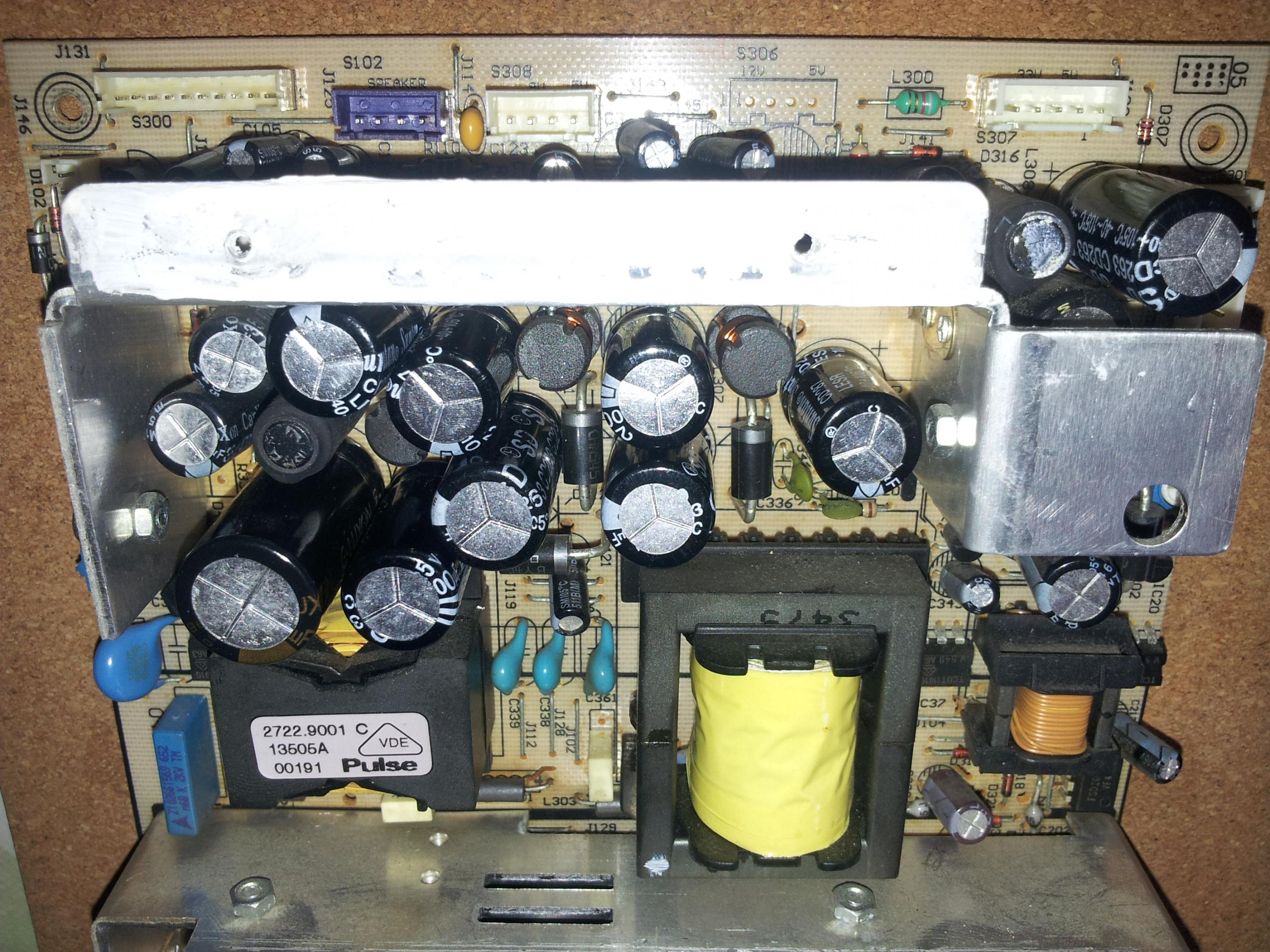

      Re: Bush LCD27TV006HD 2 secs to black
      Yes, sorry. It was getting late and just had to get some shut eye.
      Photos of PS b/d and inverter connectors
      There is about 4.1v on the inverter pin on/off, 24v on all Vin's but nothing on VSel, VEPWM, VIPWM.
      On the PS b/d there were some swollen caps so these have been replaced purely because they looked due to pop. 3 x 2200uF 25V and 1 x 16v and 4 x 1000uF 25v.
        Are those "SD" caps used as replacements?
        • notallbad
          • Oct 2012
          • 1190
          Erm, yes. Am I due a telling off?
          2200uF are SD
          1000uF are Suntan
            Yes. Rapid Electronics or eBay? They are not good caps. Completely unsuitable for SMPS... Example
            https://www.badcaps.net/forum/showthread.php?t=30085
            Panasonic FC, FM, FR are suitable and readily available on eBay and Farnell.

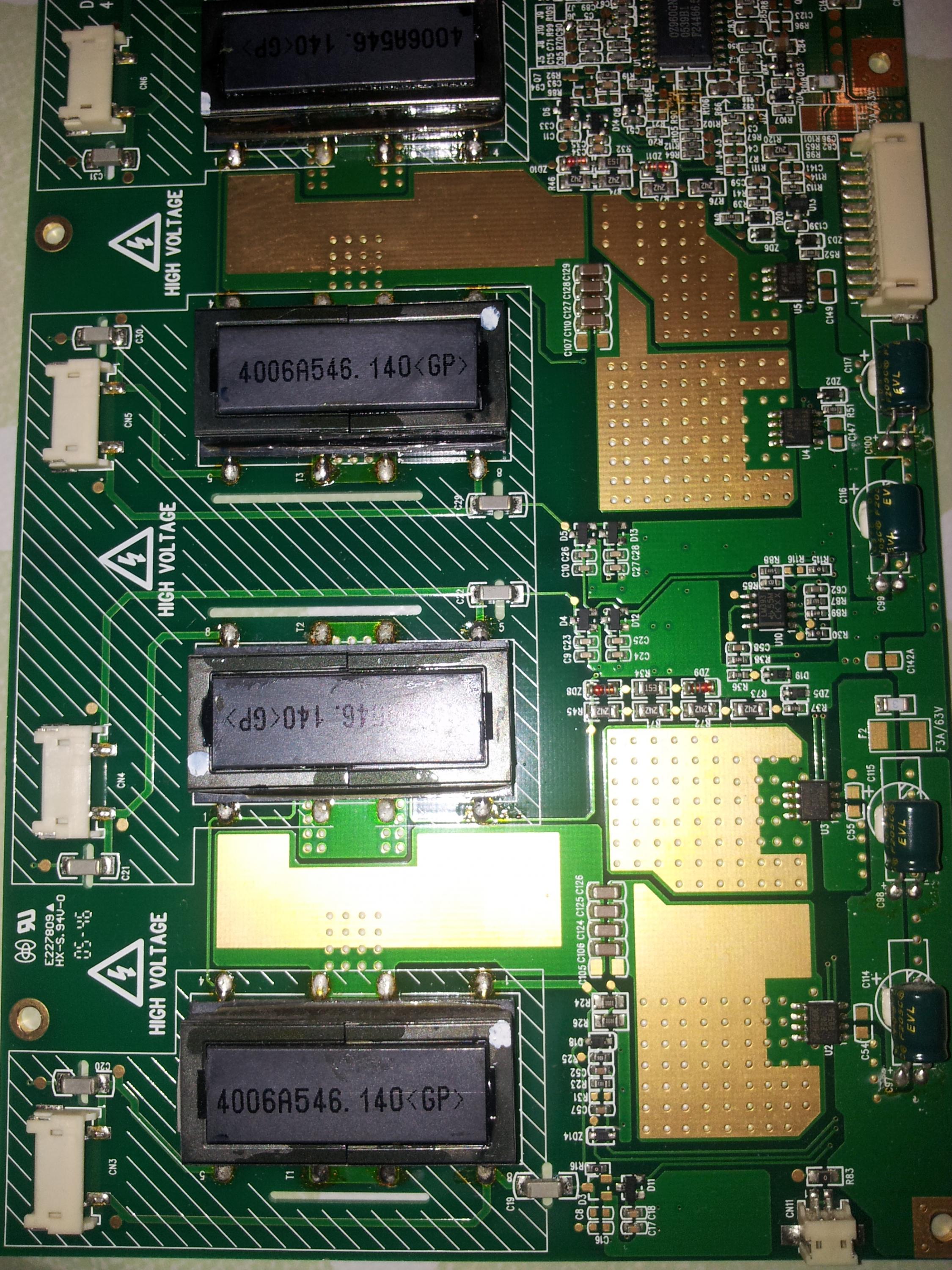

                      Looking at the inverter the 4 fuses appear to be good.
                      Need to check those trannys 4006A546 .140 for shorts.
                      Question, I have some other 4006A trannys (4006A419105), are they universal?

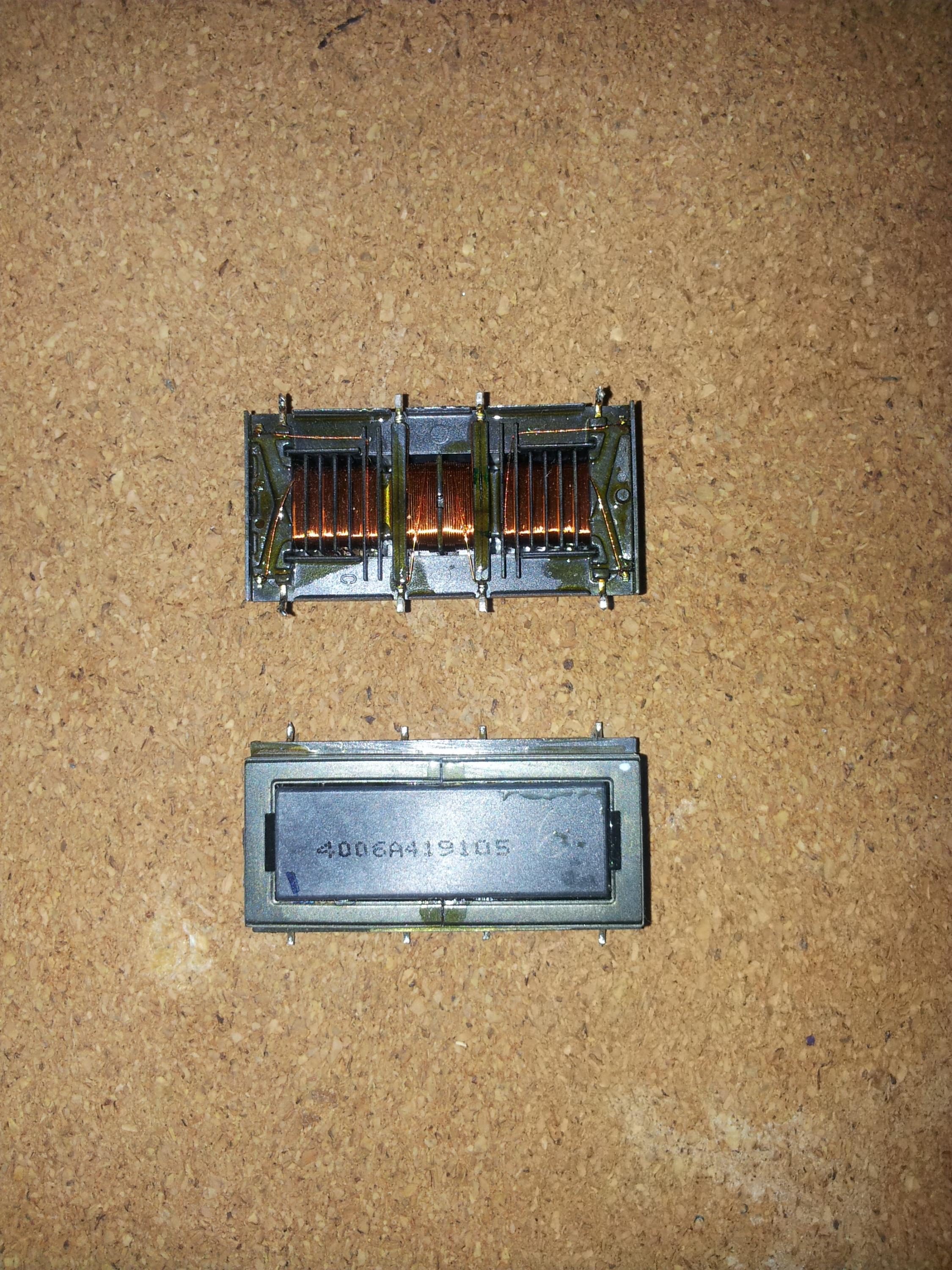

                              On the 4006A419105 trannys that I already have there appear to be 4 windings
                              All read about the following which is whats to be expected, around 950 ohm and 1.4 ohm:
                              Pin 1 to 8 - 962 ohm
                              Pin 2 to 7 - 1.3 ohm
                              Pin 3 to 6 - 1.3 ohm
                              Pin 4 to 5 - 969 ohm
                              Shall cross compare against the trannys from the board.
                                Looks like the 4006A546. 140 have the following readings:
                                Pin 1 to 8 - 954, 960, 955, 972, 964, 968, 958 ohm
                                Pin 2 to 7 - 1.4, 1.4, 1.4, 1.4, 1.4, 1.4, 1.4 ohm
                                Pin 3 to 6 - 1.4, 1.4, 1.4, 1.4, 1.4, 1.4, 1.4 ohm
                                Pin 4 to 5 - 956, 963, 958, 975, 967, 964, 958 ohm
                                The fourth, fifth and sixth ones look a little high.
                                Any thoughts?
                                  None look particularly bad, typically when they go wrong you get 2~5x reading.

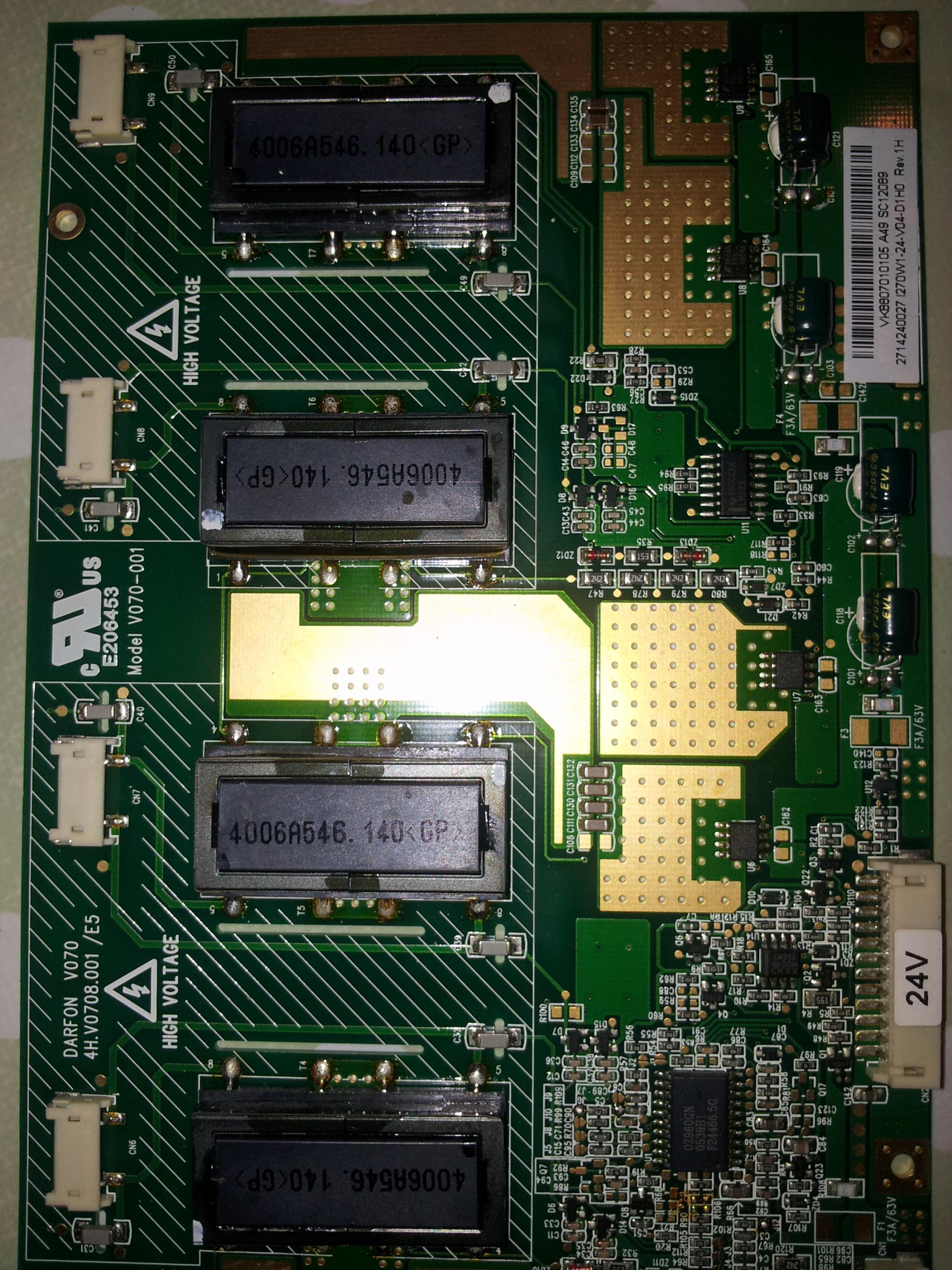

                                      Could be a bad bulb. Post a picture of the inverter and it may be possible to disable error detect so you don't have to take panel to pieces.
                                      • notallbad
                                        • Oct 2012
                                        • 1190
                                        Inverter b/d
                                        OZ960GN CCFL Inverter Controller
