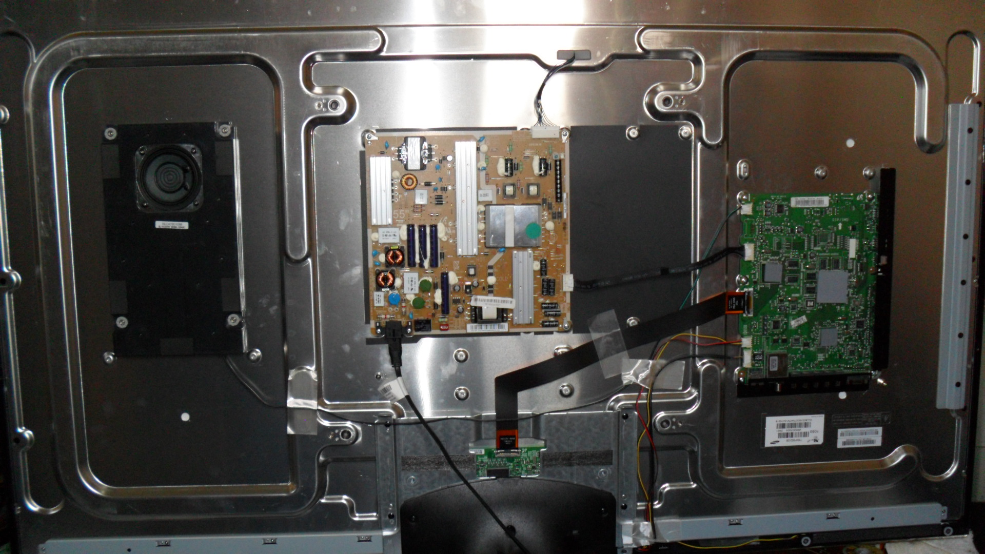

    Hello all, I got this set the other day and began checking it out.
    The guy I bought it from said he had the power supply replaced and then a month later it quit again , the repair center then said it was the main board.
    I found Toms schematic on the PSU and so far cannot isolate a fault condition. Tried disconnecting the Logic but it won,t click the relay.
    It continuosly cycles the relay on the PSU about once every 6 seconds Approx.
    The only full voltages are the 5.3 standby, 5 volt CS803 supply and the 385 volt CP801-804 CS802 complex DC at the top of the board. My best guess is this is used for the LED backlight arrays?
    The other voltages try to come up with a 3 pulse output but get shut off when the relay clicks in.
    All the fuses are good, can,t detect anything getting hot anywhere.
    Red power light on the front stays on all the time, No screen activity, and does nothing with remote.

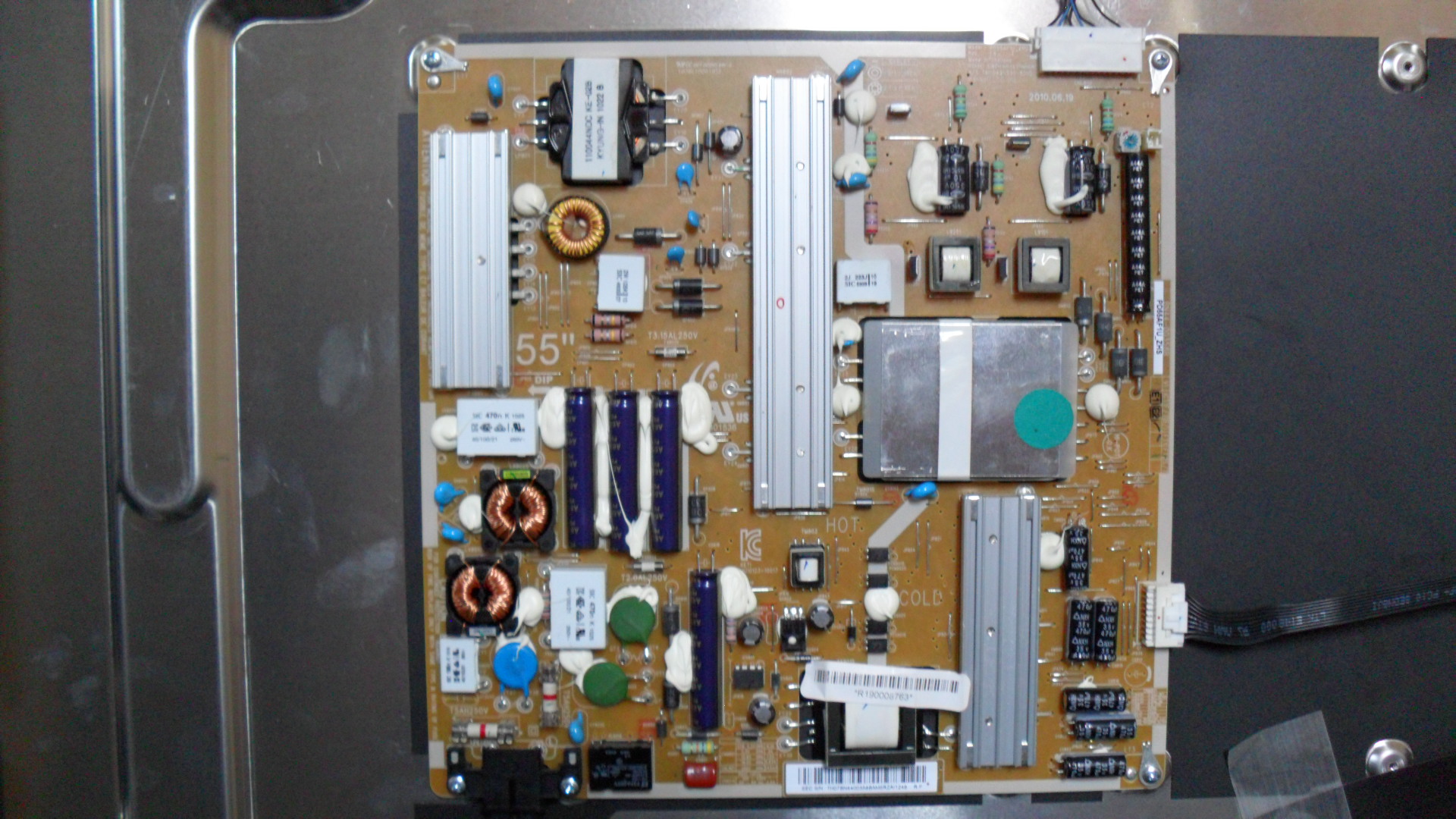

    Part # of PSU? BN44-xxxxxxx
    • dfergy54
      • Jun 2013
      • 57
      Re: Samsung UN55C6300SFXZA won,t power up
      Bn44-00358b

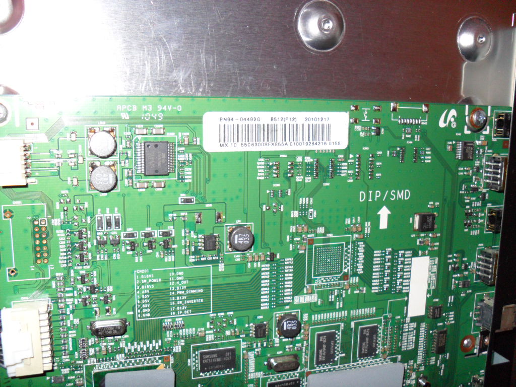

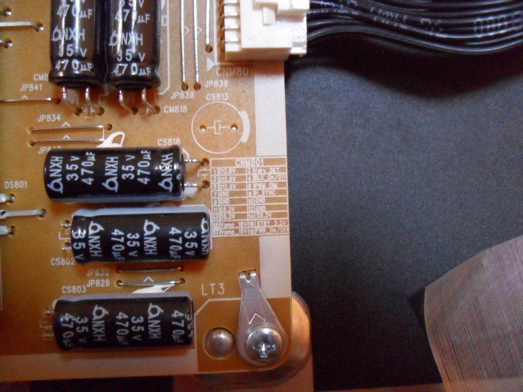

        OK pin 18 of CNM801 as power is cycling what do you measure?

              Pin 18 at psu board, pulses 3 times 25 MS ea at plus 3 volts, causing the relay to re energize and supply 120 volts to the primarys of the power supply for about 4 seconds.
              Then stays at gnd untill the next set of pulses to start the sequence again.

                        PSON should be pulled high to turn the set on, use a small resistor connected to the 5.2V standby.
                        You should get +18V, +12V and +5.3V coming up.
                        Then connect BLU ON/OFF and the backlight should turn on too.

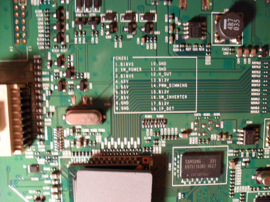

                          Did you mean Pwr_on/off Pin 18 on CNM801 from Main logic?

                            My 46C6300 was clicking too, PS_ON was changing states constantly.
                            I have removed the PS_ON wire from it's connector and I have measured it that way.
                            I have replaced the board with one of those semi empty boards from Ebay(3066R) and it's working fine. It's in my living room.

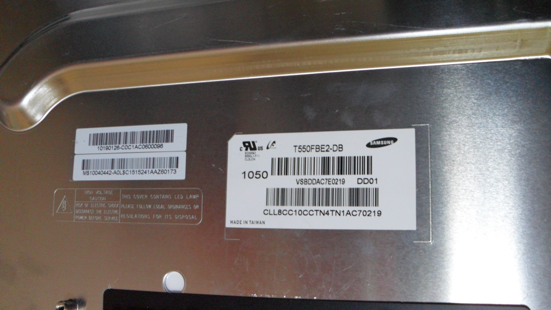

                                  You have to do your own research. You have to check which panel do you have and go from there.
                                  http://www.shopjimmy.com/catalogsear...pe]=Main+Board
                                  Yours is a bit different then mine. You will have different model number board.

                                    Pulled pin 18 out of connector and applied stby through a resistor to it.
                                    Pwr on/off then measured about 2.25 volts and relay stays engaged.
                                    However the plus 12 volts and plus 18 V amp do not come up. They pulse up to about 8 volts and come right back down.
                                    The chips that do the open,short,OVP and over current protection are on the bottom of the board and use the P Gnd which is approx -60 volts.
                                    I have checked all the components FETS Transisters , large resistors and can,t find a fault.
                                    Apparently one of those chips thinks something is out of spec and shuts down the circuits.
