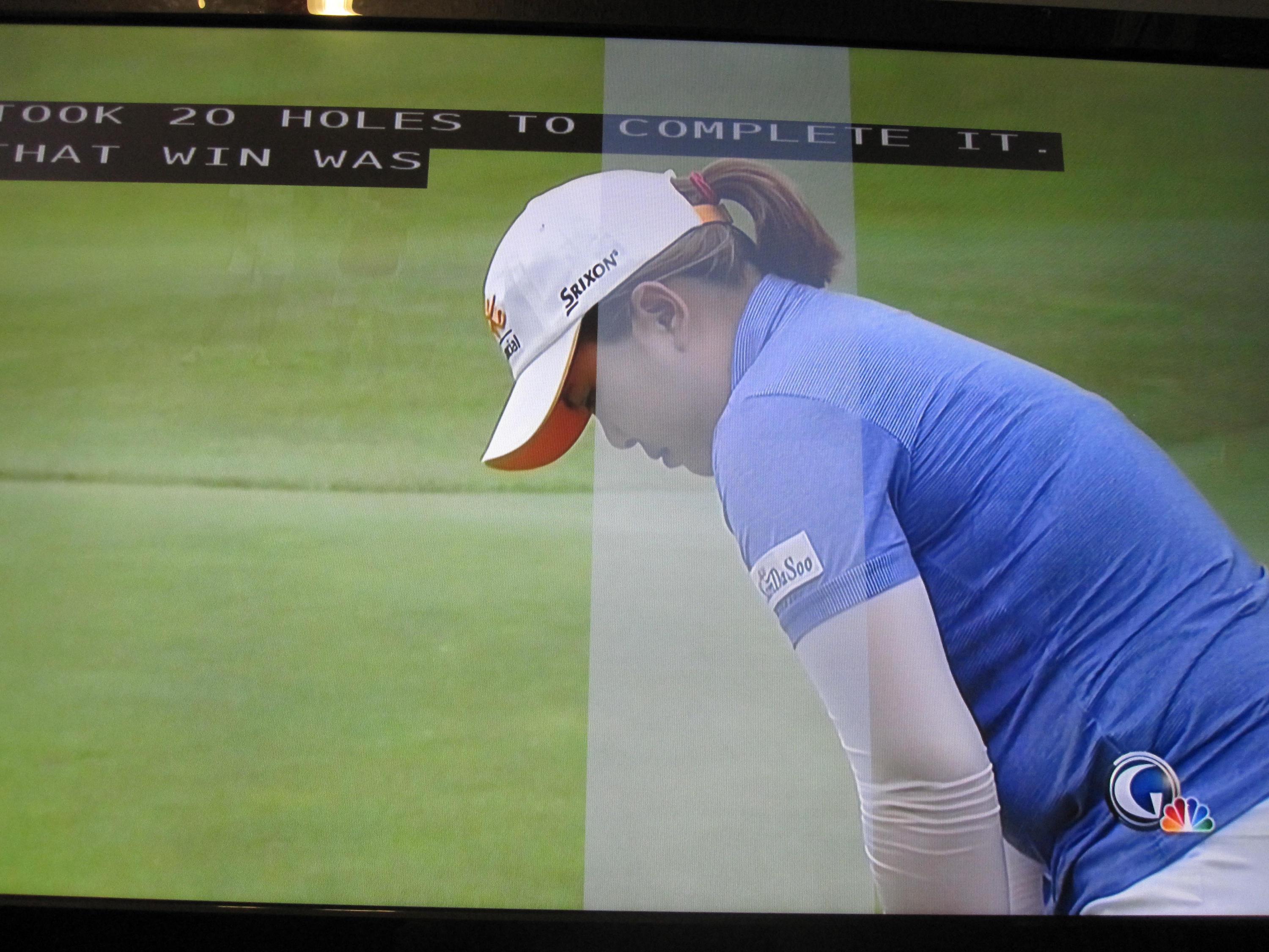

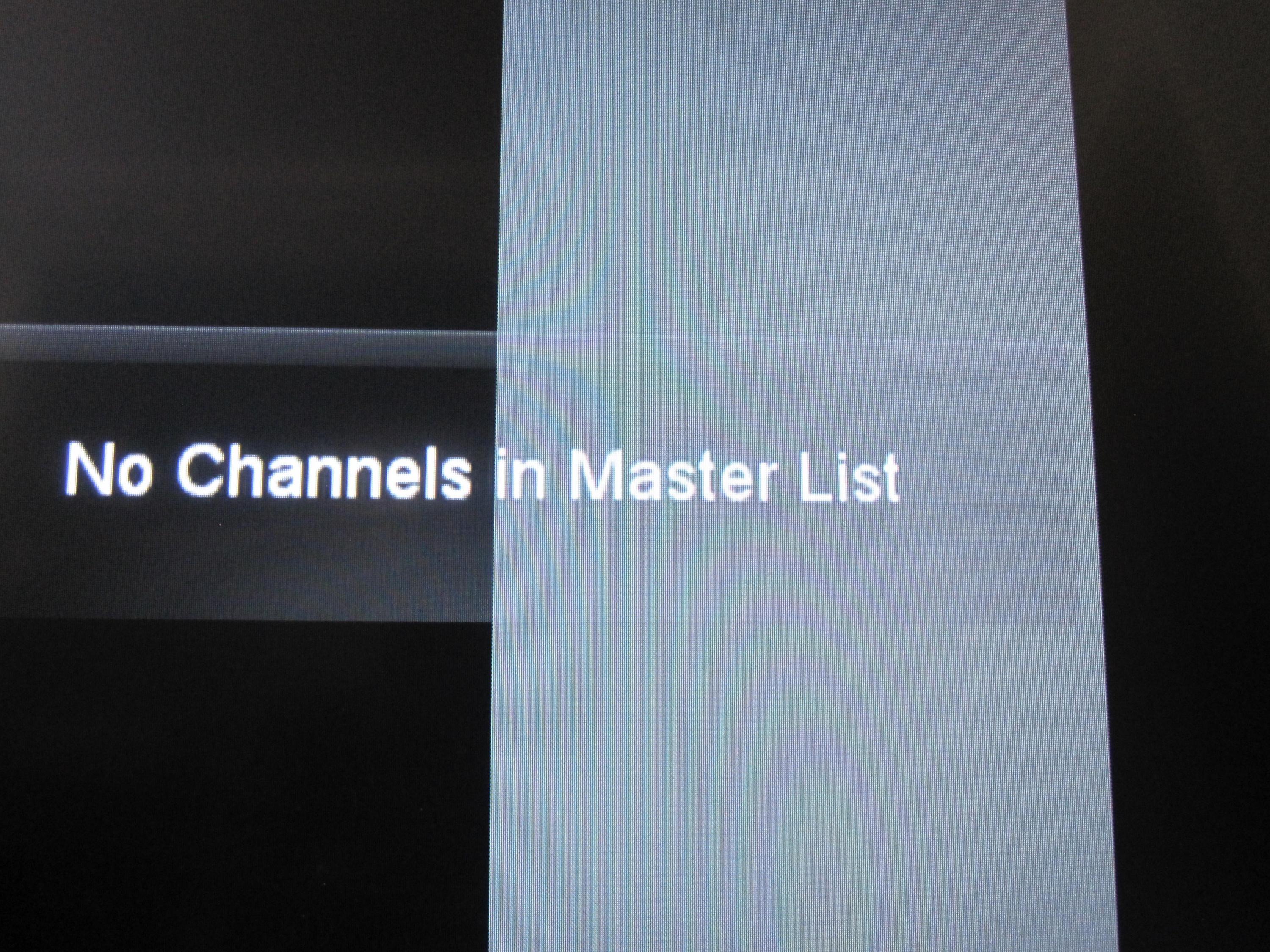

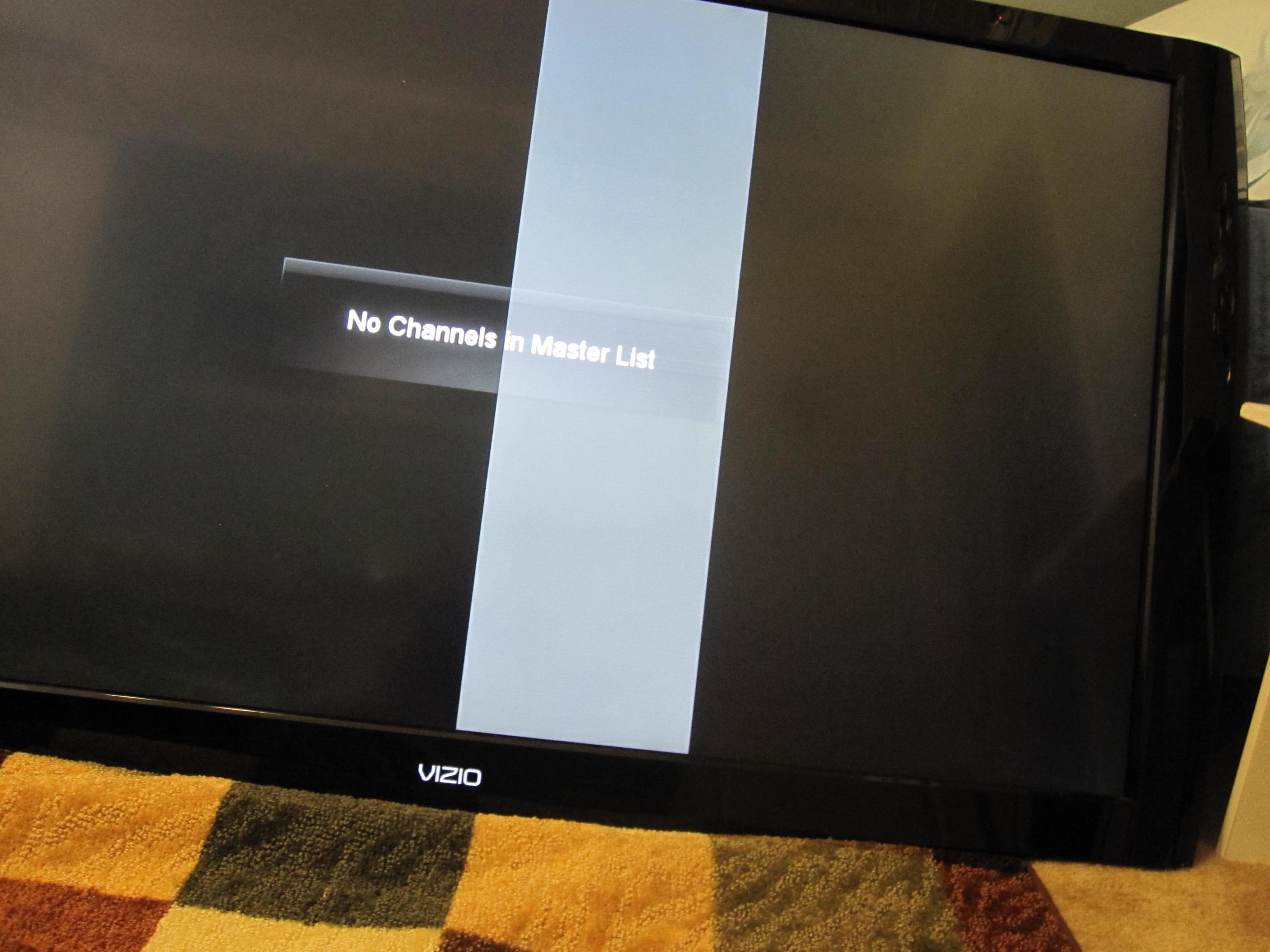

    Picked this up today cause it was cheap and I could sell the parts.
    It has a gray area but the menu letters look OK. Picture comes through but with a washed out look. Bad panel?
    Re: Vizio M550NV Line
    Probably water damage to that part of panel.

            Further work: I inspected the cable connections between the TCON and the panel. This panel has removable ribbon cables at both ends. They were cleaned with Deoxit. I then disconnected the cable from the affected side of the screen and got a perfectly white on that side. Reconnected the cable and disconnected the other cable and got the white screen there too.
            How do I get to test patterns on this set?
            I can get a TCON for $37 but everyone thinks the panel is bad and I dont want to waste money if there is no chance.Note? the TCON is on the bottom on this one.
              Swap the cables around, does the white area move?
              • truep
                • Aug 2010
                • 373
                No, I tried that first. also cleaned and reseated the LVDS cable.
                  99% panel then, very very unlikely to be t-con.

                    As usual, Tom66 was right! Got the panel out of the frame and found the area on the board corroded. As a last hope, I cleaned the corrosion off, but to no avail. Guess i'll strip it for parts. Such a shame.
                      Out of interest, top or bottom tab bonds?
                      • truep
                        • Aug 2010
                        • 373
                        The tab bonds looked good, the corrosion was on the board. Just because they "look" good doesn't mean much though. Pressing on either the top or bottom bond had no effect.
                        • truep
                          • Aug 2010
                          • 373
                          The tabs were at the bottom of the screen.
                            Bottom bonds are vulnerable to water damage, that's why I was asking. Spill a drink on your LED LCD, good bye TV!!
