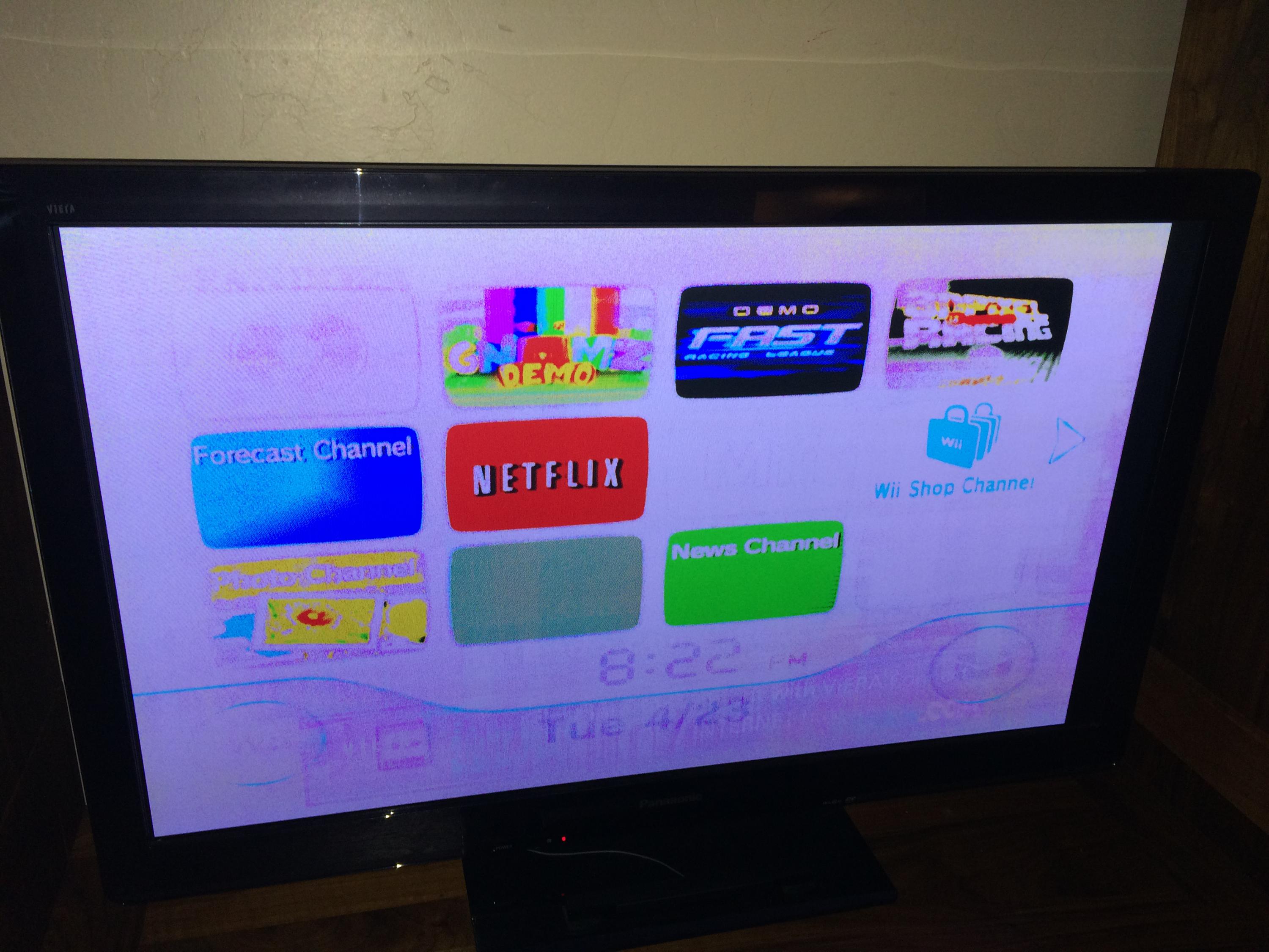

                              First off, thanks to everyone here that posted. It really helped me.
                              I inherited a non-working TC-P42S30 (it was working great and then just shut off). The original owner tried replacing the power board then gave up and gave it to me. I tried replacing the motherboard. After that didn't work, I did what I should have done in the first place and looked for actual troubleshooting info. After reading this forum, I checked SN2 and found it was shorted. Then I checked the 30F131 IGBTs and found 4 of the 6 shorted. I removed these shorted parts and checked SN2 again. Now it didn't measure shorted. None of the diodes appeared shorted so I replaced just these 4 with p/n FGD4536TM from Mouser.
                              Powered it up and ... got a picture! But I'm still not completely out of the woods. Now, it has a poor picture - sort of a pinkish hue and some ghosting of previous images since it was powered up. Any ideas of what I can check next? A Panasonic Plasma troubleshooting guide that someone recommended shows an image described as "abnormal electric discharge" that looks a lot like what I'm seeing. It suggests the SC/SS board as a possible culprit. I think the parts I just replaced were on what it labels for this model as the SN board. Any ideas anyone? I'll make sure to post back anything I find to help others that will have my same problem.
                                #35
                                Re: Panasonic TC-P42S30
                                Can we have a picture of what that looks like? If it has a pink tinge, my immediate checkpoint is to verify VSUS against panel sticker. Low VSUS voltage, especially if power board has been swapped (it is different for each panel), can cause pink tinge.
                                    I've attached an image. You can see the Viera menu in the background (the "ghosting" I was referring to).
                                    How do you know where to set VSUS? How is it adjusted?

                                      ... and could the wrong VSUS cause the ghosting as well?
                                      The good news is it looks like there are some things to try. Looking forward to hearing how the VSUS adjustment goes. I found some other references online to adjusting VSUS, turning the trimpot to change the VSUS voltage up or down until the blacks get solid black. Sound right?

                                        Hmm, that is not low VSUS. I have a project 37" plasma here (Panasonic, 2005 gen, 720p) and I tried various voltage adjustments, to see what happened:
                                        - low VSUS: image retention, pink in middle, some pixels not lighting, 6 blinks code eventually
                                        - high VSUS: odd sparkling pixels, increased sound from display (buzz noise louder)
                                        - low VE: image retention, some pixels taking time to discharge or time to reignite
                                        - high VE: no noticeable difference
                                        - low -VAD: some pixels not lighting, poor diffusion, 7 blinks code
                                        - high -VAD: no noticeable difference, 7 blinks code
                                        I would check -VAD in your instance, and VE, though VE is less likely, it is on the SS board.
