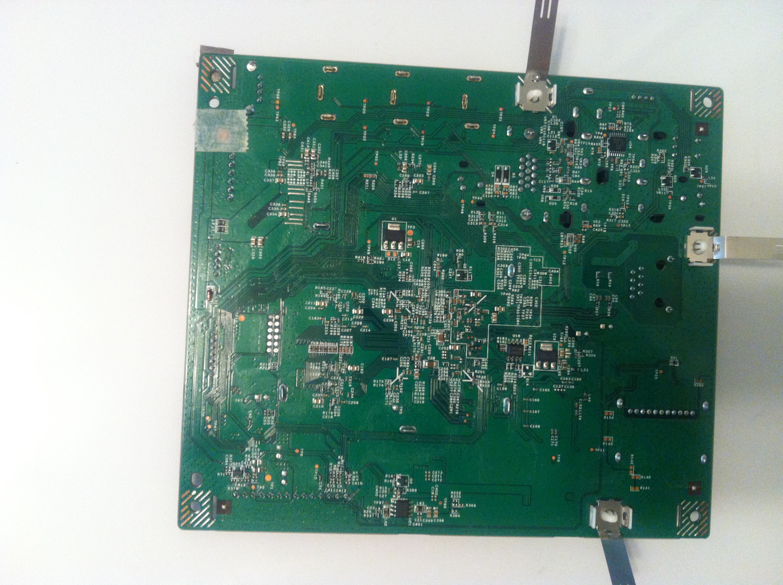

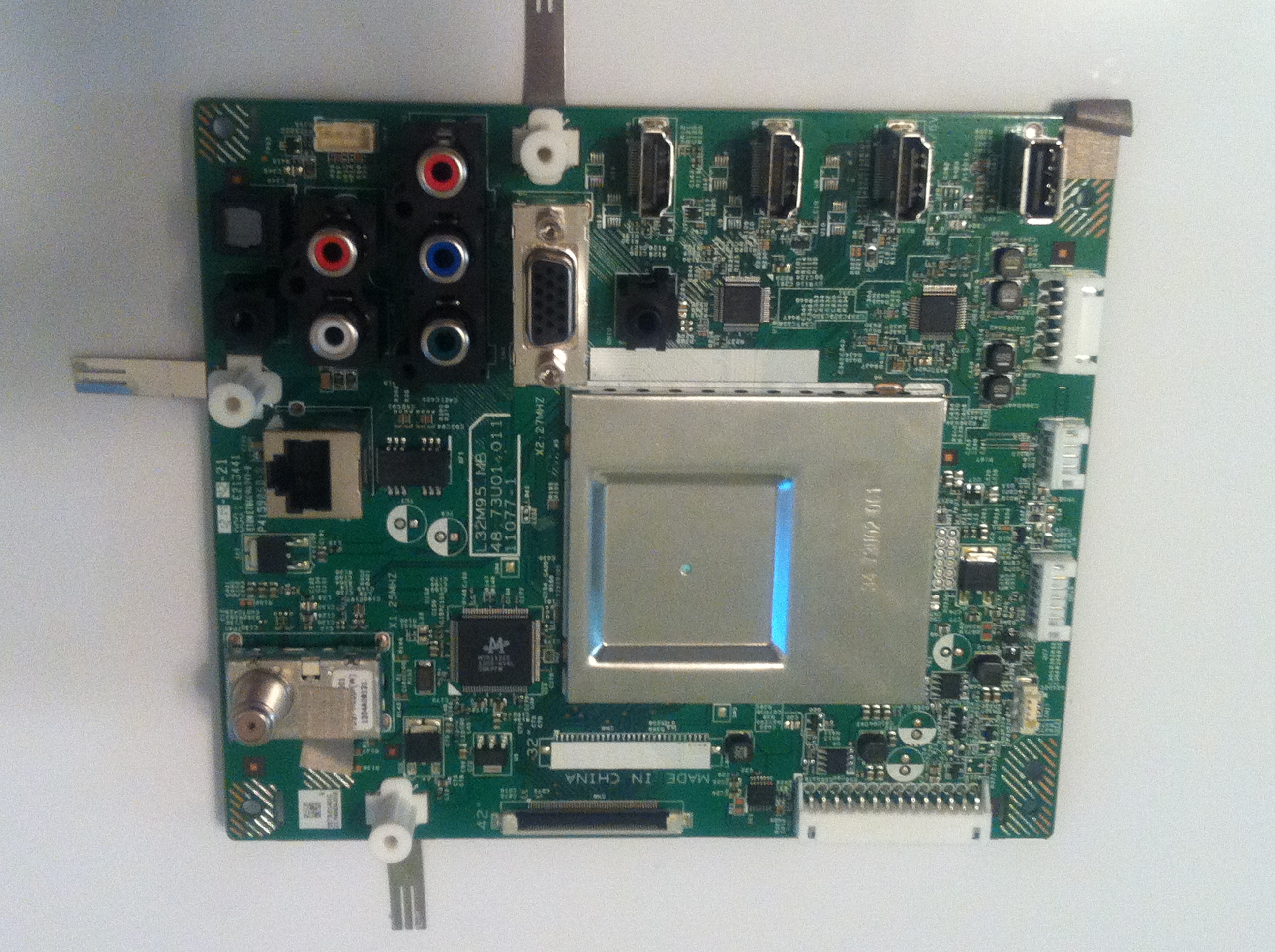

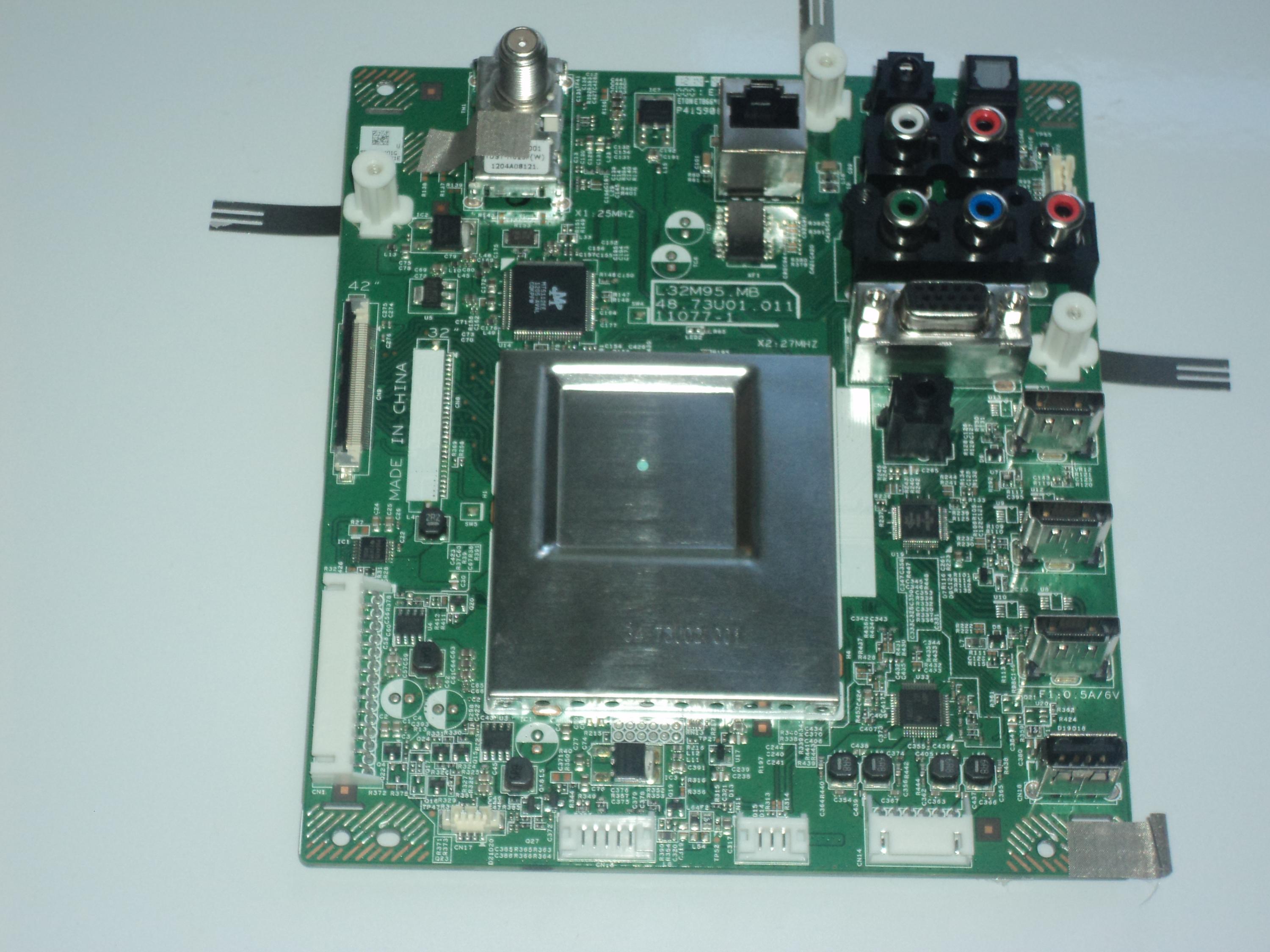

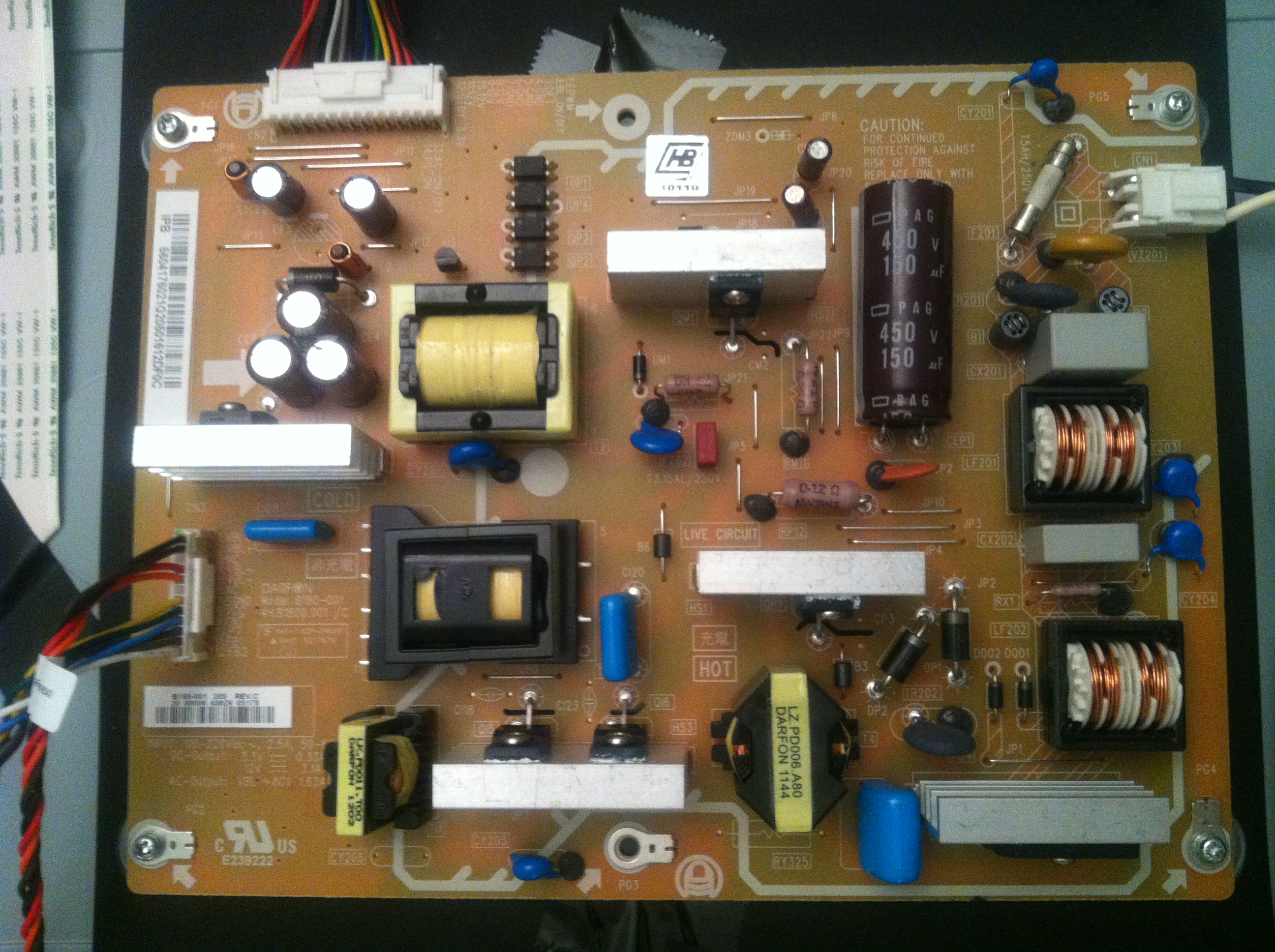

    I have a VIZIO E422AR with no power, no logo light. Totally dead the power board tested good.

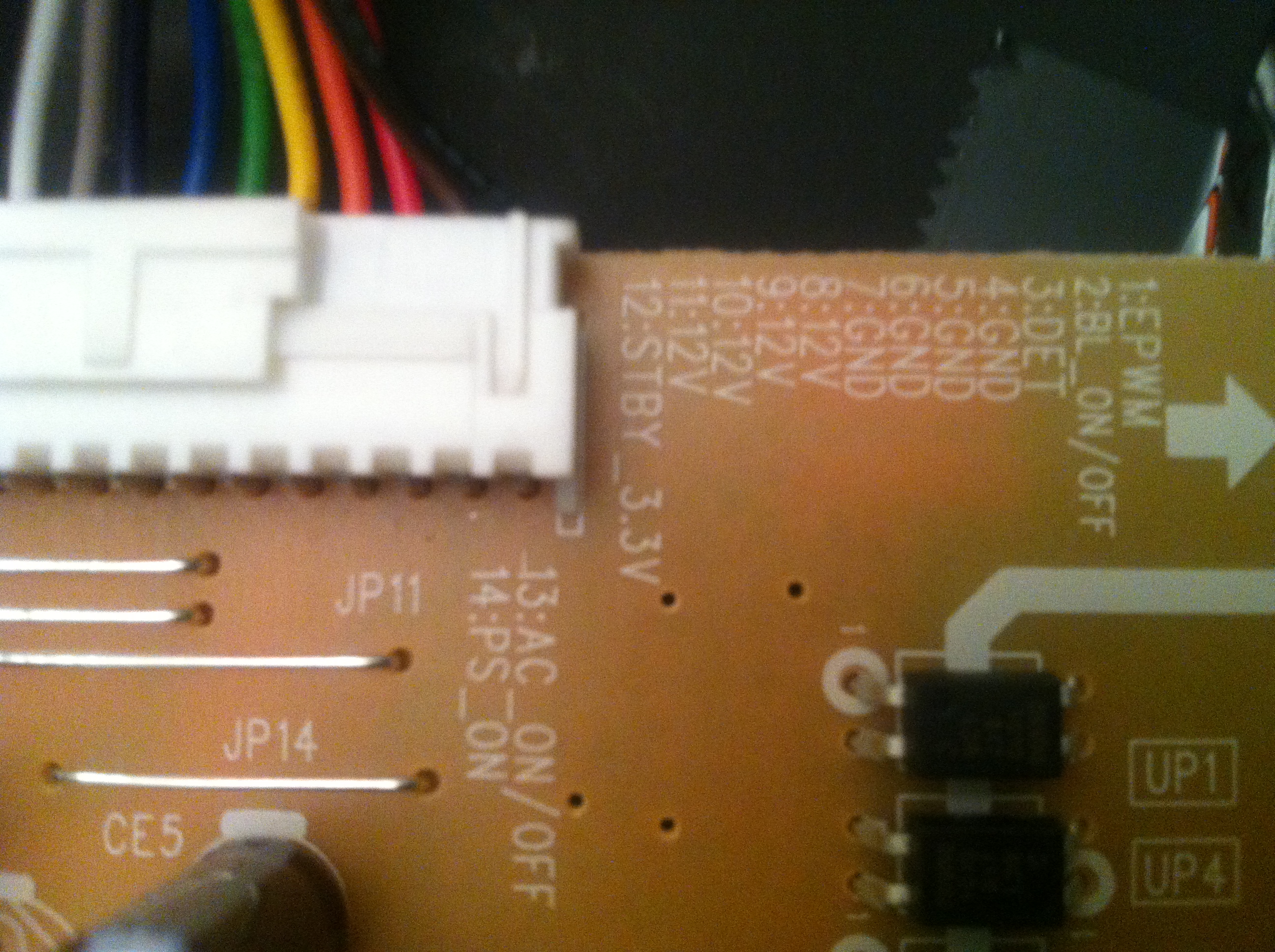

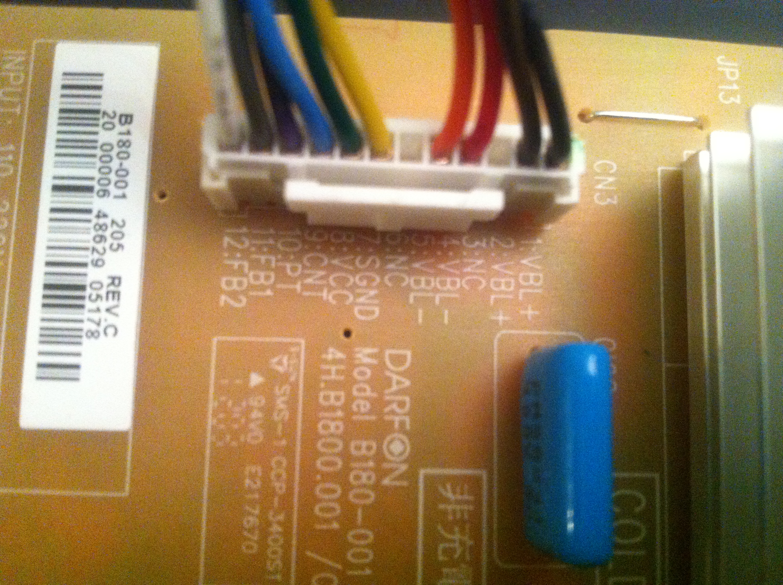

      "Totally dead the power board tested good." Can you please clarify the voltage readings for us? Pictures of the boards?

        Here is my photos the power board 4H.B1800.001/C has all 12v present and 3.292v
        main board gets really hot L32M95.MB 48.73401.011
        IC#7 LD1117AG
        tab 3.326
        pin1 0.010
        pin2 5.060
        IC#2 LD1117AG
        tab 3.306
        pin1 0.009
        pin2 5.060
        U5 LD1117AG
        pin1 0.004
        pin2 1.197
        pin3 3.304
        IC#3 LD1117AG
        tab 2.118
        pin1 0.010
        IC#6 LD1117A
        pin1 0.007
        pin2 3.302
        pin3 5.065
        U1 LD1117A
        pin1 0.007
        pin2 3.302
        pin3 5.065
        • retiredcaps
          • Apr 2010
          • 9271
          Re: Vizio e422ar
          Originally posted by 24V
          IC#3 LD1117AG
          tab 2.118
          pin1 0.010
          There sees to be a pin reading missing above? Also, please confirm readings.
