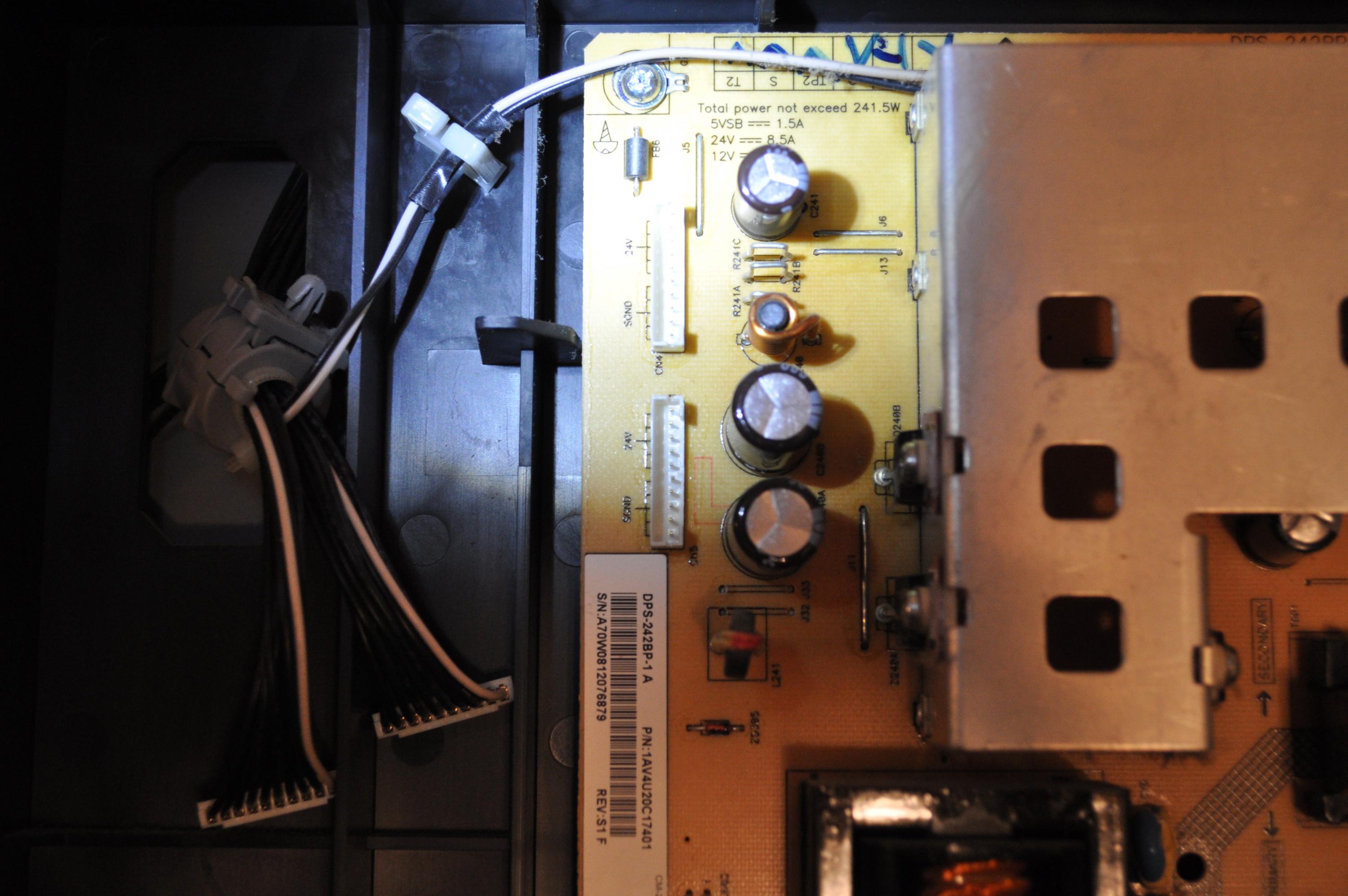

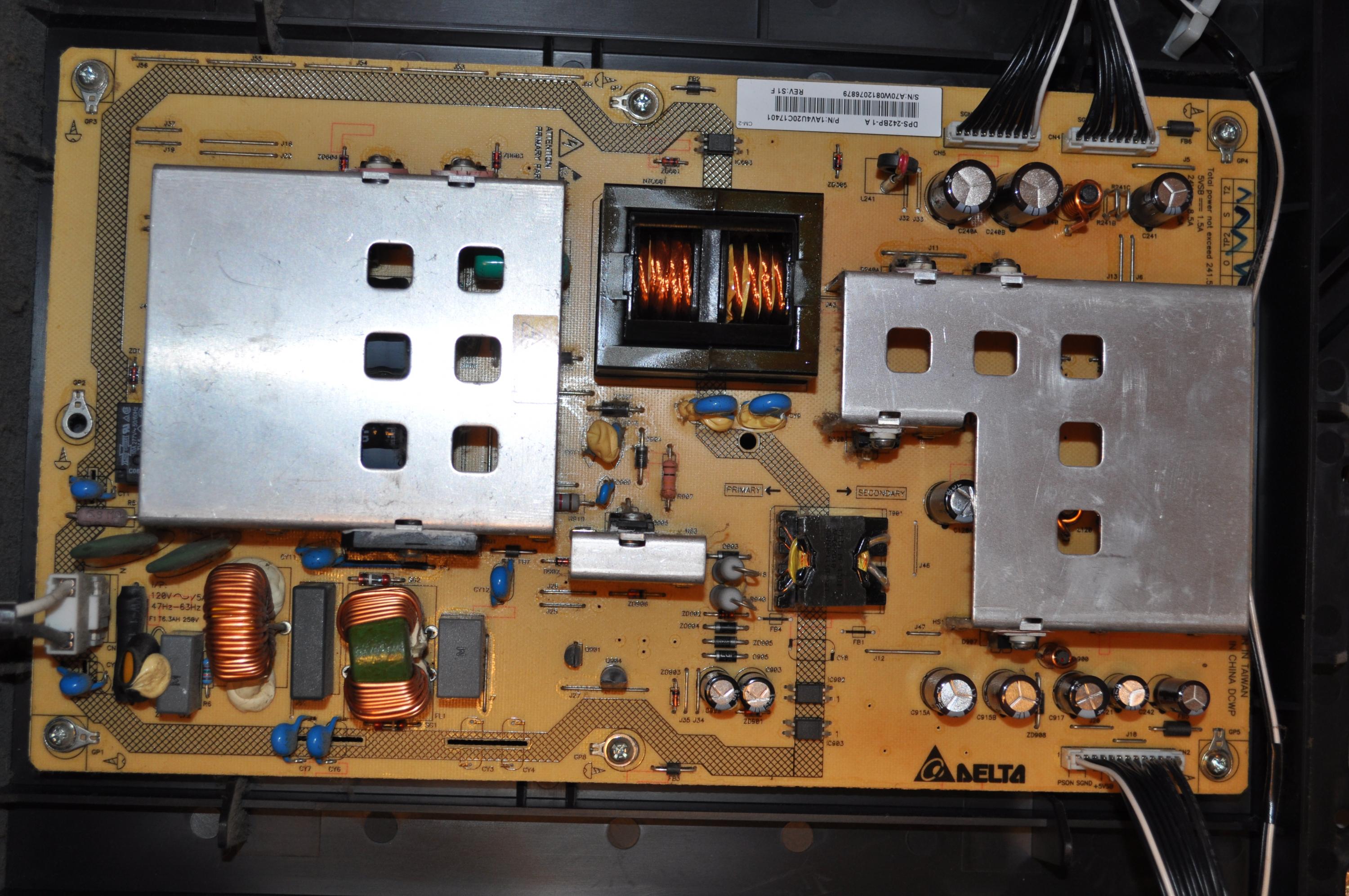

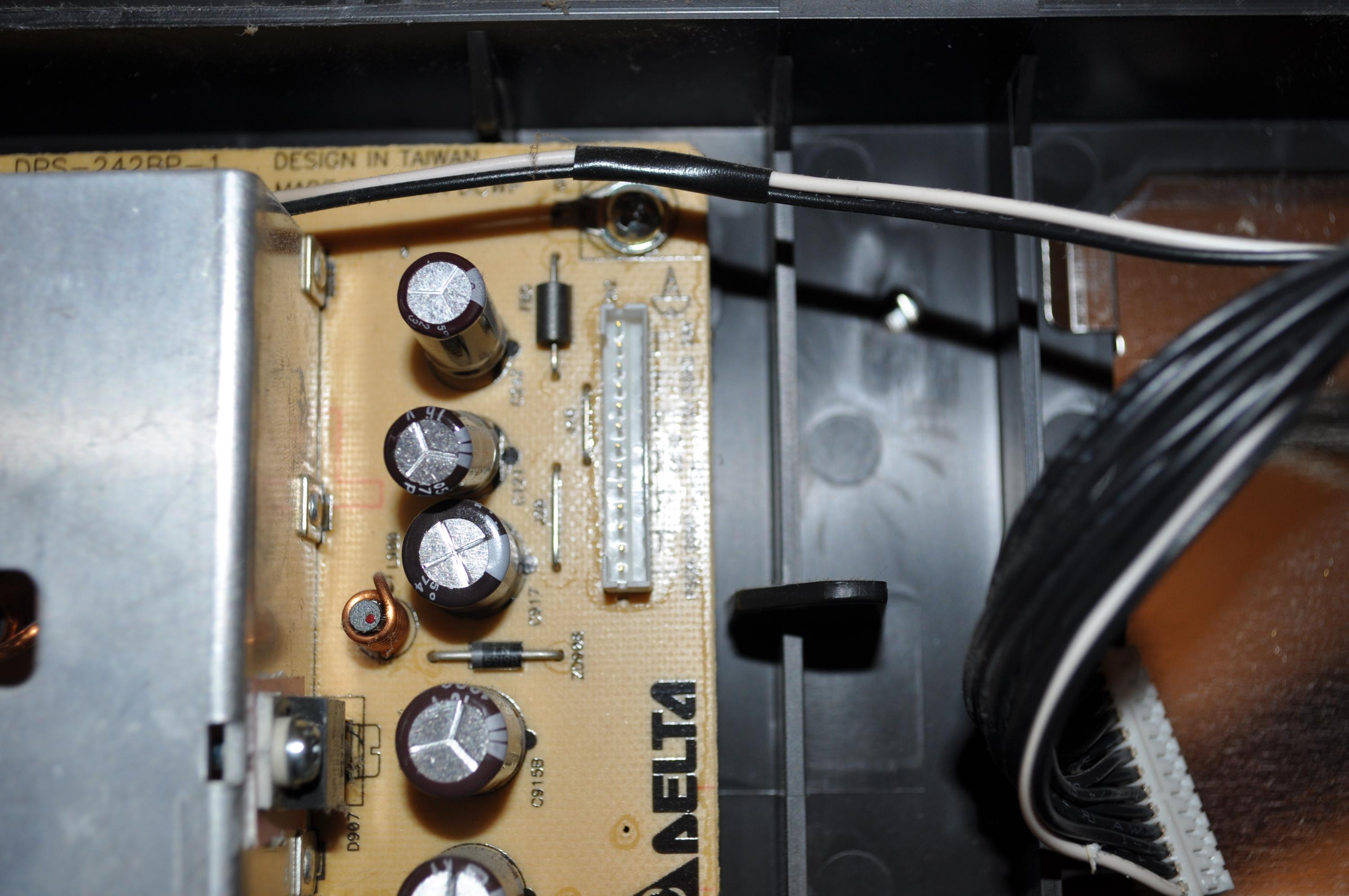

    Picked up a Sanyo DP42848. Set turns om and has sound. I can see a picture with the flashlight test. So it appears the backlights are not coming on. I have tested the PS and here is what I have:
    24V 23.89vdc
    SGND 0
    12v 12.09vdc
    SGND 0
    5v 4.99vdc
    SGND 0
    PSON 4.88
    Also have 23.87 volts on the 24v pins where the inverter board connects to the PS

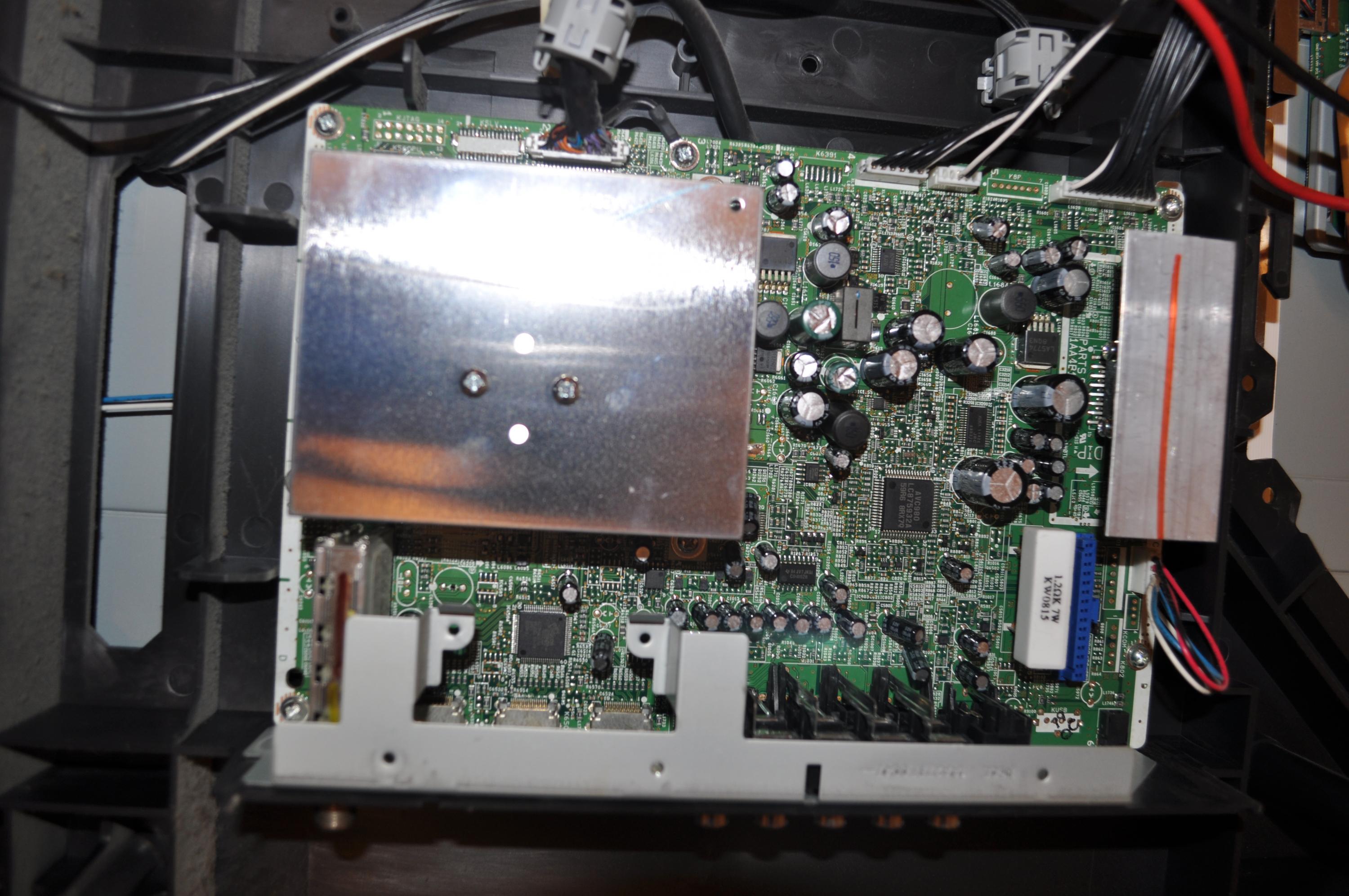

    I noticed two very slightly bulged caps on the main board.
  • capkid
    • Oct 2010
    • 1339
    Re: Sanyo DP42848 No Backlights
    I don't see the bulging caps on the main board. These TVs are notorious for bad CCFLs; I picked up one of these for free myself awhile back. I wouldn't touch Sanyo LCD TVs: https://www.badcaps.net/forum/showthread.php?t=23280

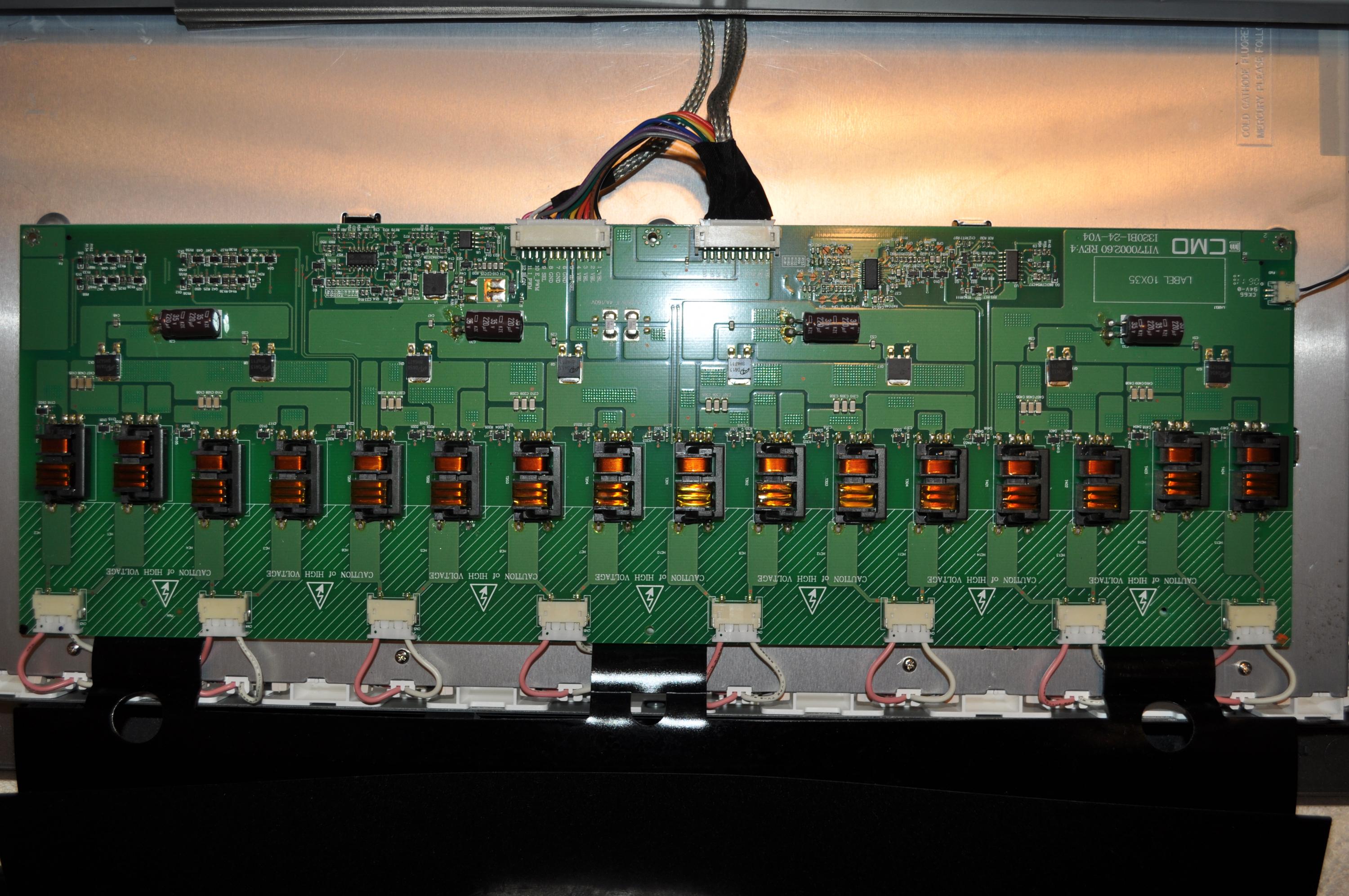

      Did you check 2 white 4A fuses on inverter board yet?
      Not sure if you can bypass a bad bulb in this design like in the this video, maybe someone else would know..
      https://www.youtube.com/watch?v=oE6K4xBVweA
      • landyboy
        • Apr 2013
        • 443
        Kept searching the forum after I posted and found another thread. I thought I checked all the fuses but missed one on the main inverter board that was bad. Replaced and now it works!!
        • landyboy
          • Apr 2013
          • 443
          Kevin it was actually the small fuse marked 15 on the main inverter board.
          • kevinm34232
            • May 2012
            • 1884
            OK, now run it for awhile before you put it back together to make sure no other underlying problem..
            • landyboy
              • Apr 2013
              • 443
              Will do thanks!
                Very common failure for the CMO inverter board, the fuse is for powering the PWM IC.
