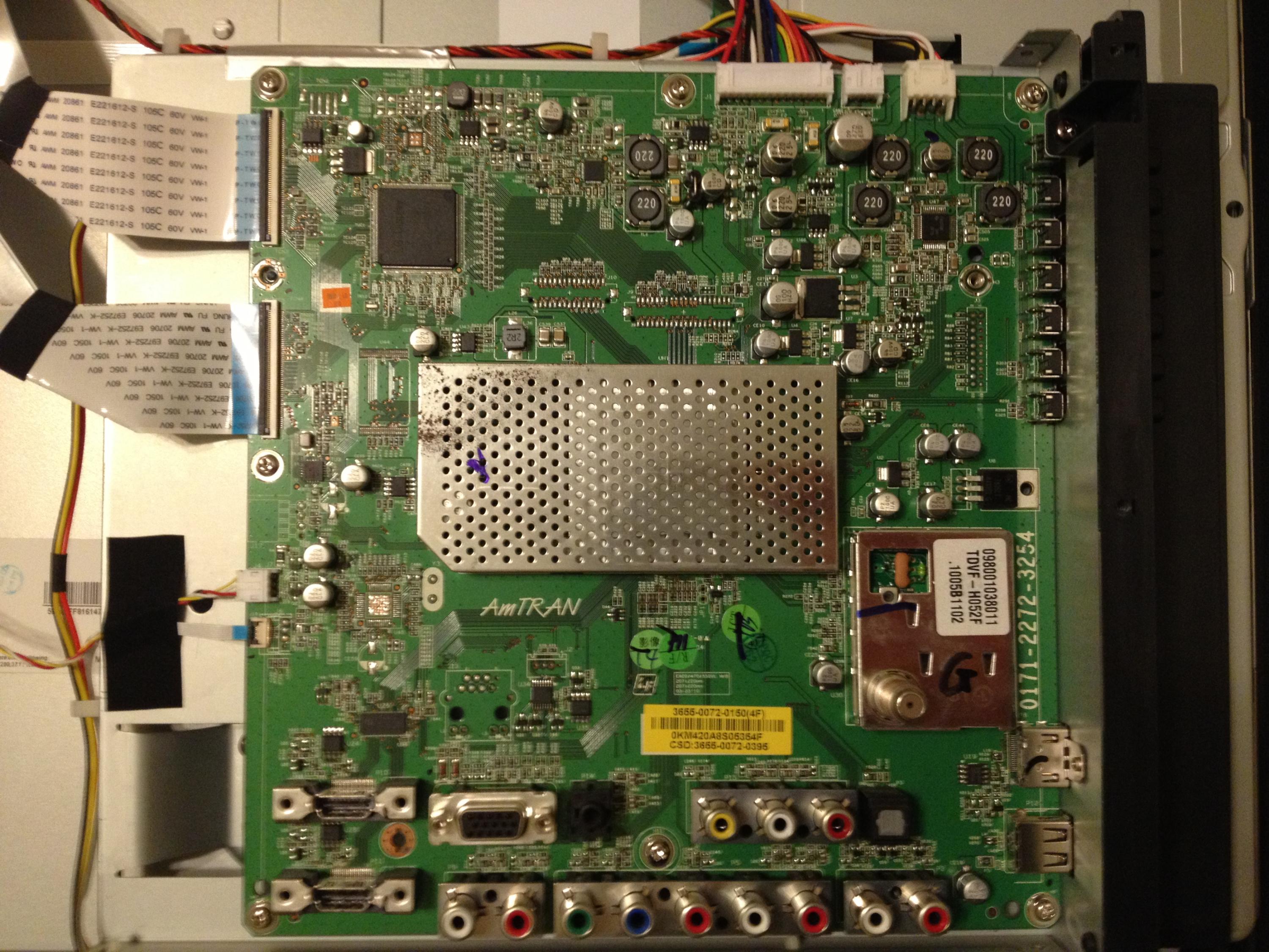

    Hi again everyone. Picked this one up yesterday and paid a decent sum since the only issue was that the HDMI ports don't work and I was able to verify that first. Component, Composite, and VGA inputs function normally.
    Now, on to question 1. I would certainly assume that there is nothing else that could cause the fault other than the main board? When I plug in an HDMI cable I get the 'connecting' and 'retrieving data' messages followed by a 1080i in the upper right corner but then black screen with no sound. All three inputs act the same way. I'm pretty sure this is not easily repairable.
    Question 2. Does anyone know where I can find a board for this at a reasonable price? I researched before buying this and thought I had one located for around $70. However, once I pulled the back off of it when I got home I realized mine had a different version of board. The T-con is built in on mine and apparently it's rarer this way. The cheapest one I can find is $142.
    Any help is appreciated as always and I hope I can find something for $100 or under. I have a buyer for it or I wouldn't have gotten it to begin with and at $142 my profit isn't looking to good.
    Thanks,
    Aaron

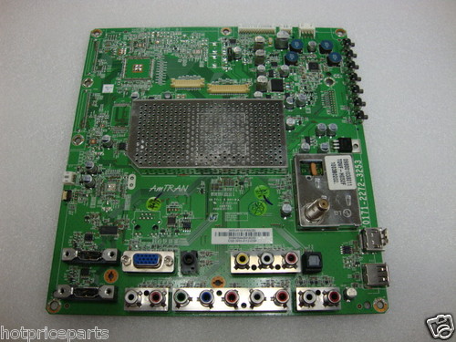

    Just for reference, here is the other version without the T-con parts in the upper left.

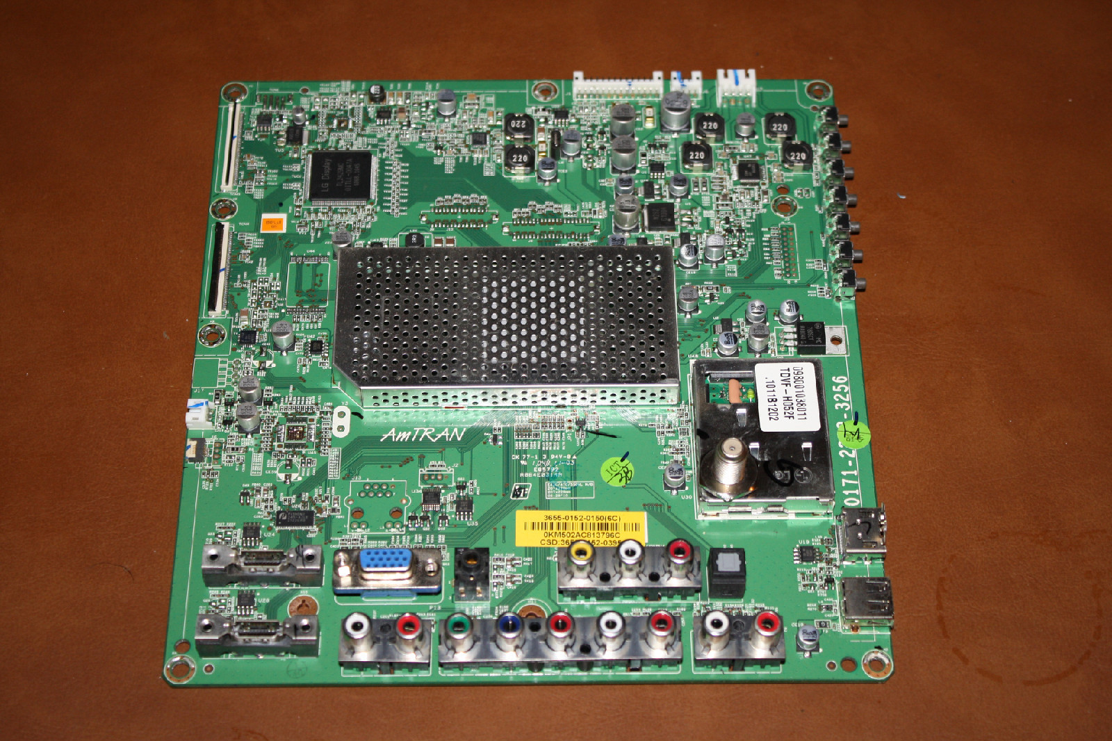

      Well, I saw one that had just been posted on Ebay this morning so I took the plunge. Numbers on the yellow sticker don't match exactly which scares me a bit but all the parts look the same. Chip on the top left says LG display so I'm confident its for the same version as mine. Will report back later when it arrives.

        Out of interest, next to the HDMI port(s) is a pc input (15-pin connector) can you confirm if this works? You may find neither of these work! You've already said it does, strange.
        Also there is a tuner board, can you confirm what this is for, cable? terrestrial?? Can you see if this works?
        From bottom right hand corner are those USB port, HDMI port then the tuner?
        Is the USB port looking a little charred or is it a shadow? this is on the first photo, your original board before you panic!!!

          There are some fuses on that board you could check for continuity, 3 white ones at the top.
          Also, some regulators, check those voltages.
          A blue mark on the board next to the cap up by the 4 pin plug(top right corner), is that just a marker pen blob or leaky cap?
          Any leds on this board? solid/flashing
          Neither Hdmi ports working, must be a common fault to both ports, above them is an i.c, can you identify it? photo slightly blurry at that end of the photo.

            Does sound like its most likely the processor at fault, as you say, non-repairable. Strange VGA Pc input and component work though!
            Definately no shorts inside one of the HDMI ports, look for something jammed inside the ports.
            Also possible corrupt settings, can you get into service menu?

                            TV is back in business. I may check into that chip sometime later. If nothing else, I have a spare board for testing purposes.

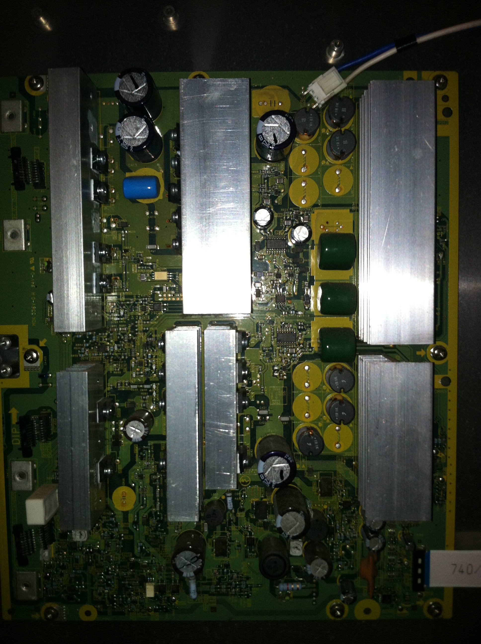

                                    Wondering if I could get some advice? I have recently received a used Vizio E550VL. I'm trying to decide what needs to be replaced. I'm thinking the back light inverter or main board. When the TV is on the display is hard to see. It is dark especially towards the center. You can barely see the writing in the center. If I go to the menu and reset the TV to factory settings it displays perfect on the whole screen for a few minutes then, slowly starts to fade and darken. Any advice would be great. I am new to this sight and hope it is ok to to post on this thread. I have an old CRT in my house so, it would be great if I can get this TV working correctly. Thank you for any help.
                                    • jhardluck
                                      • Sep 2013
                                      • 19
                                      Re: Vizio E550VL Main Board Issue
                                      This is a TC-P50S1. 7 blinking red lights, if I disconnect the SC board I get 6 blinking lights. If instead I disconnect the board on the opposite side(can't remember what it is called) I still get 7 blinking lights. I also tried disconnecting the upper and lower boards connected to the SC board but, this did not make a difference so, I believe the SC board is my problem. It has the glued on heat sinks so, I can't see if anything is blown. Everything visible looks fine. I can't seem to find a price under $130 for a board. Any suggestions where to get cheap parts?
