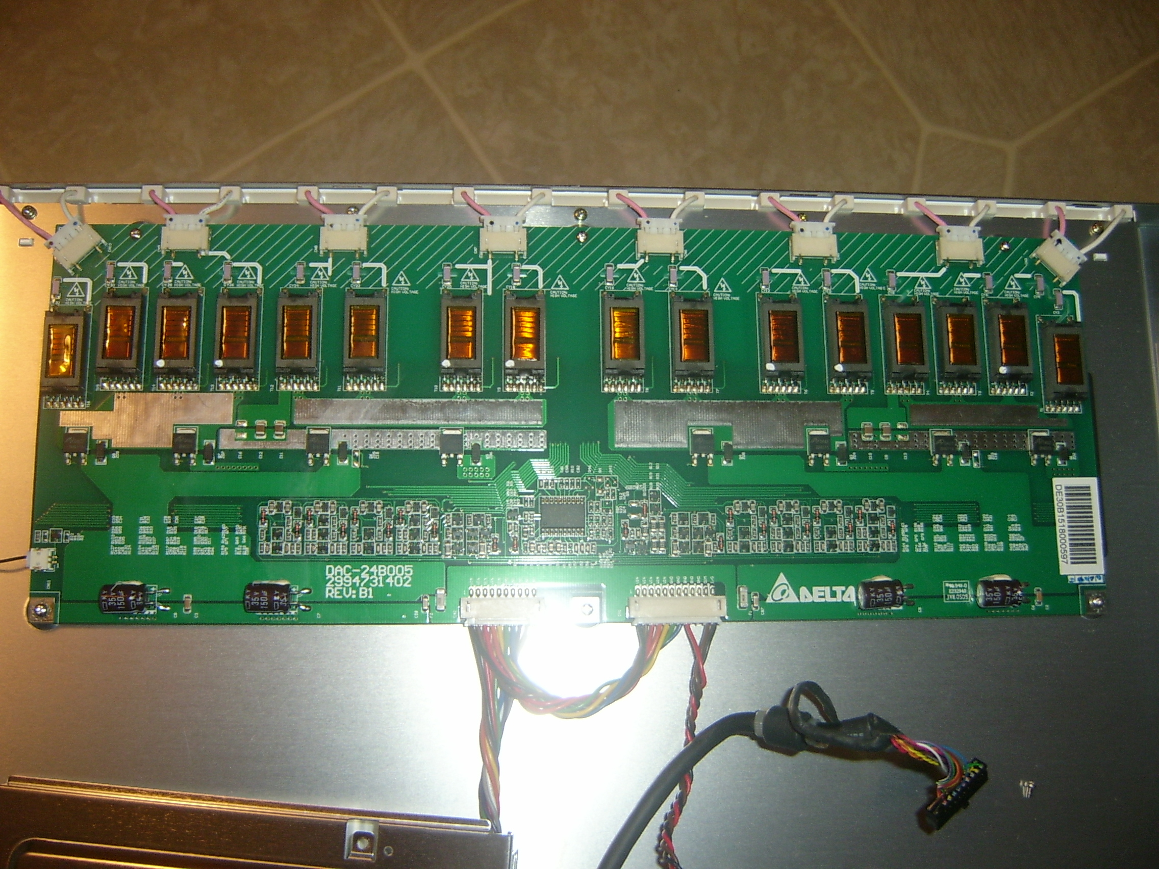

      Can you upload good clear pictures of the boards so we can see what we are dealing with?

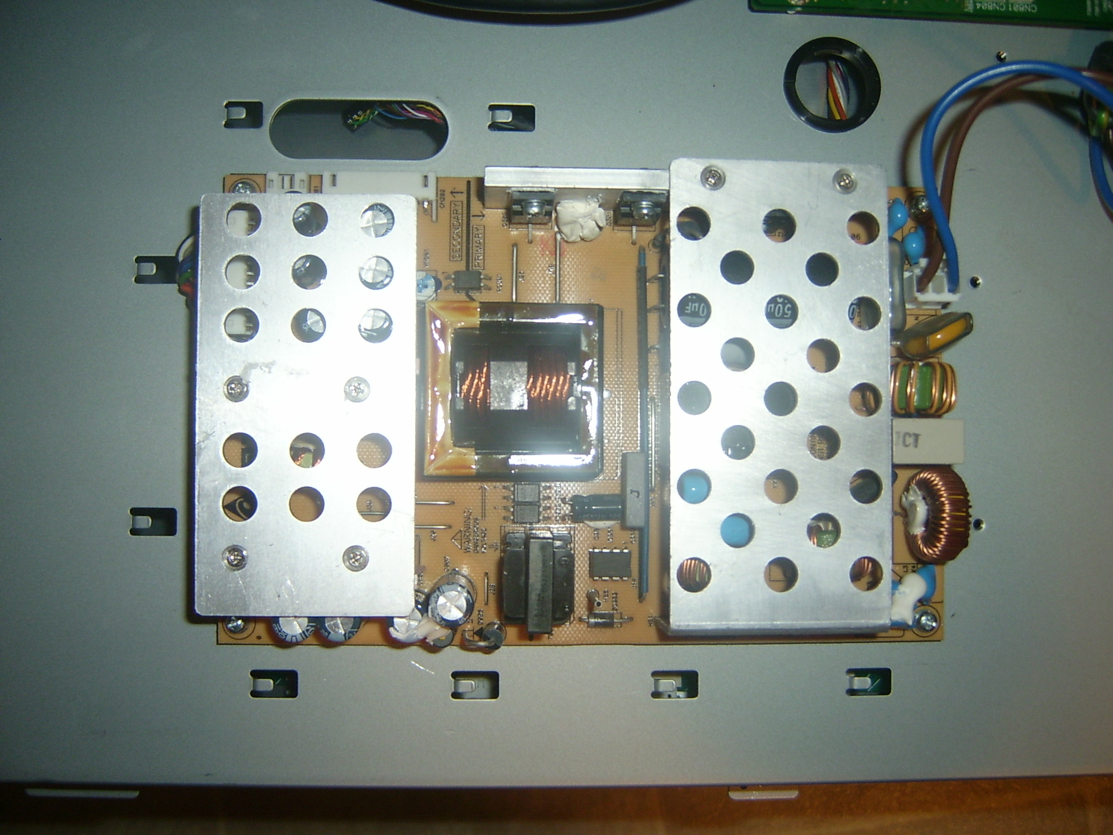

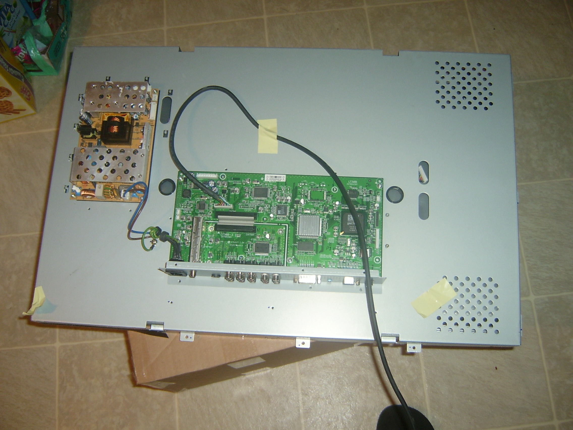

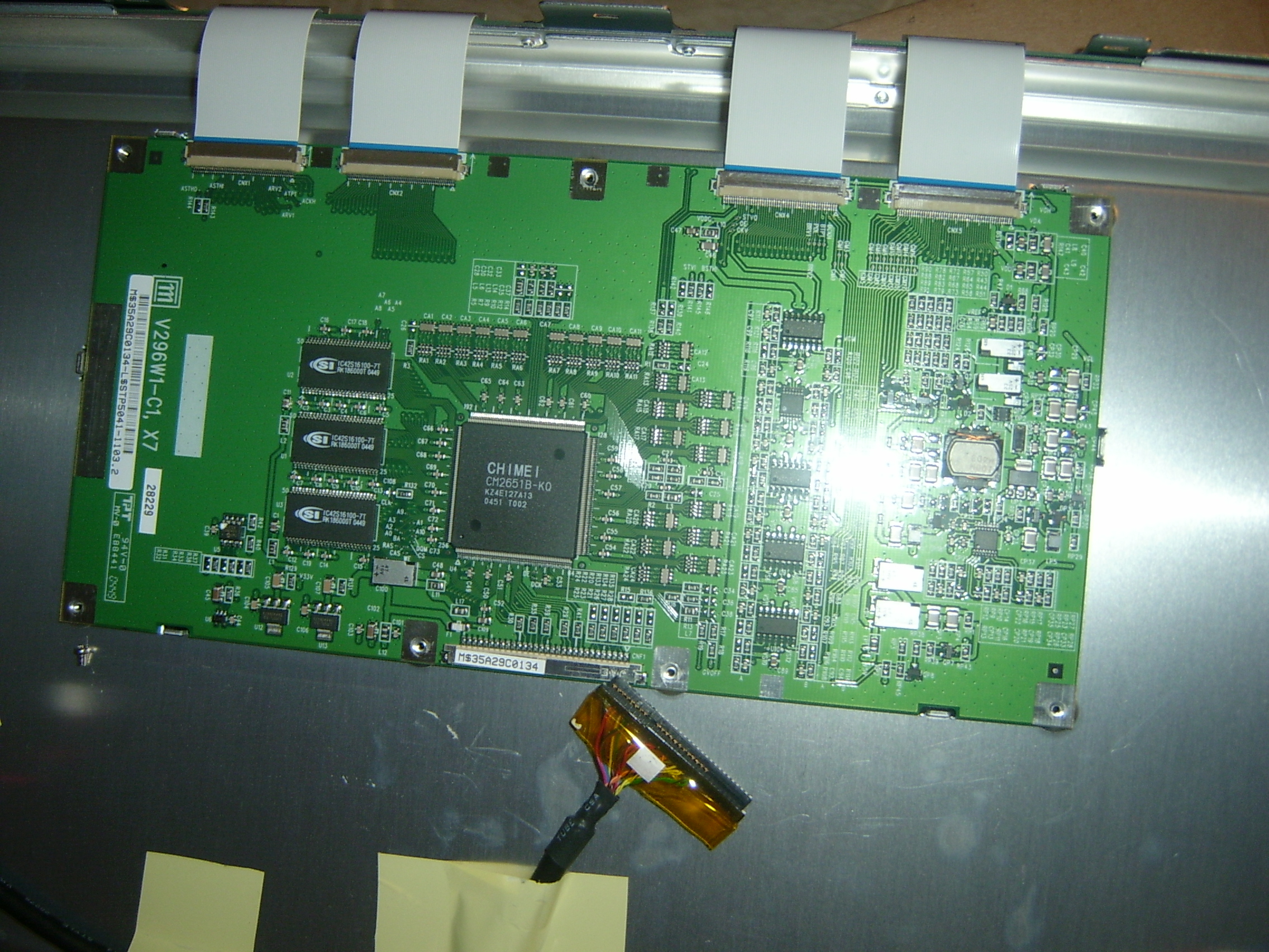

          Re: Westinghouse TV LTV-30W2
          The whole back side so we can see how all the boards are connected together, then the power supply and inverter boards.
          We need to locate the BL_ON signal pin.
                I download the pictures, will get back to you.

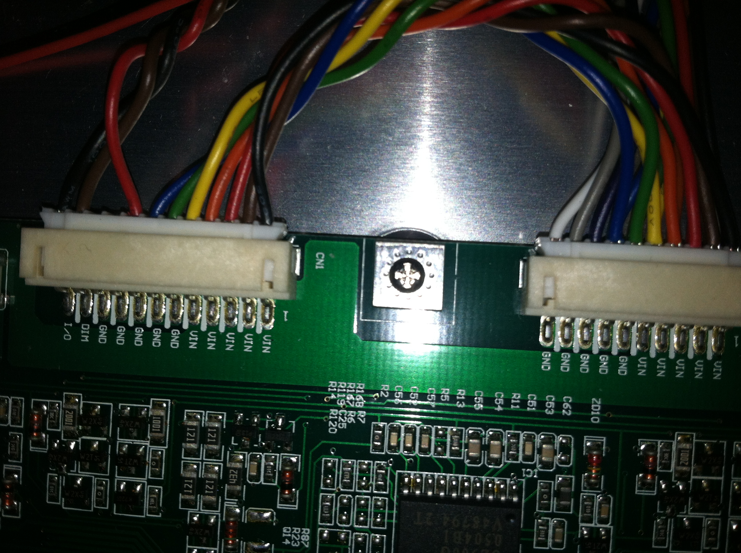

                There are some labels by the 2 connectors on the inverter board. Can you pot what they are?

                  Connectors are CN1 and CN2

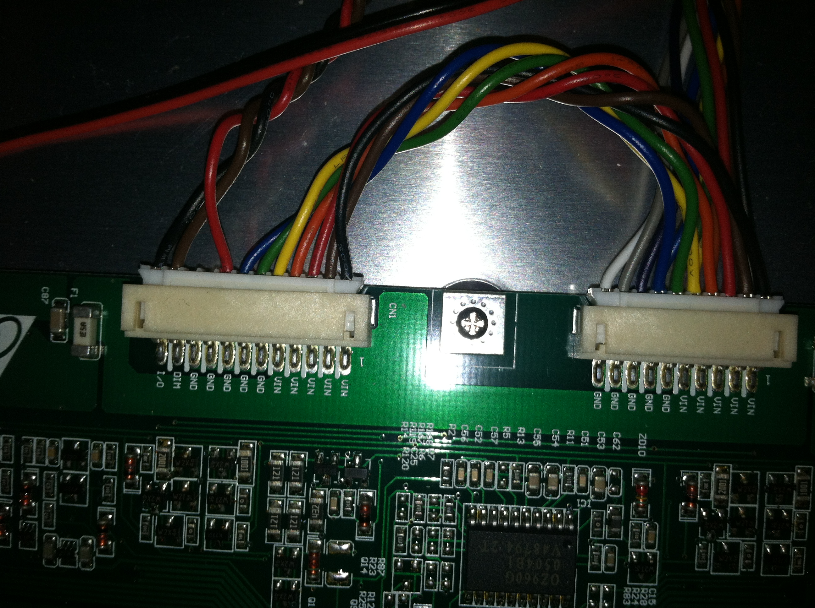

                          Hi can I please get some help with my TV
                            The listing of CN1 does not look right, from the pictures, I cannot see real well since it is not in focus, I can see that pin 11 does not look like the word GND in on that pin. Can we get good clear close up of those two connectors? There has to be a pin with the word 'on/off' (or BL_ON or Ibv_on), and another pin with the word 'DIMM).

                                  I just uploaded some new close up pictures
                                    OK, that is better, pin 12 I/O (same as BL_ON) is the inverter on/off control pin, when it receives >3VDC from the main board, that will turn on the backlights, PIN 11 is the backlights Dimming control signal which also comes from the main board.
                                    So using DC voltmeter, black probe to the chassis and use red probe to check the 24V pin to see if the 24V goes away, then check the I/O pin to see if that goes away also when the TV blackout.
