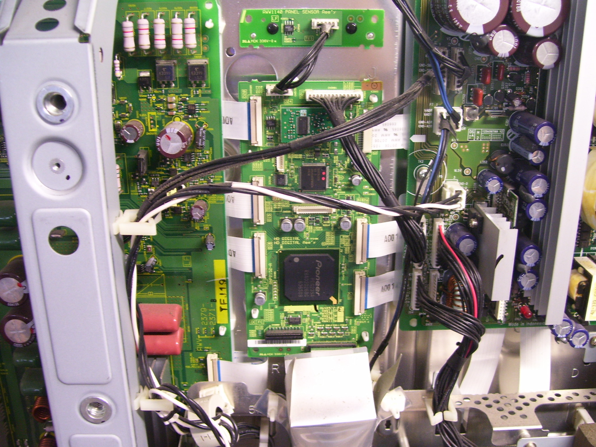

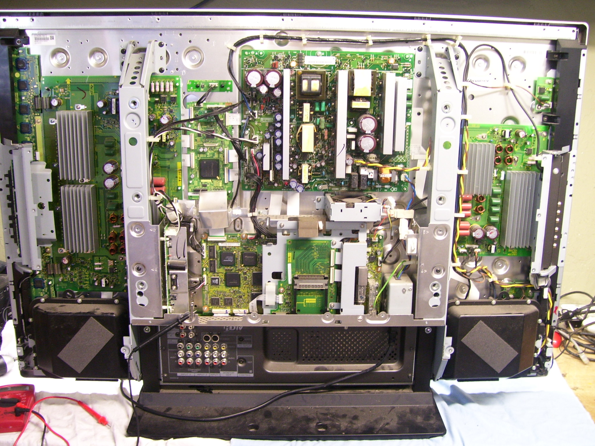

    I have a Pioneer PDP-4270HD, power light is on standby light is on, get no response when power button is pressed. Seem to have correct power from the ps. Any ideas as to where to look for the problem.

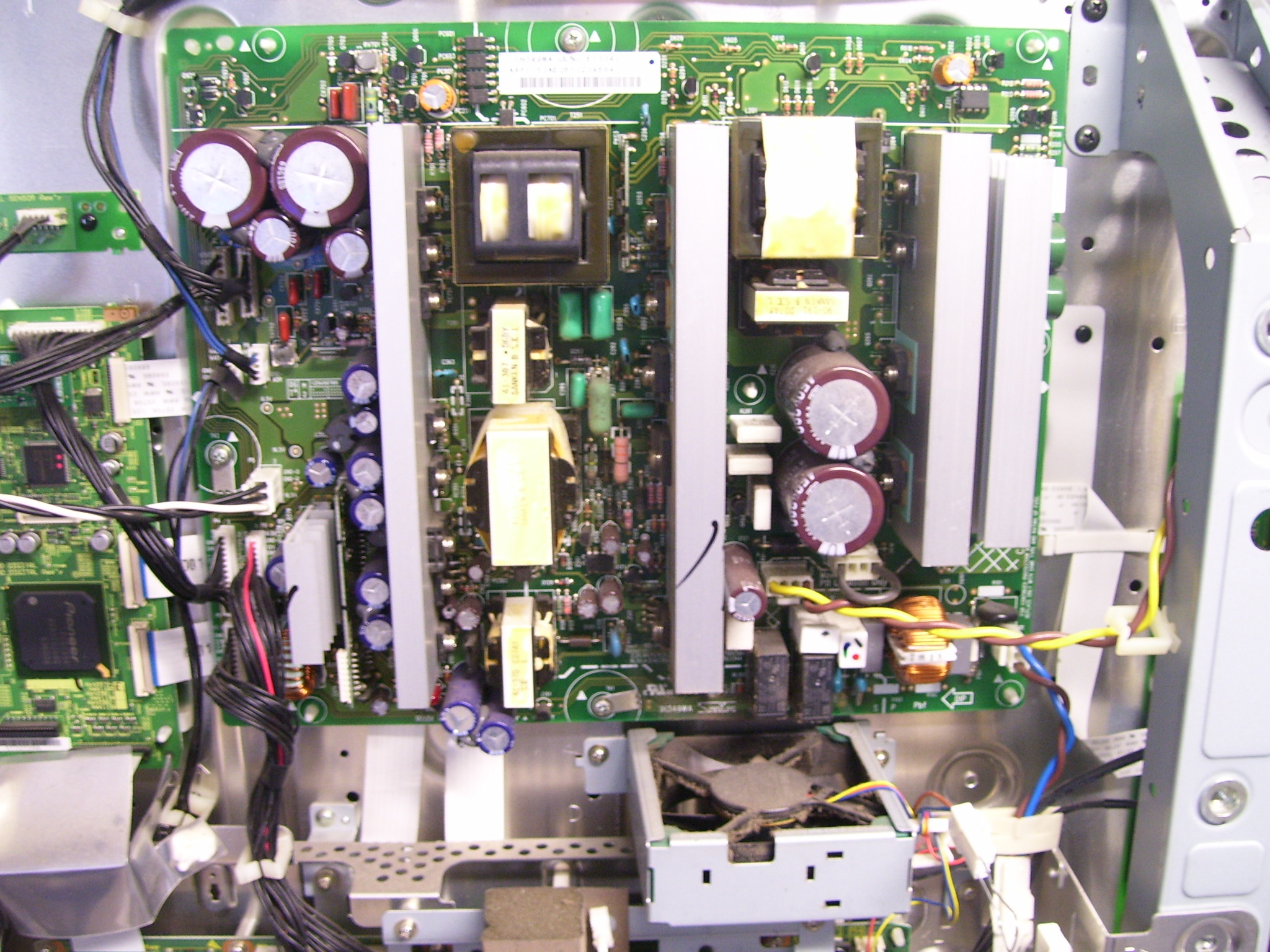

    Re: Pioneer PDP-4270HD
    Hi! Did you try turning it on using its remote control? If it wont work, try to measure the voltage on the PSU if it present and normal...
      PSU voltage is normal, I do not have the remote. checked the button switches, all good
          Does this model incorporate a 'trap" switch? It looks as if it does on the right support column. If you power on the set without depressing the switch, the TV goes into a shutdown mode.
              If you trigger the trap switch you need to reset it. There are instructions in the service manual.
                  If you would have read the pdf file I supplied in my previous post, you would have seen the symptoms of both the power and stby LED's is the trap switch protection feature has been triggered.

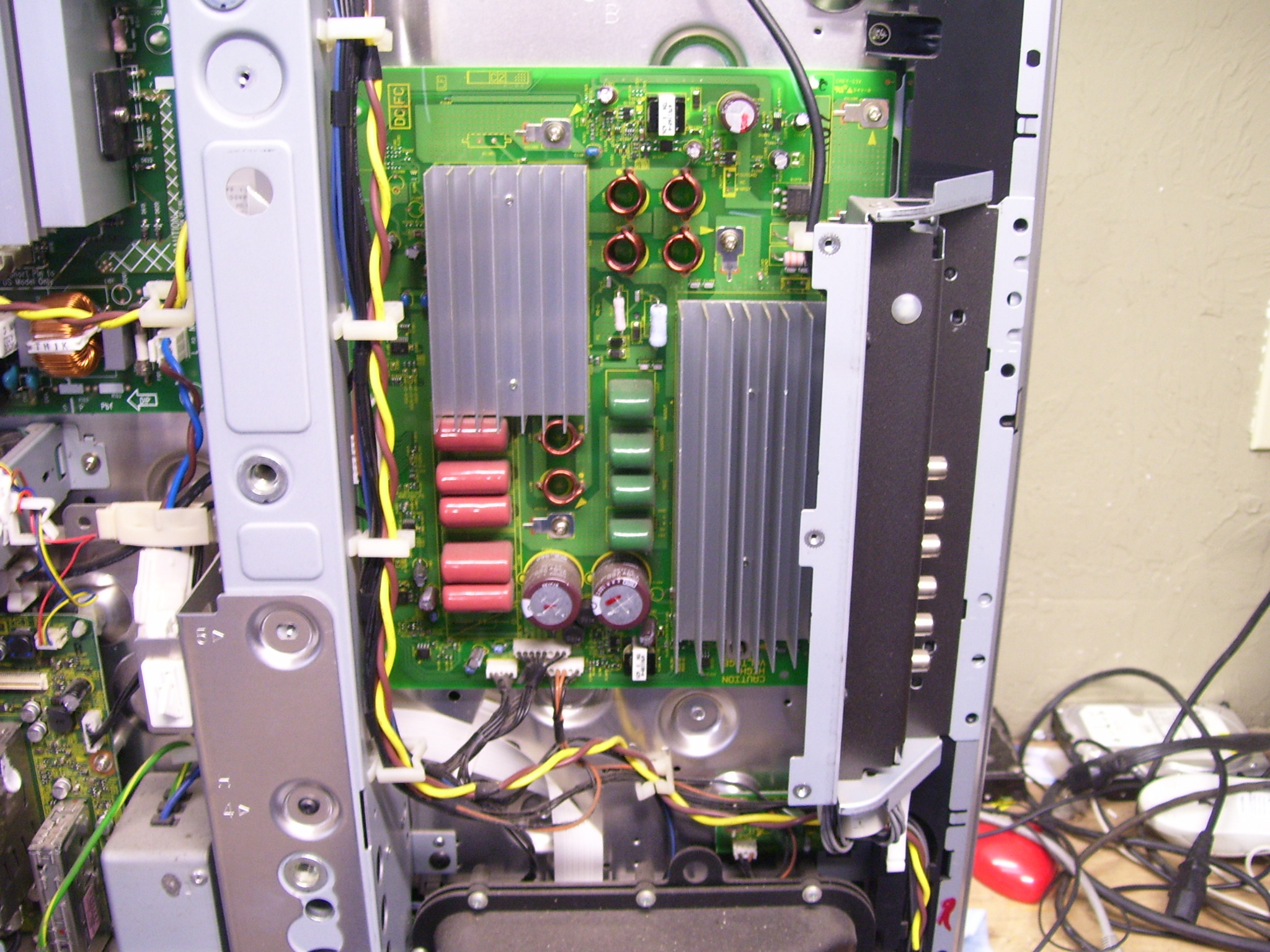

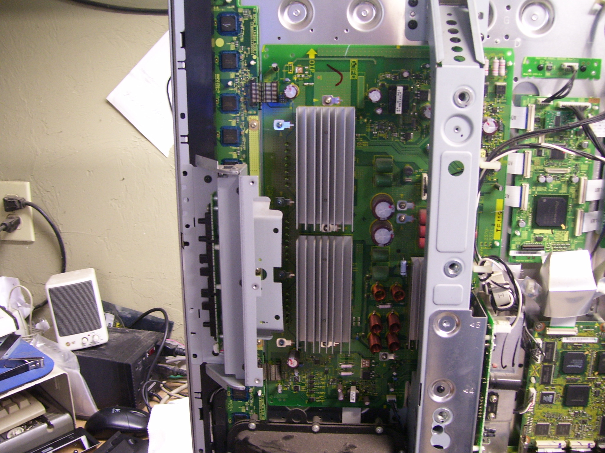

                      I have a 50" model (5045HD) that would not turn on. I unplugged one or both sustain boards and tried to turn it on. That must have reset something because all I had to do then was to clear the trap switch problem and have been watching the TV ever since.
