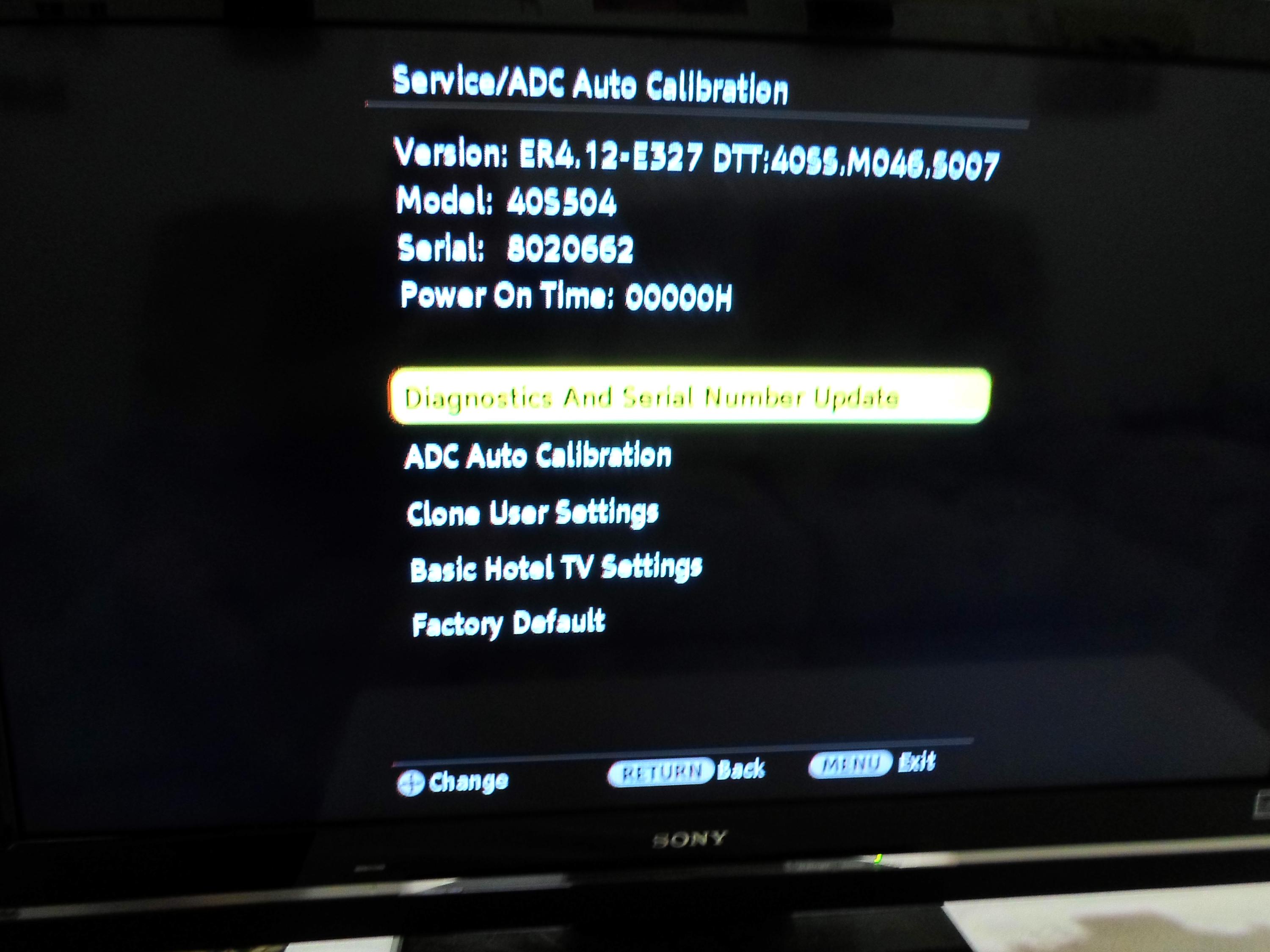

              Anyone know how to get into the factory menu on this model?
              • kevinm34232
                • May 2012
                • 1884
                #67
                Re: Sony KDL-40S504 6 blinks
                Got to this menu but was hoping to get to a menu where you can see the panel type..

                  #68
                  Is this most likely a main board issue Im not gonna be able to fix, or possible T-Con?
                    #69
                    Main board. The format is wrong but I do not think it can be changed on these sets, without replacing the main board.
