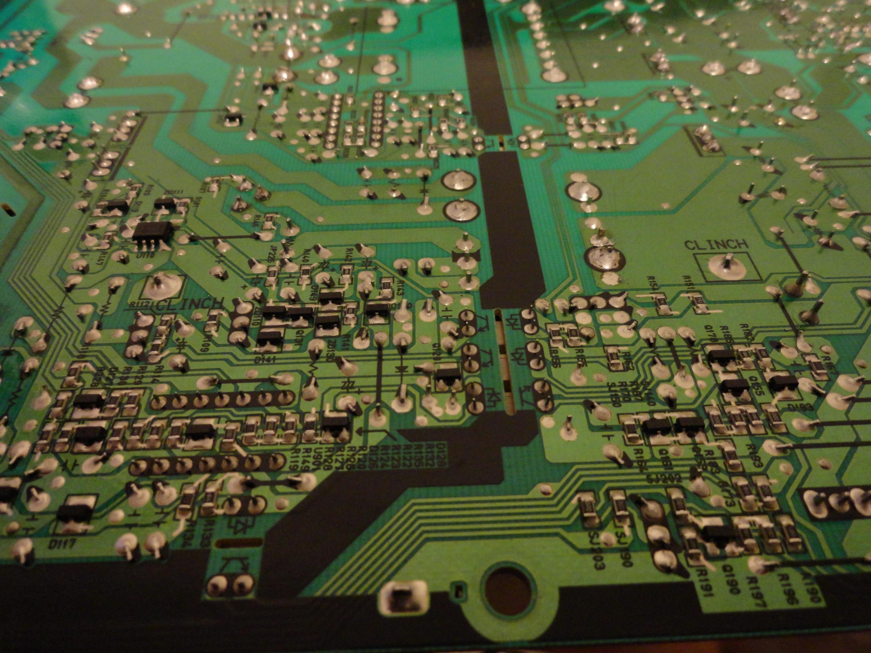

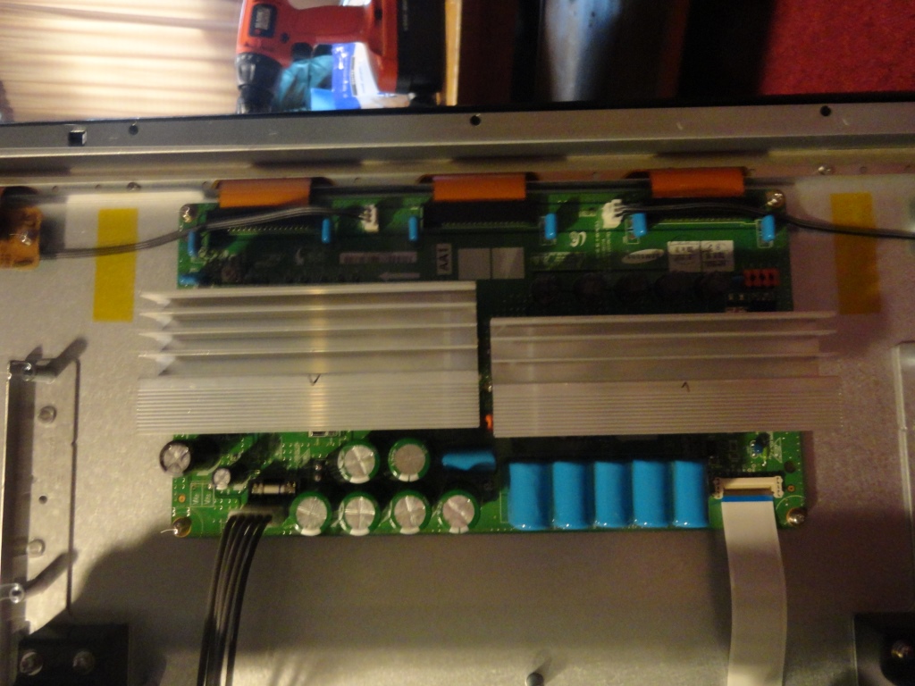

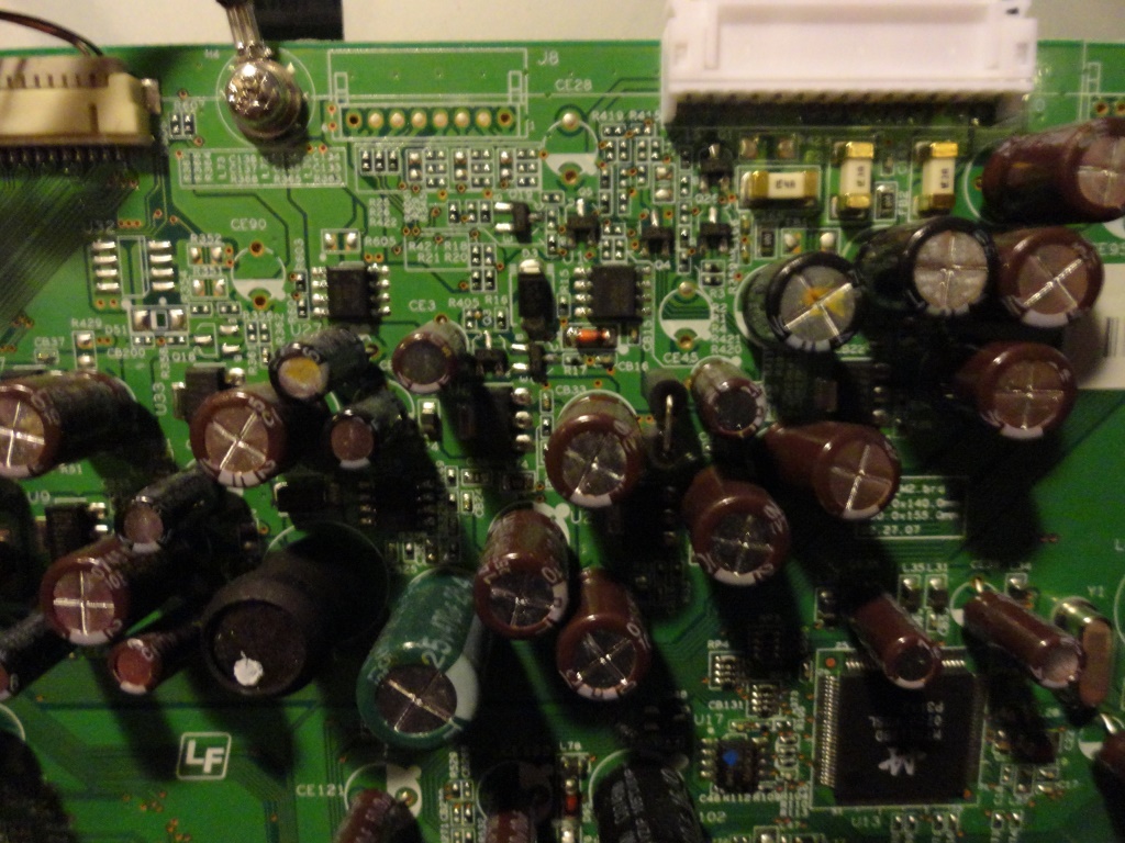

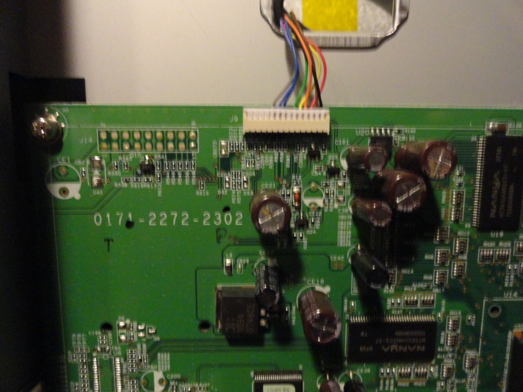

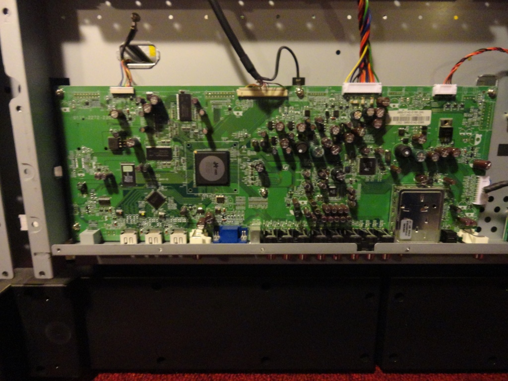

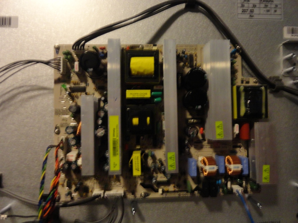

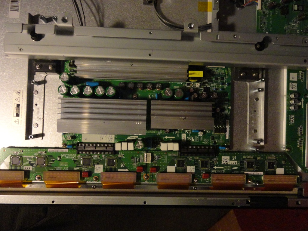

    I just got a Vizio VP50 HDTV20A that has no picture or sound but just the green light. The guy I got it from said it was working before he moved and now it only works intermittently. So I got it home and turned it on and it worked. I turned it off and the next few days tried to use it and never would show picture or sound just a green light. I took the back off to check for bad caps but didn't see any caps that looked bad. This is the Samsung version of the Vizio. Here are some pictures. Can someone help me please.
    Re: Vizio VP50 HDTV20A no picture or sound
    Common to get bad solder joints on the transistors of the power supply.
    https://www.badcaps.net/forum/attach...9&d=1370731206
    I suggest you remove the board and resolder all the transistors attached to the heatsinks.
      I will try that right now.
        Okay I took the board off and re-soldered the transistors and put the board back in the tv but now it's doesn't have a stand-by light and doesn't turn on. Did I burn a fuse out maybe?

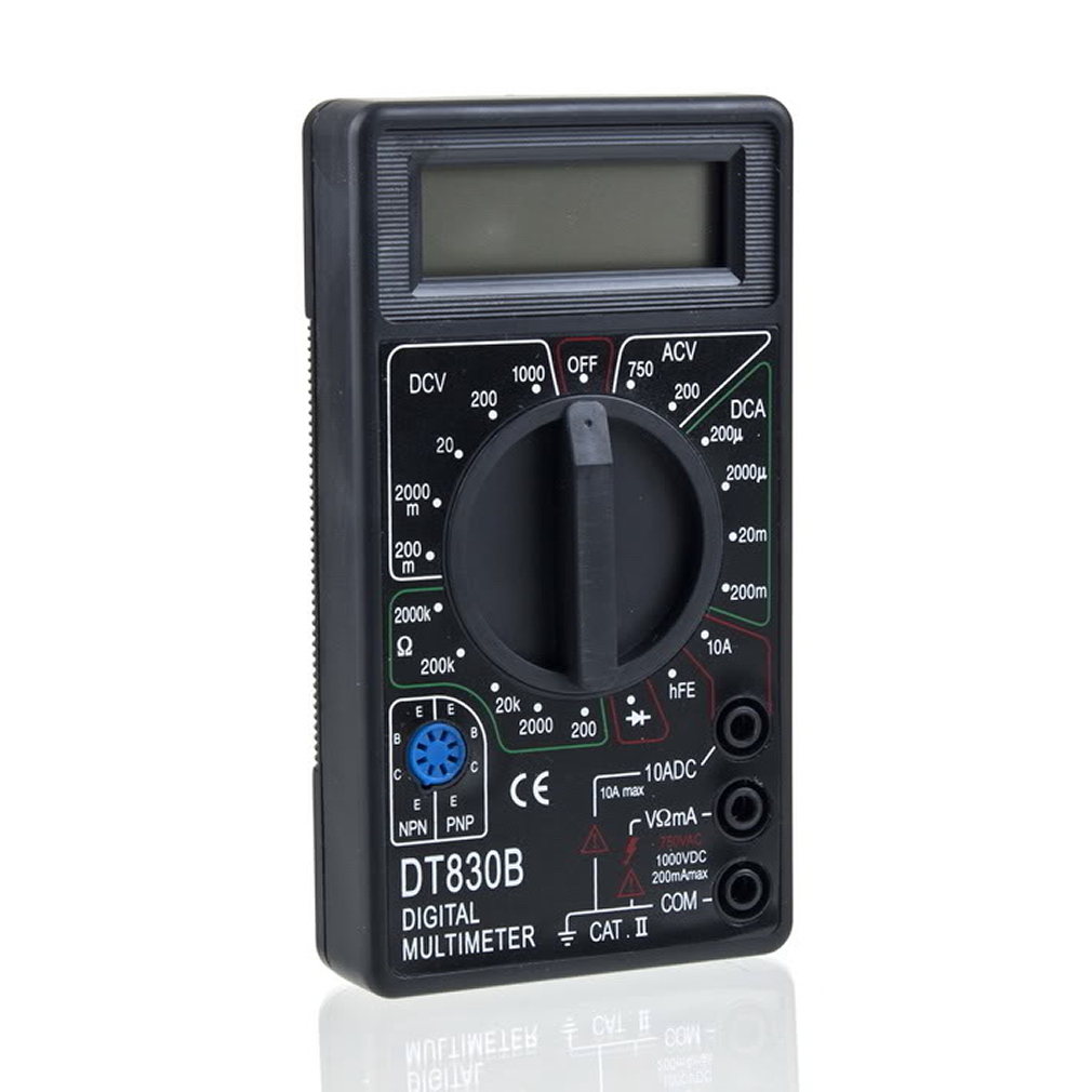

                      I have a very cheap multimeter from ebay I bought and I am not sure what to set it to, to see if I am getting 5v coming from the pin. Here is a picture of the multimeter and you let me know which setting I need to set it too?
                      • attainteddragon
                        • Apr 2013
                        • 764
                        • australia
                        set it to 20 dcv and your good to go. as long as you have it set higher than your testing voltage, your all good. black probe on fixing screw or chassis and red probe on pin to be measured.
                          http://www.sparkfun.com/tutorials/202
                                Thank you for the link for the multimeter tut. I am reading through the Troubleshooting guide now and will post better pictures after.

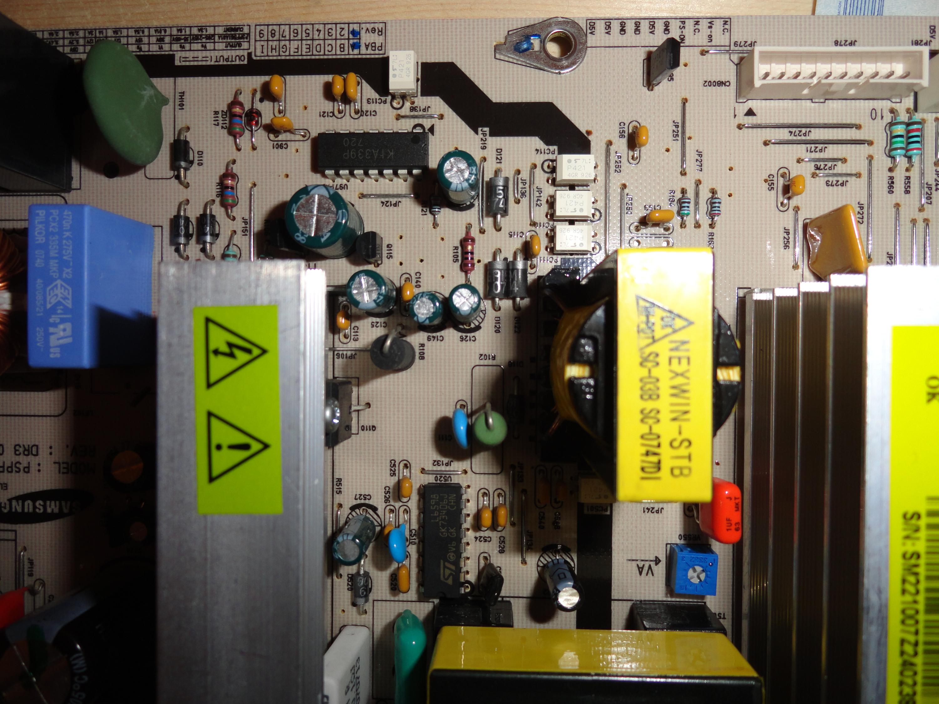

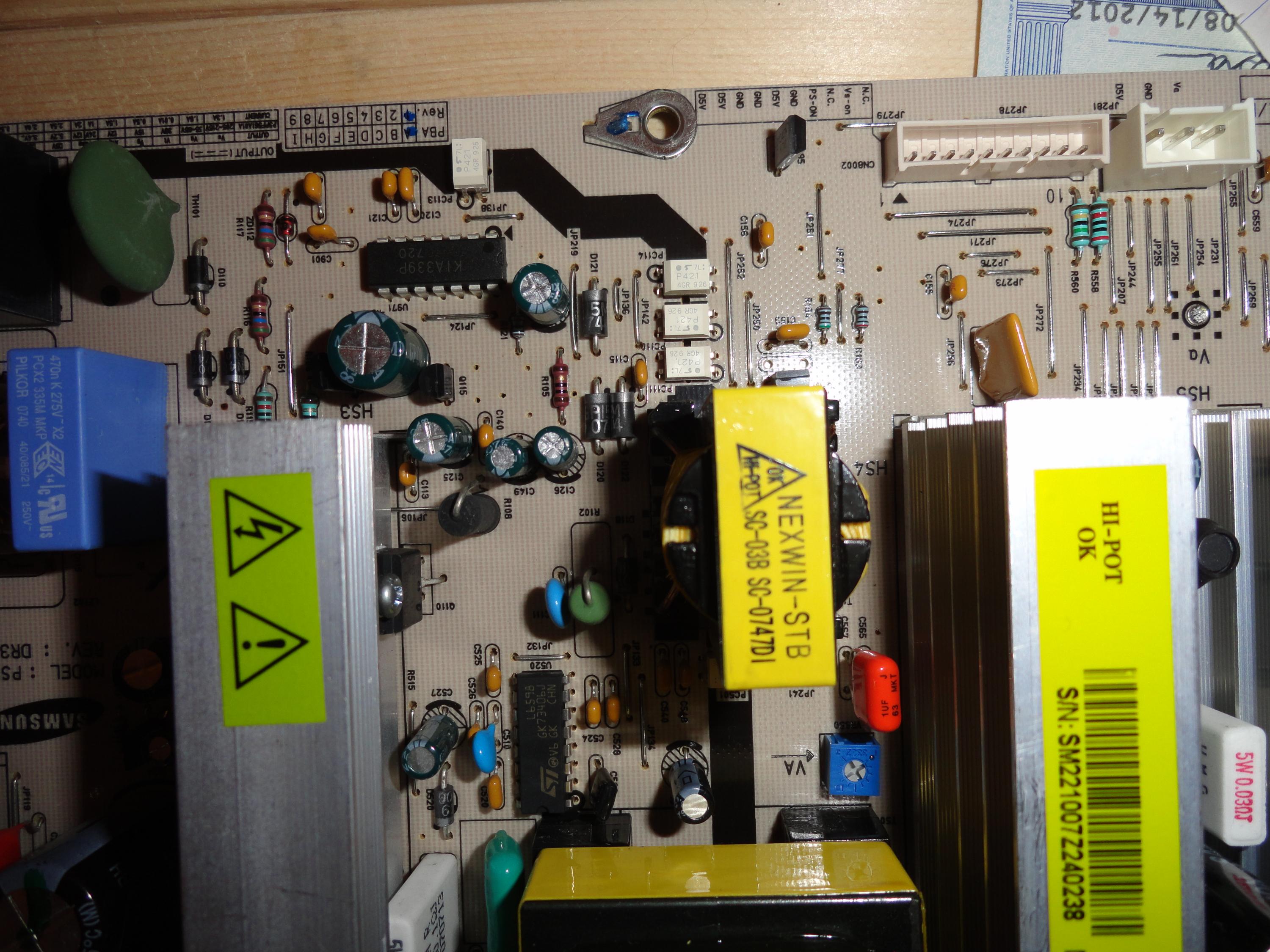

                                    Since you have no 5VSB, the first place to check is around here: look for cracked solder joints, shorted points, etc. And can you get a close up of the area?
                                    • loukin
                                      • Jun 2013
                                      • 22
                                      Here are some close ups I don't see anything wrong.
                                      • loukin
                                        • Jun 2013
                                        • 22

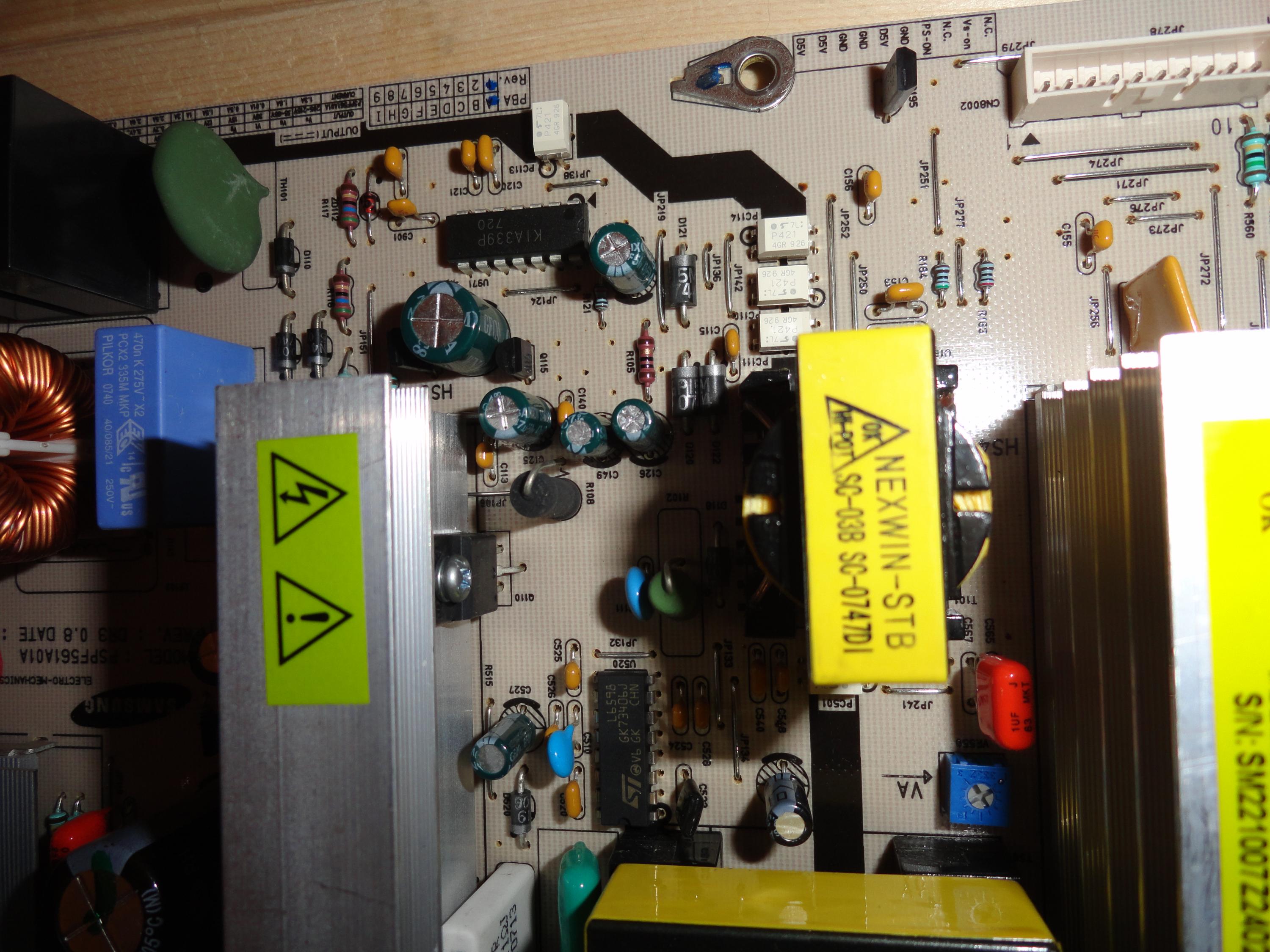

                                        Here are closeup pictures of this area. I looked at it and it looks find is there a way to check these components?
