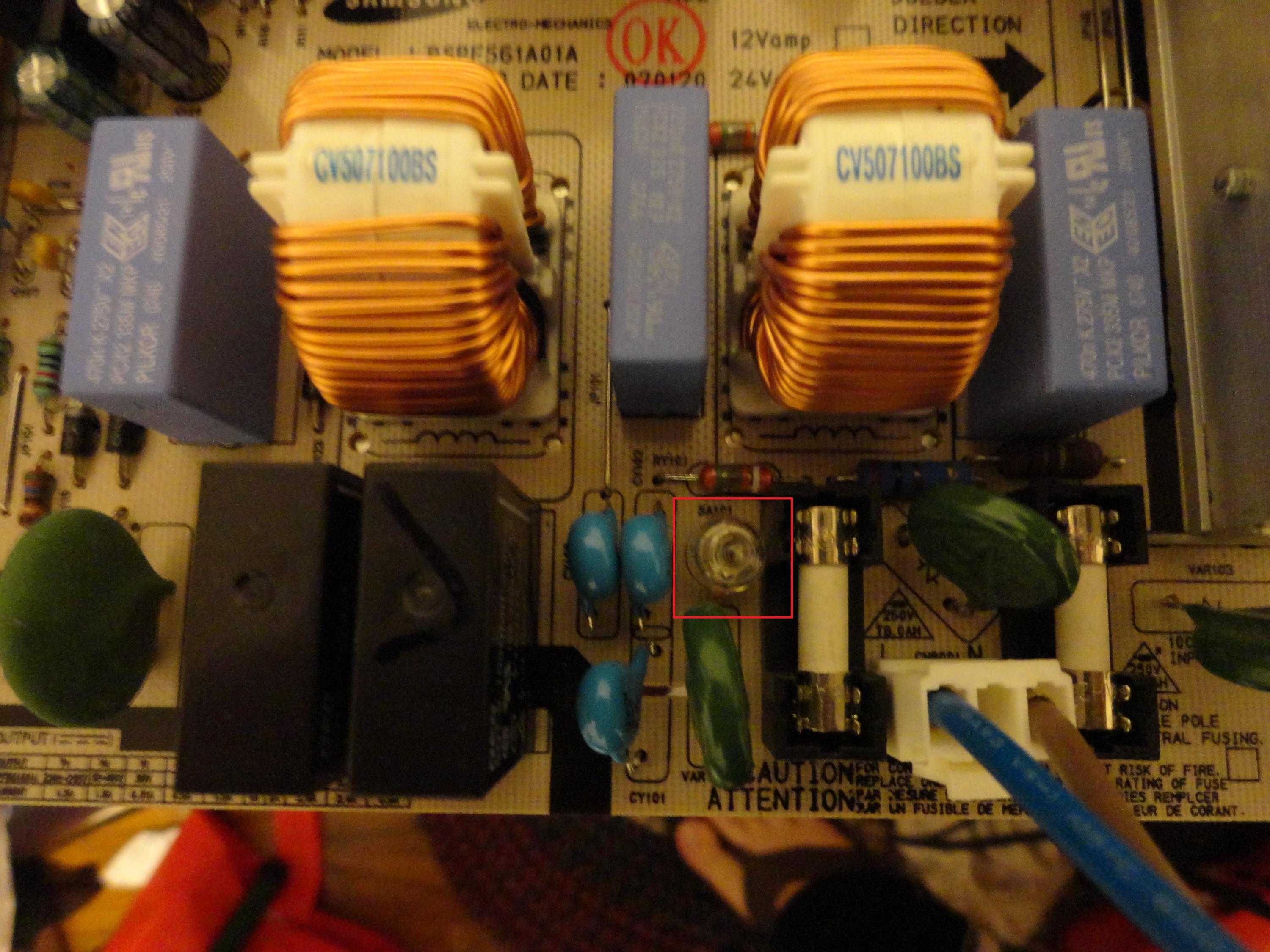

    If the power board is plugged in should this bulb be on in this picture?
      Re: Vizio VP50 HDTV20A no picture or sound
      That is a surge absorber, not meant to be lit up normally.
