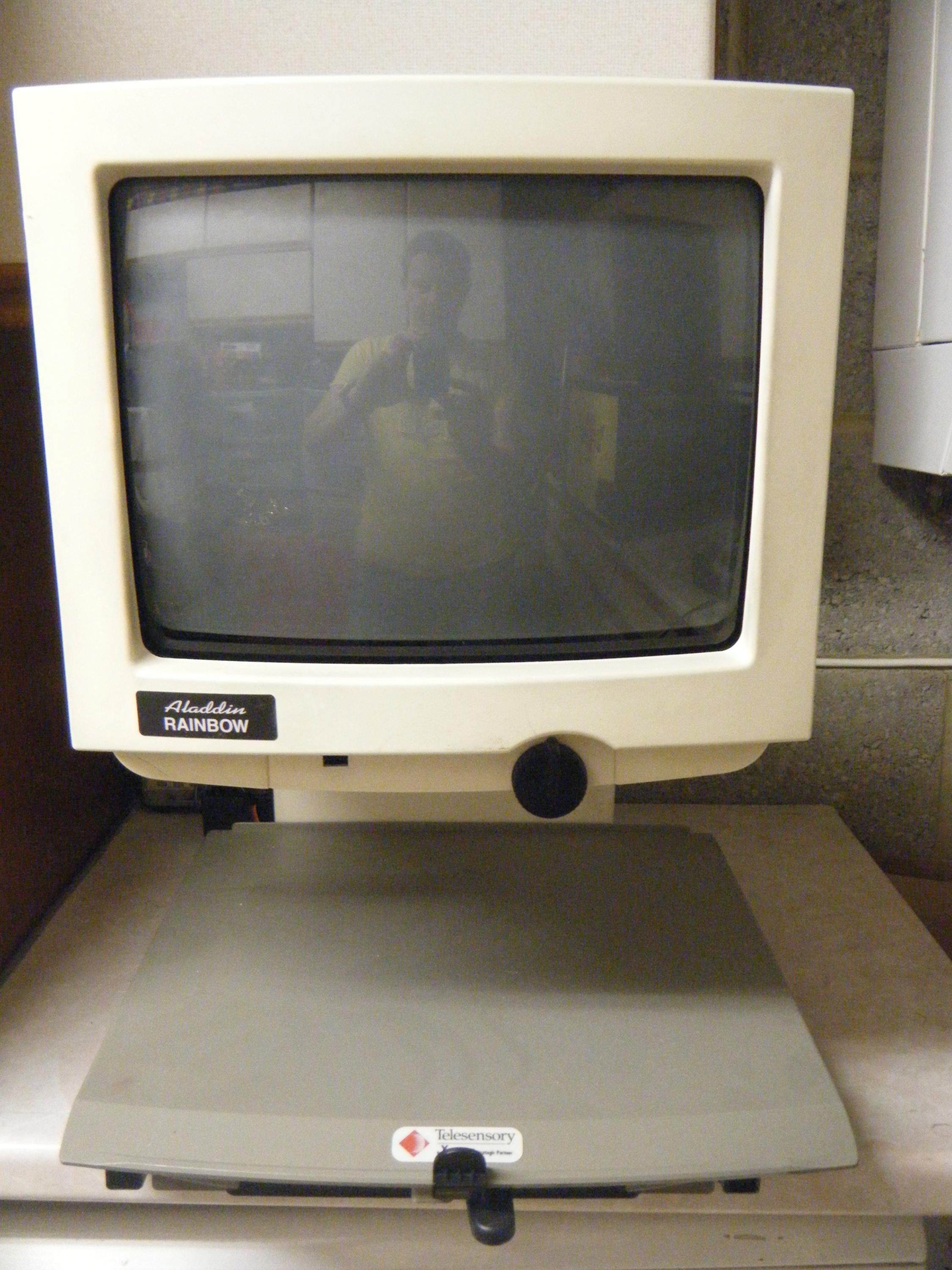

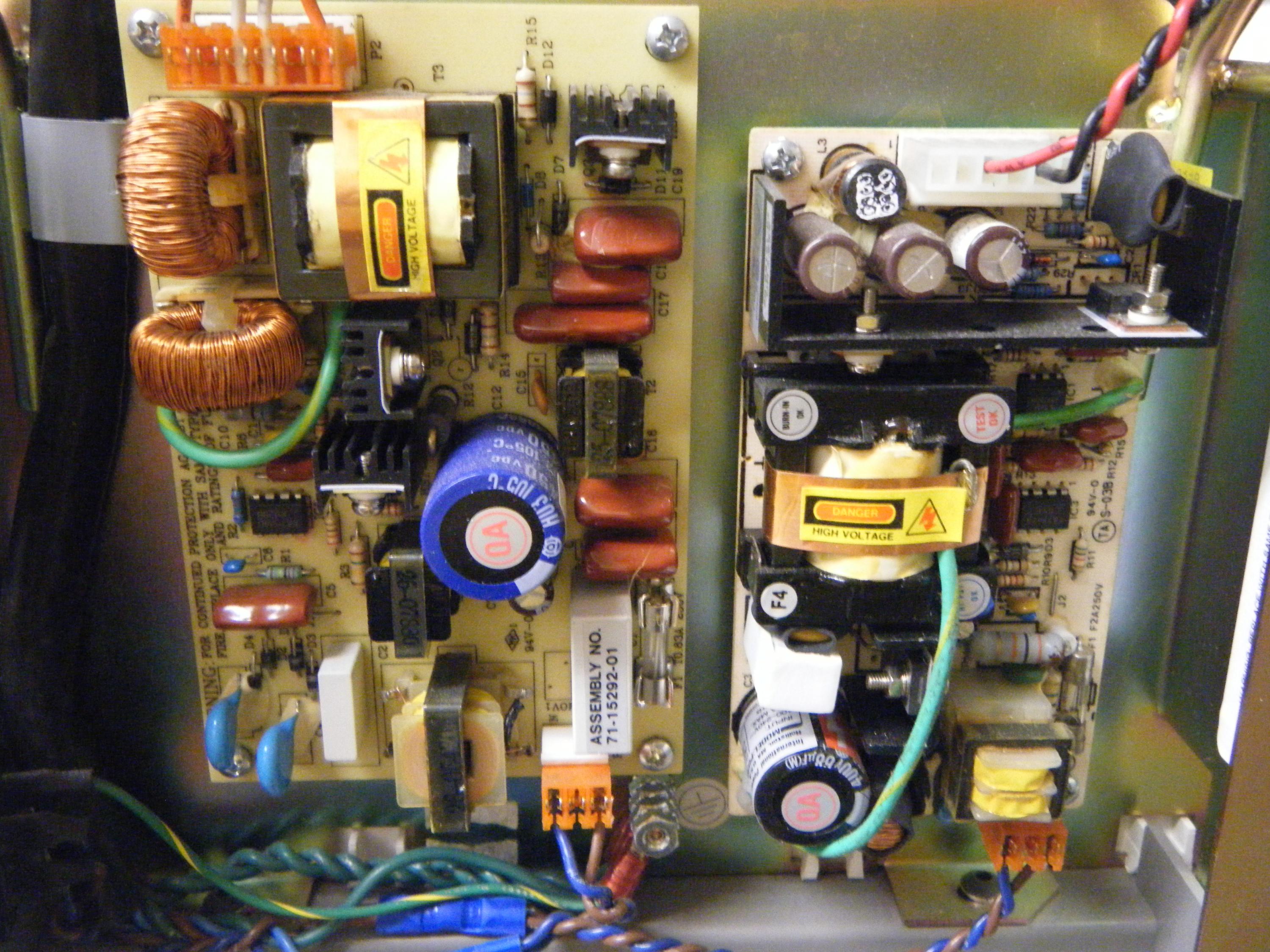

    Hi Guys,
    I have been asked by a local care home to repair a Telesensory unit, it is used by a mentally ill blind resident of there care home.
    I said no problem to help out but I cant find the cause yet. Basically the unit is dead, I am getting power to the light below the CRT that is used to illuminate the newspaper/document.
    So thought I would ask you guys to see if anyone can help me with some fault finding on a CRT.
    kind regards
    Andy

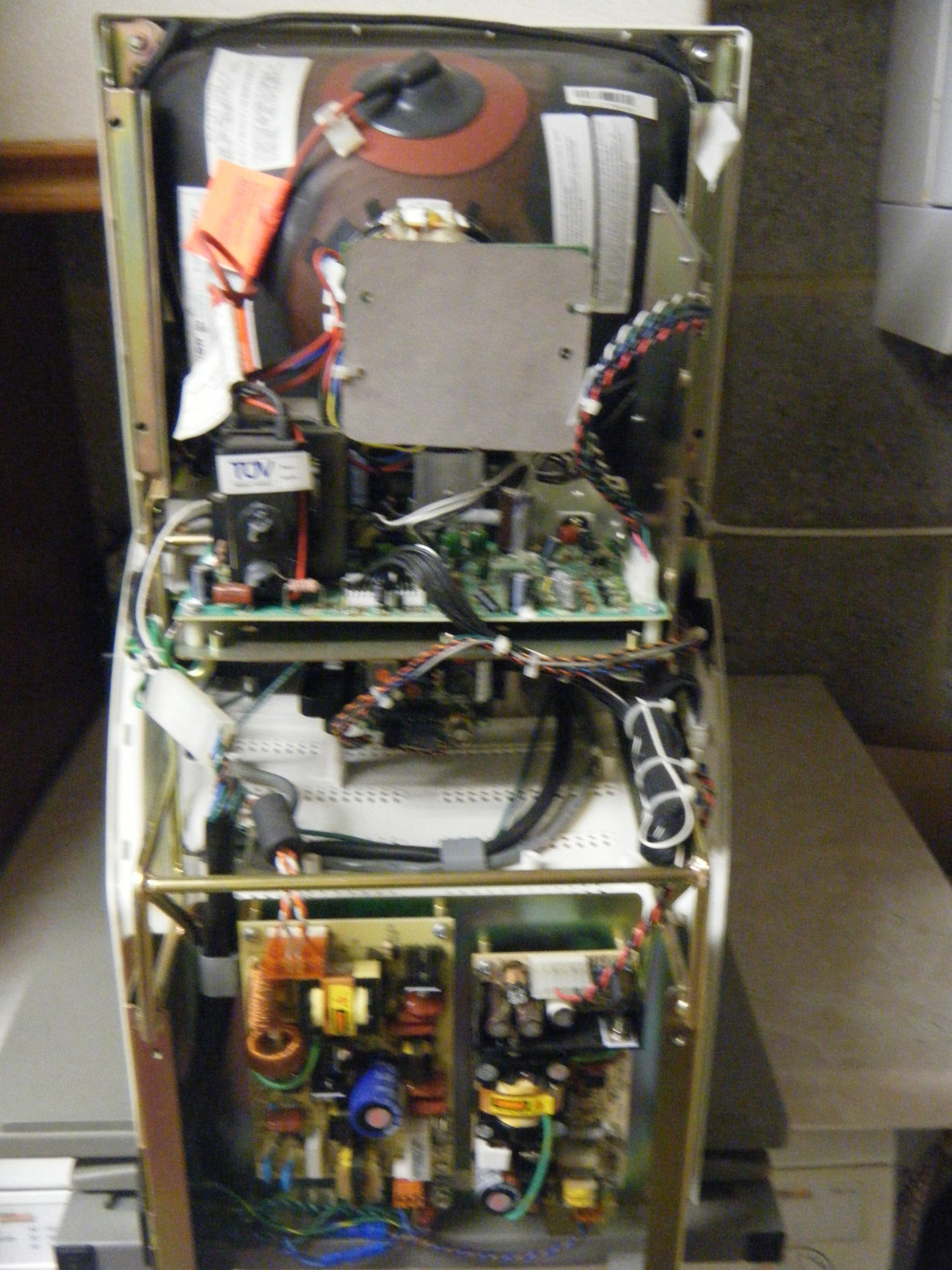

    Re: CRT TV, Telesensory Rainbow....Dead!!

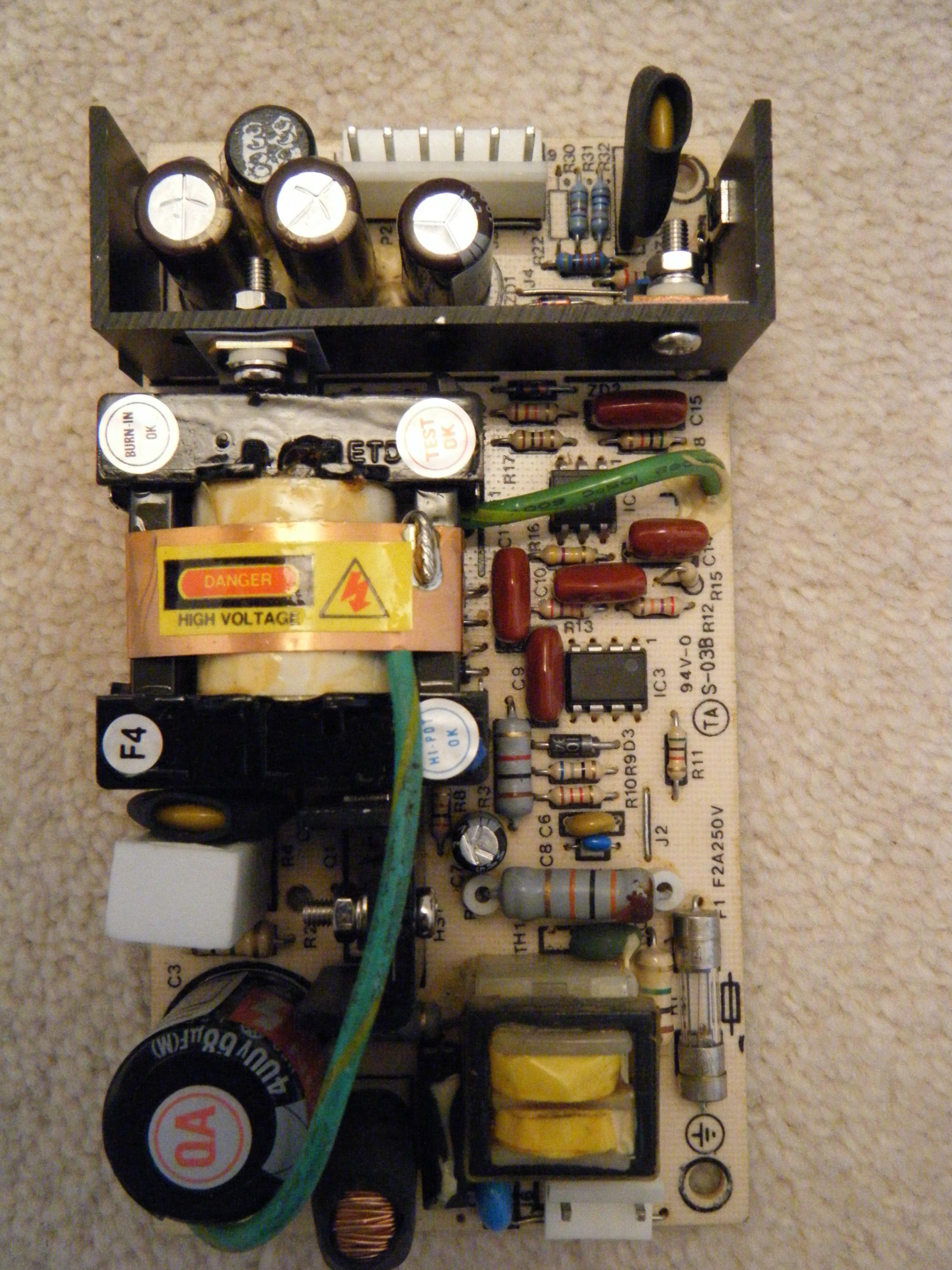

    My guess would be these are two power supplies one for the fluorescent lamps and one for the CRT monitor. The left one is for the bulb, right is for the monitor.
    https://www.badcaps.net/forum/attach...0&d=1370446733
    The CRT looks like it only has a single voltage requirement so check if that is present, see if the rating is labelled. But possibly around 100~150V DC if it is straight B+ for CRT... Could also be a 12V or 24V monitor.
    For a device which people depend on this is quite poorly made, I am very disappointed! Seriously, these units are not cheap, so you would expect they would put better components into them, and better care into assembling them.

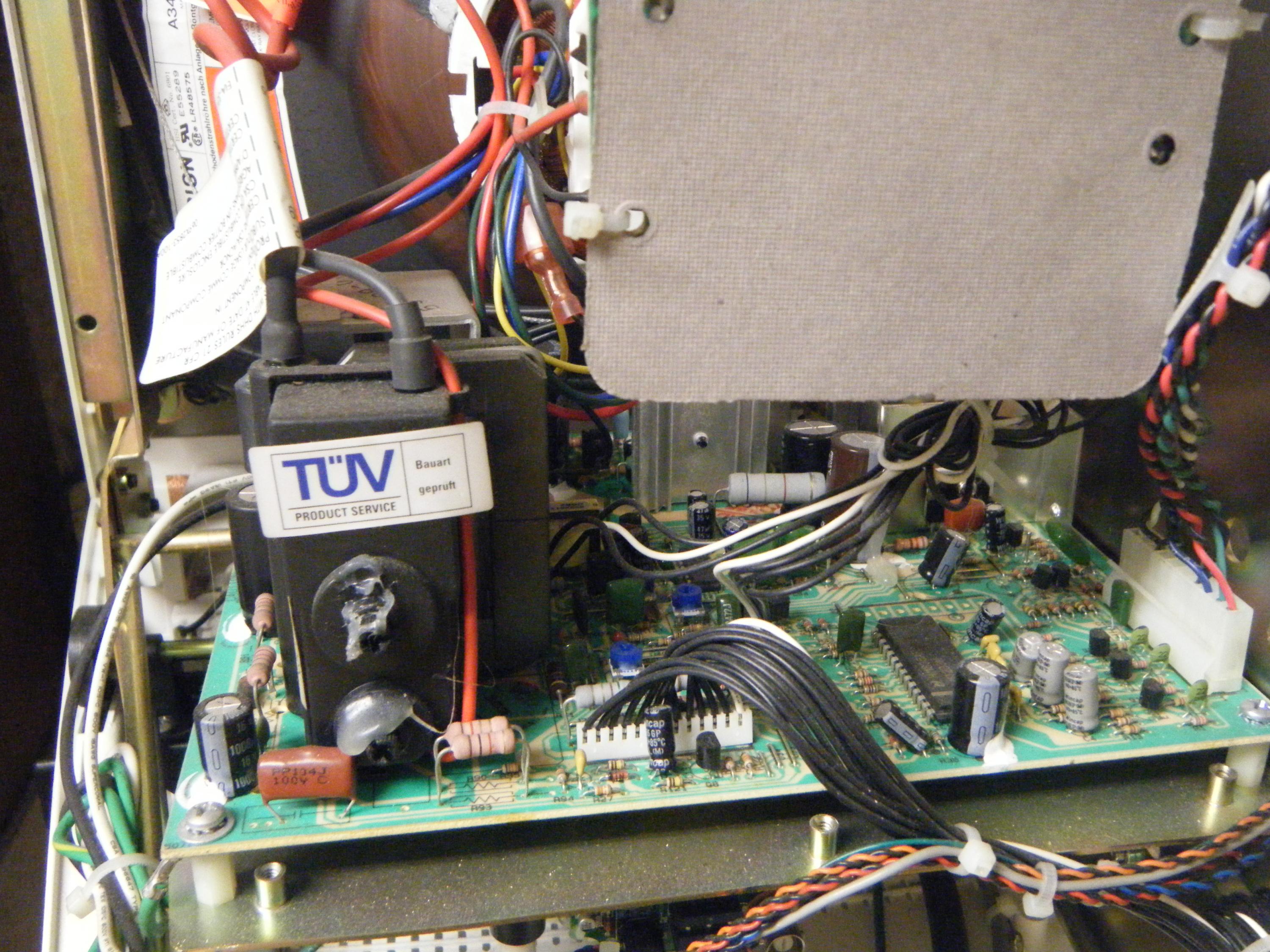

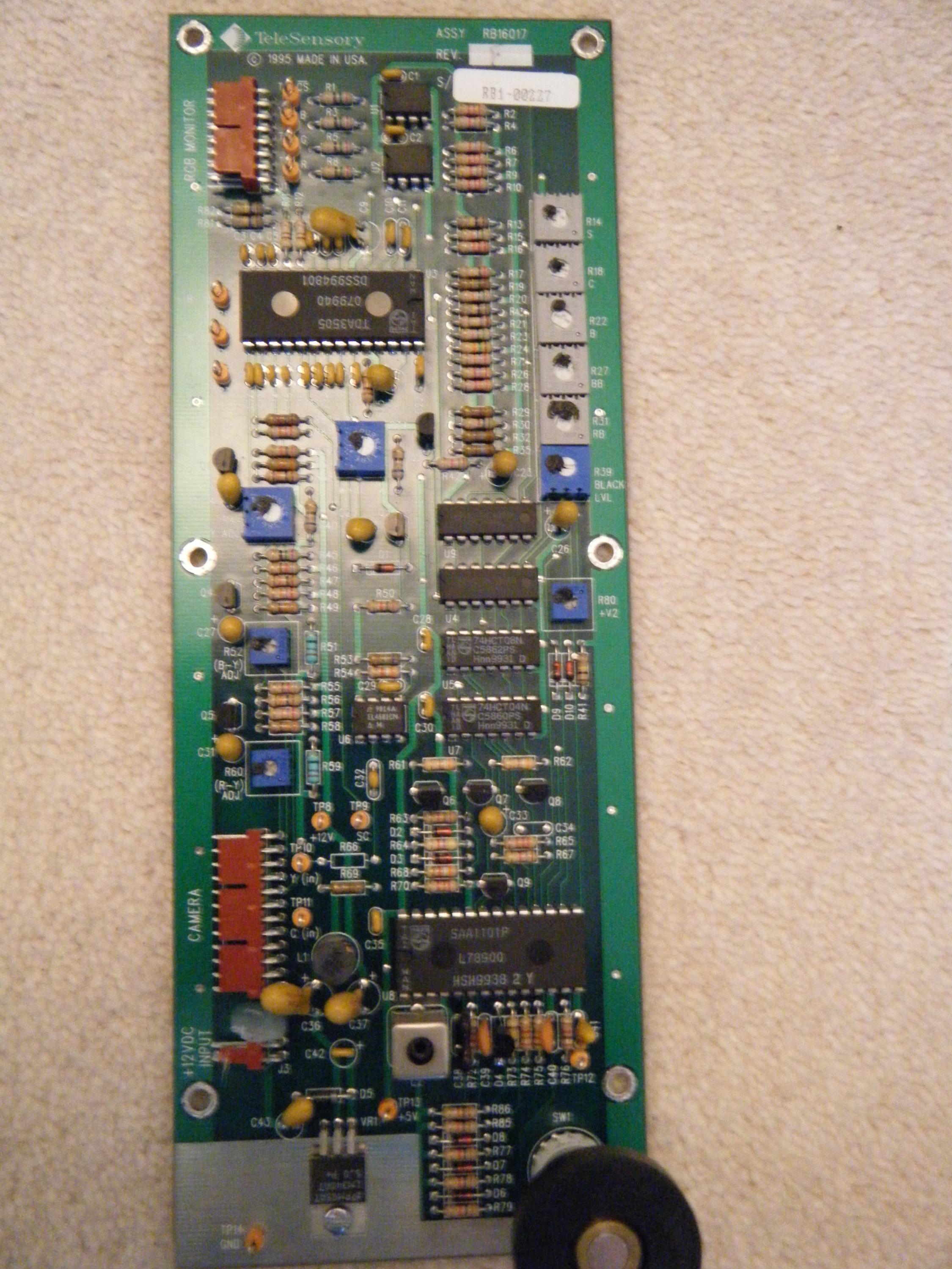

      Hi, On the last picture you will see a black/red pair that goes to a PCB on the side of the unit. I unplugged that cleaned contacts and refitted it and hey presto it worked!! It worked for a good few days swtiching it on and off, until today I switched it as I was going to return it I heard the sound of the screen energising but no picture. so I switched it off and tried again later and now no sound as the screen energisies. The lights operate that are used to illuminate the newpaper etc.
      Suggestions? Tom made reference to some things but sure where they are likely to be to check.
        The sound as you switch on is likely the degaussing circuit operating (this is usually controlled by a PTC device in series so it only operates for a split second at switch-on from cold).
        What this means is that the CRT's board is getting power - can't see what's under there but my initial investigation would be centered around the line output transistor and associated circuitry (these often fail short and cause a cascade failure in the SMPS or, if you're lucky, fail open and replacement will fix the fault).
        You should also check for dry joints around the line output (flyback) transformer if the fault is intermittent as quite a number of the necessary voltages inside a TV are generated from that.

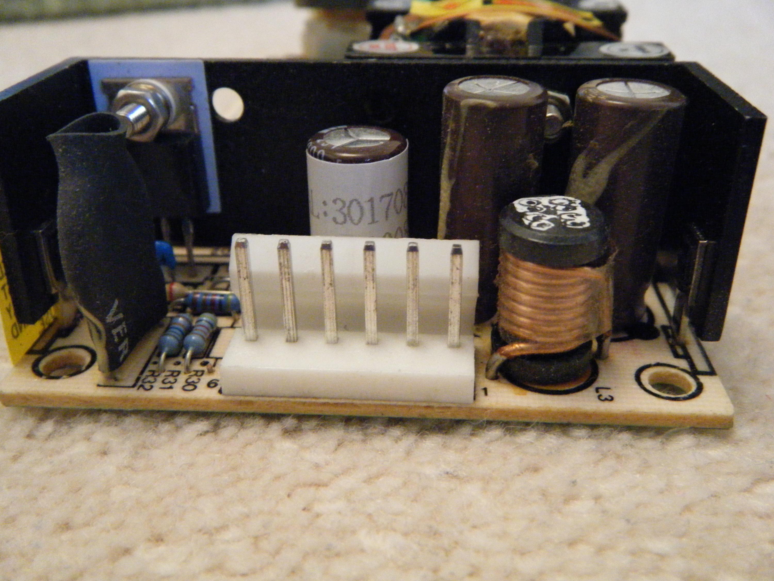

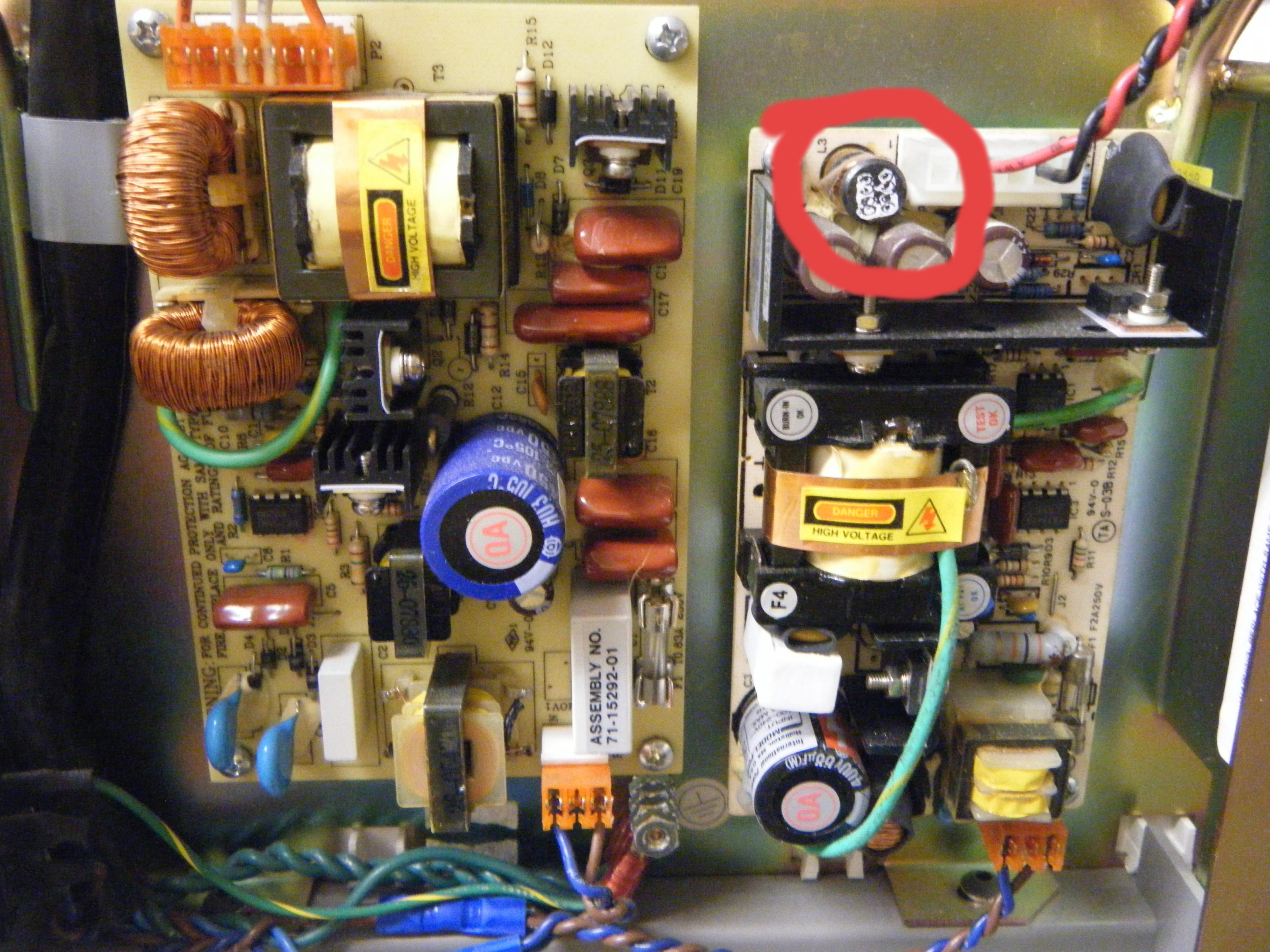

          did anybody notice this choke is burnt?

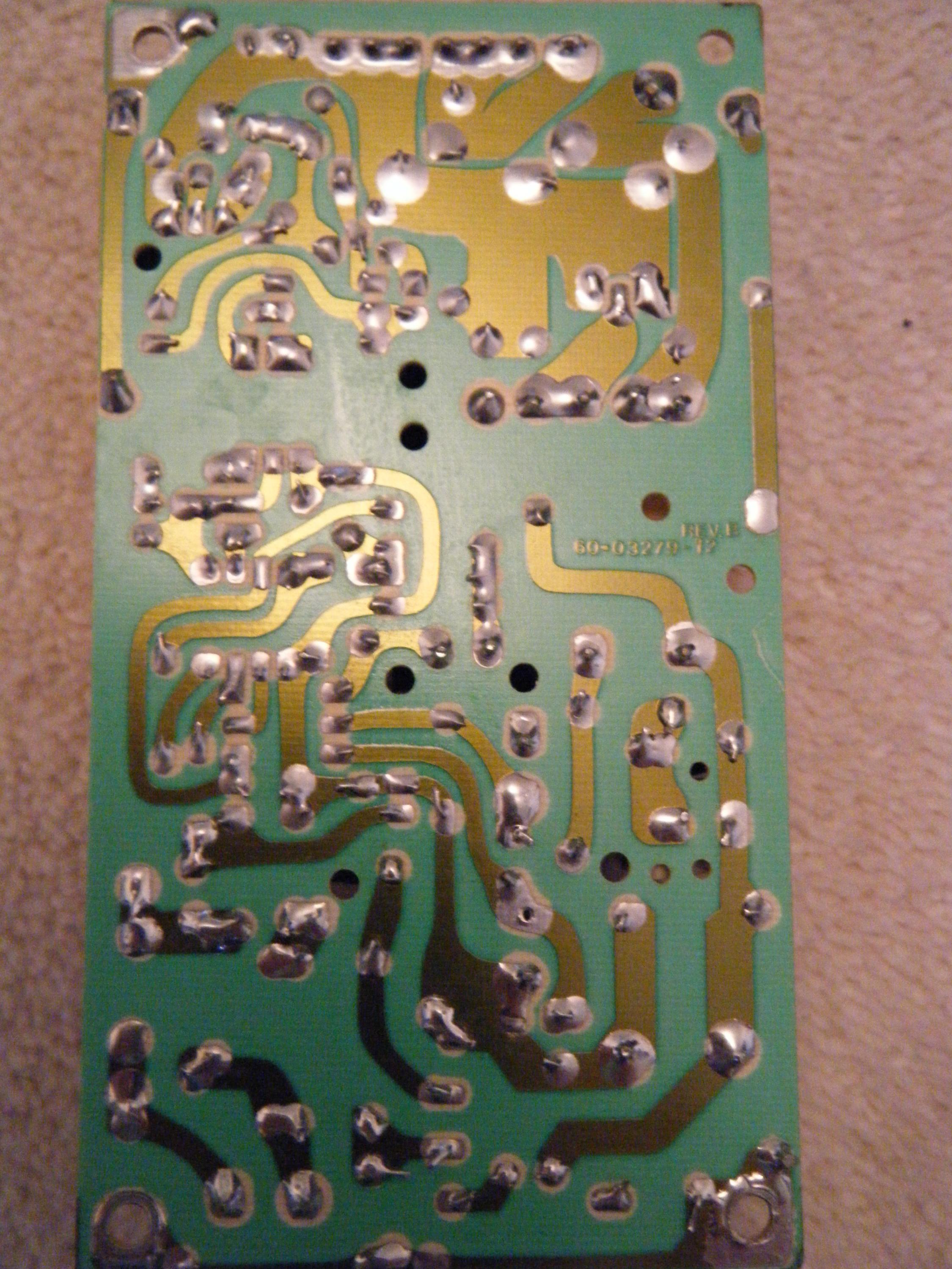

          could you take pics of the bottom of the board
          Follow the white rabbit.
            Is it? Just looks like varnish to me.
                Either way, are those Elna audio capacitors in an smps?! The two just under that inductor.
                Muh-soggy-knee
                  ...Elna make a LOT more than audio capacitors. They also make low ESR capacitors suitable for SMPS.

                    Thank you for all the input, so far I have checked for dry joints on the PSU, I have reflowed the 12v pins on the PCB that the PSU feeds that is located on the side of the unit. See pics of the two PCB's.
                    I checked that the PSU was outputting 12v to the side PCB and it is. The light system works but I guess thst is driven by the other PSU.

                          We are looking in the wrong spot. You can see in the first picture, white and black wires (neutral and line) going to the crt board. That is the board we need to look at.
                          Look on that board for burn marks, bad solder joints, or blown fuses. Test all fuses. Could you take some good pictures of that board, bottom side and a few different angles of the top side, please?
                          Also, have you tried un-plugging the 12v cable from the power supply, then plug it back in? Could be a bad connection on the connector contacts.

                            I say 12v as the right hand PSU outputs 12v at switch on and the PCB to the side it feeds (see pictures) has 12v written on the PCB. I can hear a sort of low sound like a creaking sound from the rear of the monitor/PCB below it.

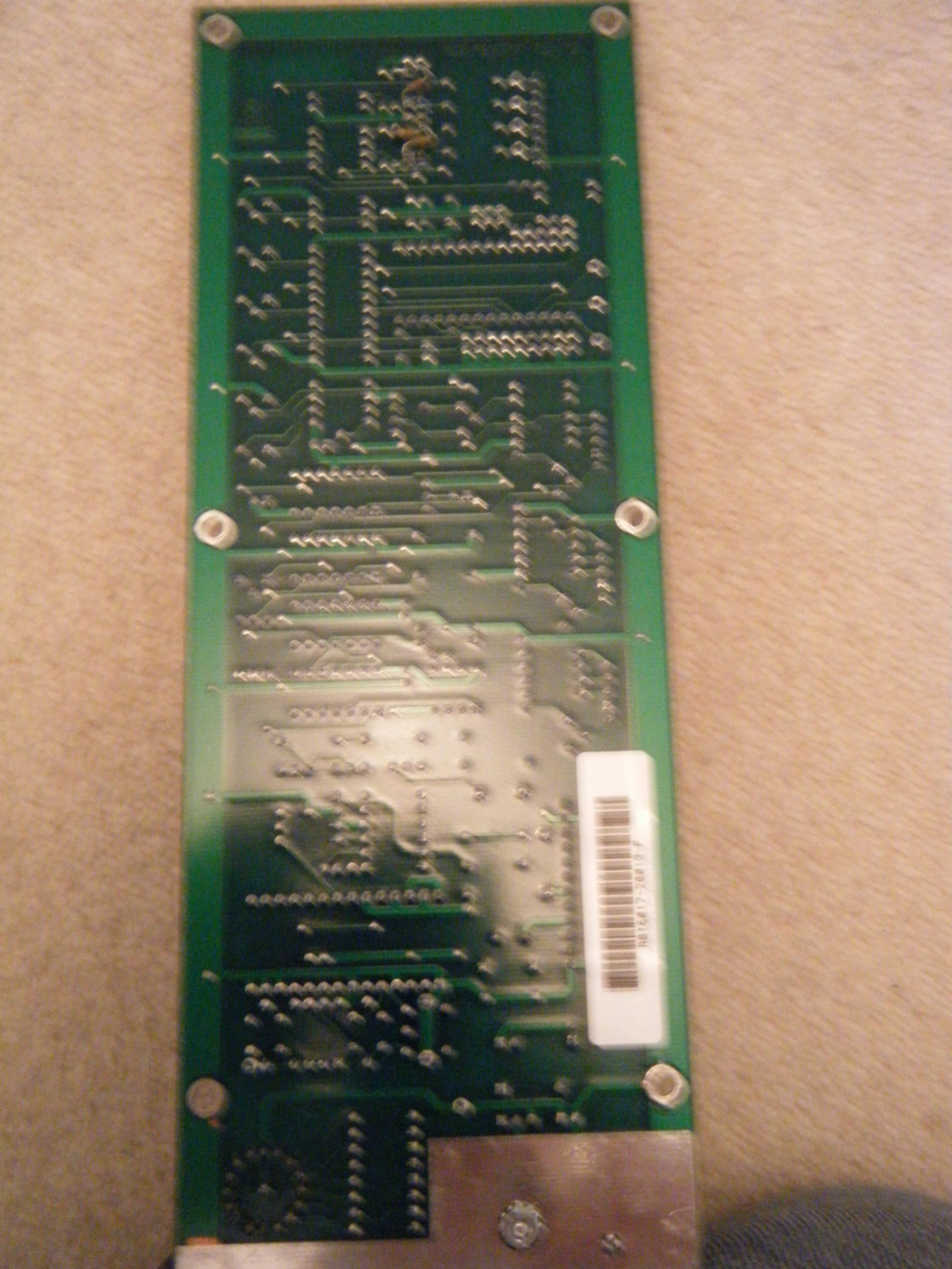

                                    I saw you mnetioned about the choke which to me looks OK, I did take some pictures as per your request, do you have any thoughts. I apriciate TOM66's suggestion, but the thing is the guy has used this for years and only wants this back. So I am trying to do all I can to help.
