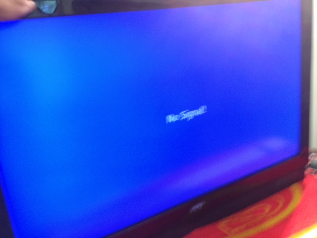

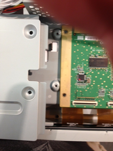

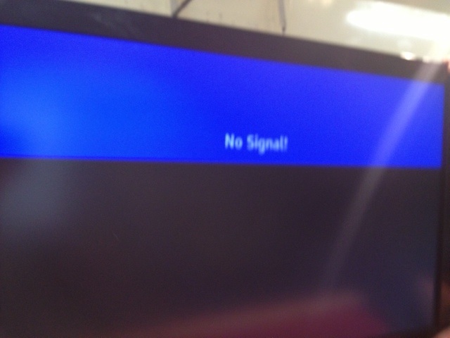

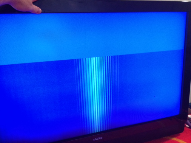

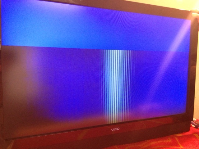

Vizio VW42LHDTV10A screen blue with lines
  • BryB
    • May 2013
    • 10
    Vizio VW42LHDTV10A screen blue with lines
    My TV was given to me by my brother because it went out and he didn't want to mess with it. The TV would turn on, screen was black and it would not turn off by the power button. I found the readings on U33 were off so I replaced it. Now the screen is blue with lines but I can also turn it on and off using the power button. Any suggestions on what will help with the screen now?
  • Pentium4
    CapXon Be Gone
    • Sep 2011
    • 3741
    Re: Vizio VW42LHDTV10A screen blue with lines
    I'm think that the T-con board or the panel is bad
    • BryB
      • May 2013
      • 10
      Re: Vizio VW42LHDTV10A screen blue with lines
      Sorry, I am somewhat a newb posting on forums, here are pictures of when the TV is first turned on and then after sitting a minute, with a black shadow like area at the lower left hand corner. Could it still be the Tcon board or the panel? Thanks for your reply Pentium4.
      Last edited by BryB; 06-02-2013, 04:08 PM.
        Re: Vizio VW42LHDTV10A screen blue with lines
        I am betting panel.
        This fault is very similar.
        https://www.youtube.com/watch?v=GcBwTums_mI
        • BryB
          • May 2013
          • 10
          Re: Vizio VW42LHDTV10A screen blue with lines
          Panel? Ugh, I hope not! Thanks tom66
          • BryB
            • May 2013
            • 10
            Re: Vizio VW42LHDTV10A screen blue with lines
            Originally posted by tom66
            I am betting panel.
            This fault is very similar.
            https://www.youtube.com/watch?v=GcBwTums_mI
            I'm not sure it's worth changing the panel, might cost close to the same for a new TV. Is there any way that I can test the panel to be sure before spending the money?
              Re: Vizio VW42LHDTV10A screen blue with lines
              The video linked goes through that procedure, and no, changing the panel is very unlikely to be economical.
              • BryB
                • May 2013
                • 10
                Re: Vizio VW42LHDTV10A screen blue with lines
                That's what I was afraid of, thanks again tom66
                • BryB
                  • May 2013
                  • 10
                  Re: Vizio VW42LHDTV10A screen blue with lines
                  I may be grasping at straws here but I just took the cover off of the Tcon board to check the ribbon cables and realized that there are no screws holding the board in the tv. My brother must have had it opened at some point, or someone has and didn't put the screws back. Around the board is copper, are the screw points grounds for the board?
                  • johnboy1313
                    • Nov 2012
                    • 1959
                    Re: Vizio VW42LHDTV10A screen blue with lines
                    Yes they are
                    • BryB
                      • May 2013
                      • 10
                      Re: Vizio VW42LHDTV10A screen blue with lines
                      Great, just found out that my brother did change out the T-con board, lost the screws and looks like installed the wrong t-con board since the mounting holes do not line up.
                        Re: Vizio VW42LHDTV10A screen blue with lines
                        You need to ask him if the problem was the same before and try to get the old T-con off him. Failing that get us the LCD panel sticker (e.g. AU OPTRONICS TC4150W9XXX) and we can potentially find a guaranteed compatible replacement; my opinion is though that it is the panel and an incorrect T-con would not cause that.
                        • BryB
                          • May 2013
                          • 10
                          Re: Vizio VW42LHDTV10A screen blue with lines
                          He said the screen went black and it had colored vertical lines back in January. He is sending me the original T-con board. I will update again after I get the board and troubleshoot further. I'm just trying to keep from buying a panel or throwing the TV away if I can help it.
                          • BryB
                            • May 2013
                            • 10
                            Re: Vizio VW42LHDTV10A screen blue with lines
                            UPDATE!! :-D
                            Got the T-Con board from my brother in the mail today, installed (screw holes lined up perfectly (even sent the screws LOL)) And here are the results! Turns out it WAS the wrong T-Con board and U33 was bad after all.
                            Thank you everyone for all your help, I appreciate it!!
                              Re: Vizio VW42LHDTV10A screen blue with lines
                              Nice one! And I am surprised a wrong T-con could cause that, I would have expected no picture at all.
                              • Stanley1843
                                by Stanley1843
                                06-29-2024, 11:54 AM
                              • jeyoung12
                                Samsung QN50Q60t lines on screen
                                by jeyoung12
                                Hi all
                                I have lines on the screen...which is an age old problem that can be remedied by watching Youtube videos and getting out the tape.
                                My issue (after successfully fixing a different sammy tv with a separate tcon board and isolating the side of the panel...):
                                This tv has an integrated tcon...so it is a bit more confusing when trying to isolate the clocks.
                                It has a c ribbon and i have taken each end out to see if that will isolate the lines. instead, it makes it much worse ALL over the tv!
                                So....i don't know what end of the C ribbon to work with...
                                02-26-2024, 10:38 AM
                              • Ryan.man
                                by Ryan.man
                                02-04-2025, 12:23 PM
                              • hiperco
                                Vizio M492i-B2 with periodic lines on the screen
                                by hiperco
                                Having an issue with periodic lines on the screen. Any suggestions on which board(s) to blame first? Video below
                                VIDEO
                                Link to another post with pictures of boards etc
                                02-19-2023, 12:16 PM
                              • kdaniel
                                Hitachi 58HK6100U - Horizontal Lines (Bottom third of the screen)
                                by kdaniel
                                As stated by the person I collected the TV from, it just stopped working overnight. However, I still gave it a go to try and repair it.
                                There is a thread on the same TV but with slightly different issues where they had to tape connection points on the ribbon cable, so I want to see if this is repairable by any chance.
                                After bringing it home and plugging it in, the TV turned on with its backlight working but had no picture. After removing the back cover, the first thing I tried is to unplug one of the ribbon cables and the situation is as follows.
                                Left...
                                11-16-2022, 09:23 AM
