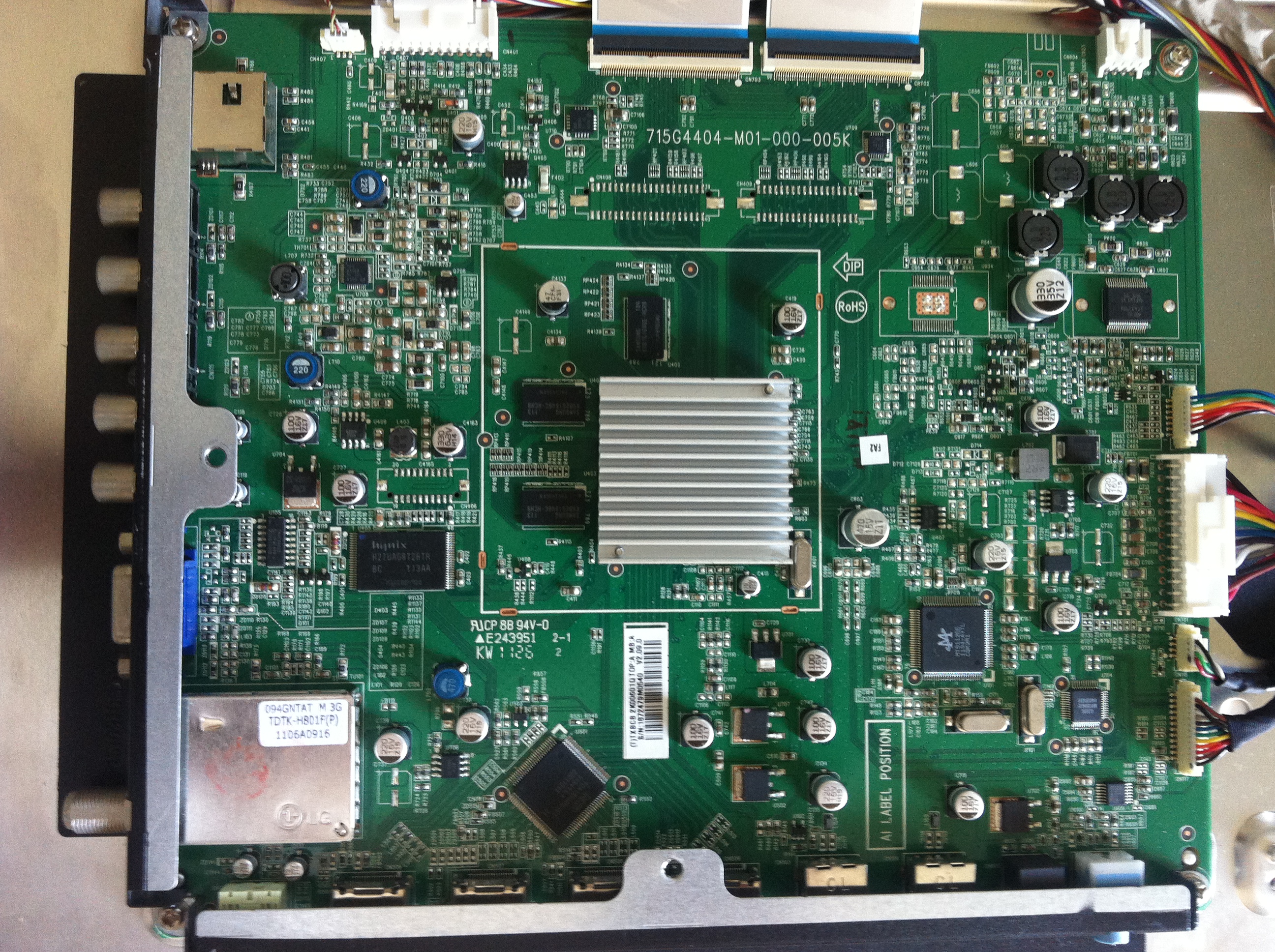

    I have a Vizio M3D421SR no sound, no image, TV powers up and the logo light turns white. Power board board voltage 23.89v, 5.217v, 12.2v main board# 715G4404-M01-000-005K

    Re: Vizio M3D421SR
    I have the same tv, same problem, exactly the same main board. I could not find the problem and sent the main board out to be repaired.
    I used the repair service currently offered on E-bay for $89. I highly recommend their service. Very fast turn around and they fixed the problem.
    Apparently, this is a common problem with this tv but the solution isn't common knowledge.

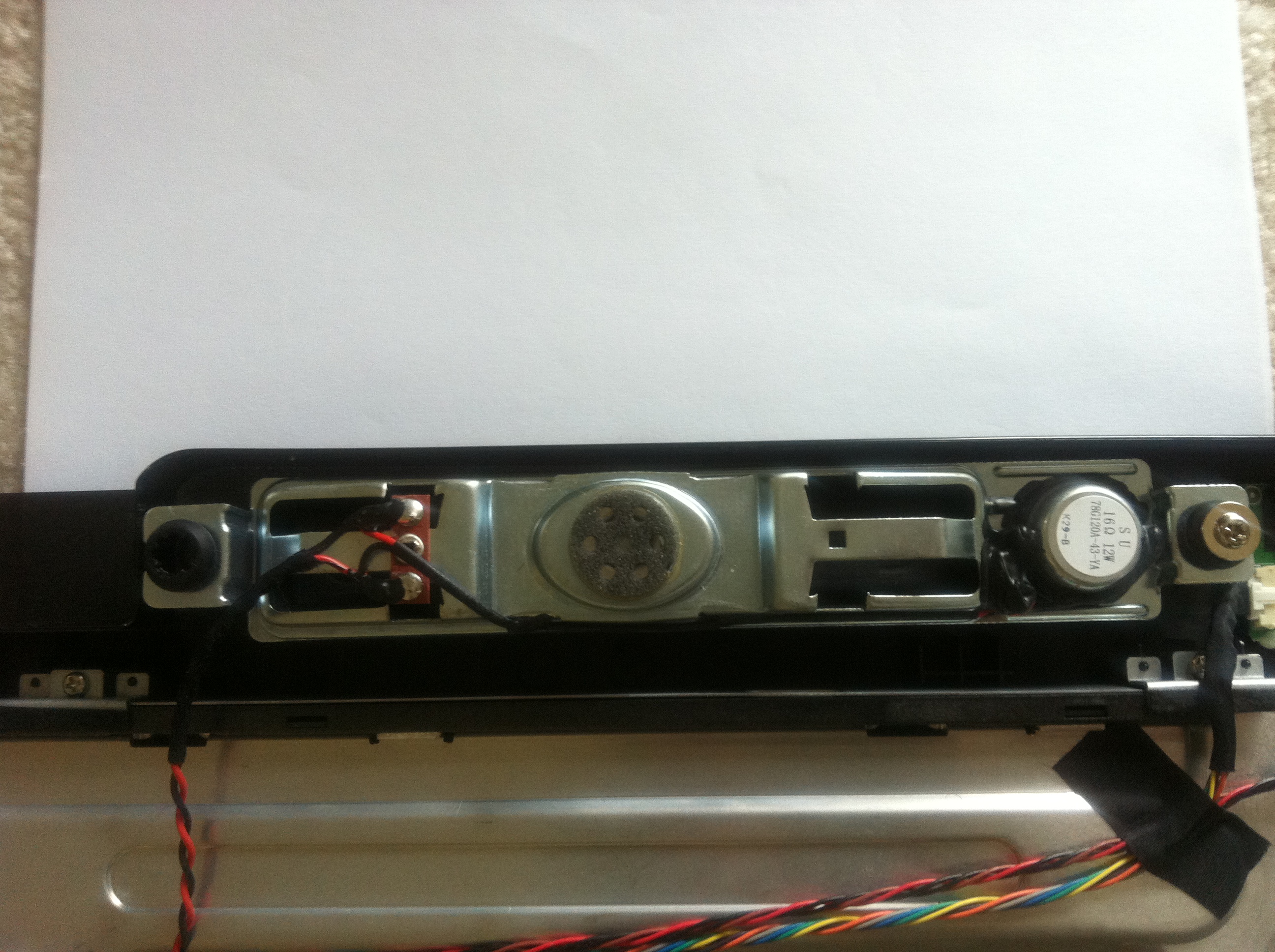

    I'm still trying to find a set of internal speakers for this tv. Would you be so kind as to post any numbers that are marked on them - or posting a good photo would be appreciated.
    I got the set from a recycler and the speakers were missing.

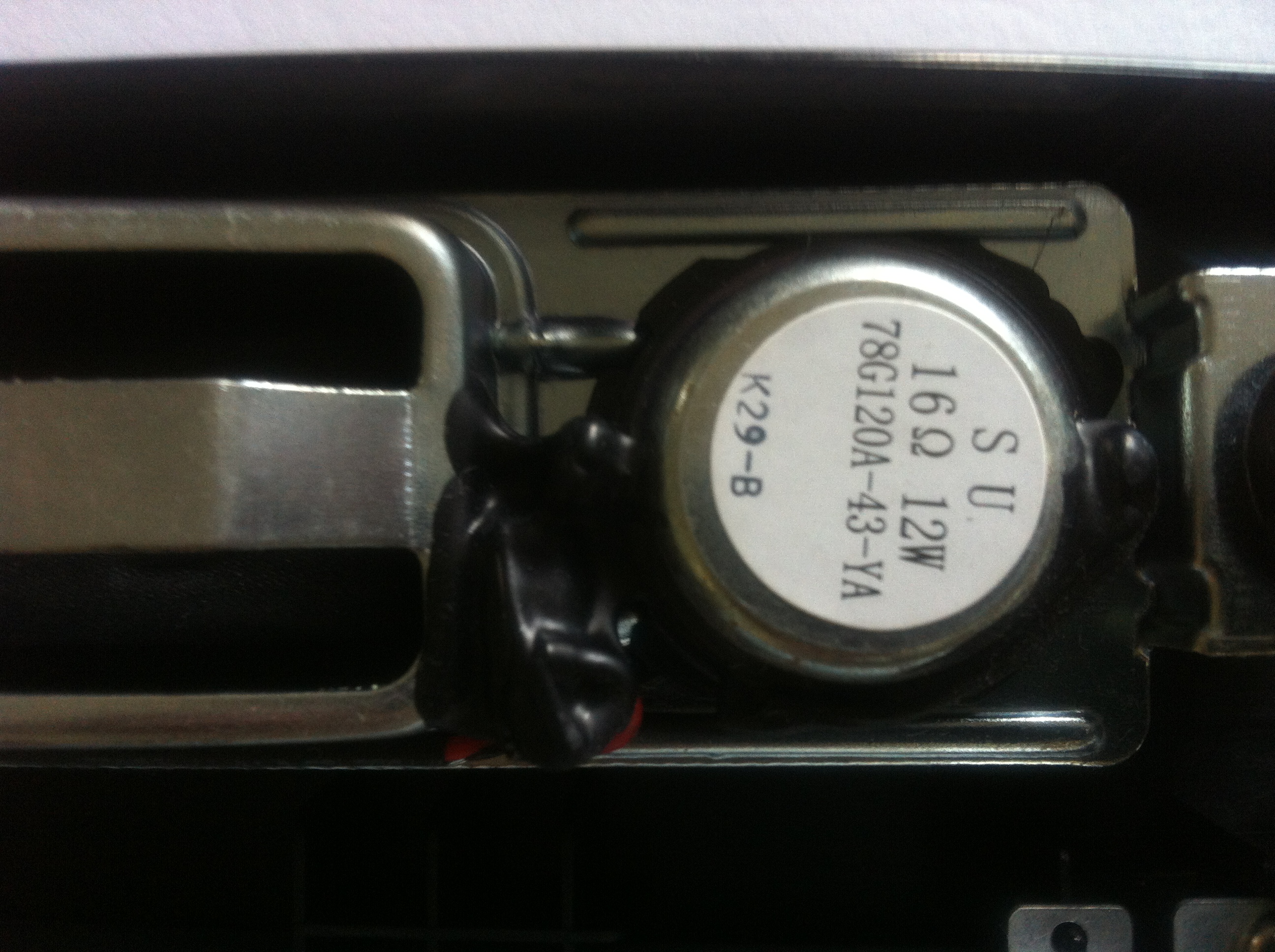

      Re: Vizio M3D421SR
      Thanks Mike, here is the speaker information. If possible someone please post a diy fix here.

          Re: Vizio M3D421SR
          24V,
          Thank you very much for posting the speaker photos. Looks like the speaker is some kind of combination woofer and tweeter. At least I have part numbers that I couldn't get from Vizio.
          Regarding the problem on the main board. I suspect that problem is in the area of the processor - perhaps poor solder joints. Just a hunch!

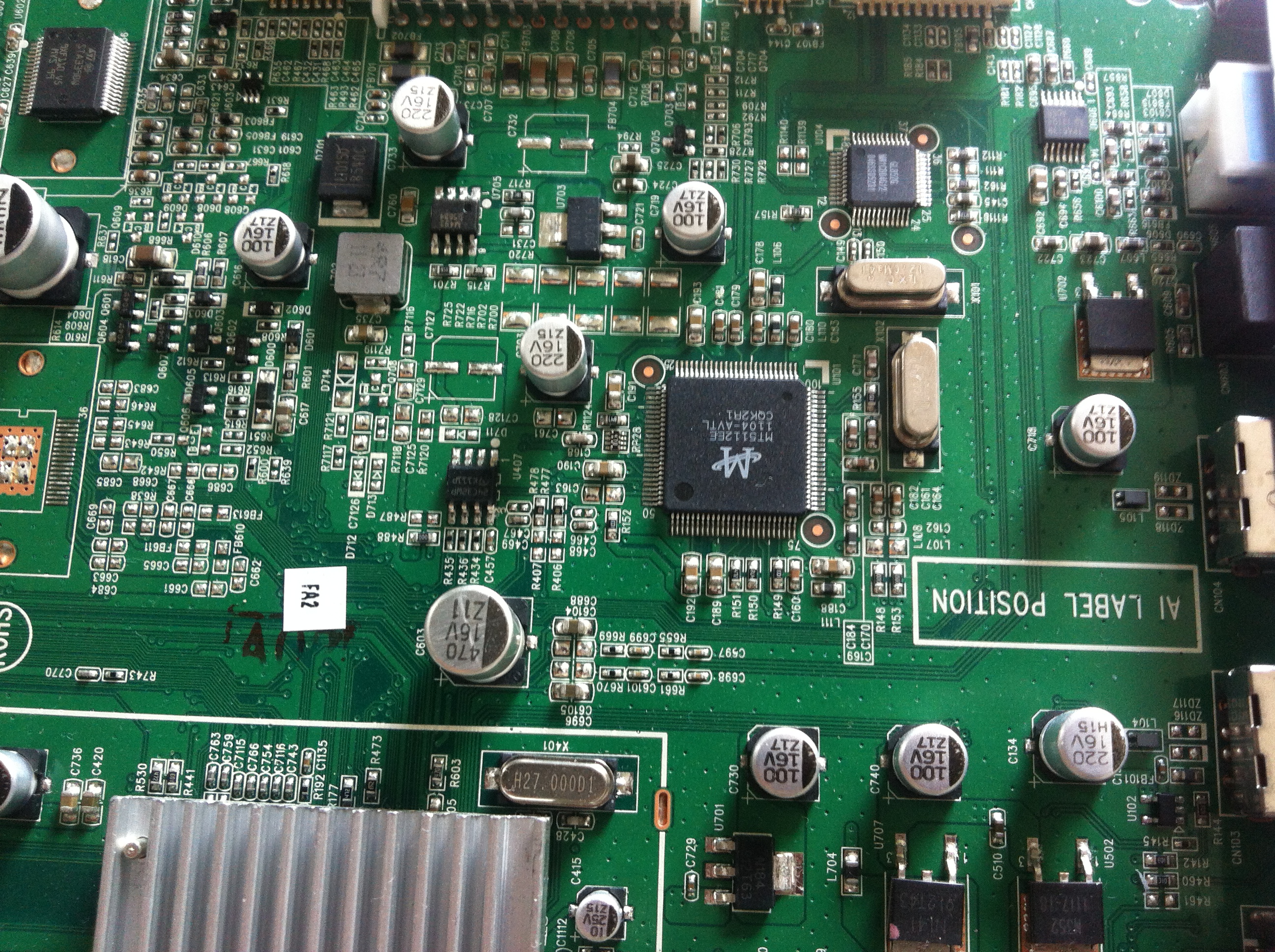

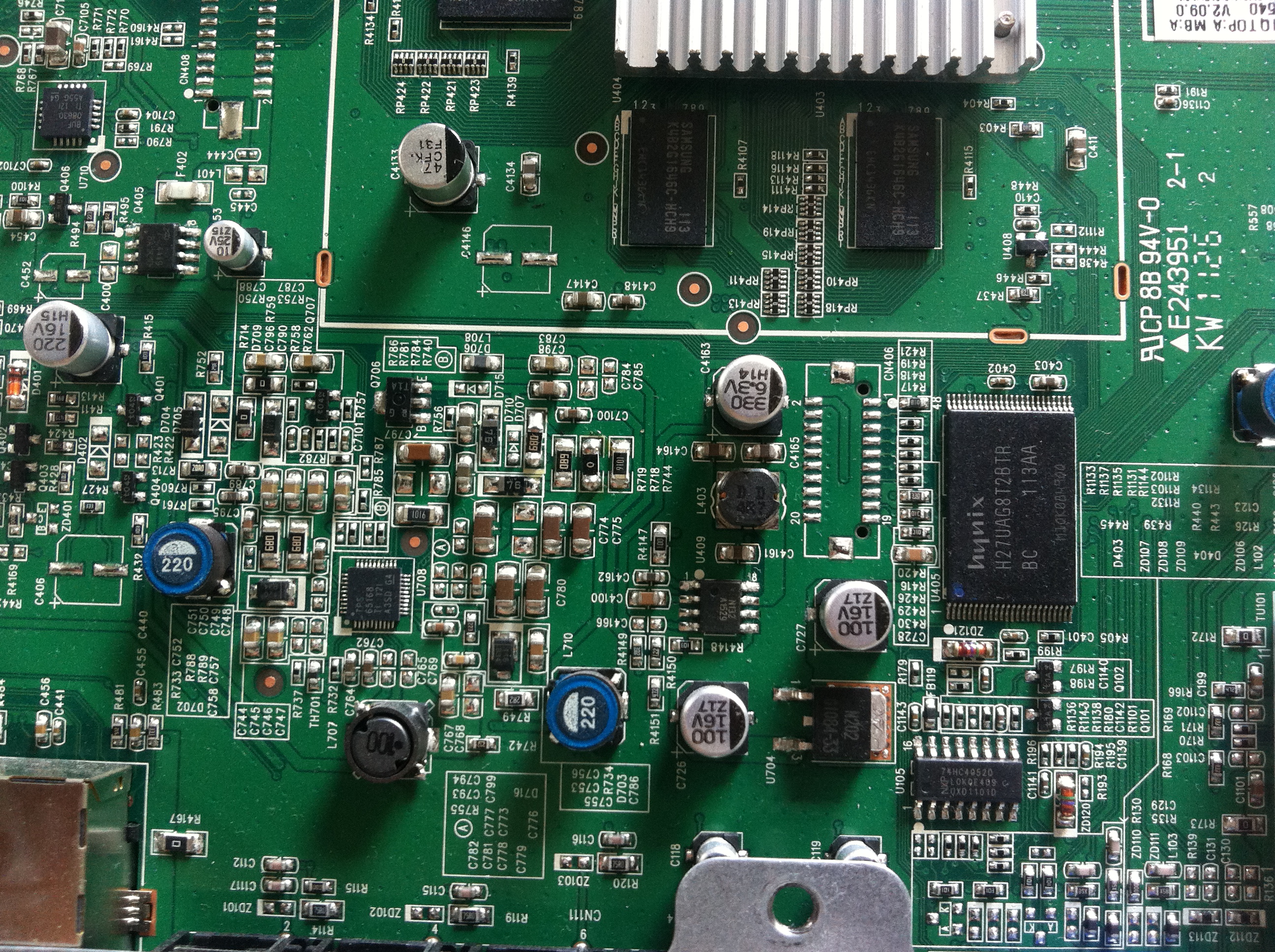

            Has anyone fixed this issue? I have a unit with the exact same problem and have searched high and low for a solution. I Have tested ps voltages and the voltages on the regulators. one regulator was low and i replaced it to no avail. there is still another regulator which is a little low. it reads 3.28 out it is supposed to be 3.3 is that too low?
            Anyone have any technical documentation for this or related models?
            m3d420sr, m3d460sr, m3d550sr
            the motherboards are almost identical physiclly with the 420 and 421 being the same.
            I really dont want to send the board to the ebay guy as i have already replaced a regulator and he may not want to work on it.

                        Re: Vizio M3D421SR
                        i got my main board back today and the tv is working fine. after talking to the repair guy from the ebay service and thoroughly inspecting the board im pretty sure they just reflowed the solder on the processor much like you would do to a xbox360 with rlod or ps3 with ylod. they also changed a voltage regulator but the one they changed i had already changed. it was the 1117-18 regulator which i had swapped with one from a 360. i have encountered other main boards with the solder issues as well. infact it seems like this is an issue amongst all surface mount processors as they produce heat and the boards in tvs are very likely to flex and pop the solder joints. good luck with your repair. i highly recommend the service for anyone who is not able to reflow the chip themselves. in the future i will be doing this myself. oh and a side note: i am a technician at a tv repair shop, i got this tv for free because we could not find a replacement main and the cx asked us to dispose of it. $89 for a smart tv oh yeah!!!
