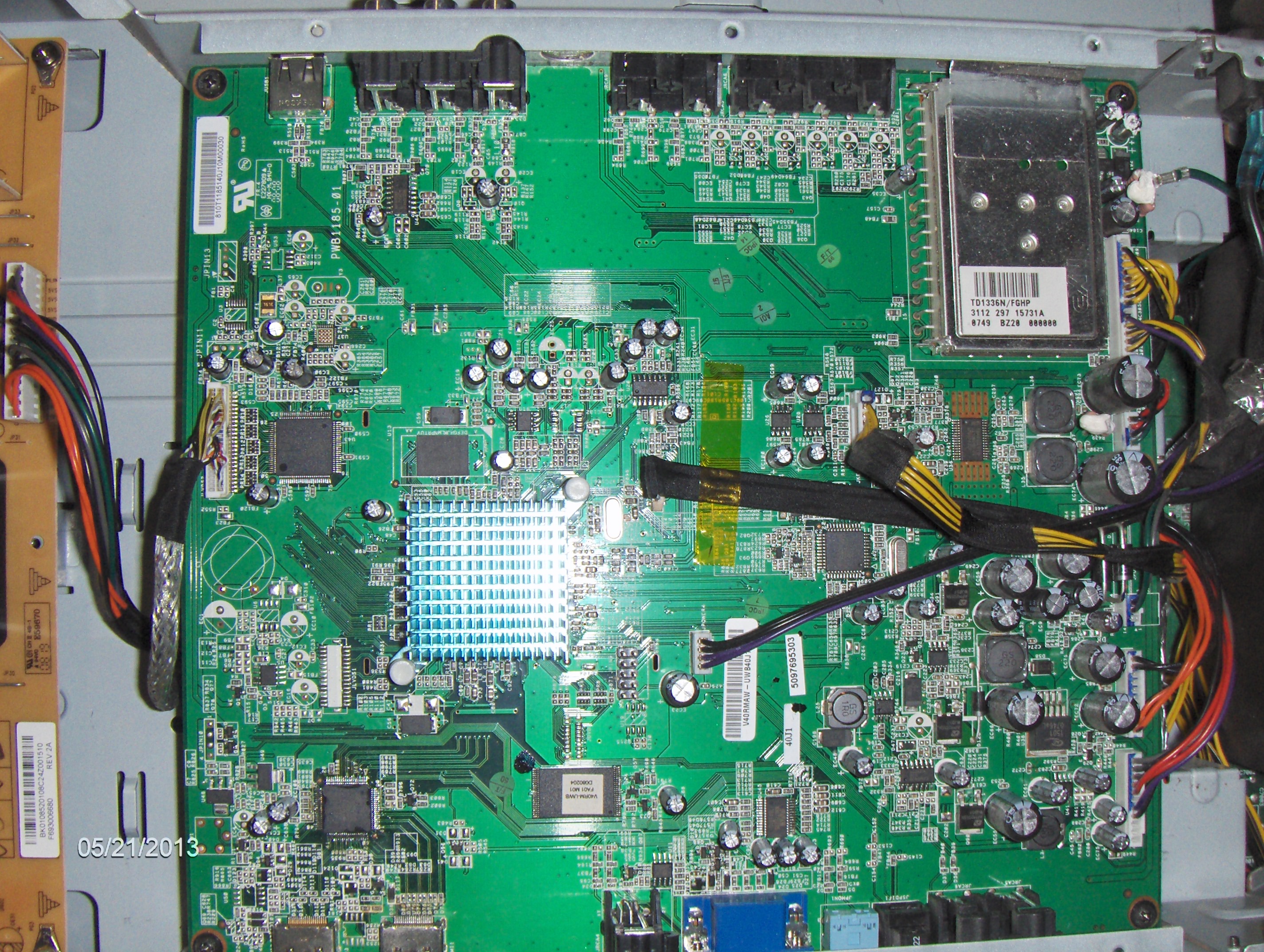

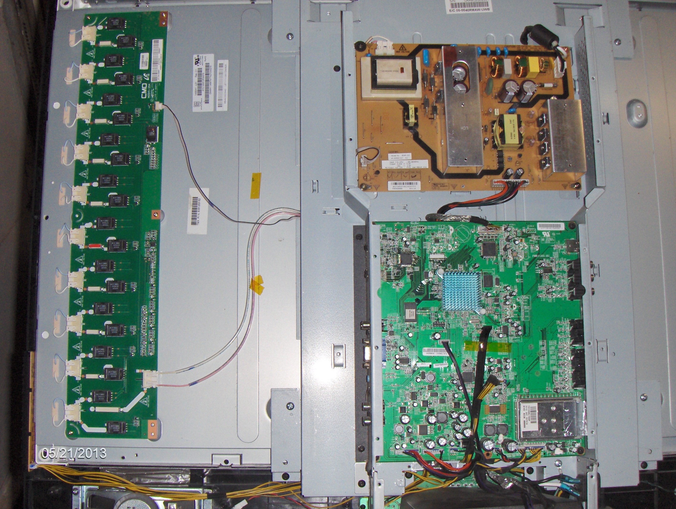

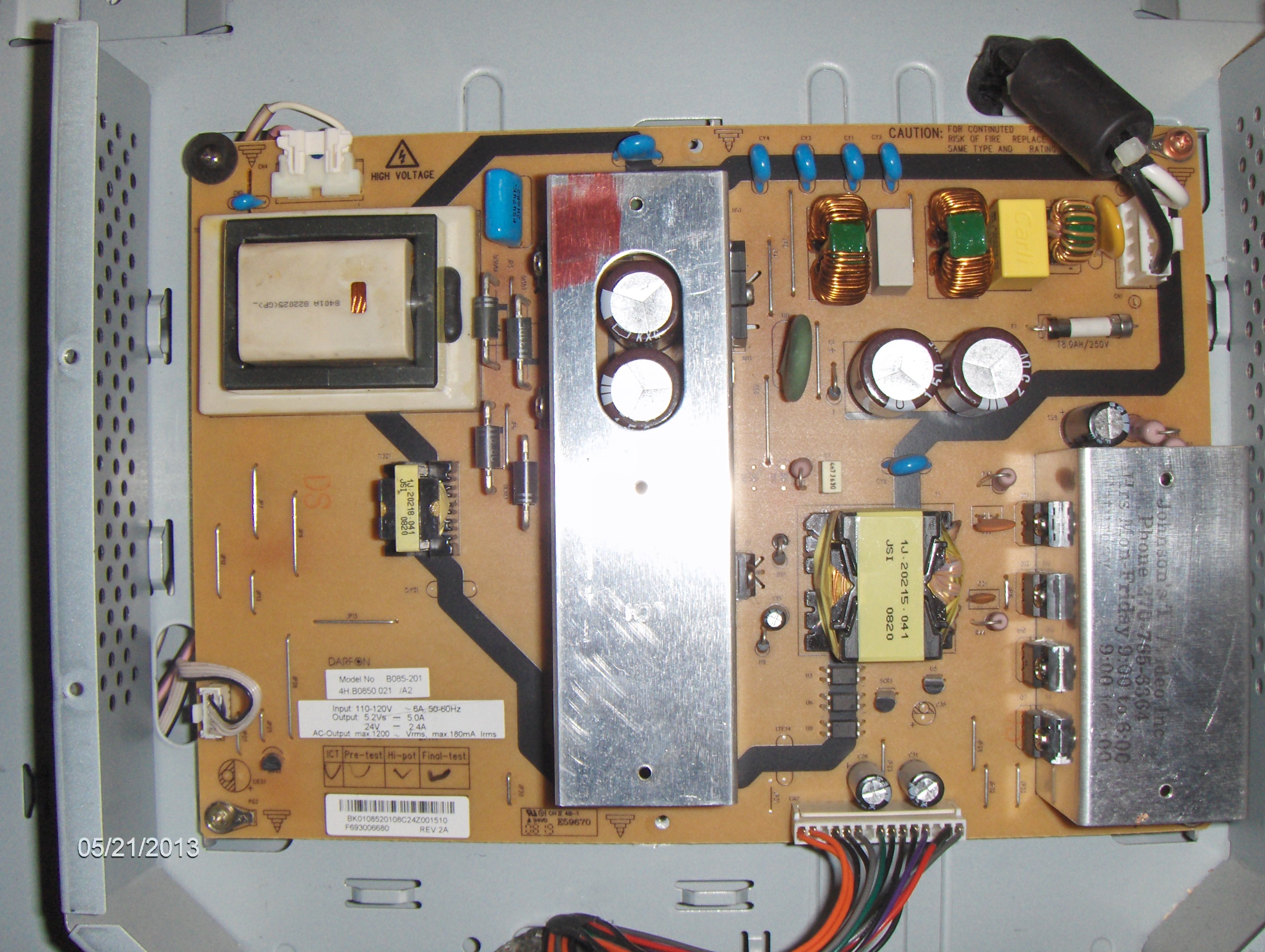

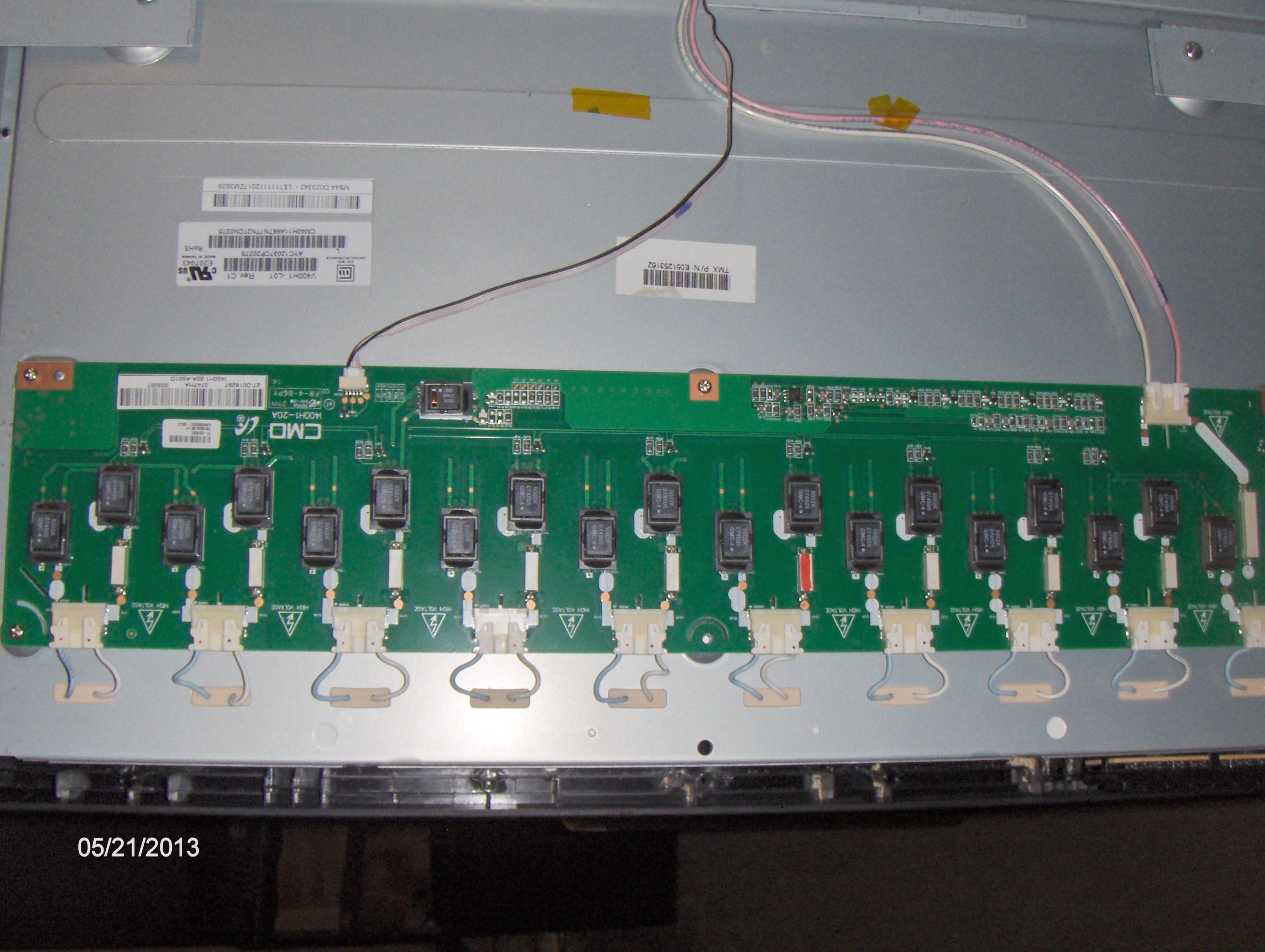

      Here are photos of the boards in the TV,
      the power board number is F693006680
      Main Board 5097695303
      Inverter 1400H1-20A
      I am not getting any back lights, The power board is putting out the voltages that are required on the silk screen. I tested the primary side of all the transformers on the inverter board and they all test good. Just for giggles I installed a known good power board and it made no difference. I have not checked the T-Con, will a bad T-Con prevent the back lights from working???

        I checked the voltage at each transformer on the inverter board as the set was turned on. Non of them exceeded 1.9volts but quickly went down to 0 but all the voltages out of the power supply stated the same.
        On the main board
        U31 5V
        Q90 5V
        Q91 5V from center pins
        Q92 5V
        U48 Pin1 2.0V, pin2 3.3V pin3 5.2V
        U49 pin1 .56V, pin2 1.8V pin3 3.3V

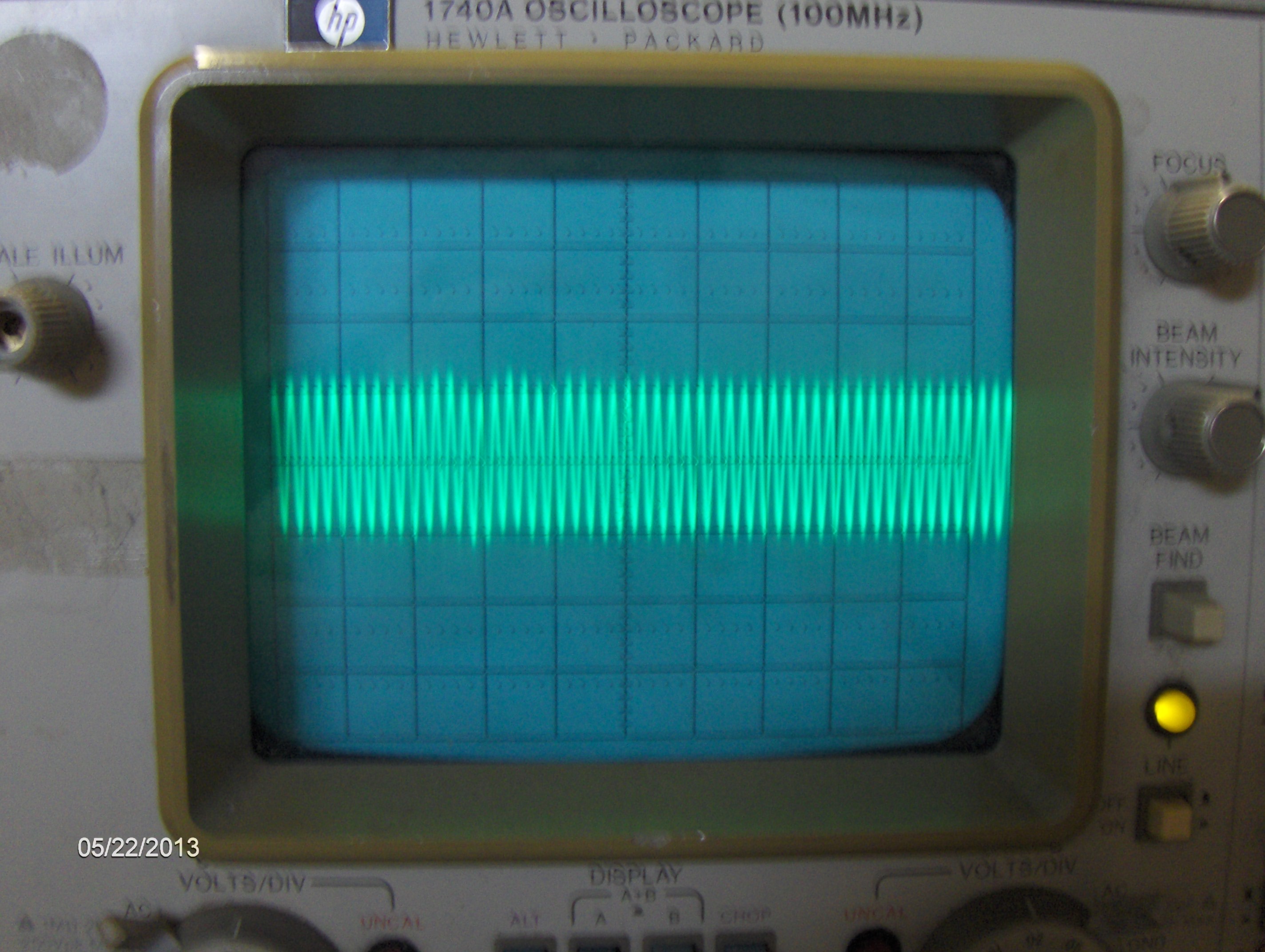

        I scoped the connector to the T-Con and the photo shows the display I received on all pins The scope was set to Time/Div 05 and Volt/Div .005

          That power supply board is the combo inverter/power supply board, the two wires (PINK, WHITE) on the top left of the board is the high voltage output connector which feed the Backlights balancer board, each one of those little transformers on the Balancer board are current sensing transformer for each lamp, if the lamp draws to much current, the FBK pin will go high to trigger the inverter circuit to go into shutdown mode, it works the same as SONY/SAMSUNG design.
          You can ground FBK pin to ground using 100 Ohms resistor to see if the lamps will at least flash for seconds, you may want to look at them in the dark room.
          Can we see good pictures of the bottom side of the Inverter/power supply?
          You can make something like this for testing to see if the high voltage transformer is putting any high voltage pulse at all; Just touch that probe to one of the Pink/white connector one at a time.
