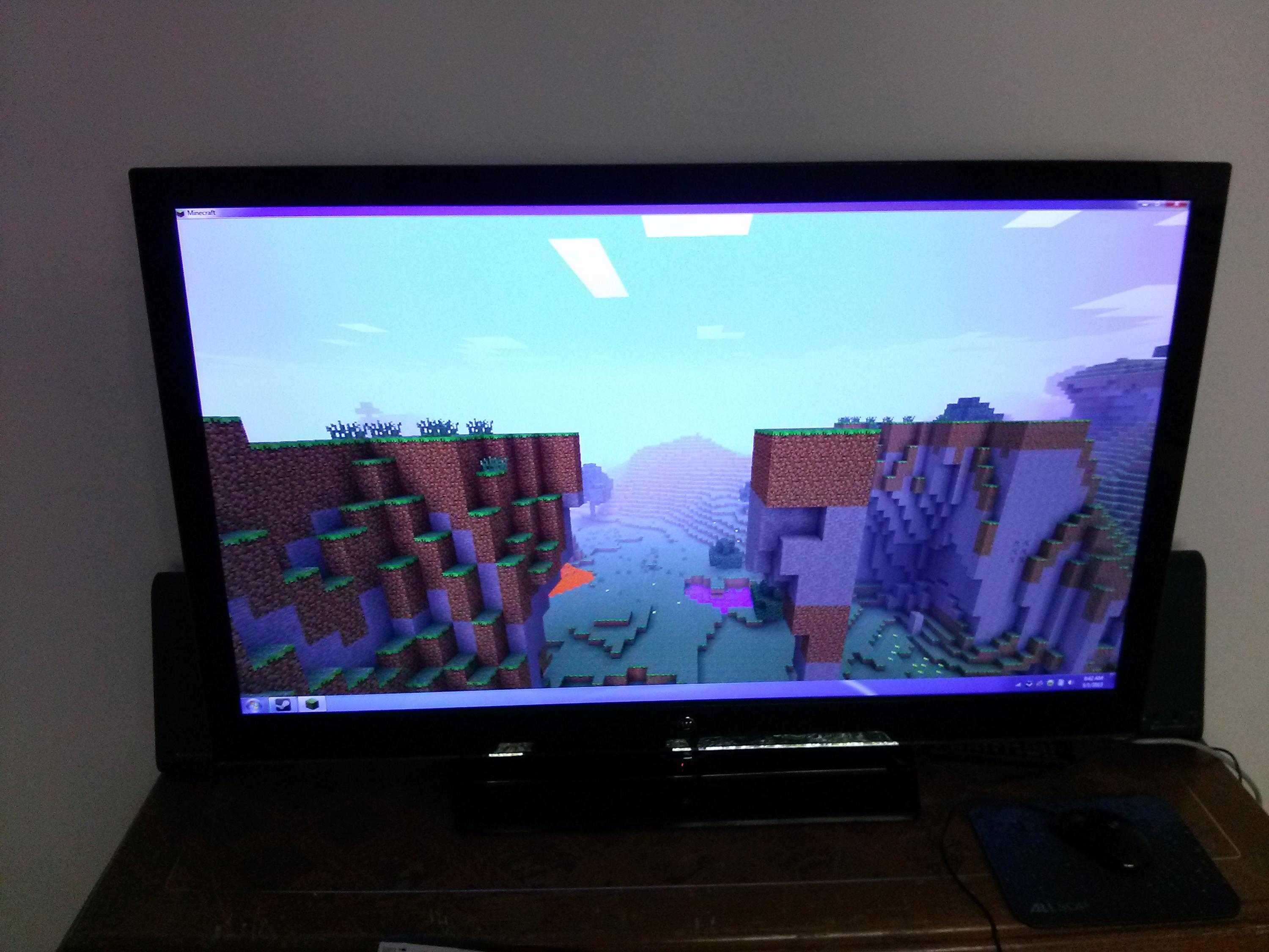

                OMG OMG OMG OMG OMG THANK YOU EVERYBODY IT WORKS!!!!!!!!!!!
                Initially the new cable was not working I had a hunch and flipped one end around and now it worked!

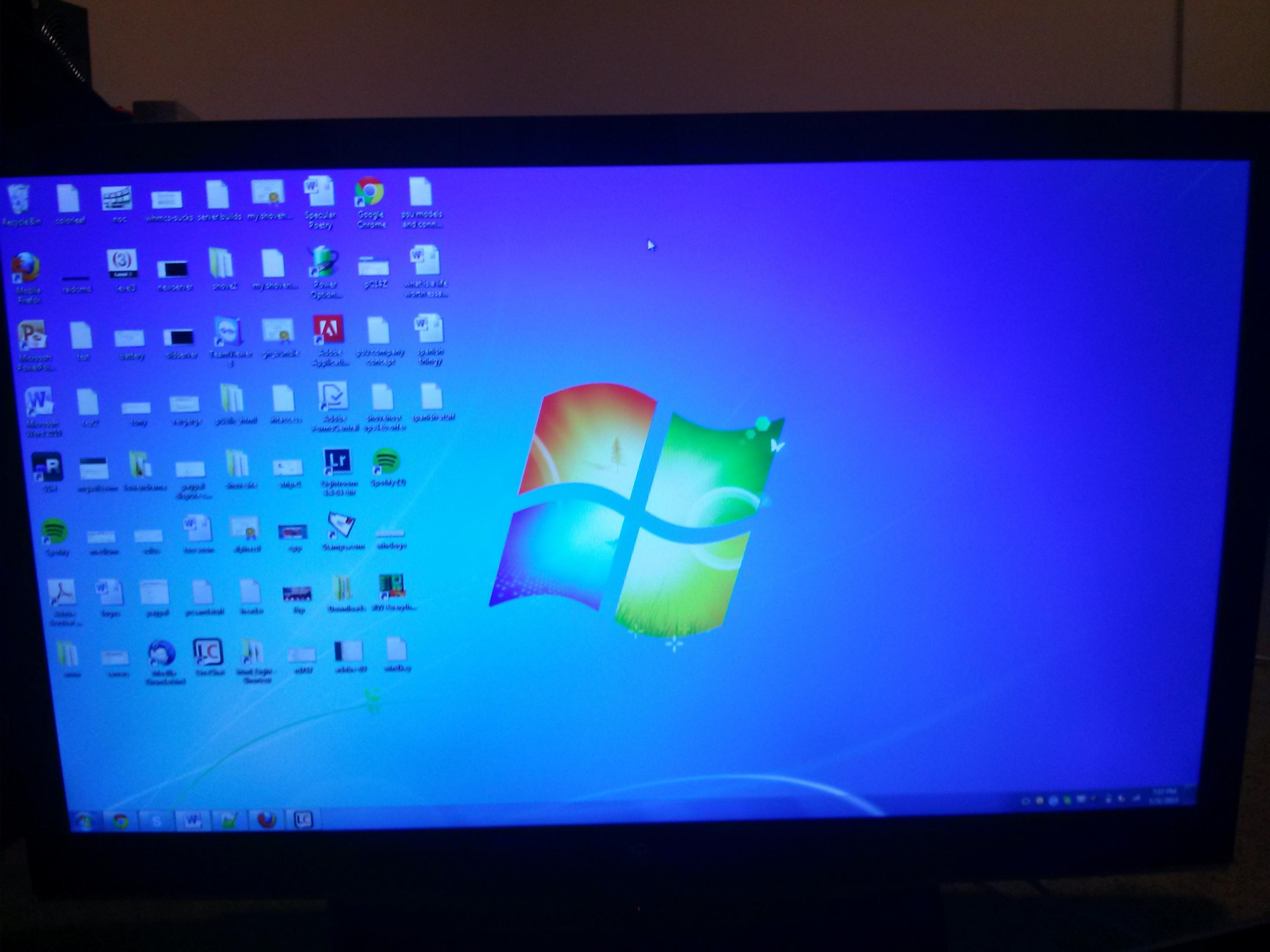

                      Thank you again to everybody in this thread... $15 to fix a nice TV... wow!
                      My phone's camera seems to make everything purple but it does not look purple in real life... and idk what that white region on the bottom bezel in the photo is perhaps a reflection but it's not there in real life either...
                      mom and I watched a movie on it yesterday... she kept complaining it was "too big" lol... her tv is 22", before that she had a 17", before that a 12"... lol
