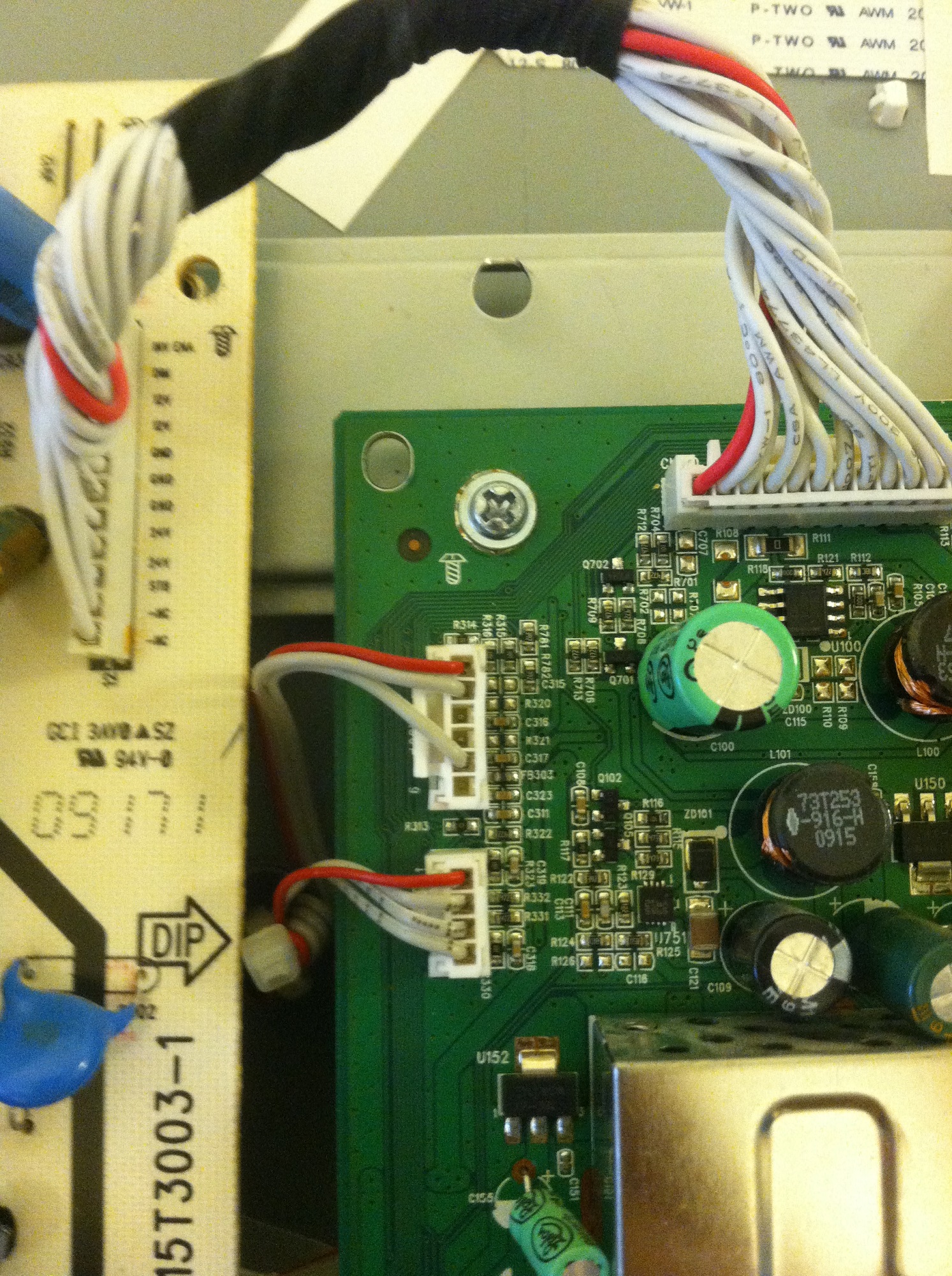

    After no obvious signs of bad caps on the boards, I checked all the connections with a multimeter. I found that the connector from the power board to the main board wasn't reading the correct voltage on two pins. The two pins labeled 24v seemed to read correctly, but the two labeled 12v both read 2.76v on the main board and the power board.
    I checked the key board and it read 3.29v, im not sure if this is the correct voltage, because it is not labeled and ive been unable to find a service manual.
    I checked the screen with a flashlight to see if the inverter board was not lighting up, I could see nothing.
    The voltage from the power to the inverter reads correct on all pins.

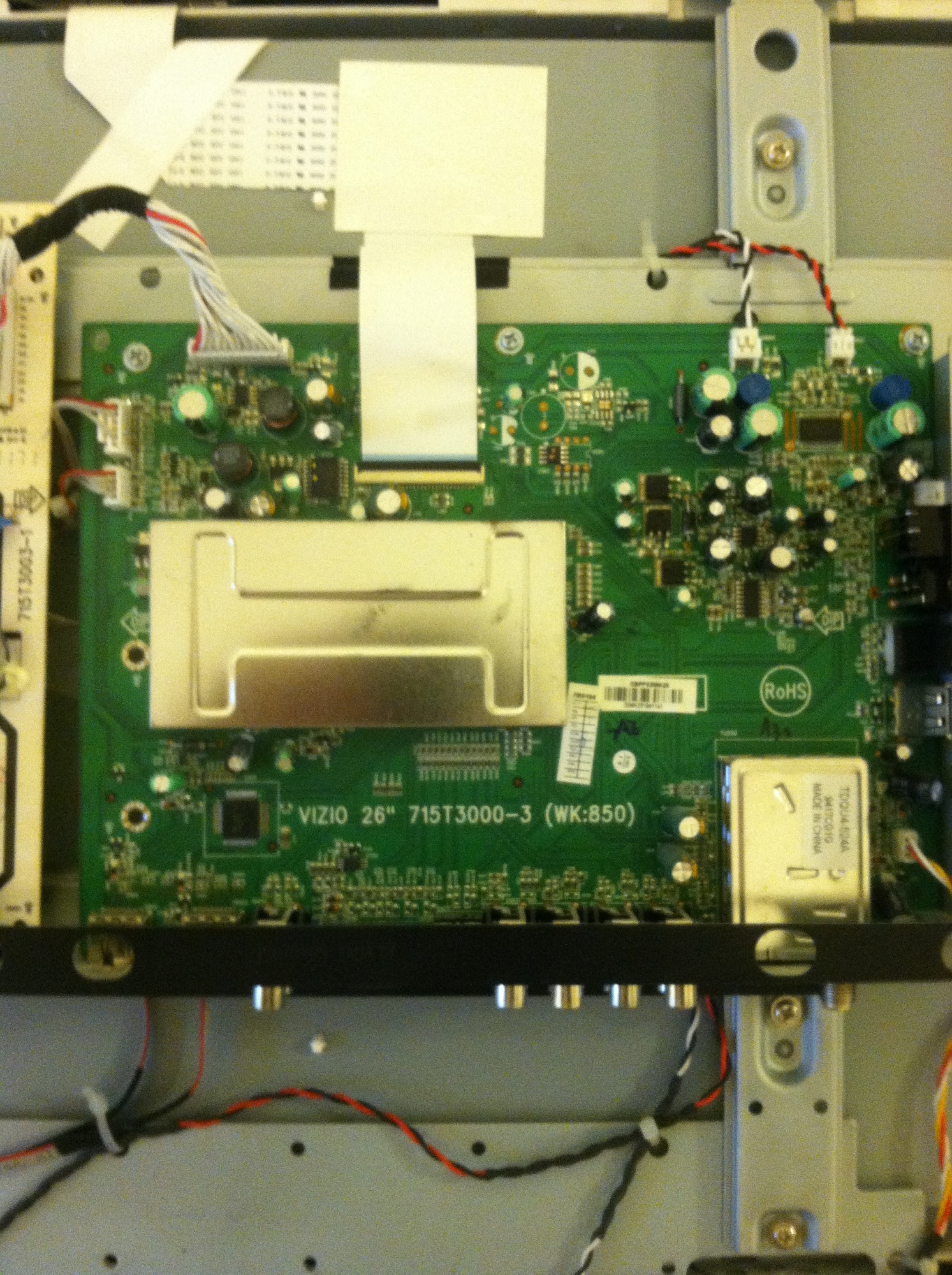

    I've attached pictures of the connection between the main board and the power board, the power board itself, and the main board itself.
    What's my next step? Thanks in advance.

    The connector for the 24V for feeding the inverter board, you do have 24V, but do you have BL_ON (Inv_on, or on/off)? You can see the printing next to that connector, report the reading on those pin when TV is in standby, and when it is on..
    Pictures of the inverter board? Read my guide under my signature to find out how typical LCD TV works.

              That means the main board is the problem, it is not sending out the BL_ON to turn on the backlights.
              There are many 3-legs voltage regulators on the main board that should be checked. Please go to the link under my signature to learn how to test them.

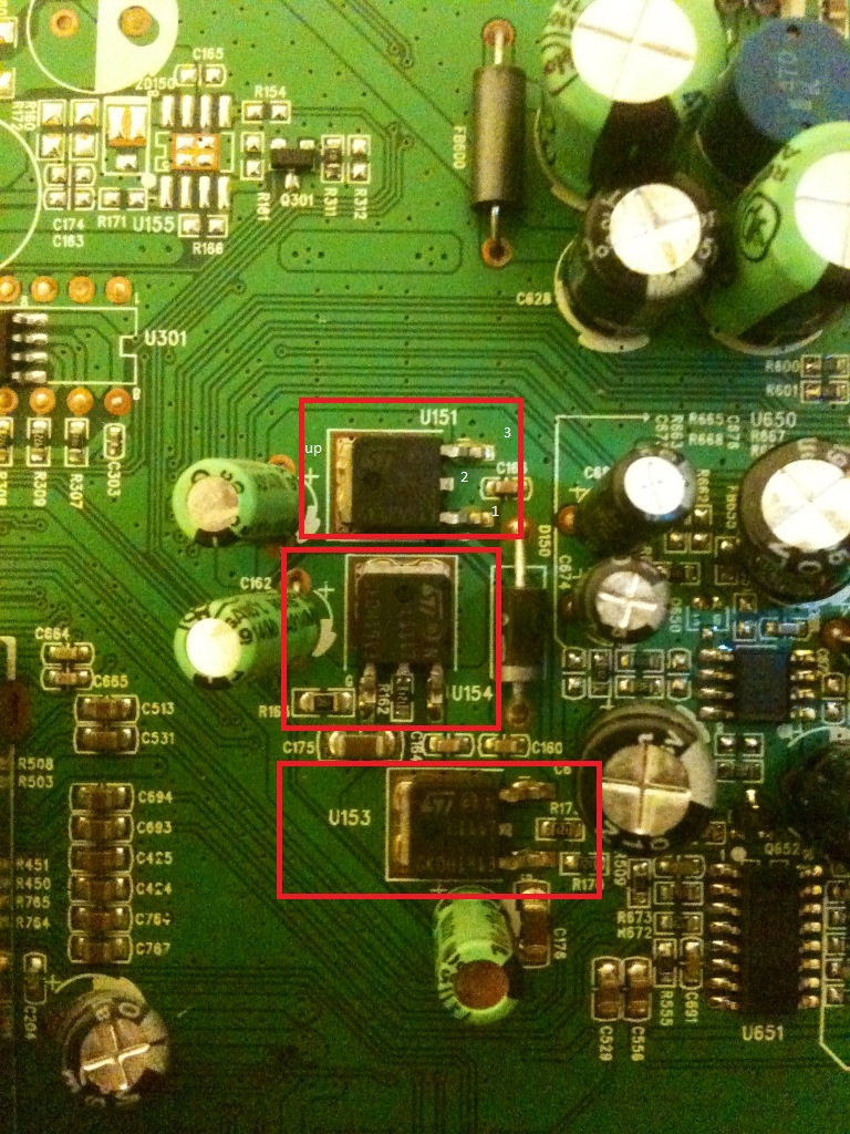

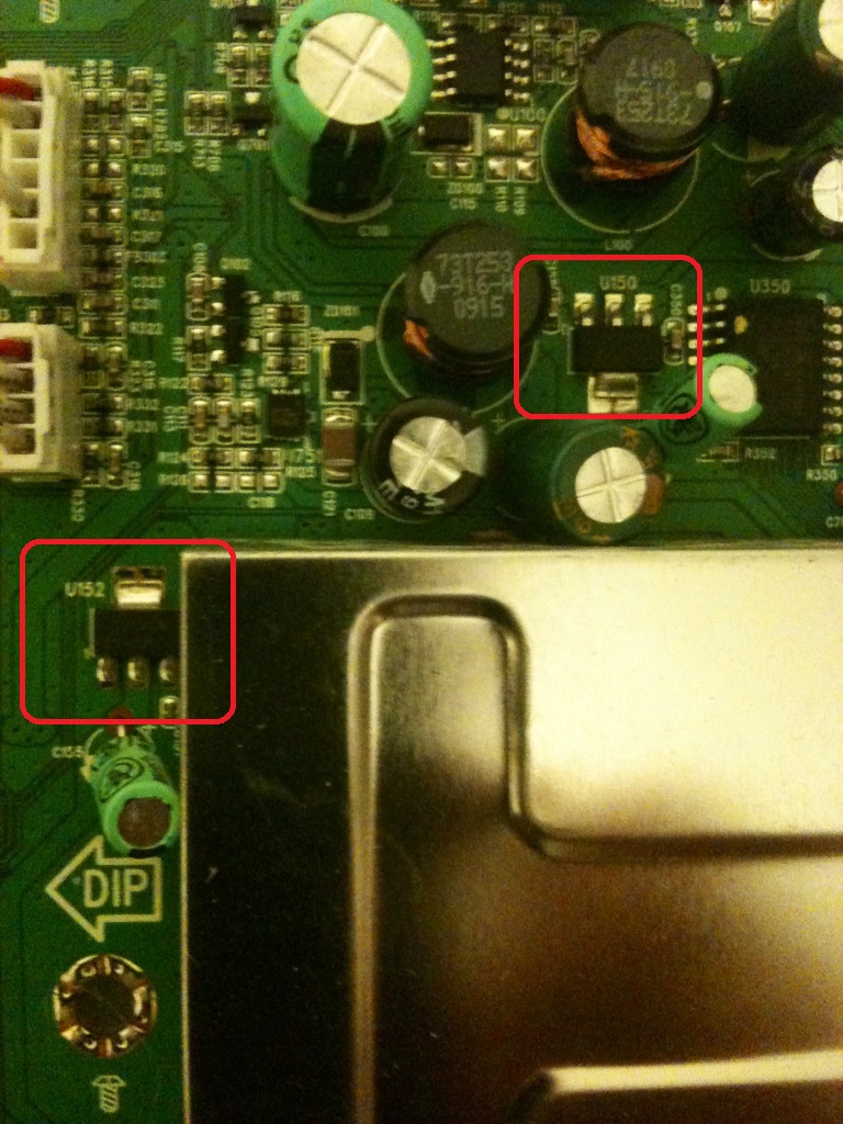

                  Re: VIZIO VA26LHDTV10T - No display
                  I've collected readings from the regulators, according to the video, they seem to be good?
                  I've attached photos, as well as the readings I found.
                  First photo -
                  U151 -> pcb designation
                  L1117 -> line 1 of the IC
                  33 -> line 2 of the IC
                  GK1FV913 -> line 3 of the IC
                  pin 1 = 0.00
                  pin 2 = 3.30
                  pin 3 = 5.08
                  tab = 3.3 -> incase you need
                  U154 -> pcb designation
                  GKO41913 line 2 of the IC
                  pin 1 = 0.01
                  pin 2 = 1.25
                  pin 3 = 2.49
                  tab = 1.25 -> incase you need
                  U153 -> pcb designation
                  pin 1 = 1.25
                  pin 2 = 2.49
                  pin 3 = 4.36
                  tab = 2.49 -> incase you need
                  Second photo -
                  U150 -> pcb designation
                  17-33L -> line 1 of the IC
                  pin 1 = 0.00
                  pin 2 = 3.30
                  pin 3 = 5.08
                  U152 -> pcb designation
                  pin 1 = 0.00
                  pin 2 = 3.30
                  pin 3 = 5.11
                      They all look OK, no more suggestion yet at this point.
