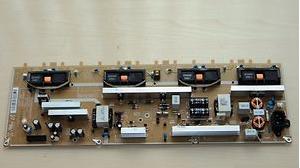

    i've looked at few posts, and possible can rule out the psu? below causing it

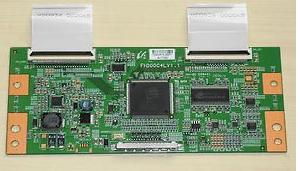

    Is there an AS15 IC on the T-con? (Small square chip.)
      Re: Samsung LE40B530P7 White out
      No nothing ic of that id

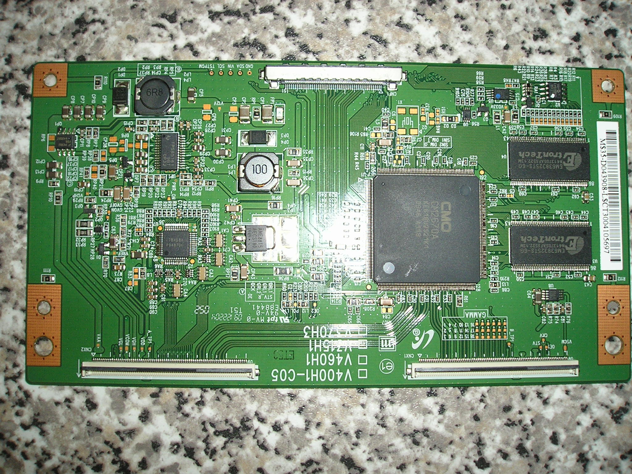

        We need a closer image of the T-con board, ideally we would be able to read the part numbers on each IC, if necessary, split the photo into two or four parts.
          ok will take original pic now
            Picture of board taken out
            thanks

                You can try testing the voltages in the box marked GAMMA. Each voltage 1 thru 18 should test slightly higher than the last.

                      It does sound like GAMMA fault, so please perform the test I suggested (board installed in TV.) Gamma circuit is used to drive the panel brightness, making the light output linear with the input signal.

                          Just out of interest the back light is fine
                          powered by psu board yes ?
                          john
                            Yes

                              i since bough s/h tcon and although diferent patern of colours its basically the same problem still
                              i will post oic of picture white with hint of colour and program

                                more than likely the t-con board or the lcd panel itself
                                here is a link on how to test the psu
                                https://www.youtube.com/watch?v=wrD1d-a2fnA
