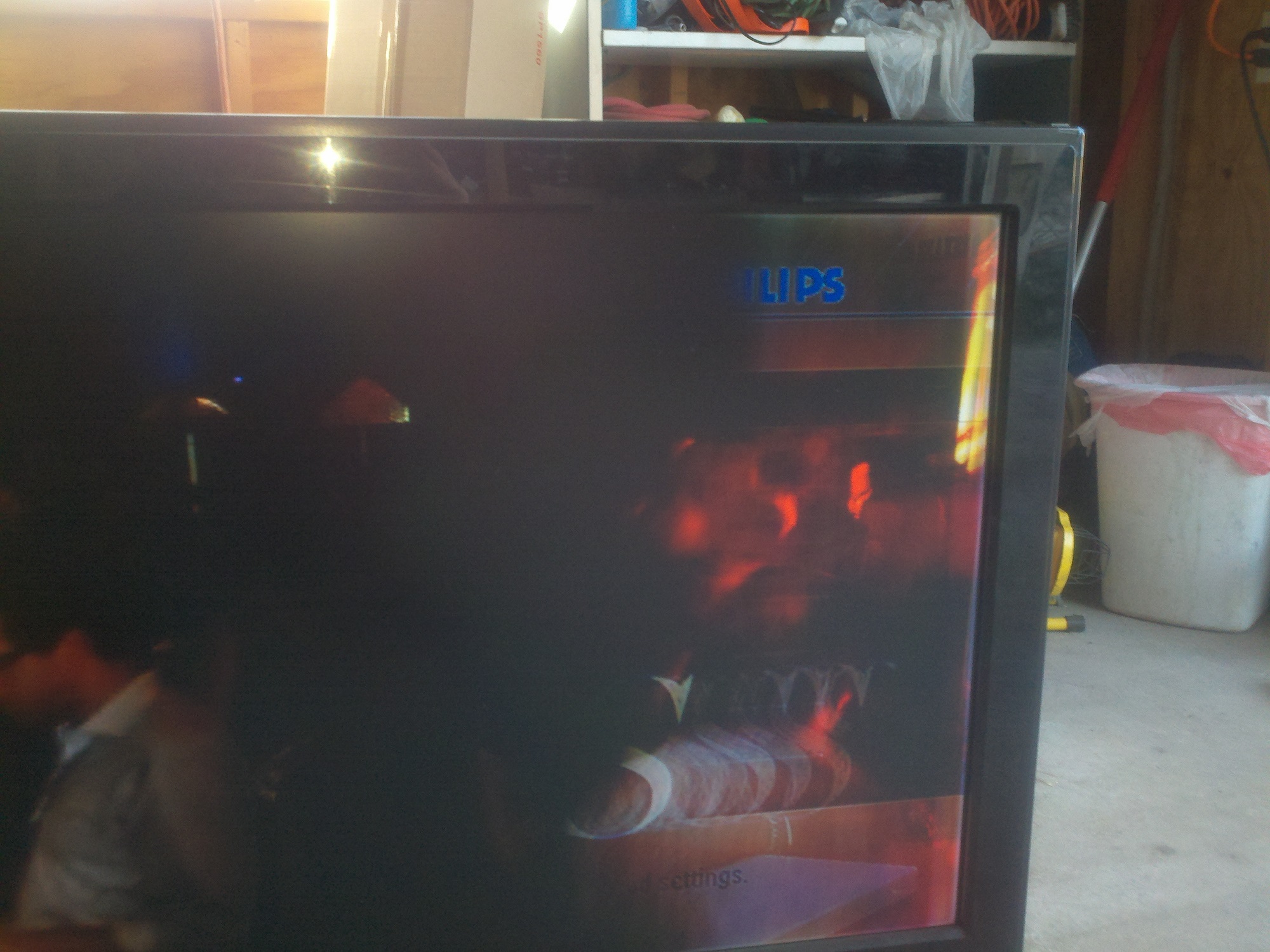

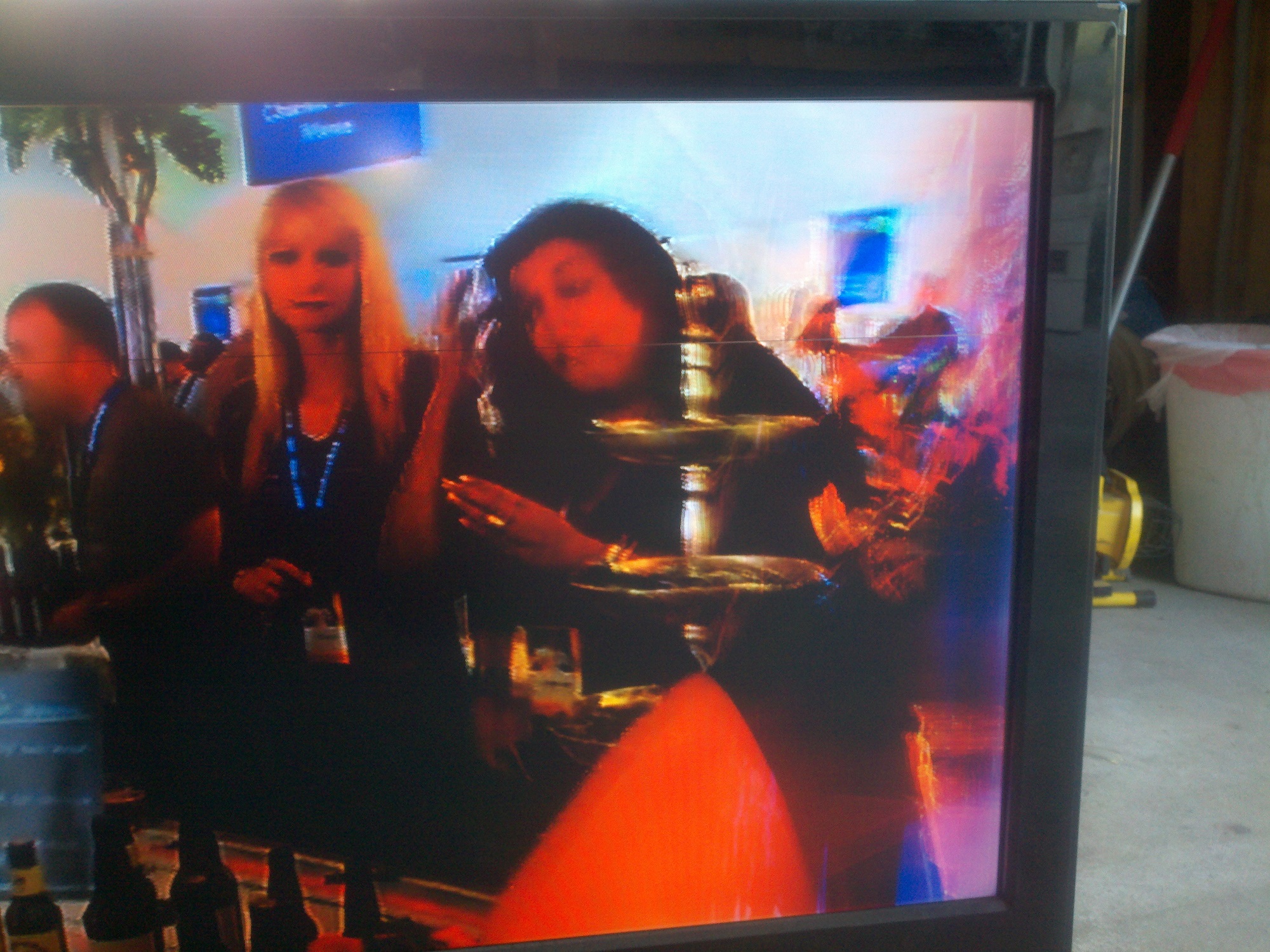

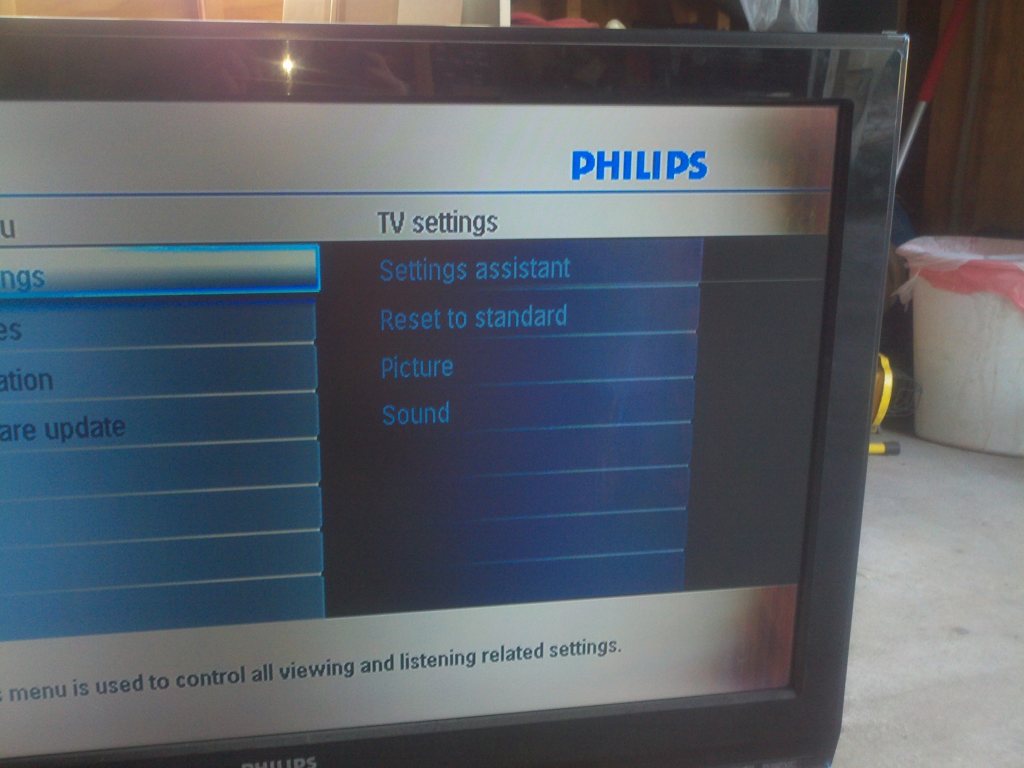

    Somebody is selling this TV with this picture issue and I'm not sure what to think of it.
    Panel issue? I never had a Philips with bad panel.
  • cashkennedy
    • Aug 2011
    • 668
    Re: Philips 42PFL7422D/37 screen issue
    The ghosting / and black void would seem to indicate one of the voltages (similar to sustain / or refresh) is not reaching that part of the screen. I think that generally means tab bonding issues or tcon. I don't think ive read of 37" sets anywhere having tab issues, but in theory any tv can develop the issue if handled very bizarrely.
    Hopefully someone else knows more. You may want to confirm with the seller that the ghosting affect of the text / and the black void area is part of the error symptoms and not just from the camera.

      The TV is a 42", not 37". I can ask him about that, thanks.
        Appears both 42" and 37" LG.Display panels had a few minor issues with tab bonds, I have had it before.
          This looks exactly like the 37" Vizio I just posted about earlier this week with the 37" LG display. Hoping to tear it completely apart sometime soon.
            It's panel issue.Problem with side screen buffers.
