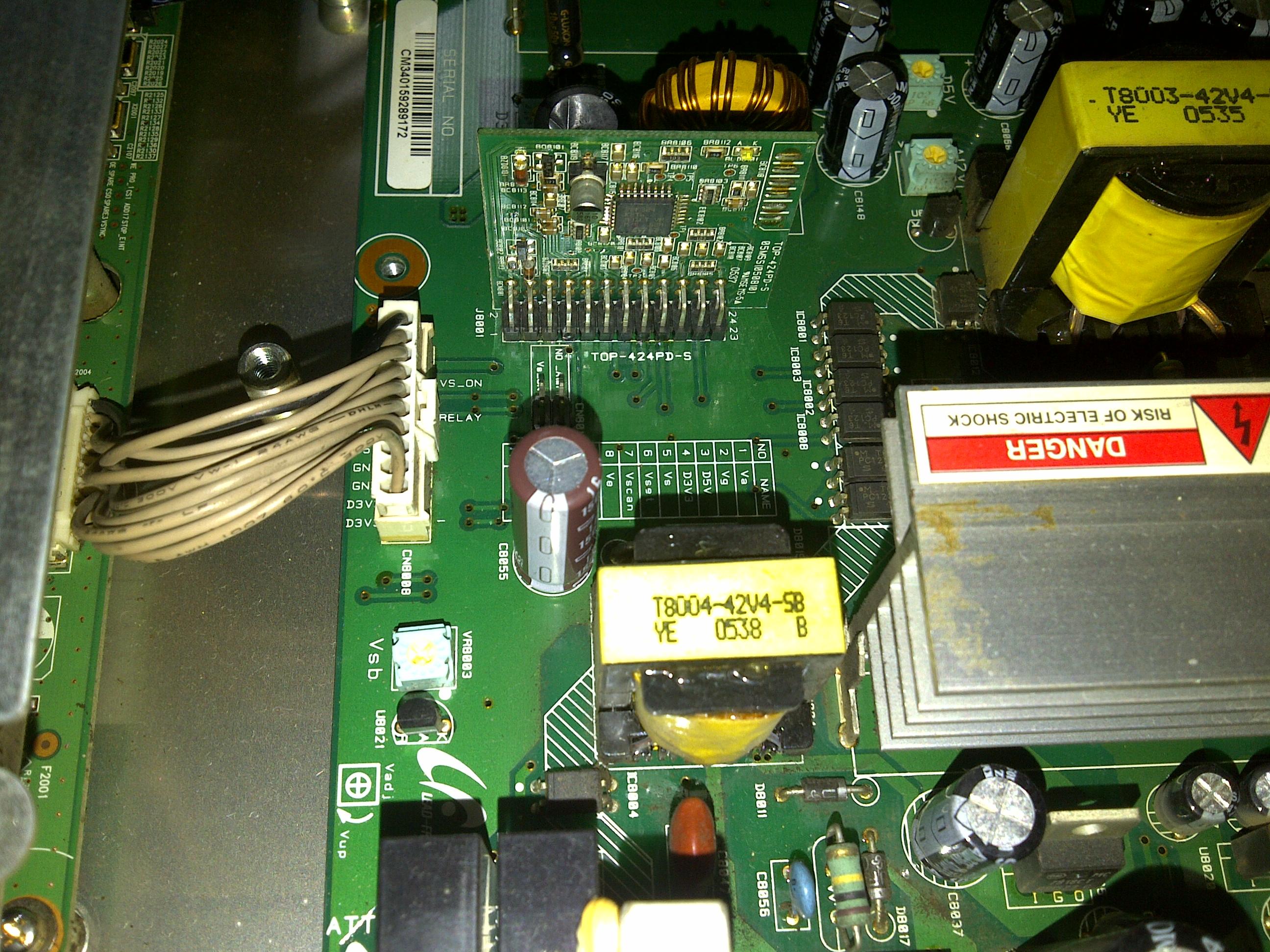

    I have a Plasma TV Sanyo PDP-42PF2 (seems based on a samsung chassis) that is stuck on standby, it does not respond to remote control or front panel buttons, all voltages on the PSU section are down with the exception of the ones i presume are responsible for the standby circuit and connect to the control board (attached picture) this connector has the following voltages:
    Vsb - 5.23V
    Vson - 0.2mV
    AC_DET - 5,20V
    Relay - 4.10V
    D5V - 2.3mV
    DEV3 - 20.6mV
    Any help would be apreciated.

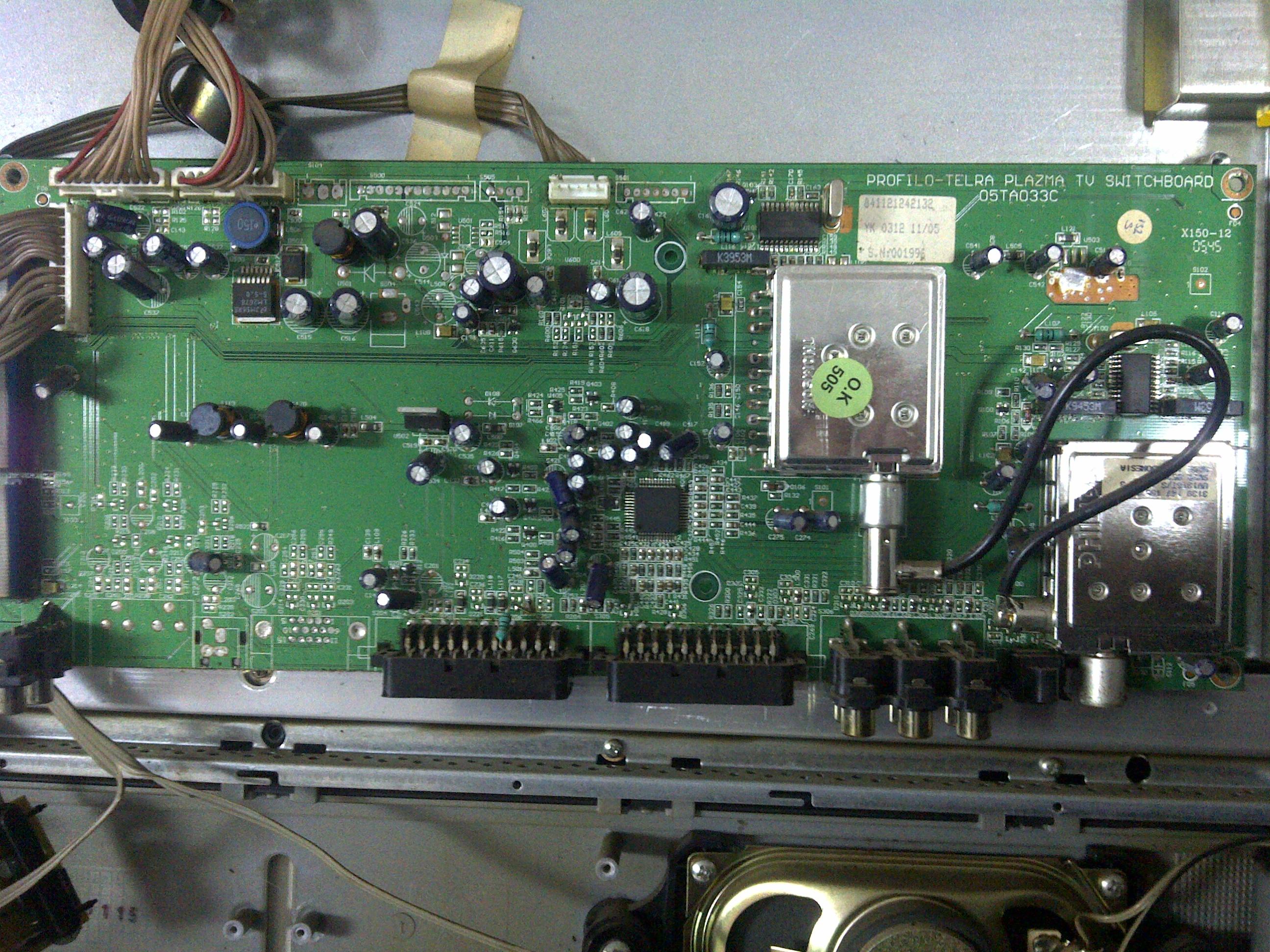

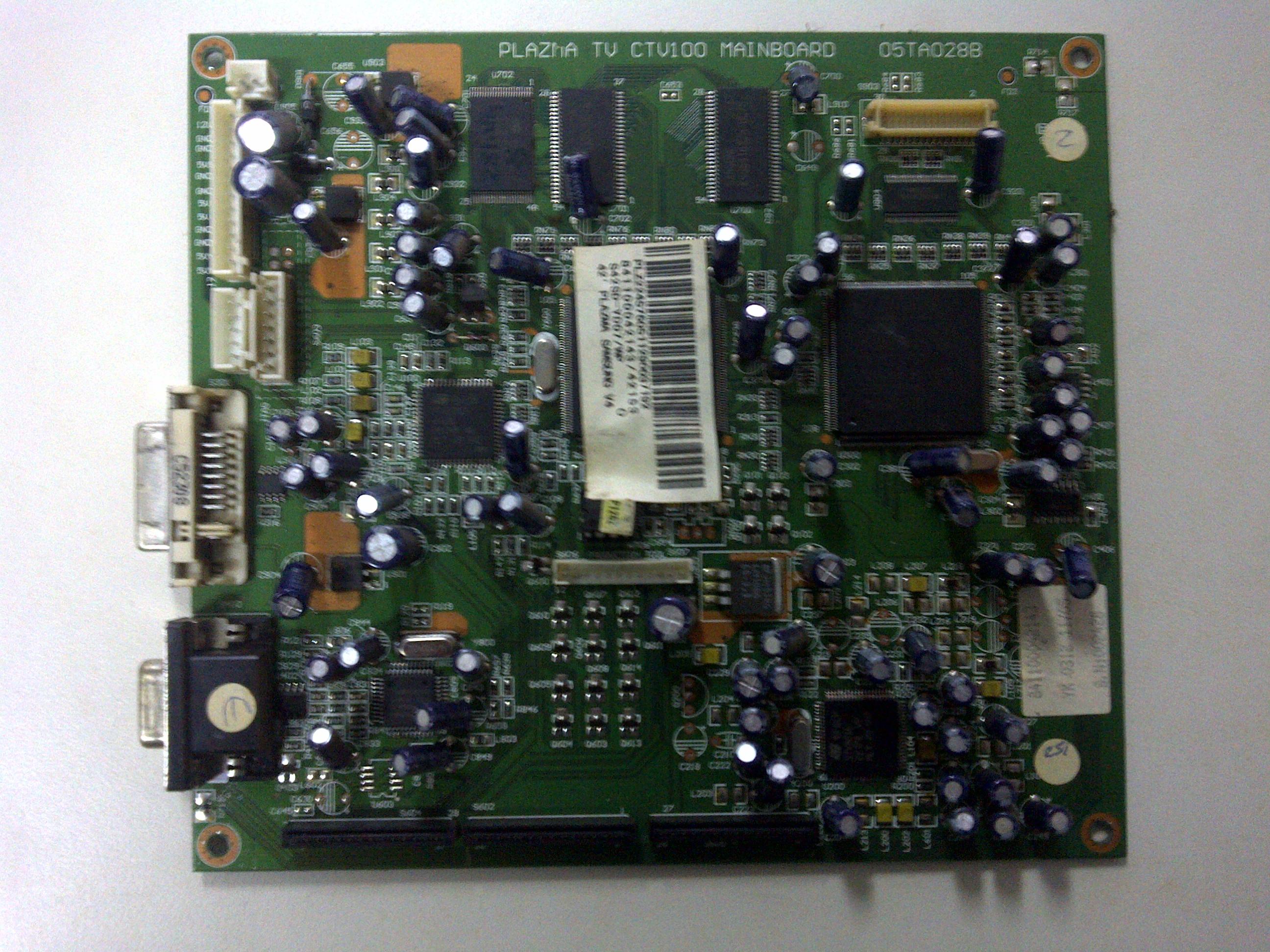

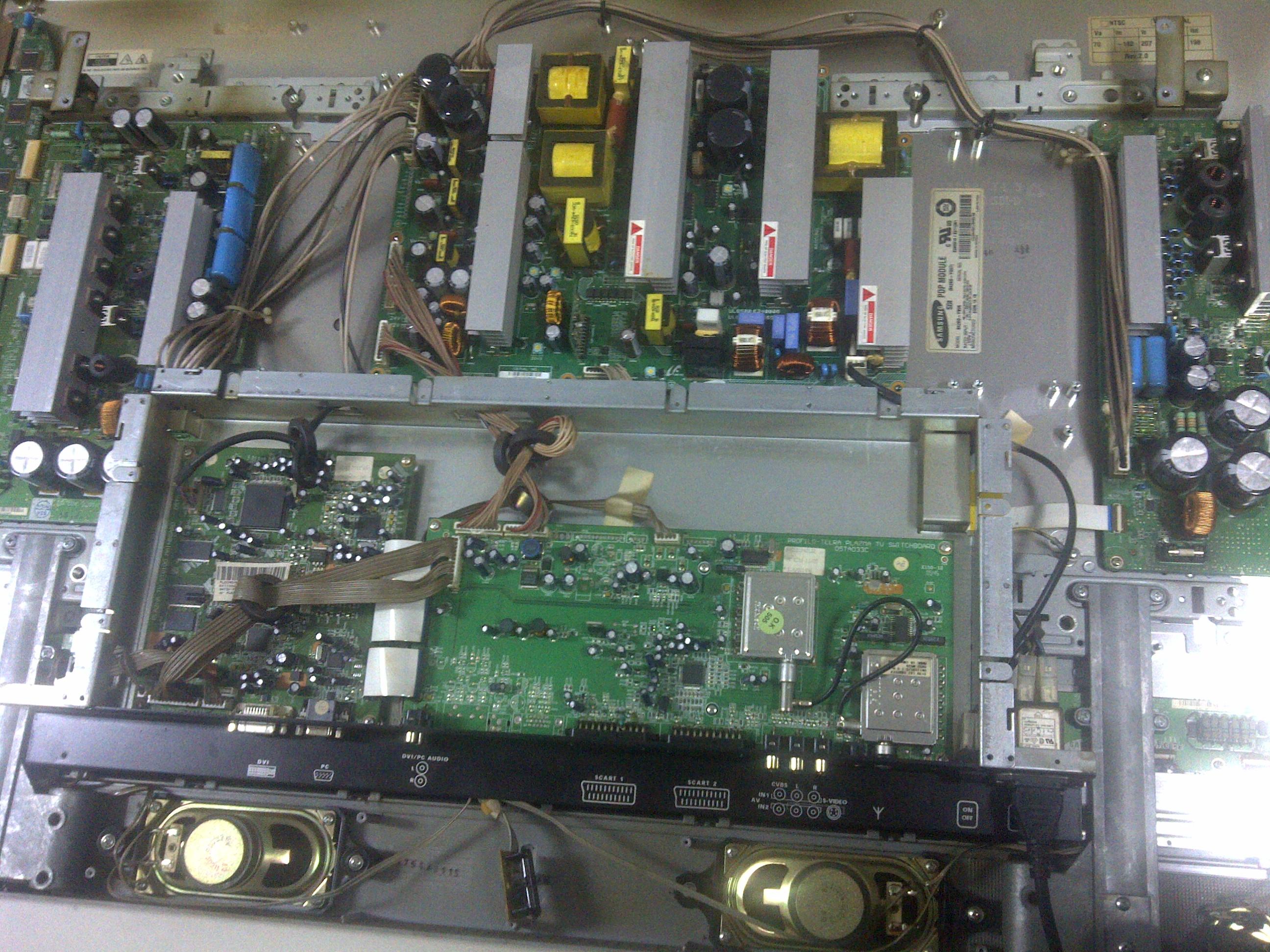

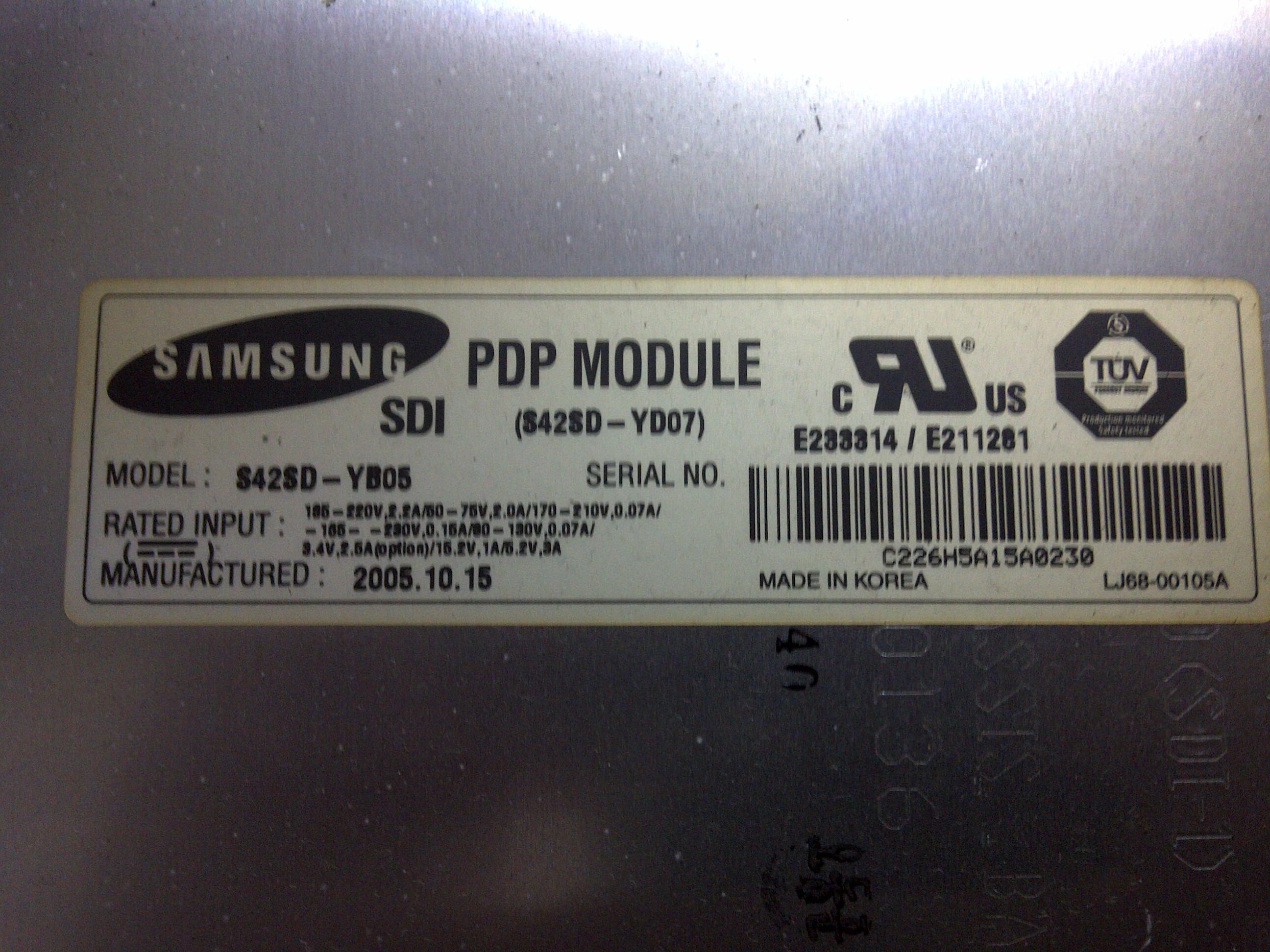

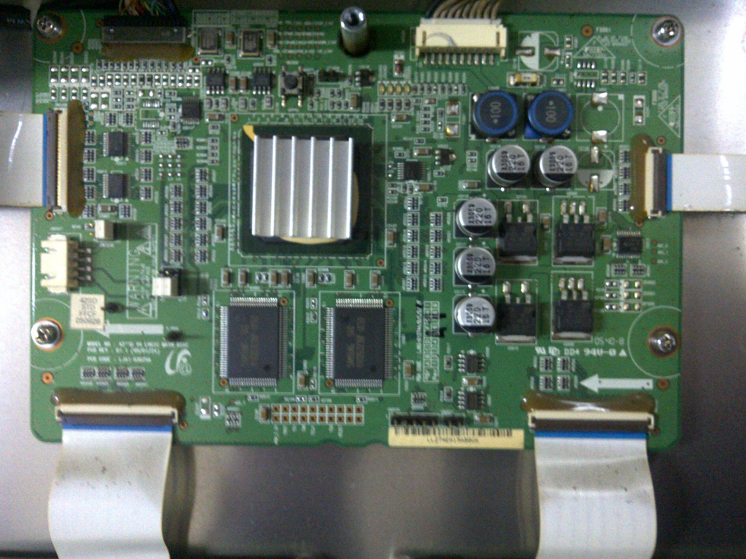

            The fault is more than likely on the main board then.
            This set is based on a Samsung plasma panel, but the main board, case, remote, etc. are made by Sanyo or a subcontractor for Sanyo.
            Can we see clear close up pictures of the main board?
              Re: Sanyo PDP-42PF2 Stuck on StandBy
              Here they are, sry about the quality if you need to know some reference or part number let me know.
