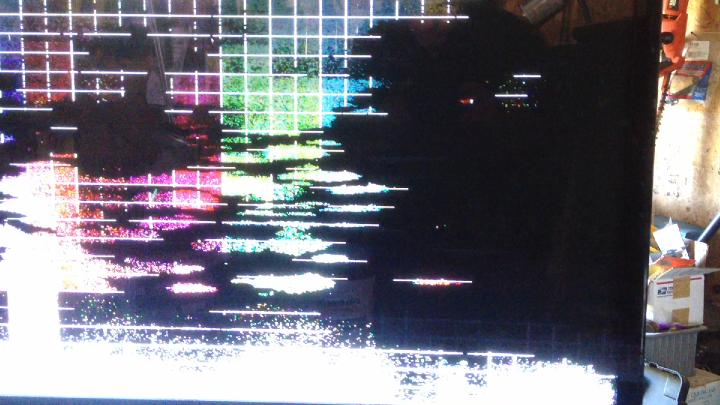

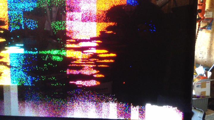

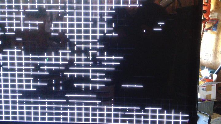

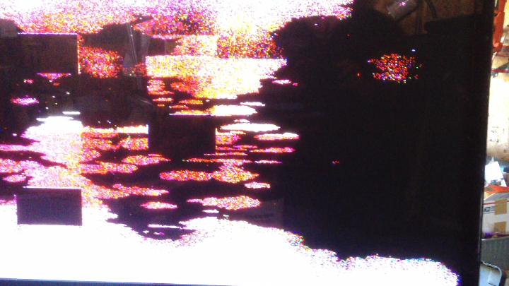

                                    OK, can you show me a picture image of the fault?
                                    • Bamakc
                                      • May 2013
                                      • 39
                                      #38
                                      Re: Zenith Plasma Z42PJ240 sound but no picture
                                      Thanks for you Help Tom66. Here are some pics. After i took the pics I removed power and disconnected the cable going to the Z-sus then re-applied the power and i heard a faint snap and the picture would not come on but still had audio. I checked the Y-sus board and found Q22and Q23 (SUS_DN) shorted. Also Q21 (SUS_DN) open. Q12 (SUS_UP) open , Q13 (SUS_UP) shorted, Q15 (Blocking) open. After looking at the pictures, do you think this is beyond repair?
                                        #39
                                        I think you've just got to replace -everything- shorted to get the image right.
