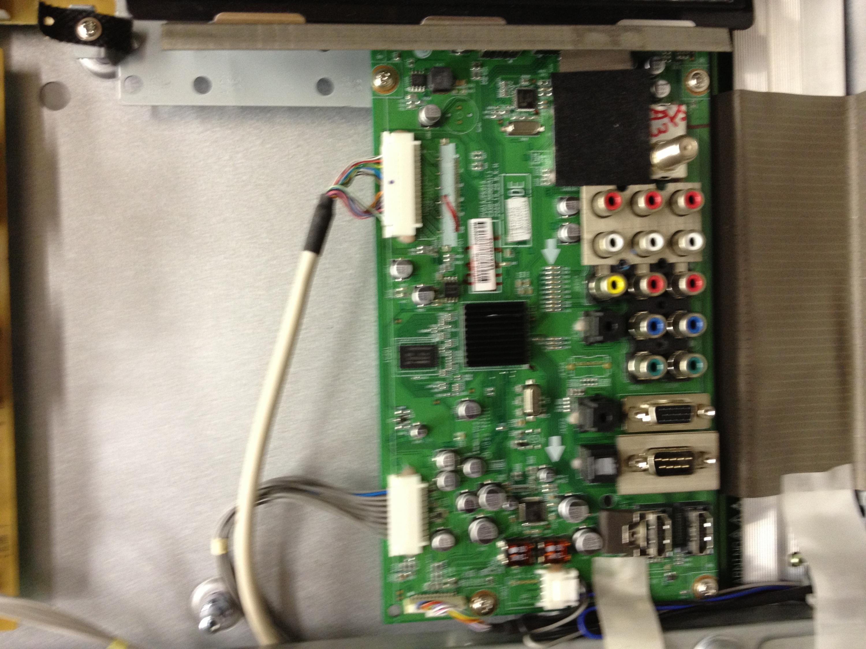

                                  It is looking like it, though I'm not sure why it and the Y-sus/Y-buffer would both fail. Can you show me all the connections around the main board and control board?

                                    #57
                                    Re: Zenith Plasma Z42PJ240 sound but no picture
                                    I will take pics this afternoon when i get home from work. Initially i had all voltages on the Y-sus but i think the Z-sus was bad. I think i killed the Y-sus by disconnecting and reconnecting the cable going from the Y-sus to the Z-sus while the tv was on. When i did i heard a snap like a power arc and one of the pins on the connector was black. The lady that gave me this set thought lightning might have came in on it and she just bought her a new on. I dont know what kind of video source she was using at that time.

                                          #60
                                          Here is a pic of the board
