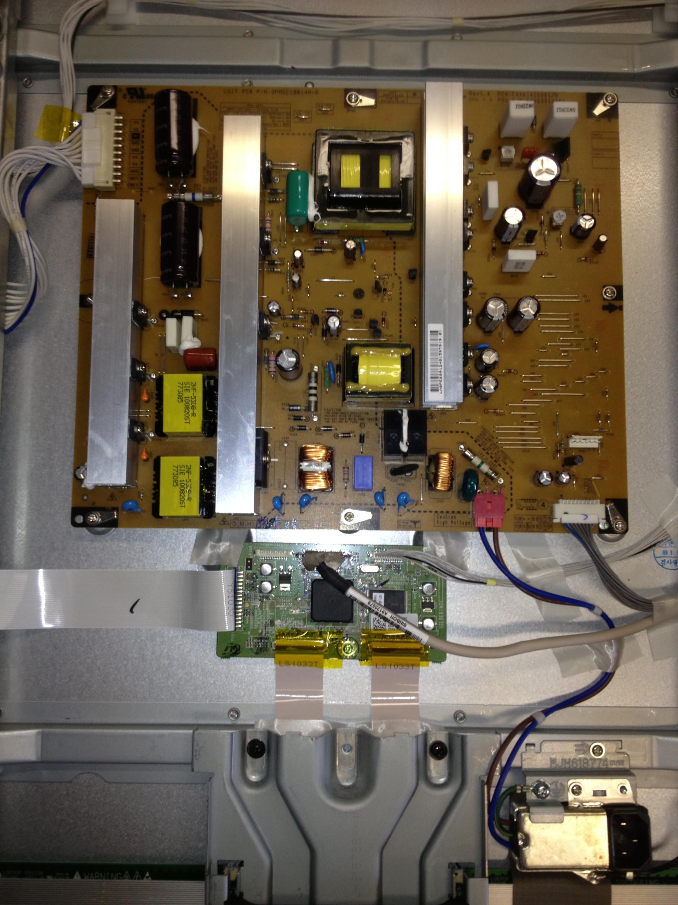

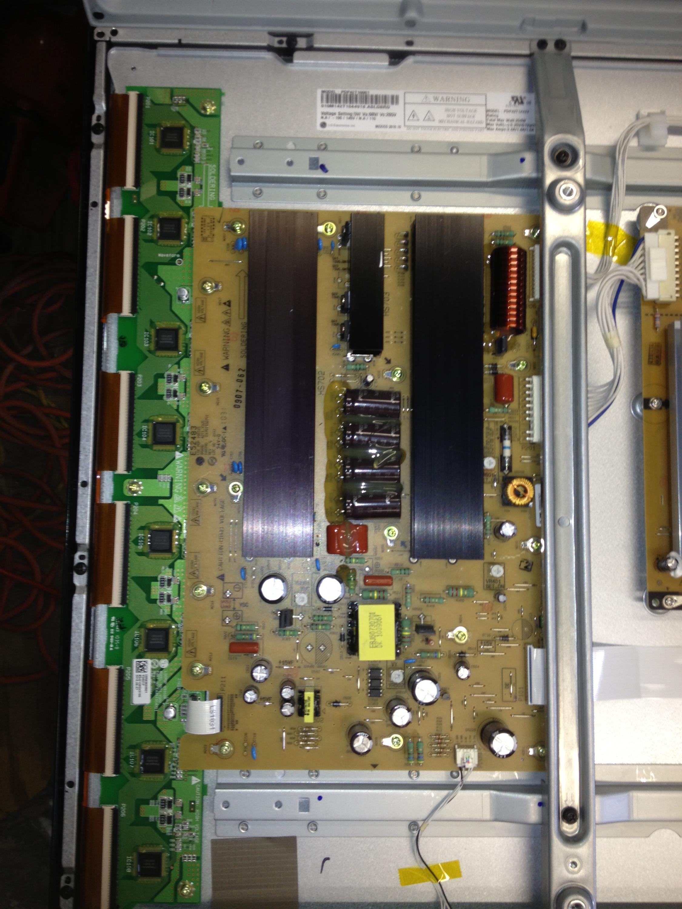

    I have a Zenith/LG model Z42PJ240 that has sound but no picture. The screen is very dim in a dark room. I have 205.5 vdc on VS and 60.4 vdc on VA. The only thing that i can find is 2 shorted transistors on the Z sustain board. Q206 is shorted between all legs and Q203 is shorted between ey316 and ey317. This test is with both transistors removed from the board. I am an old CRT type repair tech and have not worked on tv's for several years. I was given this tv by a friend that knew i liked to tinker with electronics and i am excited about getting back into this as a hobby only. Any info or guidence would be greatly appreciated.

      Post some pictures of the chassis so we know what we are working with.
      It is likely a Z-sustain fault.

        I replaced the Z sustain board with one that is supposed to be new that i bought off ebay and the screen comes on bright and white for about 3 seconds then goes back off but sound stays on. I have also attached some pics.

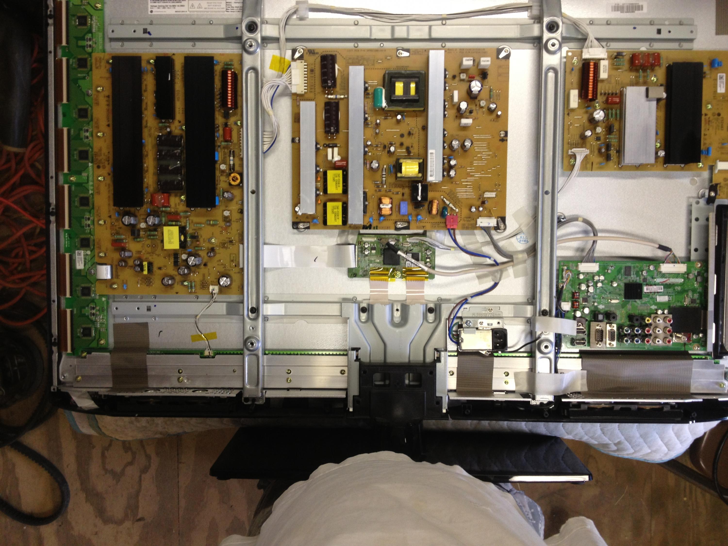

          Here is a few more pics. Any info will be greatly appreciated.

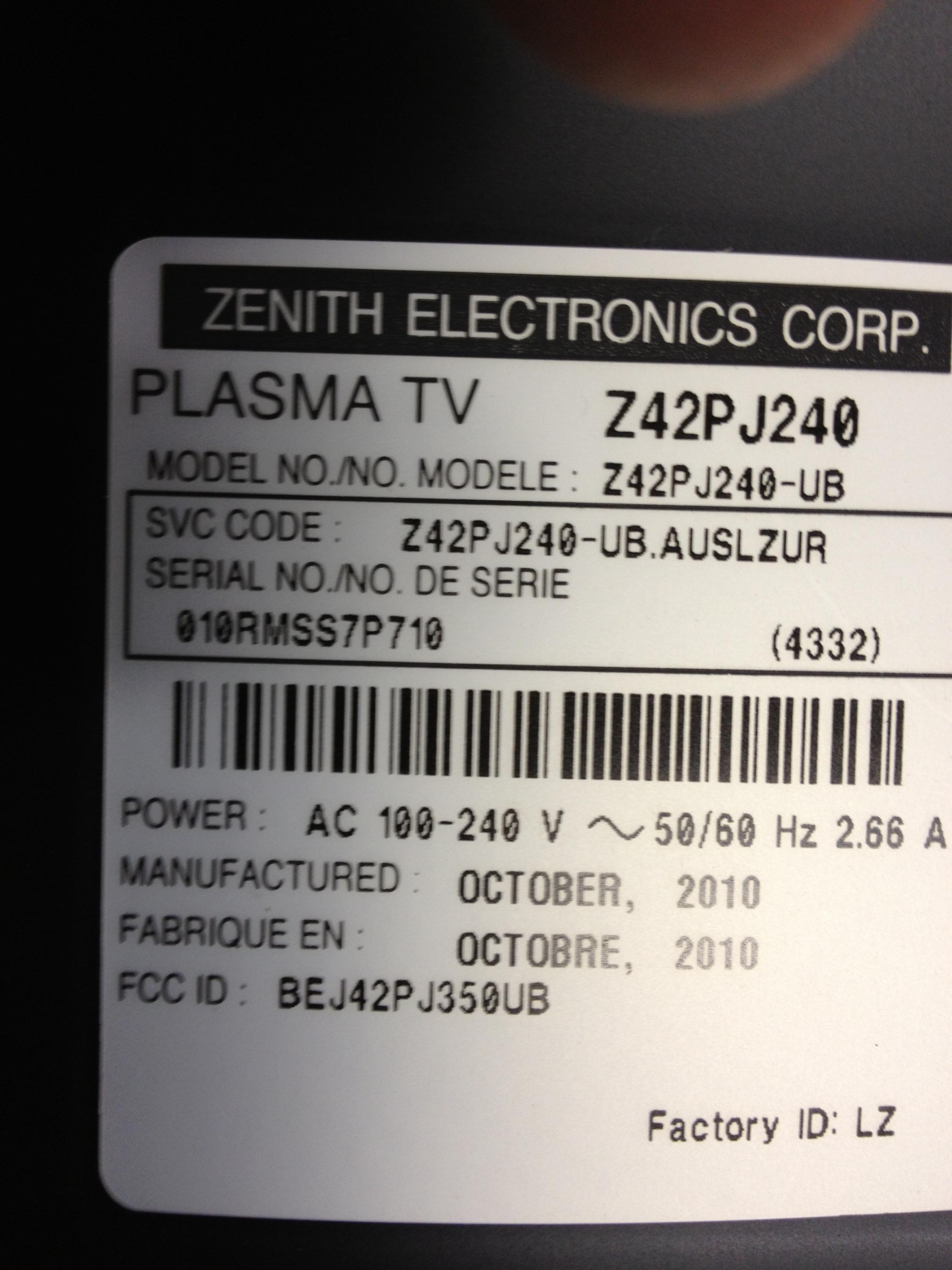

              What is the panel model in this TV? It will be indicated on the LG model sticker. e.g. PDP50R4000.

                Pdp42t1001

                      Test the Y-sus and new Z-sus for shorts.
                      It may be that you need to adjust the Vzbias, Vsc, etc. But you can only do them with the set fully connected and powered up. It's a shame that the chained design makes this potentially hazardous to the new boards.

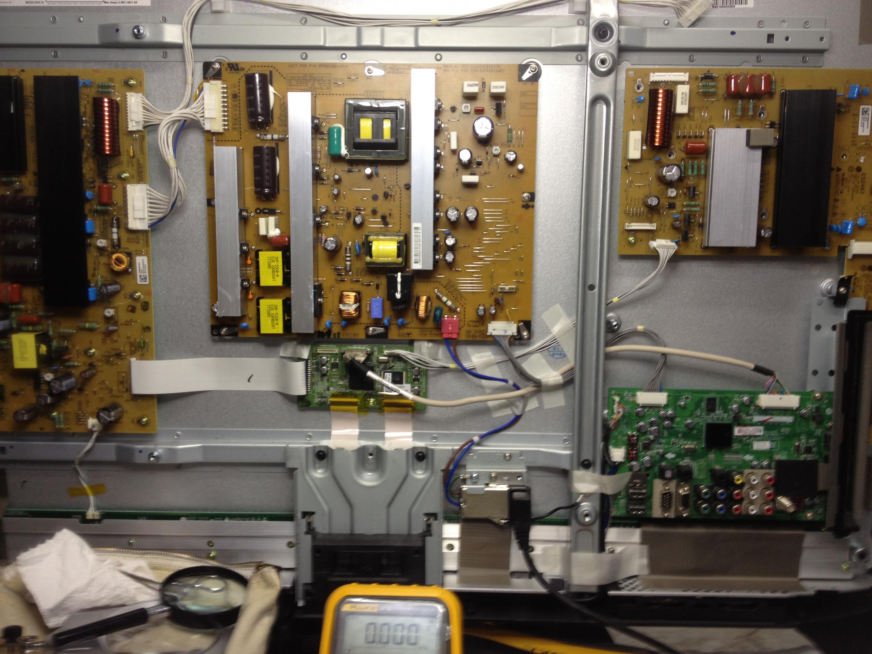

                          I have followed the alignment procecures except the ones requiring a o-scope.
                          All of the voltages were within range but i tweaked them to make them exact.
                          I could not find a short on the Y-sus or Z=sus. All voltages are correct on the power supply. When first turned on the picture is all white for about 3 seconds then i hear a click (like a relay) then the picture goes black but i still have audio. In a dark room the screen does not have a glow like before i changed the Z-sus.

                            OK, in the middle of the set you have a small green board connecting a lot of the boards together, this is the control board.
                            On it, there is a jumper space marked EXT AUTO GEN.
                            Take a 100 to 470 ohm resistor (any value from 100 to 470 ohm is fine) and place it across the EXT AUTO GEN pads.
                            Disconnect the LVDS cable -- runs between main board (has HDMI ports on it) and control board -- then turn the set on.
                            Do you get test patterns, and do they last?

                                    Shame, this will be difficult. Plasma repair without scope is difficult for tricky problems like this. These newer plasma TVs used combined ERC which means that a failure on the Z-sustain can easily kill the Y-sustain.
                                    One other thing to check. In this photo there's a small thin four wire cable coming off the Y-sustain and going into the X driver board along the bottom of the panel: https://www.badcaps.net/forum/attach...9&d=1368157361
                                    What do you measure between the two outer pins? It should match Va.

                                      It is 60 VDC which is VA
