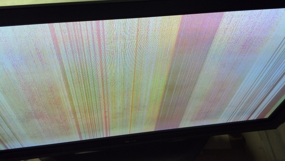

    I decided to start a new thread since this appears to be another problem.
    So far I have replaced bad Y-buffers, bad y-sus board, bad power supply.
    I now run into a problem shown on the picture. I've read that it could be anything from a bad control board to bad y-sus.
    I took some volt readings this morning and everything looks okay except the vsc which reads as low as 5v but should be 169v.

    It looks like you still have bad buffers.

      Have you checked the OSD with the remote to make sure the fault is not caused by the logic board or video board?

        I don't have the remote, I did short out the OSD pin 1 and 2 and the individual colors, bars and lines all show properly.
        Tom, I checked the buffer boards and showed no faults. I'm going to connect one at a time and see what I get.

          I pulled both buffers and sure enough, they are both shorted AGAIN. This time I tested both buffers before installing them and they tested okay. What are the chances that my problems are being caused by the Y-Sus board?
          I tested my VSC with no buffers hooked up and I get -169v and my -VY is showing +2.5v. It should be showing +120v on VSC and -200 on -VY.
          From my power supply going to the y-sus my VA is 60v and VS 196v just as label on display calls for.

            -Vy is bad and this might have cooked your new buffers. Vsc is probably measured the wrong way around and is a little high, this is probably not a major issue (at the moment: you'd probably have sparklies on the image.)

              What should I look for that would have the -VY so far off like that? Whenever I adjust the corresponding pot it only swings 1-2v with +2.5v being the lowest I can get it.

                You probably have a short on the Y-sus somewhere.

                  That's what I was thinking. I tried to track it down and kept coming up with nothing. I decided to go back to my original Y-sus board, I replaced a couple of caps which looked like they were starting to swell a little. Then I hooked it up and I'm getting 120 VSC and -199.9 VY!
                  Now I think I'm back to buffer boards. I'm holding out hope that the Y-sus board only fried the FETs on them.
