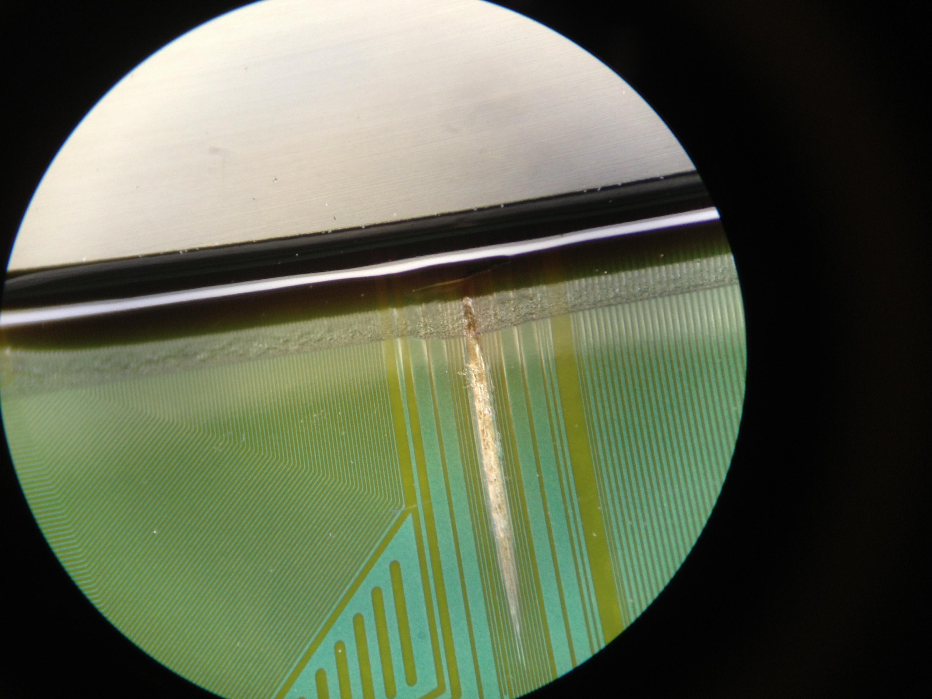

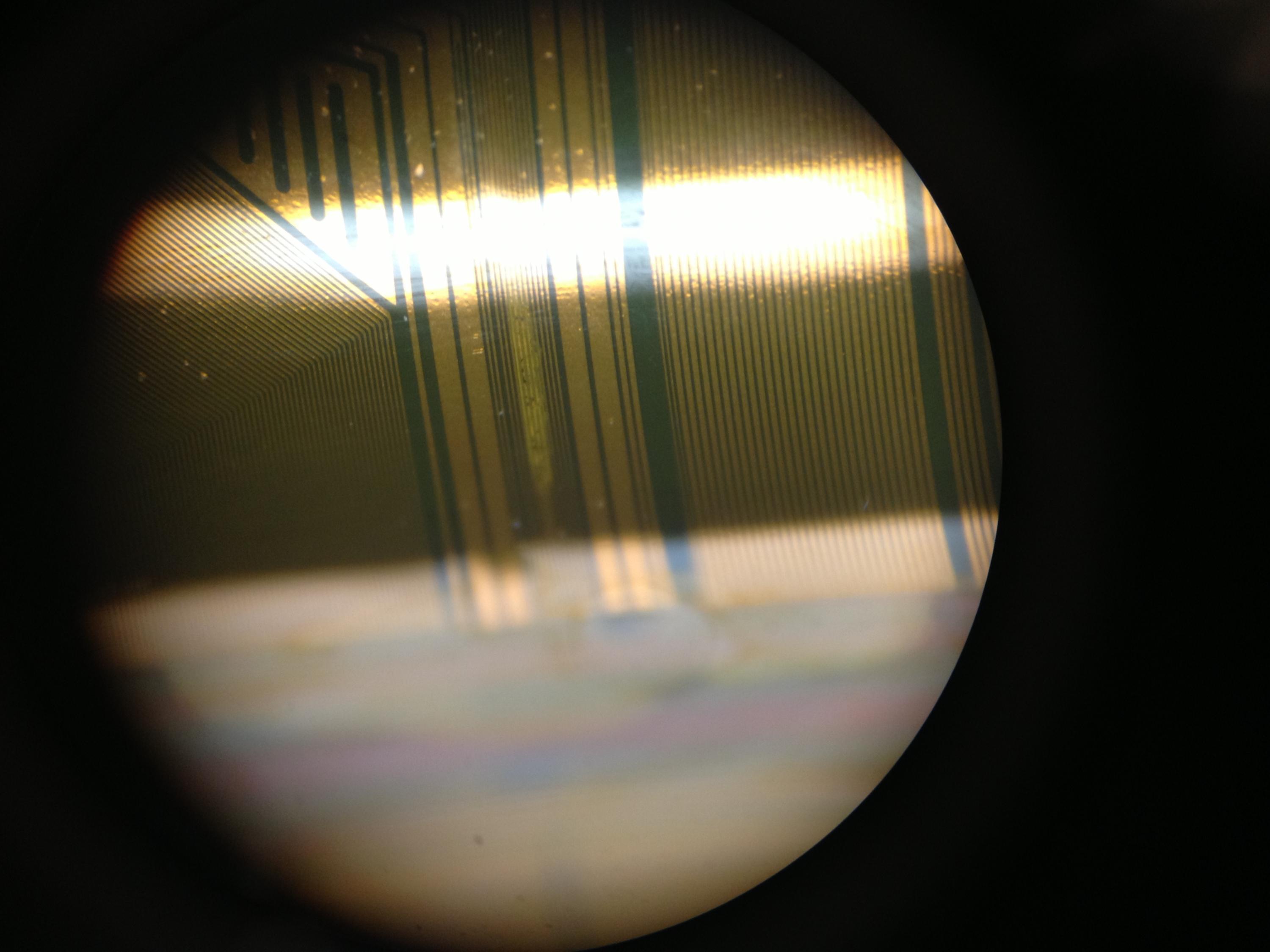

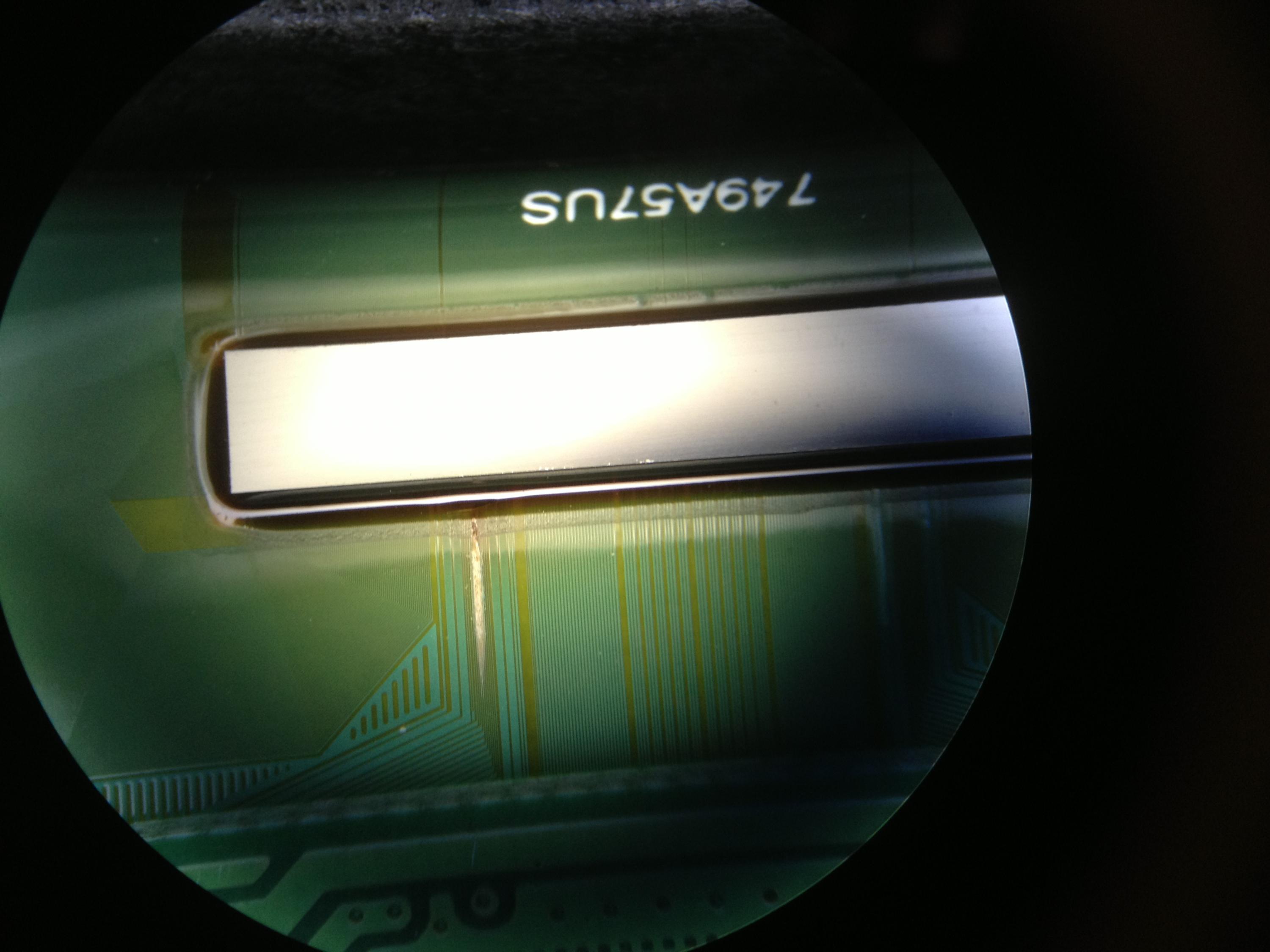

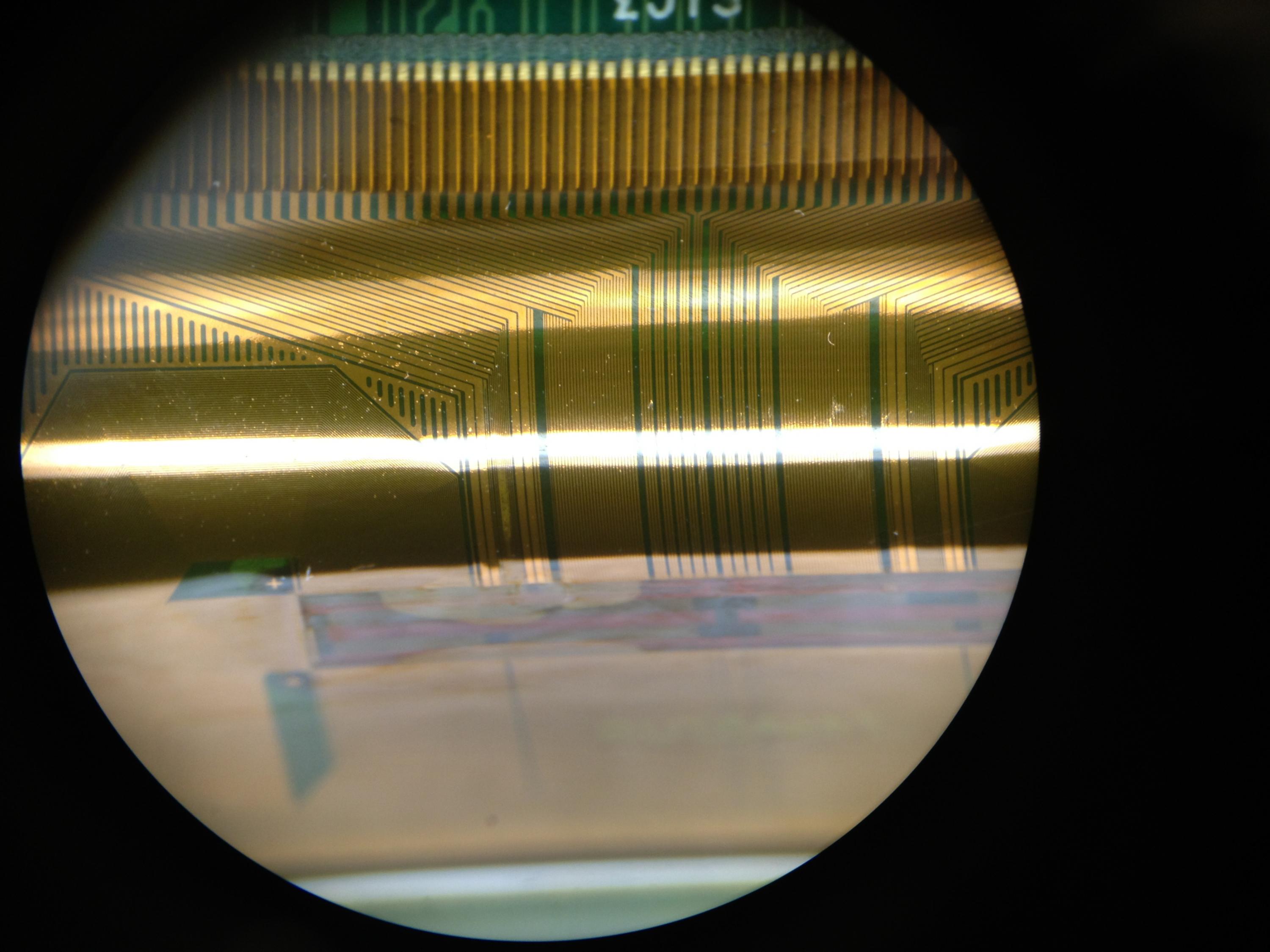

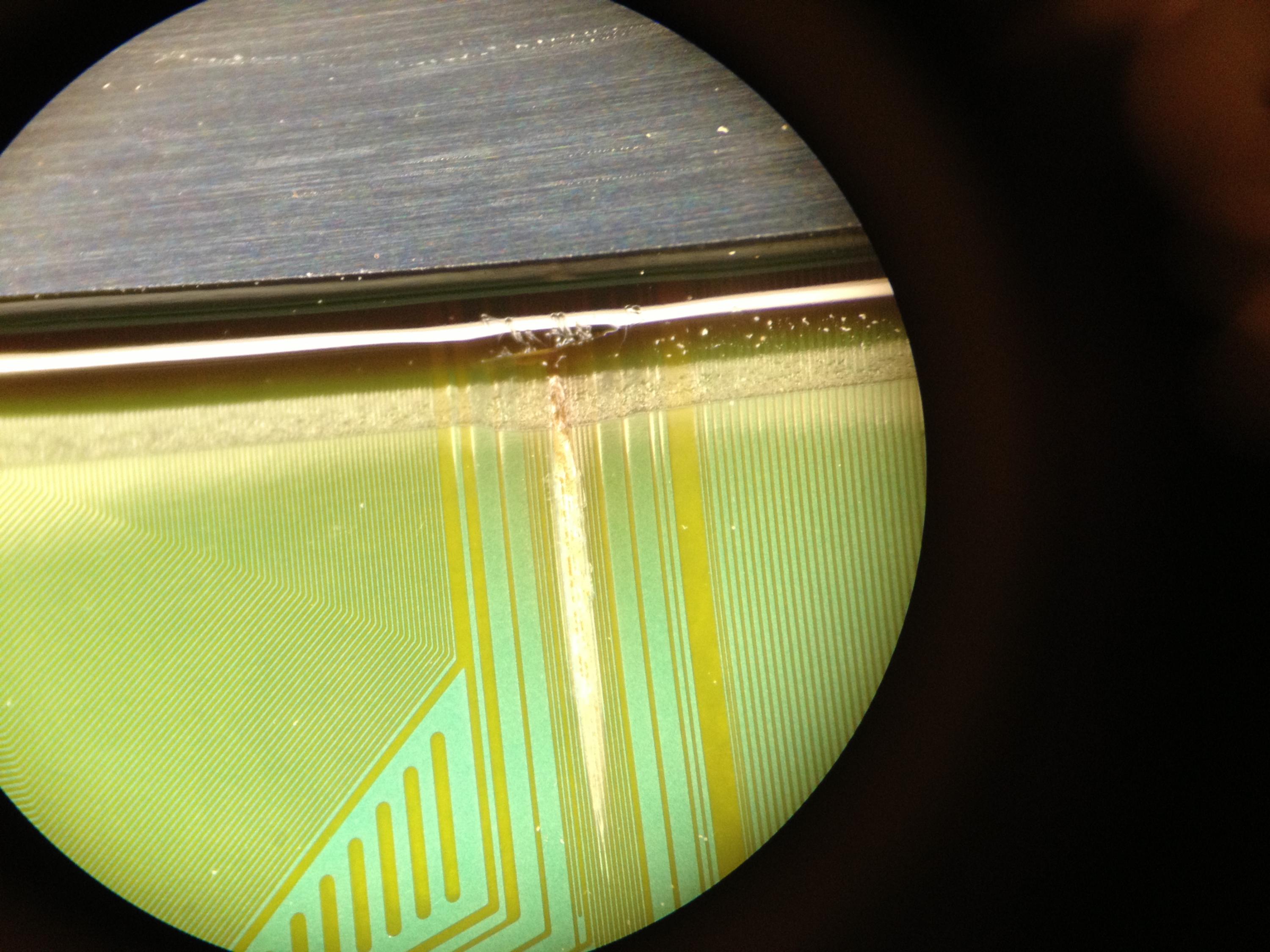

        Alright well I believe I found my issue. Sadly it is pretty scary and probably not able to be repaired. One of the tabs running of the lcd board running to the lcd has several bridged exposed contacts. Not sure how the hell it happened but none-the-less it did. I attempted to take a few photos through my microscope to show you all the damage.
        The brown colored ribbon photos are taken from what would be the outside or topside of the ribbon and the green colored ribbon photos are taken from what would be the inside or underside of the ribbon.
        I think I am going to attempt to repair using a conductive pen and an xacto blade.

          My guess would be the ic or the panel shorted over heating the trace.
            Re: KDL-46v3000 Sony Bravia LCD issues
            It does look like burnt traces.

              Okay I have since completely removed the LCD panel and moved it to my work station. After another close inspection with the microscope I have found a grouping of thirteen traces running from the LCD ic to the LCD pcb. Mind you there are probably a 70 or so in total off the IC but the column where my problem is only contains thirteen. Of the thirteen only eleven actually are in use and the other two just run a ways and stop connecting to nothing. Sadly not the traces I have issues with.
              Now the good news. Well kind of. Lol. I currently have six or seven exposed traces however only one is broke and lifted. The others seem to be okay and not shorted to a neighboring trace. My plan is to somehow cover the exposed traces then reconnect the lifted trace and cover it as well.
              I read an interesting post a few days ago at another site avs something rather entitled universal tab repair. In it the poster discussed ways of rebonding panel tabs. My issue isn't where the tab connects to the pcb though as I have now found a few traces in the "tape" that have lifted from the ic or at least appear that way. I can't really ohm them out due to the ic being glued with a silicone of some sort not to mention my fluke doesn't have tips fine enough to touch single pads on a chip that size. Having nothing to loose and everything to gain I decided to use a tunnel type tip on my soldering iron and proceeded to apply a little pressure to the affected area. This does not seem to be doing anything and I have decided the tape that is used to enclose the traces is apparently GMO made from superman's DNA.

                  Well I believe what happened is that I most probably got the tabs to rejoin however I think the ic itself is shorted somewhere as it instantly would heat to a few hundred degrees. At this point in the game I have sat the unit to the side and plan to sell it off as parts as I know the rest of the parts are tested and working well. I still plan to play with the tab bonds and try to find reasonable repair ideas for them.
