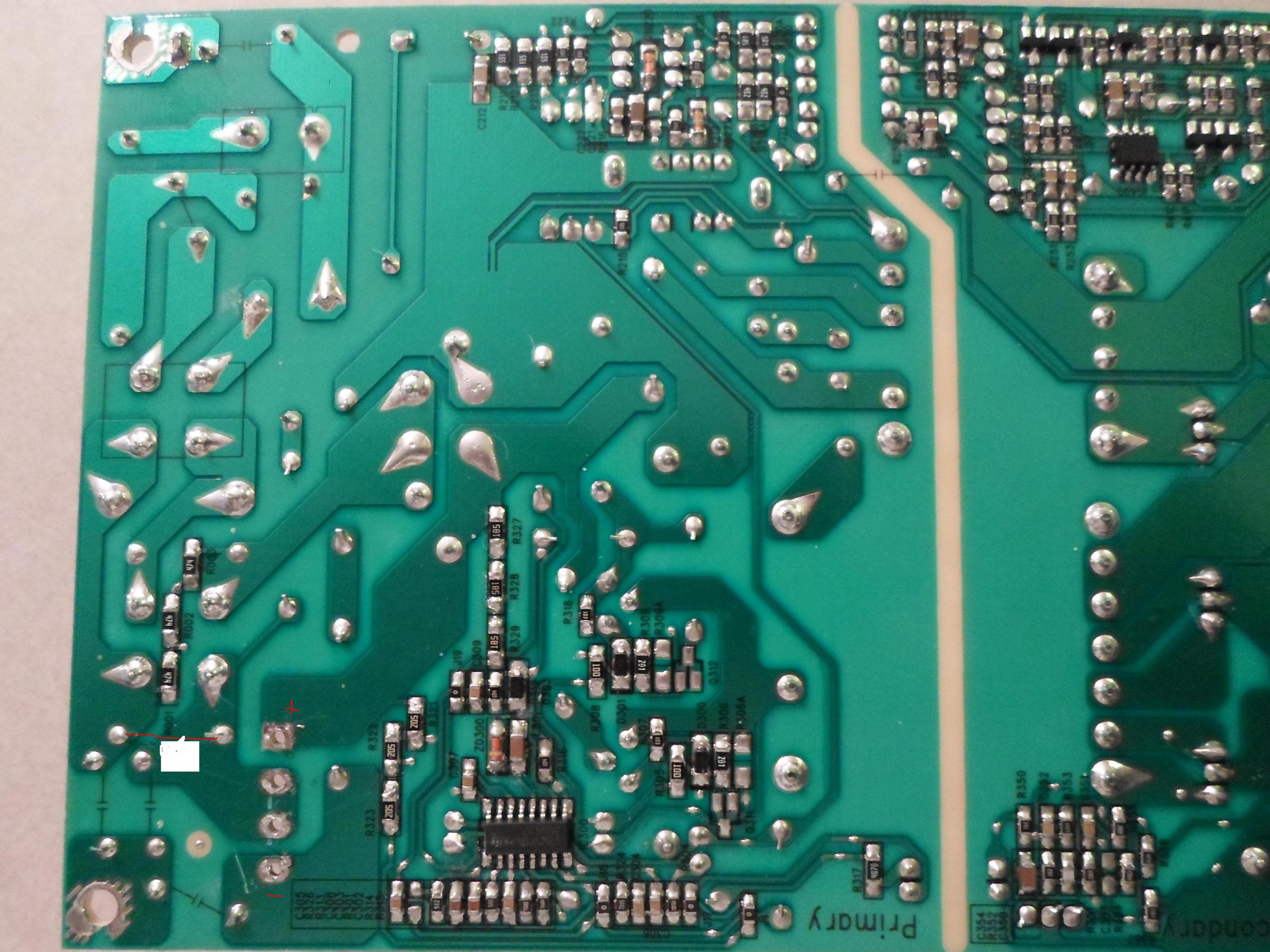

    The TV is dead, main fuse is good. Have 120VAC voltage at connector CN1 but no voltage at center pins of bridge rectifier. Center pins show short. Removed bridge rectifier and tests good. Center pads show short. Not much experience in what can go wrong before this point but this seems like a very simple design.

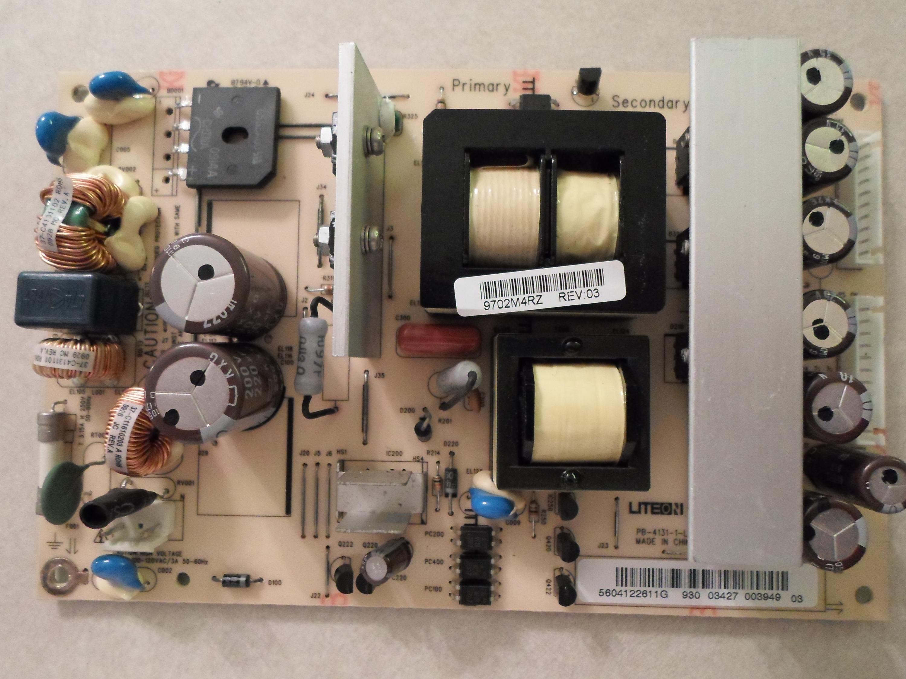

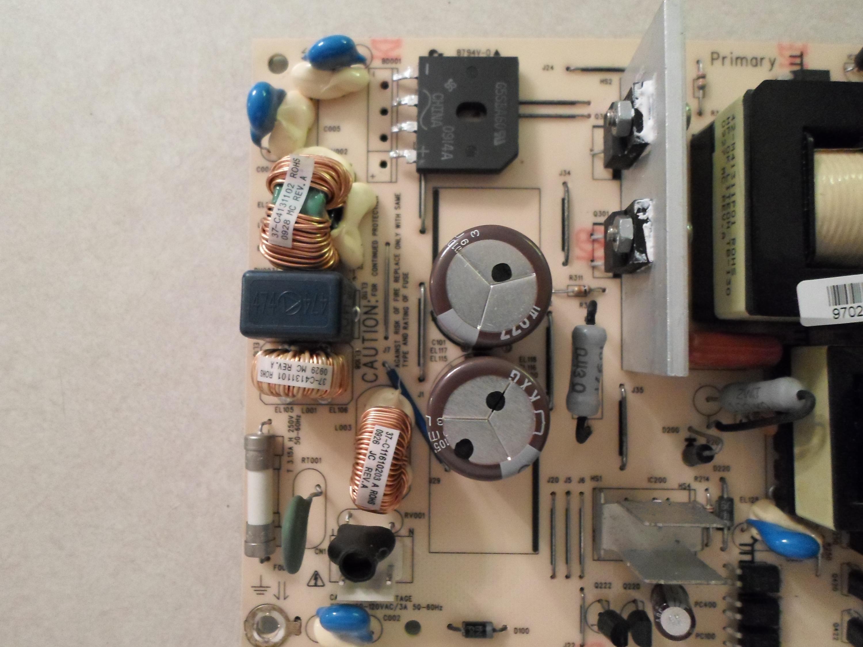

    Re: Westinghouse SK-26H735S Power Supply Problem
    In the pic you can see where the bridge rectifier center pins are, is it supposed to be low ohms between these pins?? Without the bridge rectifier installed I still do not get the 120VAC there I just cannot figure out why and there's not much there so I feel kinda dumb!
    Also, with the bridge rectifier removed can anything else on the DC side cause this?
      If the bridge at the top left of the board is shorted (or shorted load), then I would expect the main fuse to blow.
      I look at the traces, the two pins are connected both ~ pins together. I will have to trace out the connection to see how it is designed.

        The thing is Bud that it tests fine out of circuit, but in circuit ~ pins show short and removed, the ~ pads show short, is that normal? I edited the post above if you can looks at it and see if something could be blown or shorted..??

          As I said not too familiar with components over in this area but RV001 (varistor?) is open. Should it be?
            I am tracing out the circuits right now, that in-rush current limiter RT001 should have low resistance around 3~5 Ohms. What are the numbers printed on the body? RV001 is the MOV for surge protection, it should show open circuit.

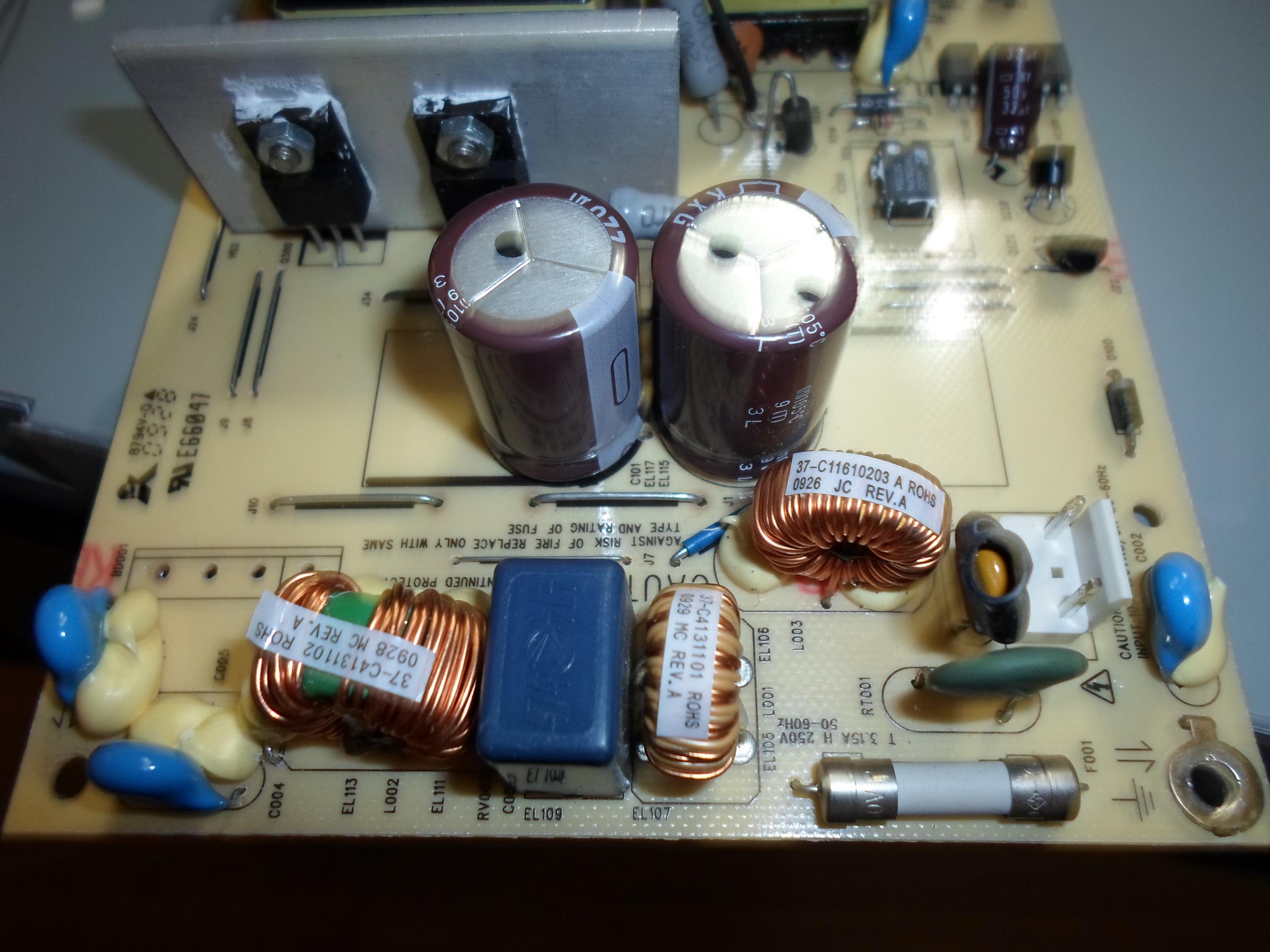

              RT001 is around 5 ohms, SCK 055.
              In post 2 picture 2, there is a blue component with EL109, is that a coil? It tests open with meter and with a ring tester no lights.
                  OK the bridge rectifier is connectED as the voltage doubler circuit, you should see about 160VDC on the each one of the main filter caps. The total out put is 320VDC.

                    First though I have no VAC to the center pins. I don't know why, and don't understand why the bridge rectifier center pin pads have 0 ohms between them.
                      They are tied together so it can be used for the voltage doubler circuits. Is there any voltages on any pins of the connectors on the right side of the board, the small transformer is more likey to be for the 5V power supply.

                        I get 160vdc on the caps! I don't get it but it's there, sorry. When I didn't see the AC voltage I stopped, never seen this before... Let me check other voltages now..

                          Im thinking maybe a main board problem, voltages are erratic. The only one that is consisent is the 5v Stdby when not plugged into main board.

                            Well Im not sure now, if I jump the 5v Stdby with 3.3k resistor to PS_ON with main board connector unplugged, I get no backlight and the 24v comes up and slowly drops off.. Would this indicate a backlight problem?
                              For the backlights to come on it needs these signals: 24V (PS_ON to turn on the 24V power supply), BL_ON to turn on the inverter circuits, PWM signal (about 200 Hz) for dimming if it uses the PWM signal for dimming control instead of the analog Dimming signal.
                              If the main board is not sending out the PS_ON, BL_ON then you need to start looking at the main board.

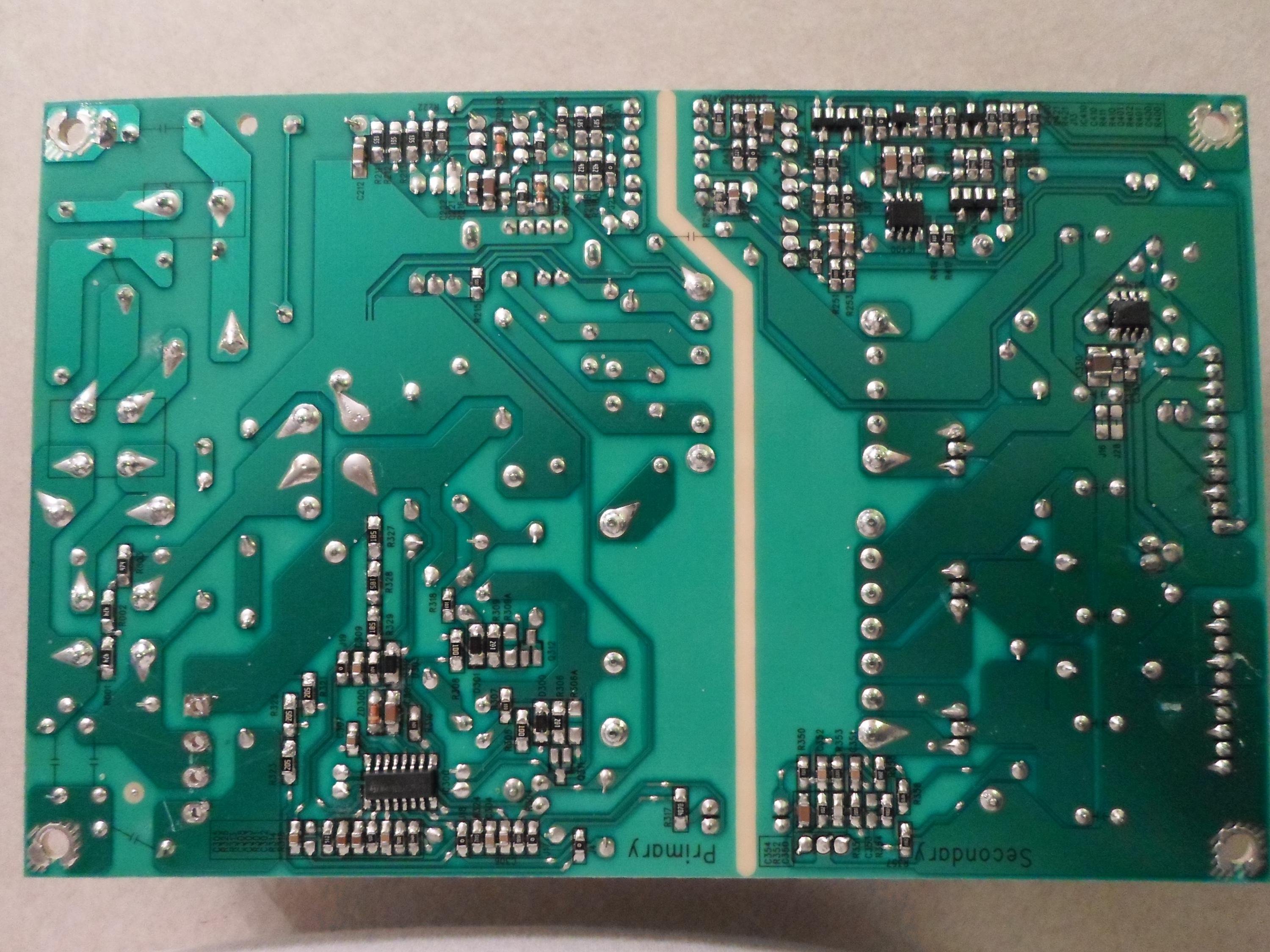

                                      not sure this is a good enough picture but voltages are steady. what can I check. I am new at this and any help would be appreciated
