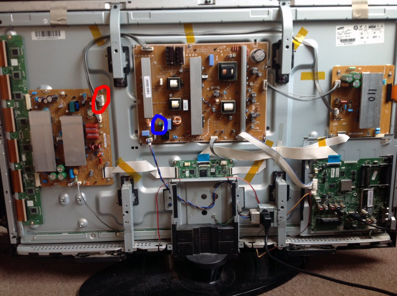

        Newer than I expected. Can we have pictures of the chassis? This model, I don't think it has the Y-main capacitor failure but may suffer from NTC relay issues. Do you have a digital multimeter?

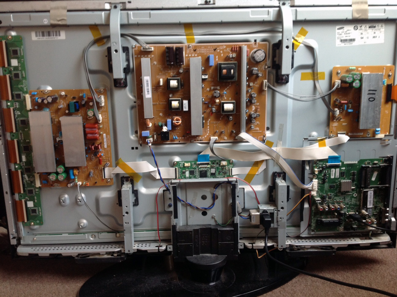

          Re: Samsung 42 picture problem.
          Here is a photo, and yes I have a DMM
            OK, I've highlighted two places to make some tests.
            Plug in the TV and verify the fault occurs.
            On the RED ringed connector, measure the voltage on each pin. Post the results.
            Wait for the TV picture to look relatively normal (wait maybe 10~15 minutes.)
            Measure the voltages again. Post the results.
            Turn the TV off. Unplug it completely.
            Feel the temperature of the BLUE ringed green component, this is an NTC. (Never do this with the set plugged in -- shock hazard!) Is the component cold, or burning hot?

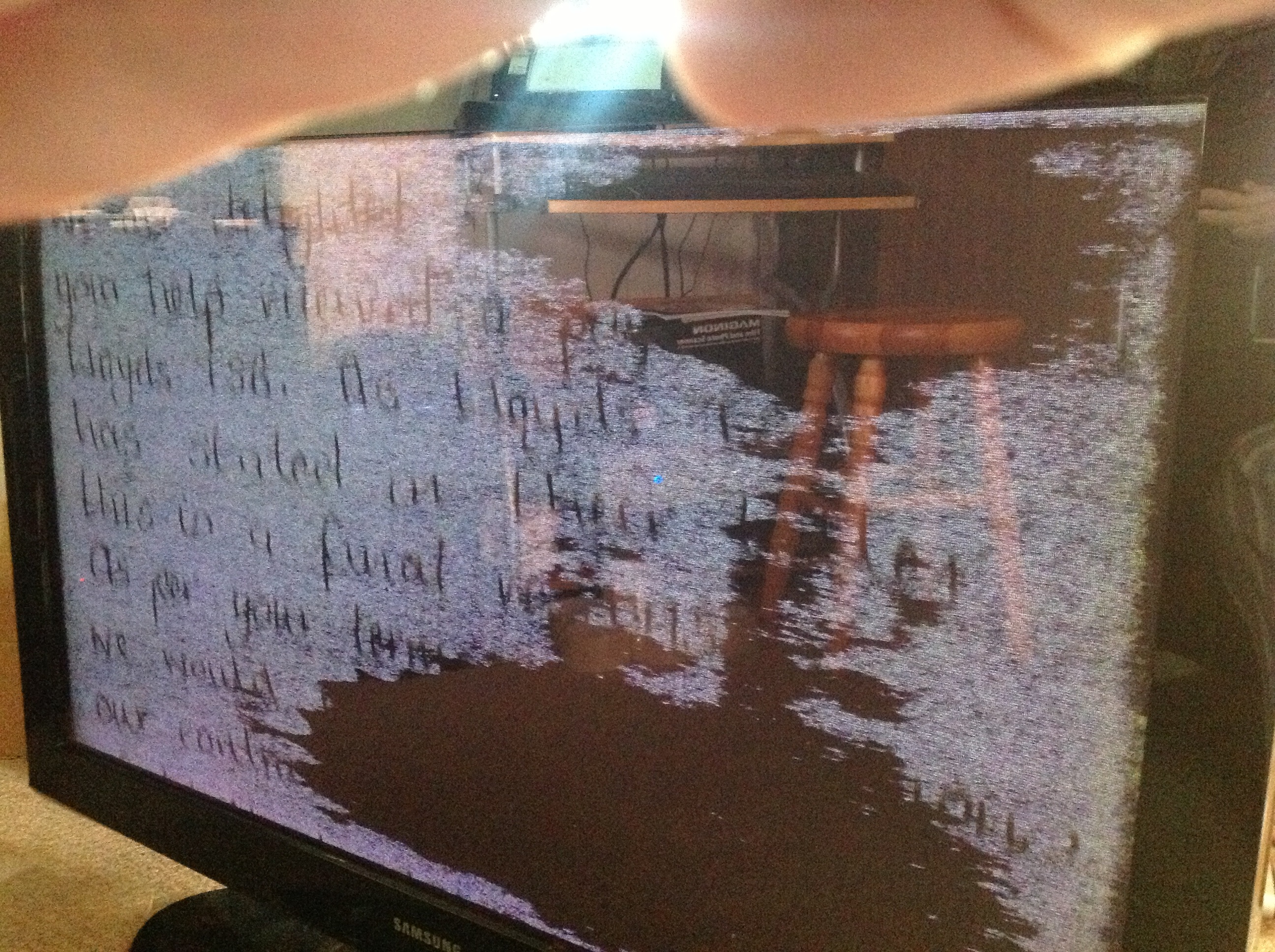

              Here is a photo of the screen, and picture, I will do as you have mentioned when I get home.
              Thanks.

                The NTC is cold.
                  Hmm, we may be looking simply at X-main fault.

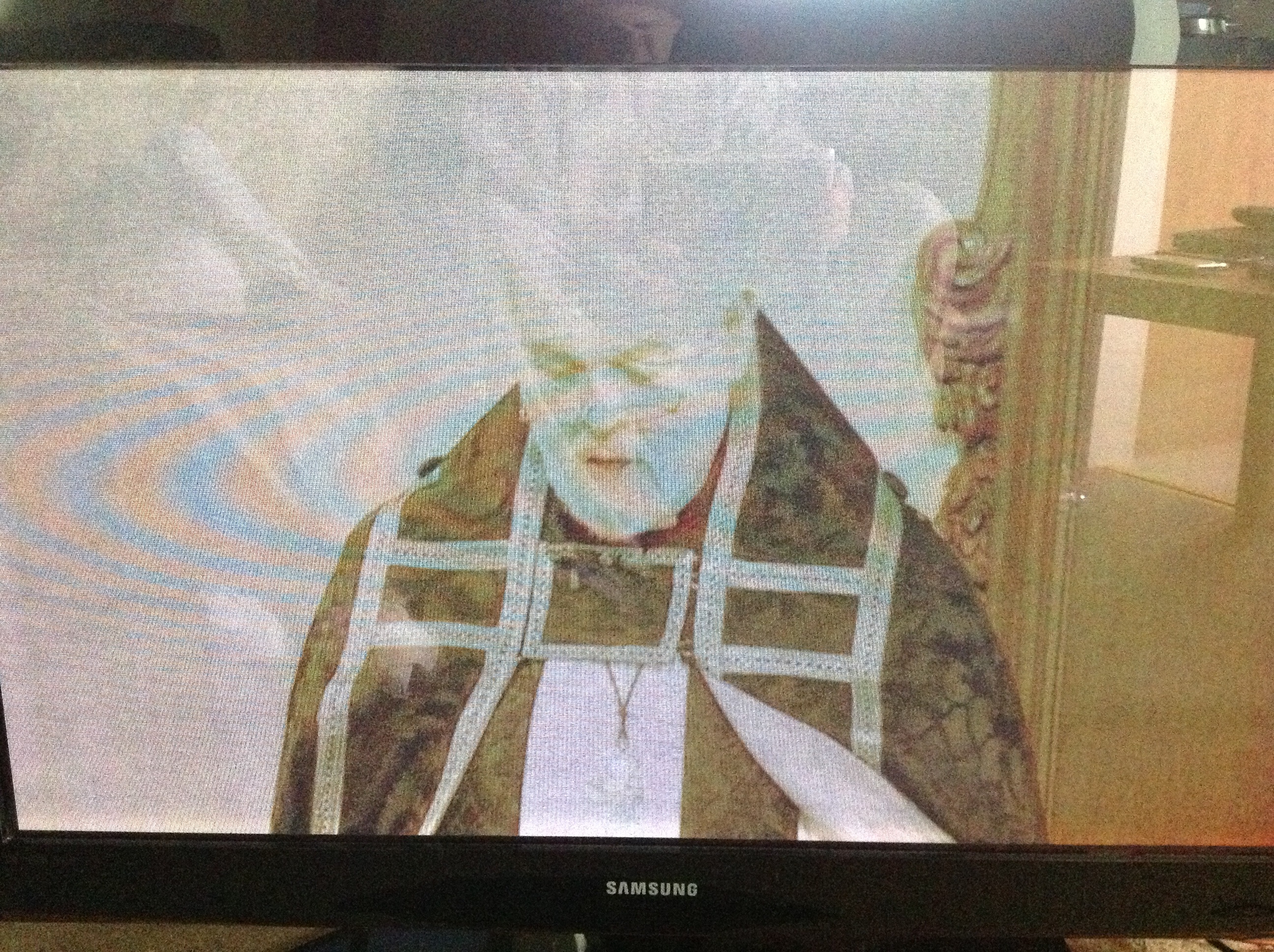

                      Ok I have swapped the x main board, this means both the x main and y main have now been changed.
                      What I have now is a watchable picture, but with very little colour or definition.
                      The black screen and lava lamp problems have now gone.
                      Picture attached.
                        Here is the latest picture I am getting, the same on all inputs.
                          Very green tinge to everything.
