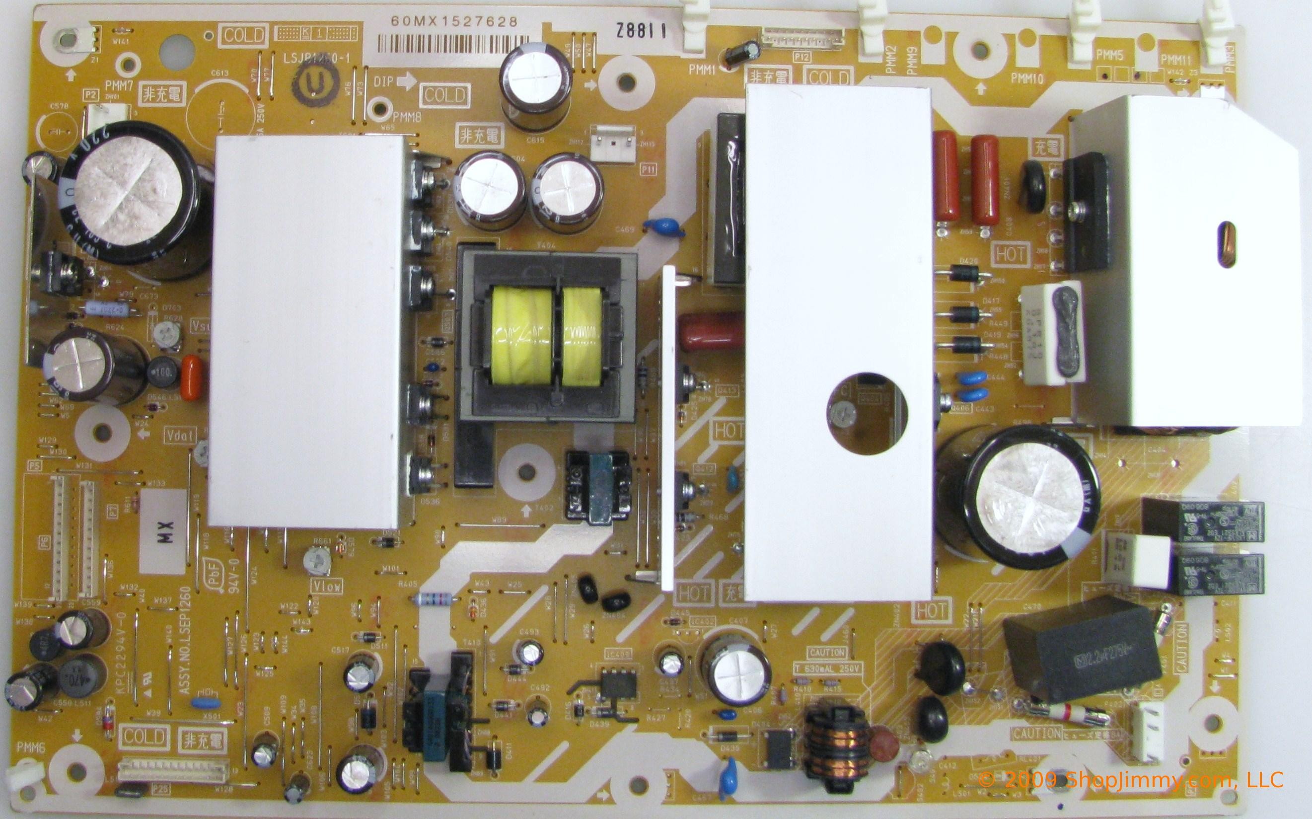

              Hey guys! I am working on a Panasonic TH-50PX80U. It keeps blowing fuses and will not power on. I have isolated the short at the SS board. I was going to just order a new board, but I wanted to see if I could possibly just fix it. My question is, does anyone know what usually shorts out on these boards? It only blows the fuse when I plug in the 15V plug to the SS board. I am pretty good at diagnosing problems, but I am not very good at finding shorts thanks!

                I doubt you have an SS board fault. Your PSU is probably popping fuses as soon as the main outputs power up. This will occur if there is a short on the power board. There are very few ways an SS/SC board could cause a fuse to pop on a Panasonic plasma.

                      All FETs on power board. Especially the ones that are hidden under the board, the leads are exposed though. Pictures of your power board would help.

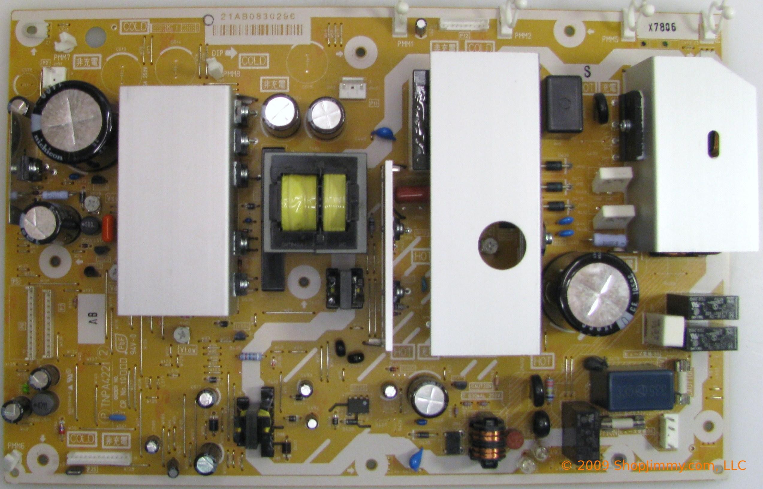

                            Does it look like the picture? The one on the right is the one the tech bulletin was for. Not a huge difference between the 2.
                            LSEP1260MXHB
                            That looks very similar in design to another with a known issue with Q406 on the heatsink across from thr bridge rectifier.
                            Did you check the FETs as TOM mentioned earlier in particular Q406?

                              Yep it's the one on the left. I did the up date on the bridge and changed the Q406,F401,F402,C426 and when I plugged it in it pop the F401 and F402. So I'm not sure what up. And will both P-Boards work on my tv?
