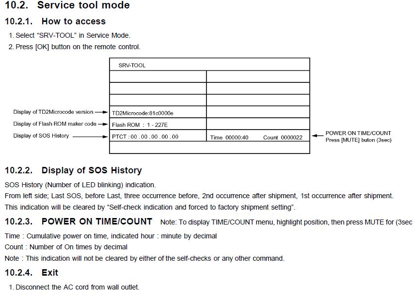

                                You know you can access the run time within service mode if you really want know how many hours.
                                I've had 2 of that generation, one had 10 000 hrs and appeared to have no boards replaced. The PSU had not been touched.

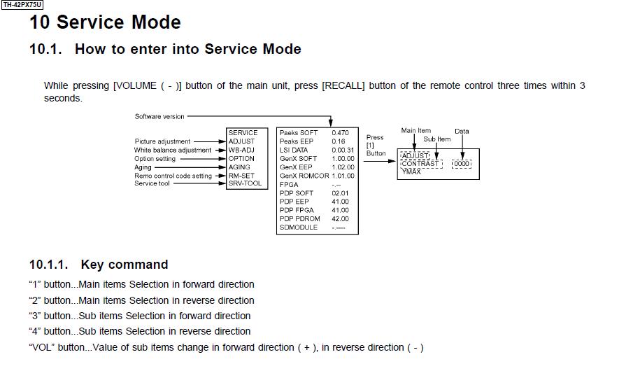

                                    I did not know that. Would you mind telling me how or is pretty straight forward? I know I could look in the service manual, but it's easier to ask.
                                      Re: Panasonic TH-50PX80U need help with a short!
                                      Hold (-) on remote and press "0" three times on remote. After about 10 secs service menu pops up and the counter is on there, I believe.
                                        Something like this. You have to activate the serv menu, then navigate to the field it is displayed in and then activate the timer count for it to display.
