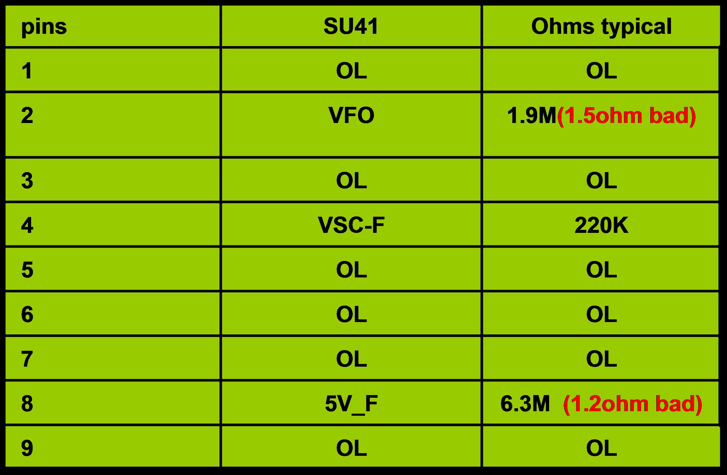

                          So you need a replacement SC and you can test the SU/SD boards. If they test with no shorts or low resistances then I'd re-use them. On my TV i was lucky as they tested ok but I did replace them initially but have used my old ones since with no problem.

                          As a guide for the buffer boards here's some results.
                          I found placing the red probe to the gnd plates and black to the pinouts gave the most accurate result for resistance.

                              There's no other way but to probe the buffers , even if you purchase replacement buffers secondhand you must check them as you can't assume the seller has!

                              VSC_F should be VSCN_F in my table, I think anything above 190K is ok for that, I think I may have received a board with that one shorted too but It should be obvious if you do find one bad.
