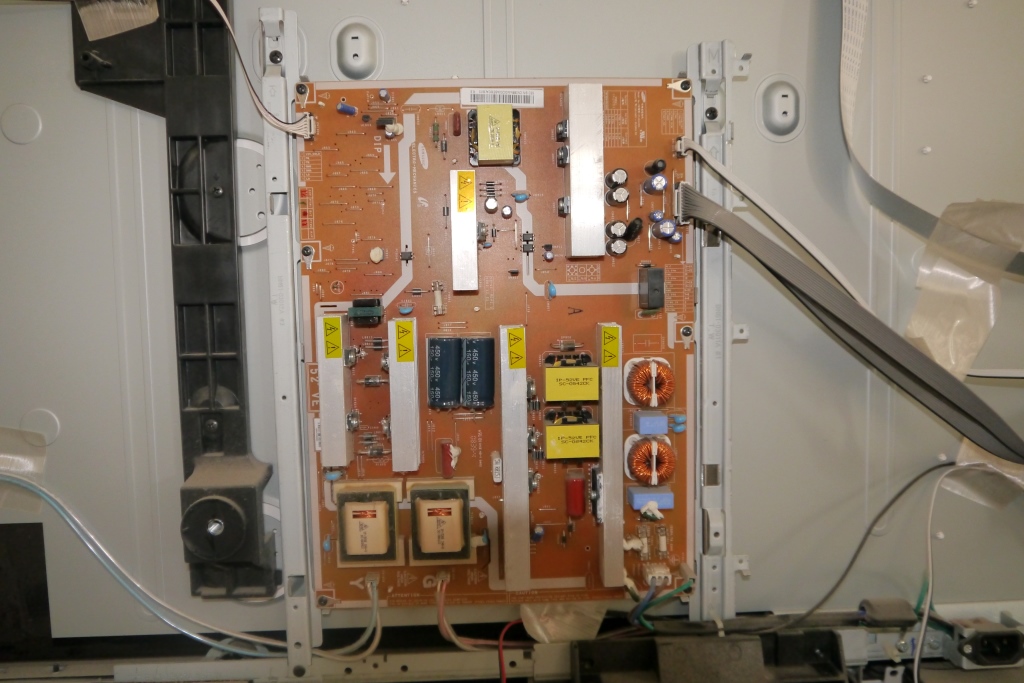

              I have a Samsung ln52a550p3f as well and I can see the picture but I cant get the backlight on. There is an orange board that the power supply plugs into, and the backlight inverters also plug into it. Do all 4 of those have to be replaced? Or should I replace the entire board?
              • capkid
                • Oct 2010
                • 1339
                Re: Samsung LN52A550P3F - No Backlighting
                Pics of the back of the TV with the cover off would be helpful for diagnosing your issue.

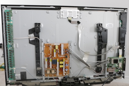

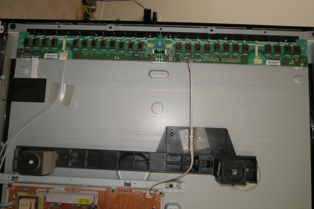

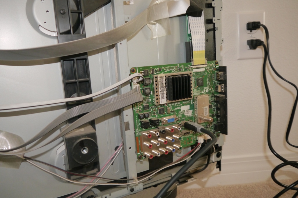

                  Here are some pictures from the unit

                    You have sound, correct? Do you have a digital multimeter? If so, please post the voltage readings for each of the pins at black connectors CN801 and CNI805 on the power supply when the TV is turned on.
                            For reference:
                            Orange board = Power supply/inverter board. It takes the AC current coming from the wall outlet and converts it to usable DC current that powers the TV. I call it the heart of the TV.
                            Green board on right = Main board. It's more or less the brains of the TV. It sends turn on/off signals to the power supply, and it controls a lot of the audio/video circuitry.
                            A cheap multimeter would be fine.
                            LG Plasma Mal-Discharge Correction Service
                              You can see the grey cable in your picture at close to the top right of your power supply board (yellow).

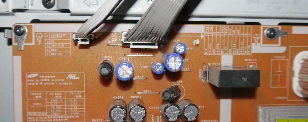

                                Cool thanks for the reference point. I had no idea what those were called. I disconnected the thin light grey cable at CNI805 and the TV turned on with no backlight, and then tried it with the thick darker grey cable and it didnt turn on at all.
                                  OK, on the power supply/inverter board where the grey wires are connected to the connector, can you post the pictures or tell us the labeling next to that connector?
                                  • eaglecaper
                                    • Sep 2013
                                    • 10
                                    Here it is.
                                      OK, the piiture is so out of focus, I can read one pin as PS_ON but cannot read the others.

                                        Set the meter to DC, BLACK probe on the chassis, red probe on PS_ON, report the reading, then red probe on INVERTER/ON/OFF report the reading.
                                        B y the way, this model has problem with bad tab bonding problem, so expect that to fail.
