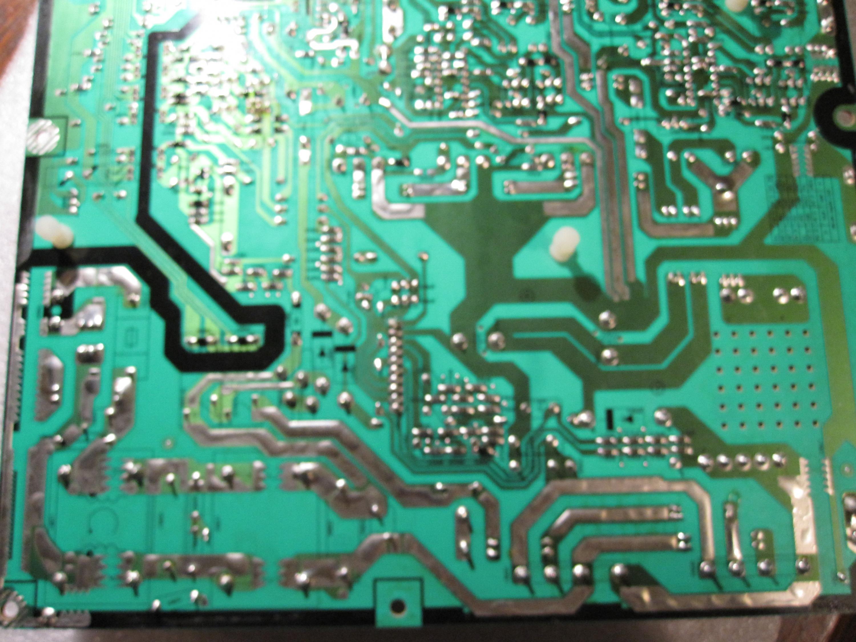

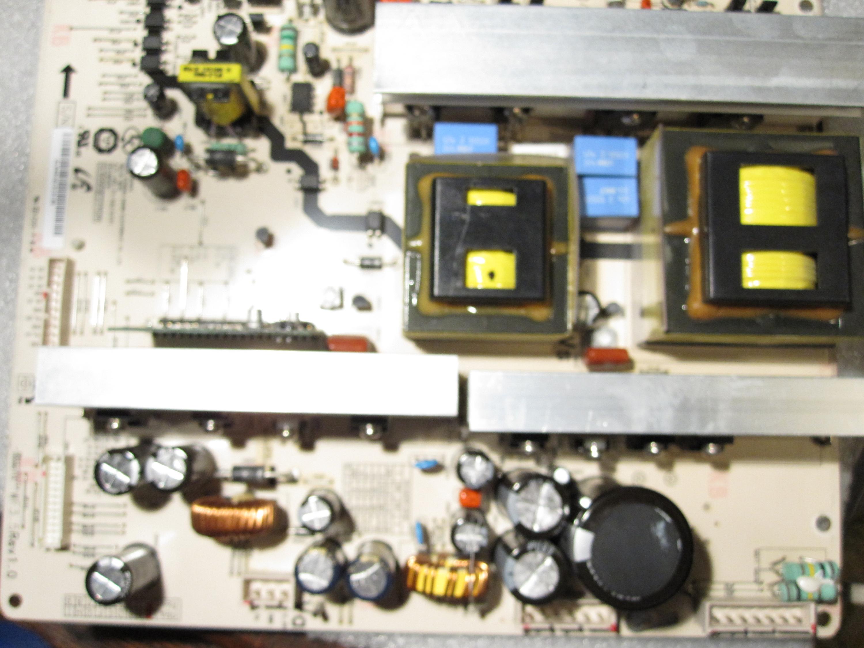

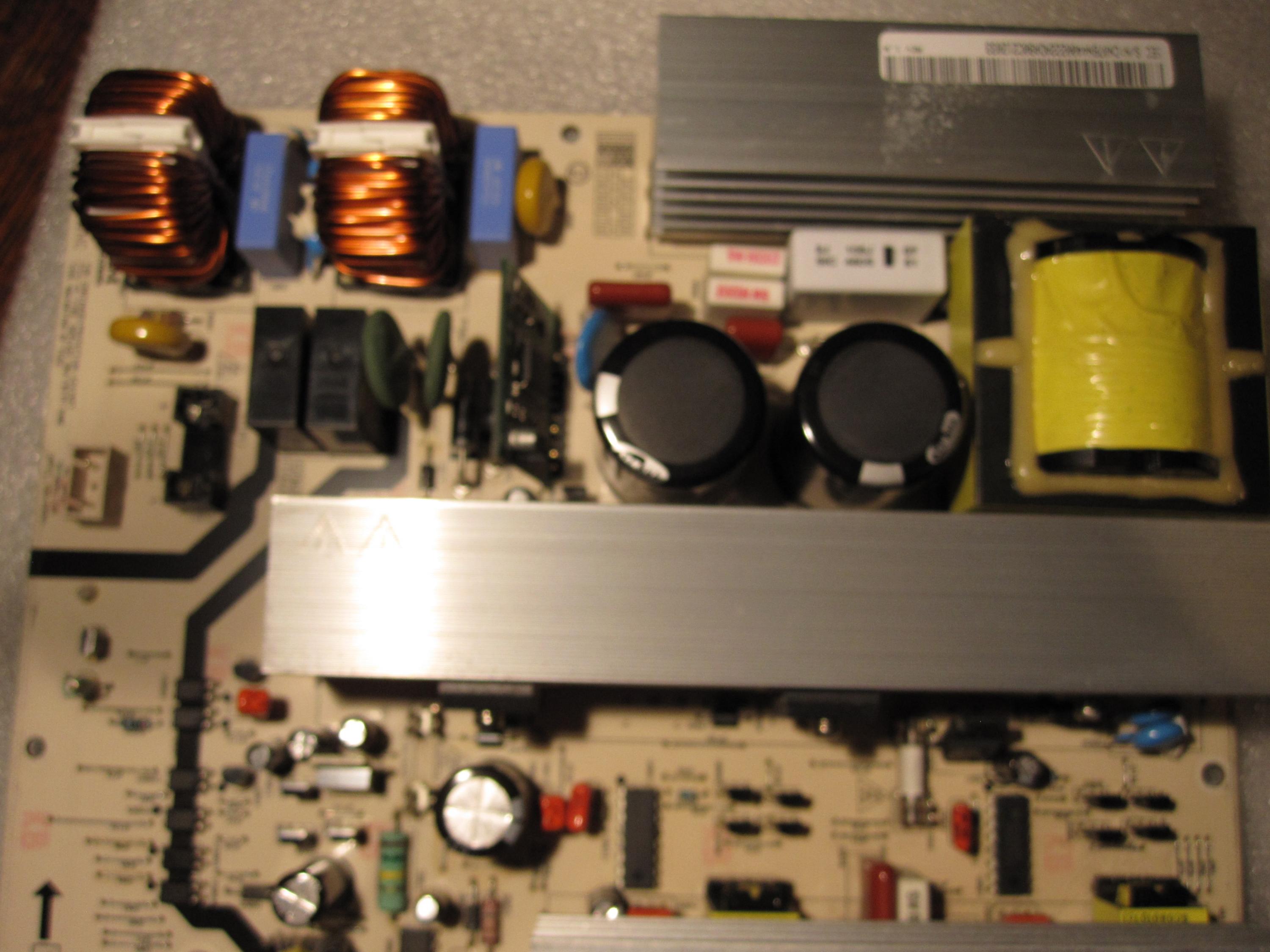

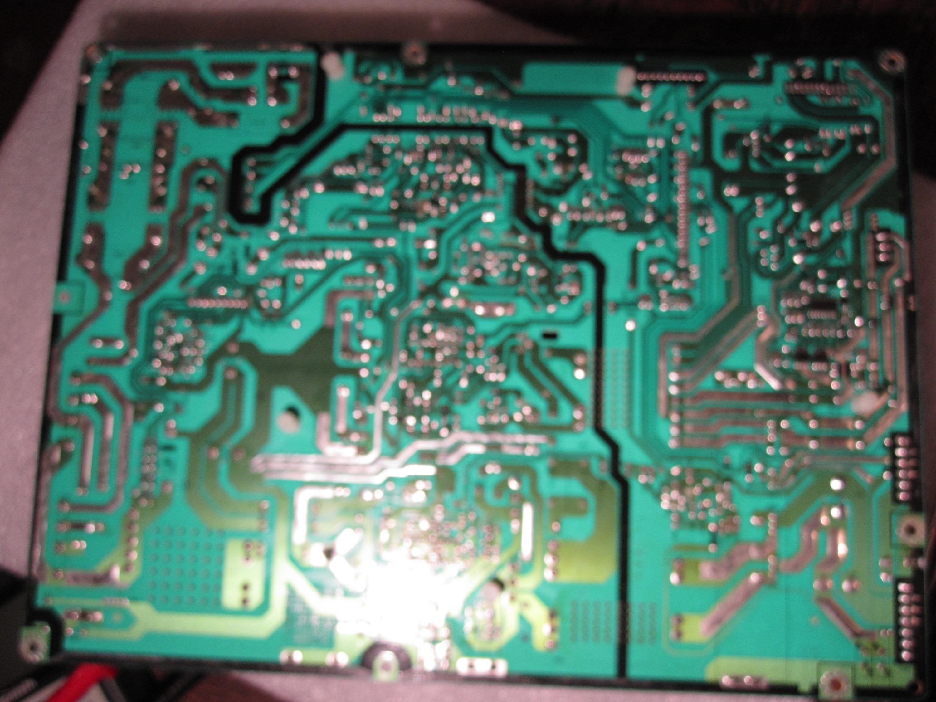

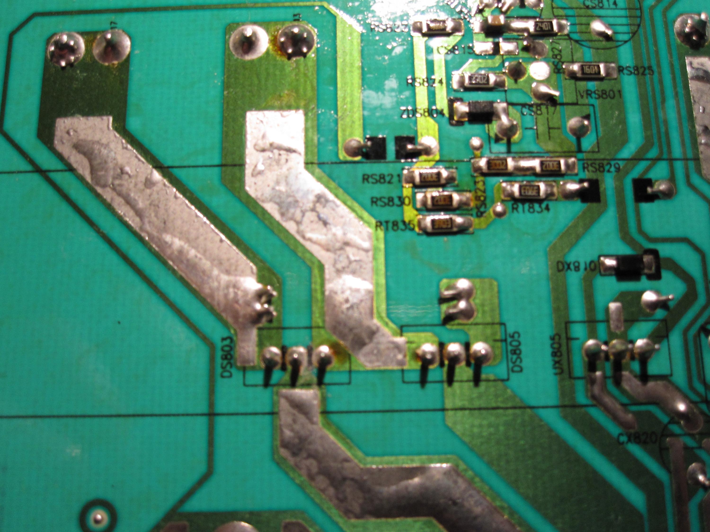

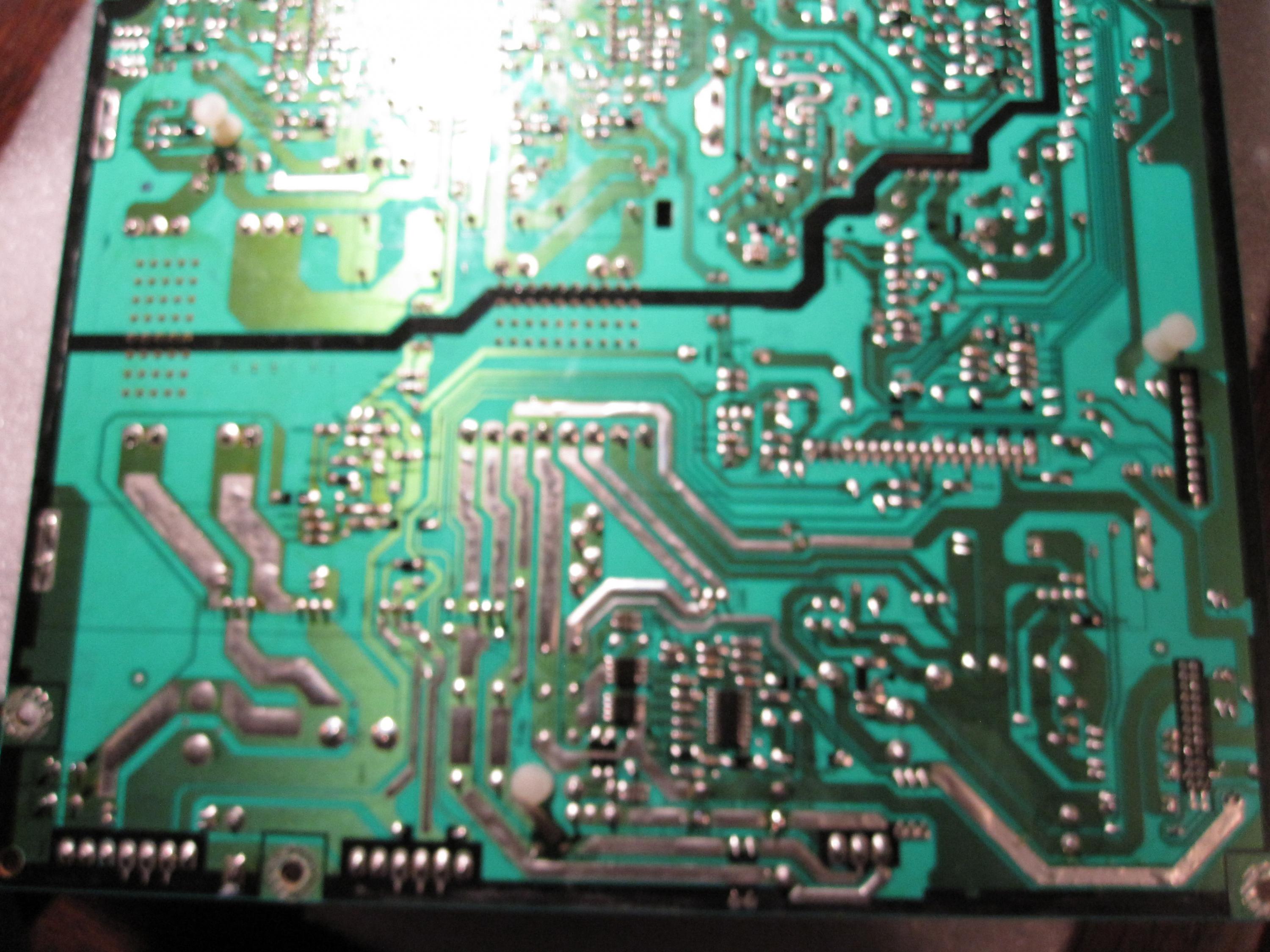

    Hi all, picked up this television and was told by owner that he went to put it on and it wouldn't power up, no lights.
    I found a blown 12amp main fuse and 2 10v 2200uf samwha caps bulged. I have replaced the caps with panasonic FC caps.
    Now i believe i can power up the power supply with every thing disconnected to check voltages on the connectors! However i don't want to waste a fuse or damage the supply by putting power to it prematurely.
    Should i check voltage regulators or anything else before powering up the board.
    I should say that i have managed to fix half a dozen computer screens, just lately an Acer and a Samsung T200 lcd, both with bad caps. previous fixes were with the help of this site and lots of reading.
    Here are some pics. Any help is appreciated.
    Mike

      If the fuse blew, check the bridge rectifier, big filter capacitor and power mosfet to see if they are shorted.

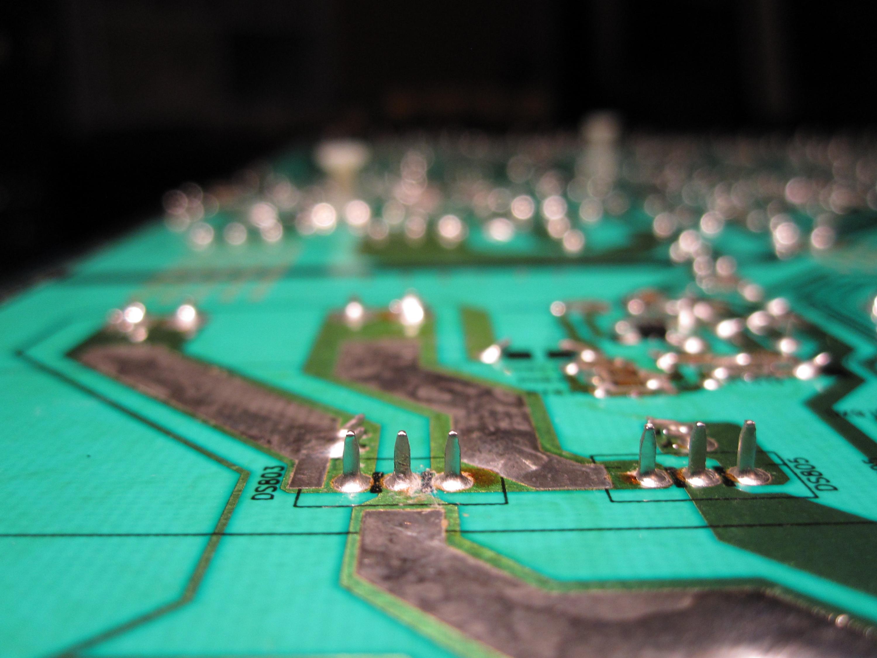

        Thanks for the reply retiredcaps, i tested the rectifiers by this video, http://www.youtube.com/watch?v=dqkT6hF0O3E
        they test good, DS803 AND DS805, i get a reading one way from - or + to ac, middle pins, nothing between the two middle pins.
        Now testing the large caps, 3 of them? CP810,CP809 and CS813 or just the first two. Do i power up the board and check the voltages and the mosfets your talking about are on the heatsinks. I can test these in circuit in the diode mode on a dmm.

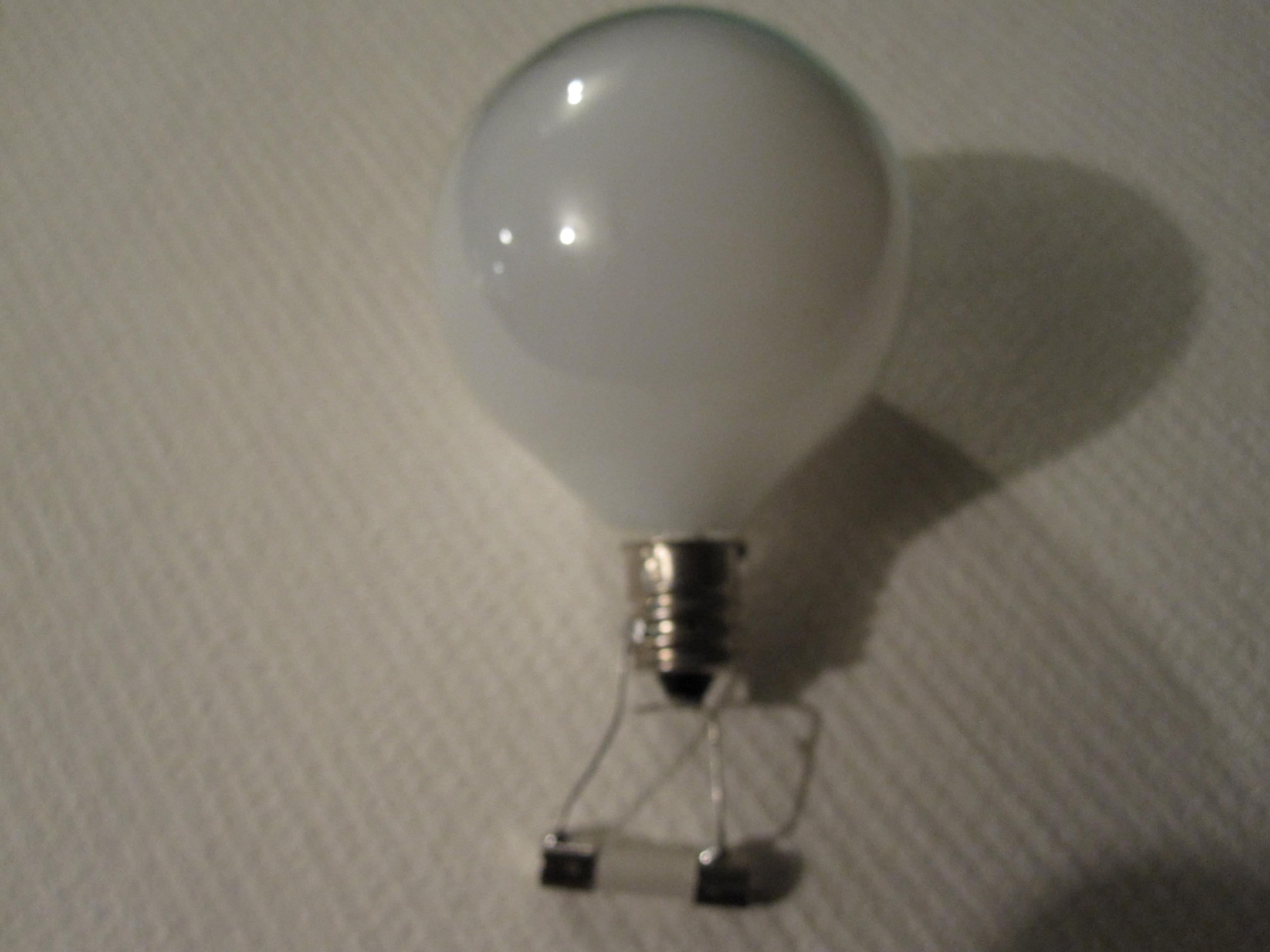

          Across the two largest 400/450V caps, test resistance (power MUST be off.)
          Consider building a "lightbulb tester" - put a lightbulb in place of the fuse. If the lightbulb glows permanently when turned on, there is still a problem. If it flashes or goes dim, then the PSU is probably OK.

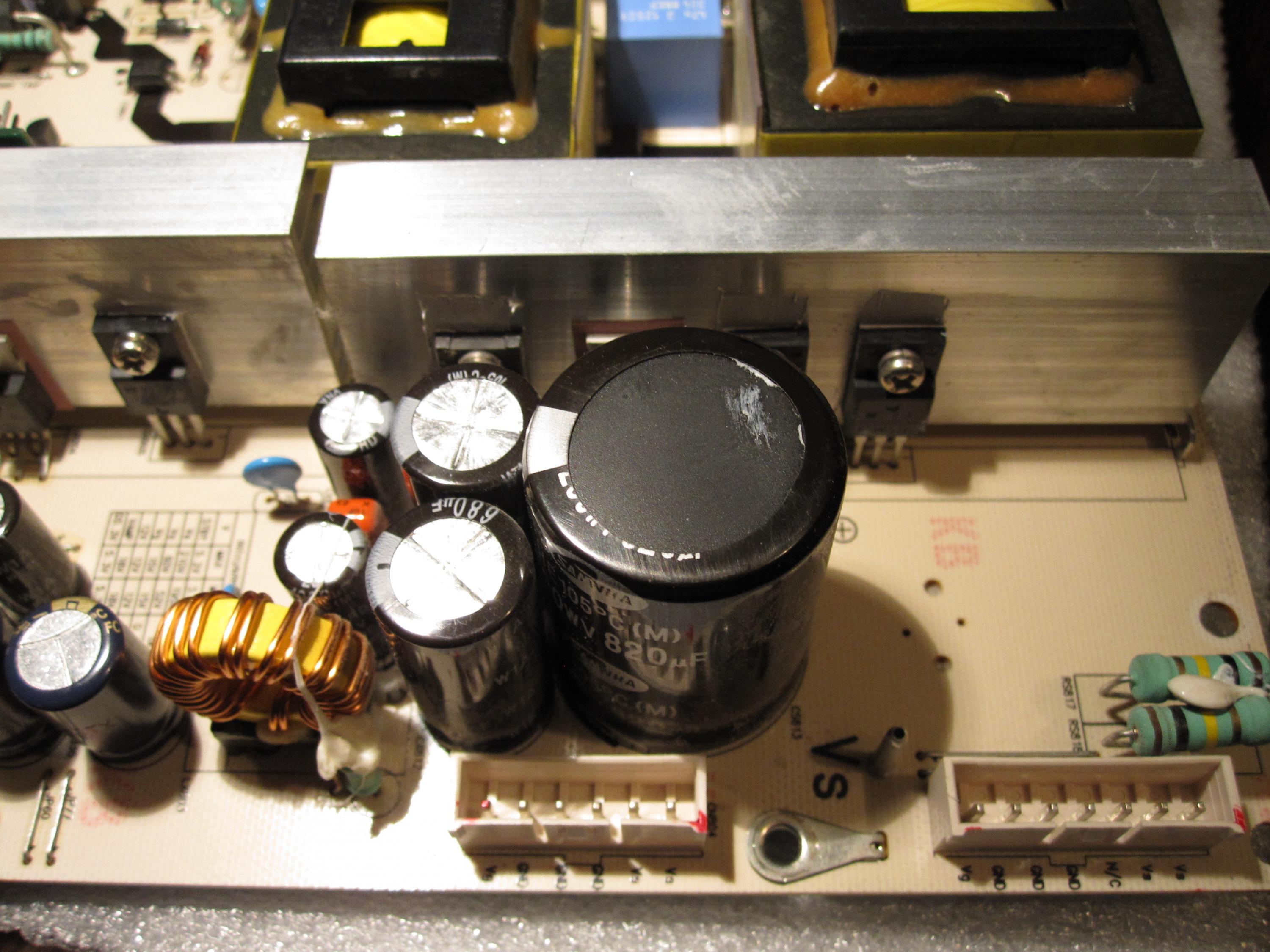

            Thanks for the reply Tom66, the two large caps 450wv 330uf read around 33 and 30mohms and decreasing. I have checked them a few times with different results, i guess it depends on the state of charge!

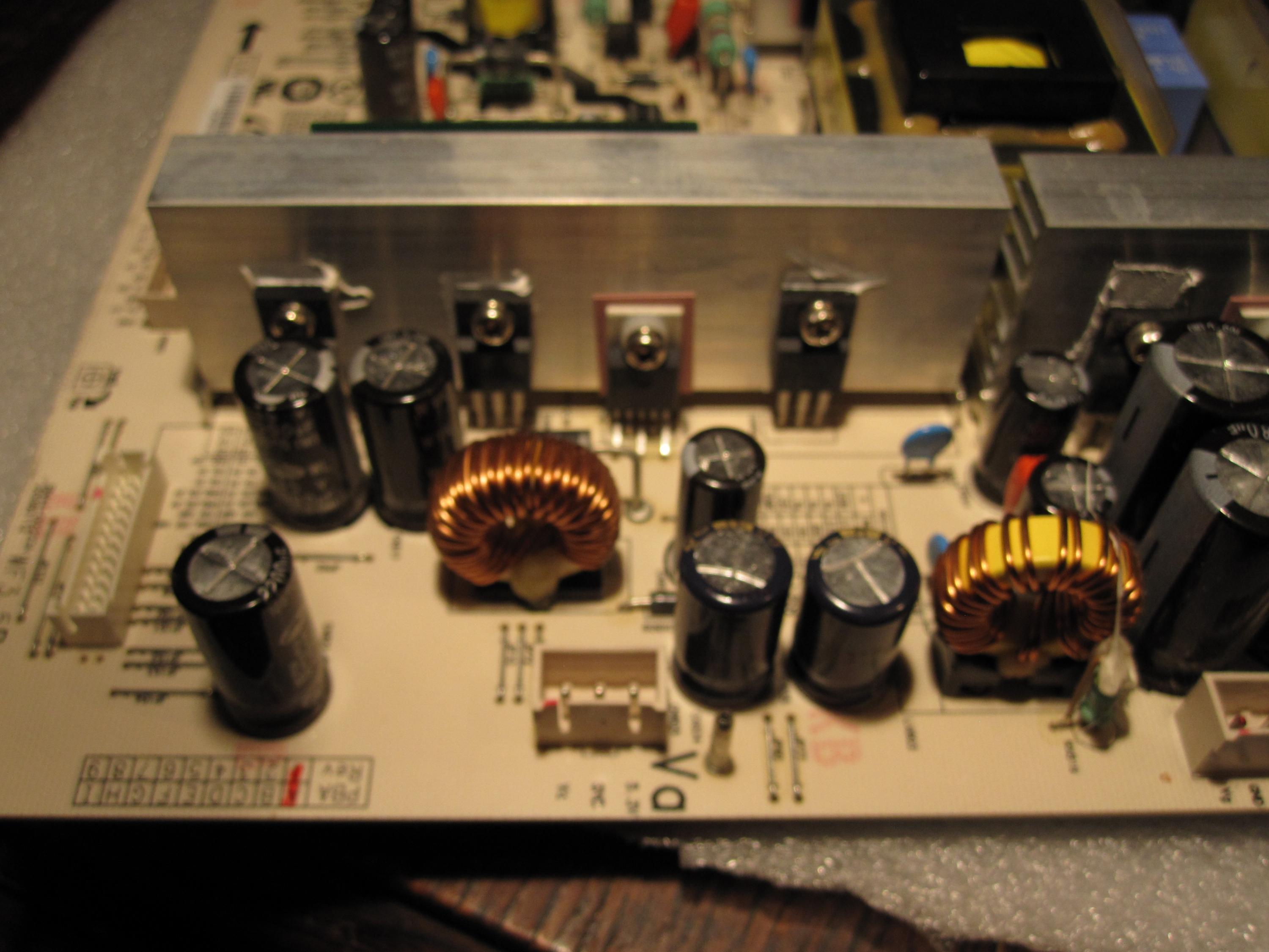

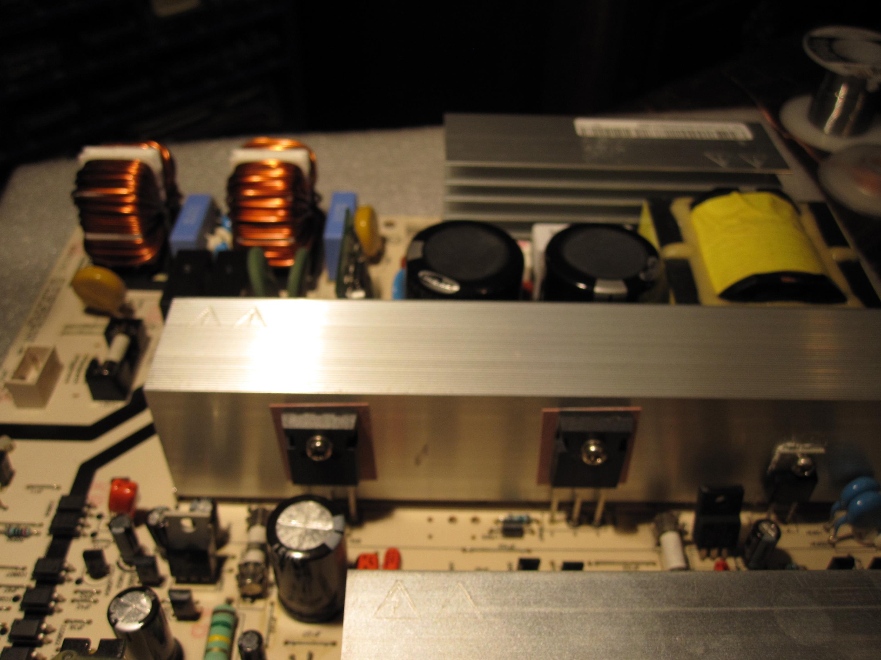

            Tested the two power mosfets on the heatsink, i believe thats what they are, QP801 and QP803. the results were.....
            QP801 S+ D- equals 1.053mohms part#20N60C3, GMN642
            S- D+ equals .820mohms and increasing
            QP803 S+ D- equals 1.051mohms part#20N60C3, GIP648
            S- D+ equals.815mohms and increasing
            The meter i have is a auto ranging.
            I made up a light bulb tester with the blown fuse and a 25 watt bulb, but after more reading, i realized the bulb should be 100 or 200 watts. I am going to make one, what size bulb should i use and do i leave all the boards disconnected from the supply?
            Here is a link to the manual, if it helps or if anyone else needs it.
            http://elektrotanya.com/samsung_f43a.../download.html
            Pics of tester and mosfets i tested.
            Mike

              A 25W bulb will do for standby testing, but you need a 100W bulb to try starting up the PSU. TV will not work with it, but it should at least show if there is a fault.

                                  Did the light bulb trick, 100 watter with a couple test leads, bulb did not light........ ps only.
                                  I then reconnected everything back together as i had it all apart for cleaning and testing.
                                  Retested with light bulb and it would come on then off in conjunction with the relay clicking on then off.
                                  I put the fuse in, connected a dvd player and started everything up. Red power light come on then the blue light in the middle, heard samsung start up sounds but no pic. Changed the cables around still nothing...... unplugged everything and reseated buffer cables, looked around boards to see if i missed a cable, and i did. So i connected the ribbon cable to the ymain and powered it all up.............. now have a running tv for now.
