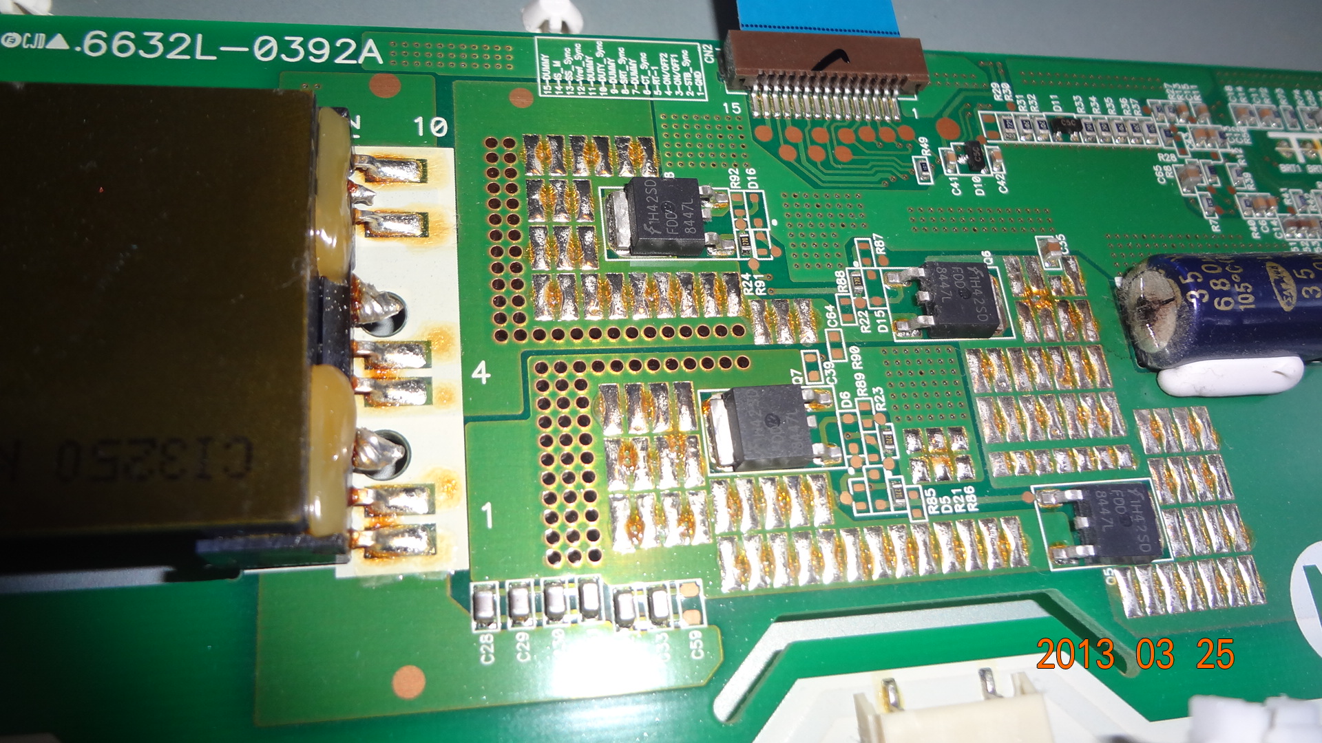

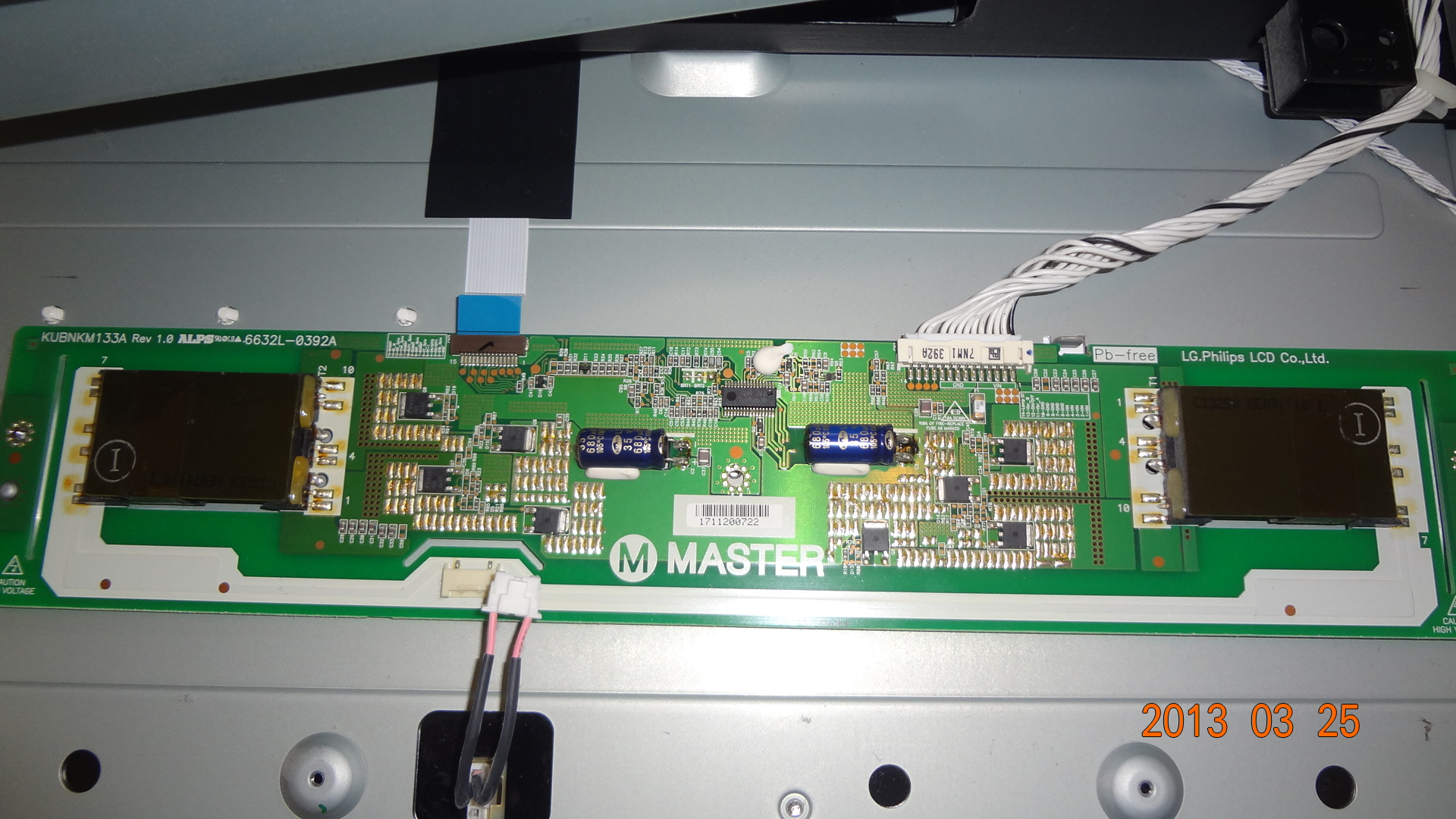

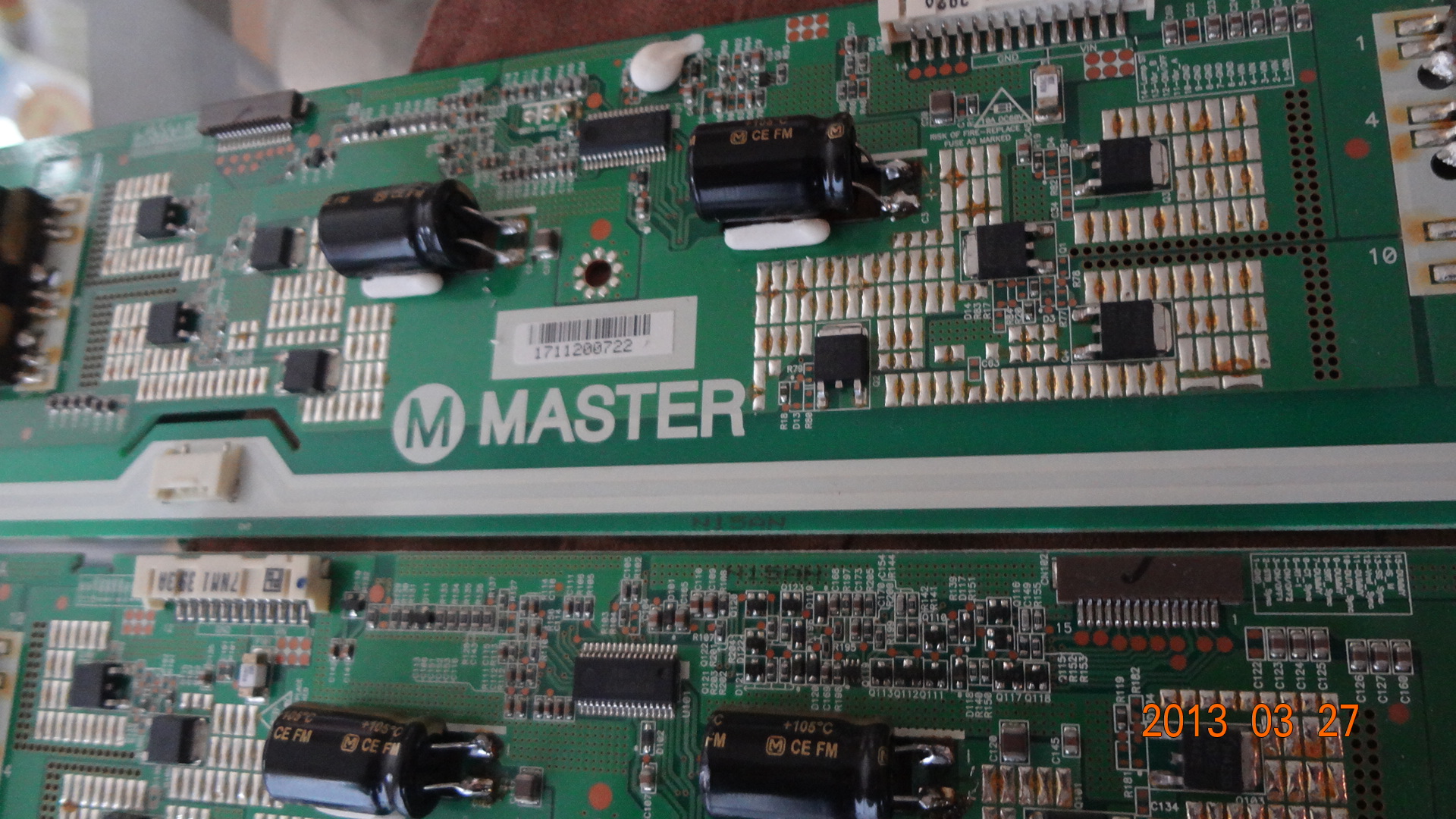

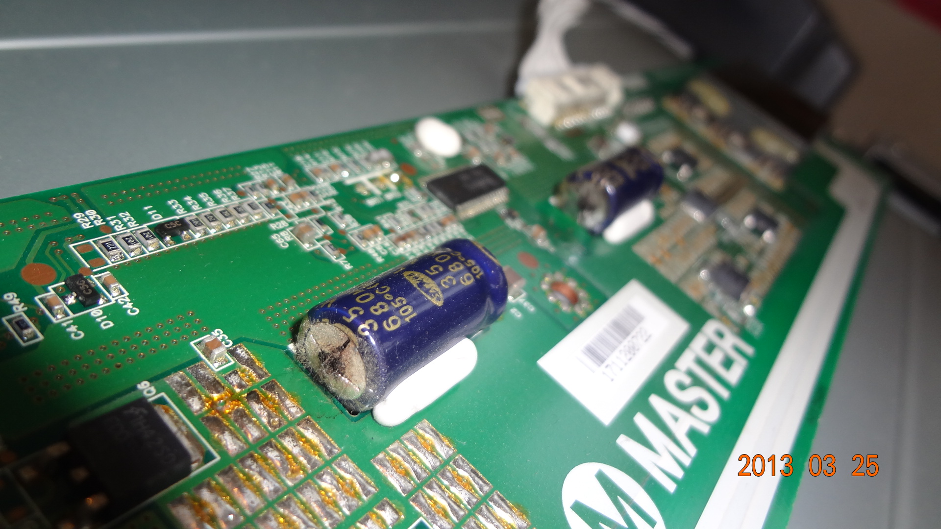

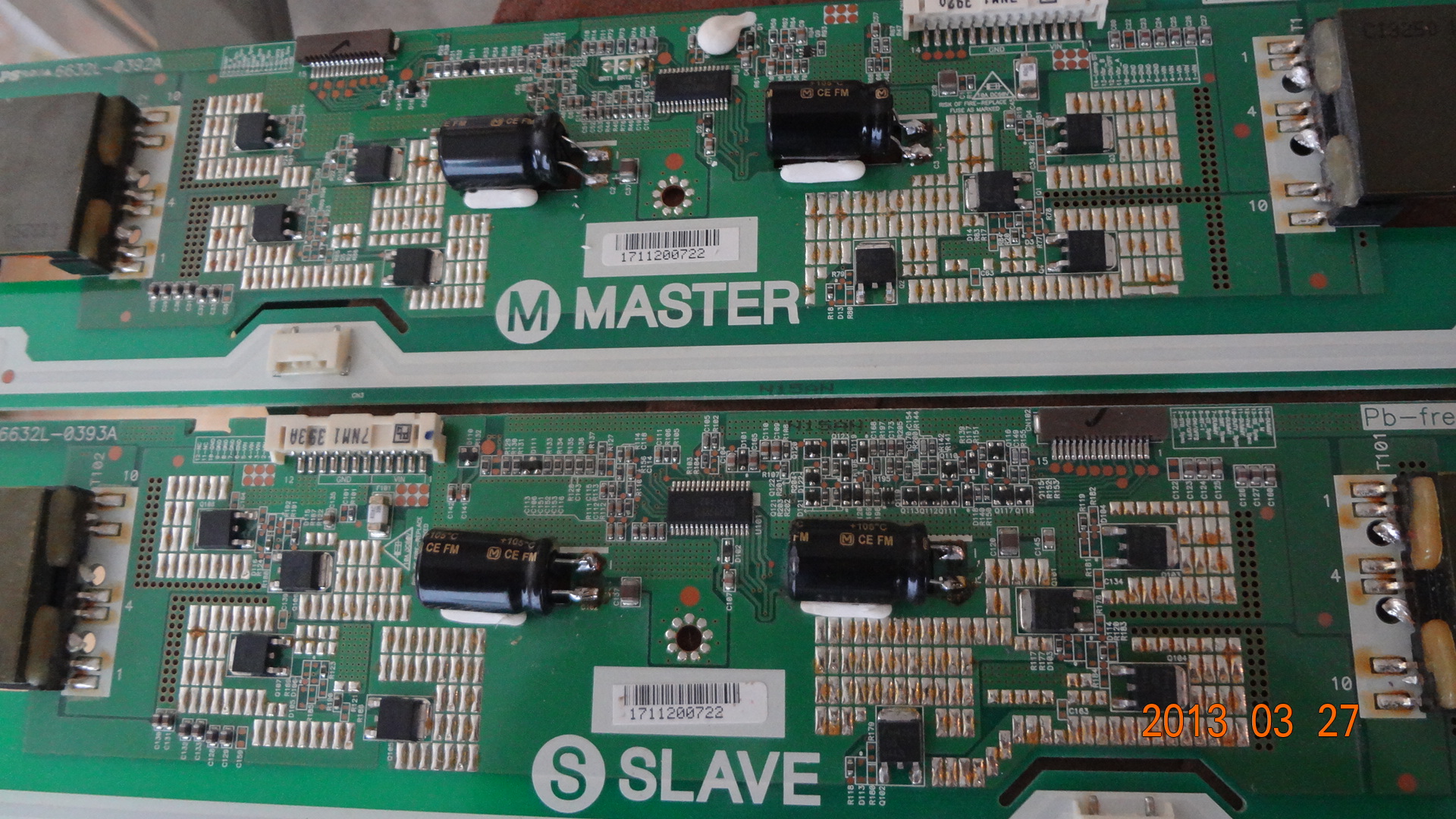

    47 inch vizio cap or replace
    47OFHDTV10a 47 inch Vizio. Screen went out this morning. I have power and front vizio logo goes from amber to white when turned on. The remote still turns it on and off and the I can still hear sound. Pulled back and see that the caps on both backlight converters seems to be leaking. Can I replace these caps or do I need to replace both boards. Also since both seem to be bad does these mean I might have a larger problem with another board? Thank you.

    Re: 47 inch vizio cap or replace
    Id go for replacing the caps on both board - surface soldering so easy stuff.
    Get good quality 105degree caps panasonic FM should be ok.
      I love to try fix things myself. I guess the thing is broken so what would it hurt. Where can I find the caps? Is it something I can find locally (indianapolis) or need to order. Thank you for your response.
        Best to get them from Digikey.
        http://www.digikey.com/product-detai...2417-ND/613778
        Do not buy them from Radioshack, Fry's etc.
          This fuse on the master inverter (red circle in pic) was blown on my set. It wouldn't hurt to check it.
              ay I have a greater admiration for those that know what in the heck they are doing. Update. I ordered the caps and did my best at soldering. Now for some stupid questions.
              1. On surface soldering, Is there a hole for the pins or am I just soldering to the spot on the board?
              2. How do I check the fuse?
              Below is the picture of my soldering techniques. No laughing please.
                Nothing wrong with that soldering. There aren't any holes on the board to solder to. May want to use flux cleaner but that's not critical.
                The fuse - check the resistance across it.
                    I have replaced the caps and still no picture. BUT when i tried to test the fuse when TV was on the pictures showed up. So I am guessing it is the fuse. Does anyone have a link to where I can buy the 10 amp surface fuse that the Master has on it. Thanks
                      Should be fine:
                      http://www.digikey.com/product-detai...5CT-ND/2620103

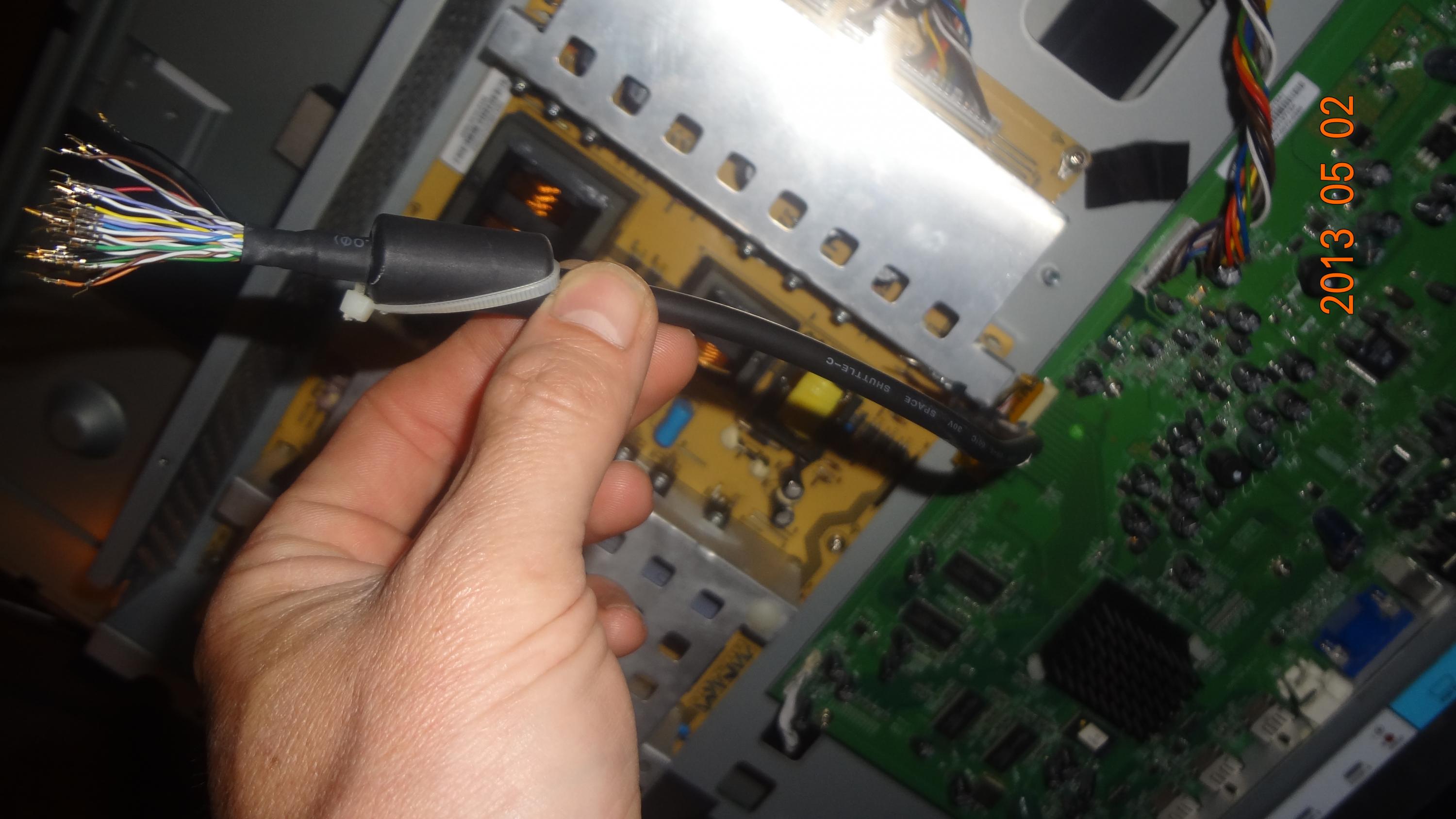

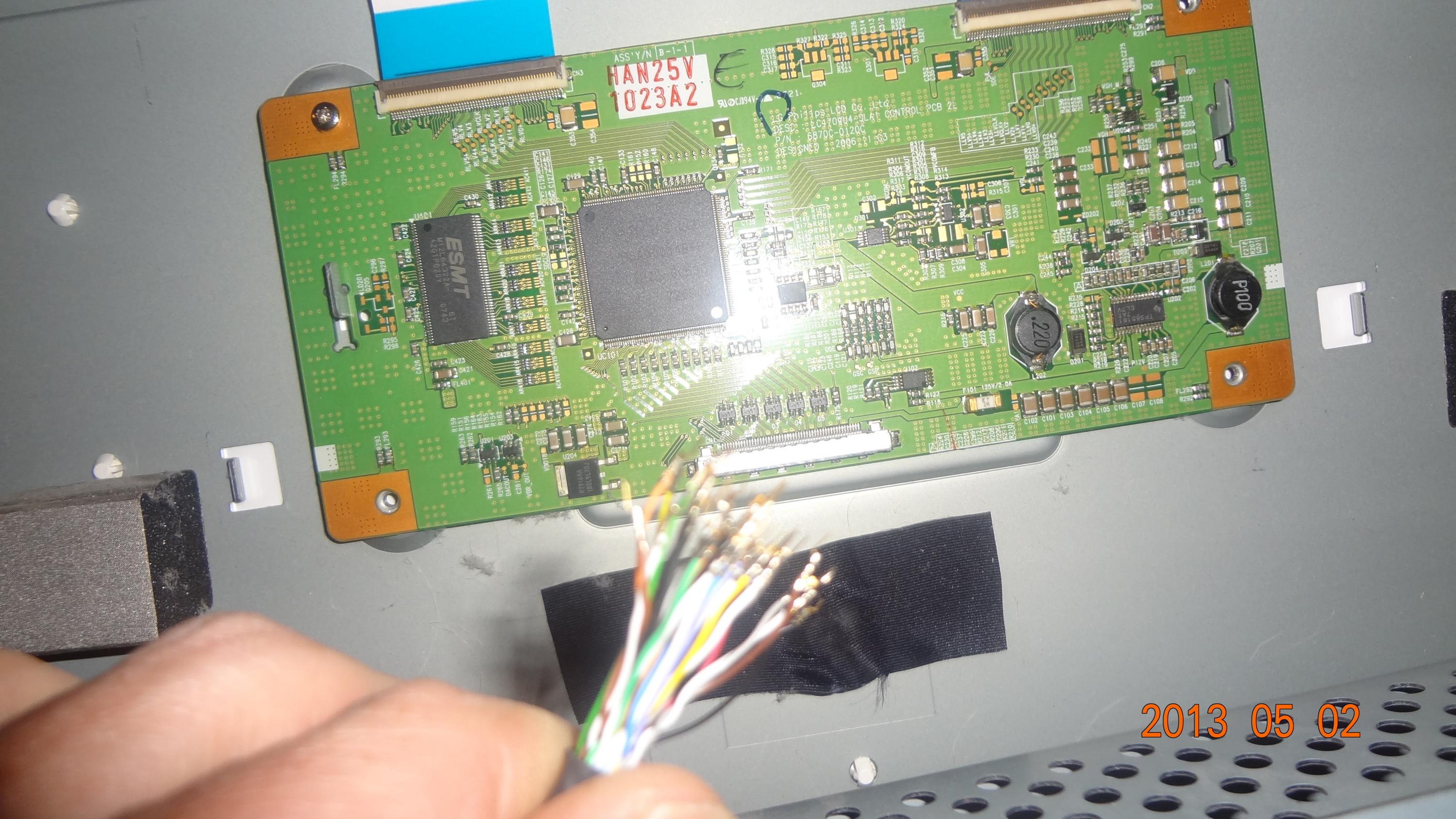

                          I am so heart broken and frustrated. Thanks to all of you I got my tv up and running. Replaced caps and fuse on backlight converter board. Gave thanks and yelled a couple kick a*****. But then when I turned tv upright to put back together the bottom metal rack fell down before I got it screwed in. It pulled the wires out of the connector to what I think is the power supply. I could push wires back in but there are a lot and a lot of the same color. Does anyone have a close up picture of where the wires are supposed to be or have any idea where I can just buy a new wire. It would have been nice if Vizio could have used something other than a thin orange clear tape to hold the wires in the clip.

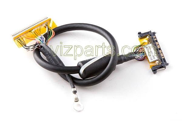

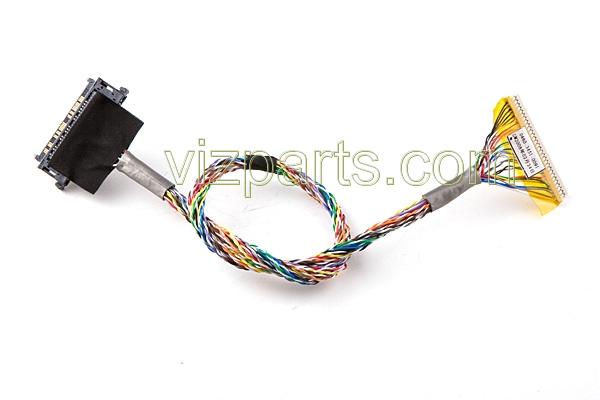

                            Check for a part number on the cable? I don't know VIZIO but best of luck.
                            P/N: 0460-3451-0091 http://www.vizparts.com/product_detail.php?pid=1598
                            ( Model number(s): VW47L FHDTV10A , Serial number(s): LHPBKAH...)
                            P/N: 0460-3430-0950 http://www.vizparts.com/product_detail.php?pid=1587
                            ( Model number(s): GV47L FHDTV20A, VO47L FHDTV10ASerial number(s): LHPBOAH... LHPBOAI... LHPBOAJ... LSPBNAH... LSPBNAJ... LJPBNAJ)
