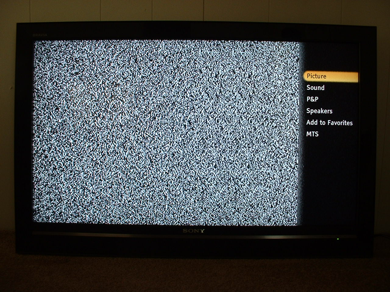

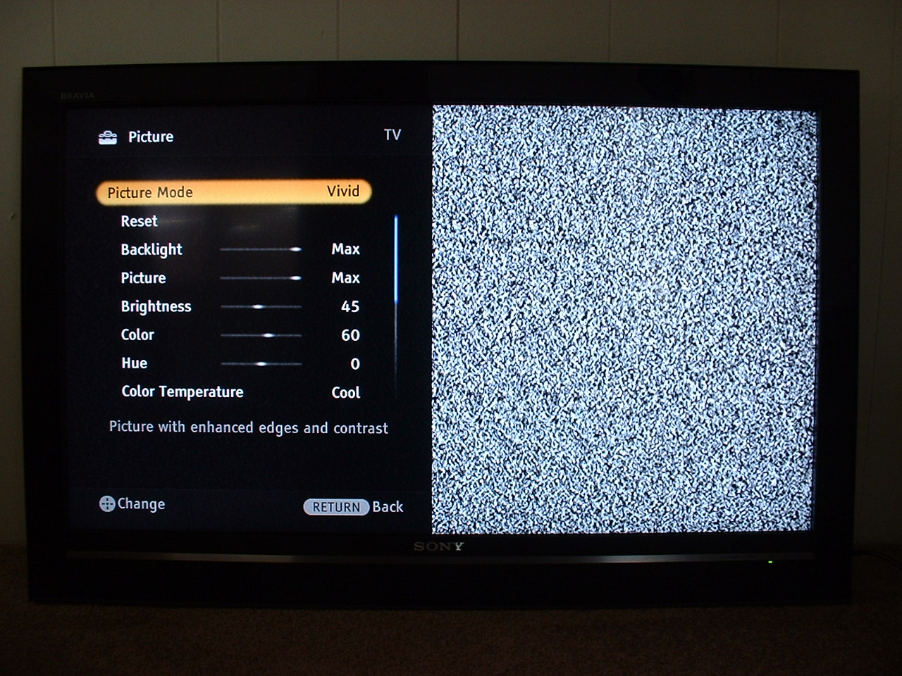

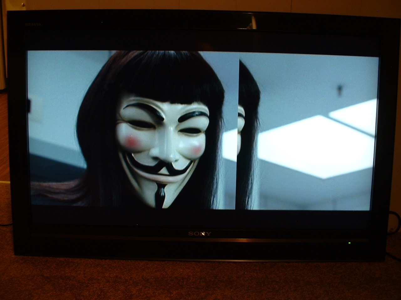

Sony Bravia KDL-40V3000 LCD TV vertical bar problem
    replied
    Re: Sony Bravia KDL-40V3000 LCD TV vertical bar problem
    Yes if there is a UB2 on your TV that may be a frame interpolator or similar can could cause this problem too.
    Leave a comment:
  • 1997eclipsegst
    replied
    Re: Sony Bravia KDL-40V3000 LCD TV vertical bar problem
    I just went and checked to see the flash pattern on a Sony KDL-40V3000 I just repaired and it is one second on and one second off.
    There is also a UB2 board that connects to the bottom of the T-Con. The signal from the main board goes to this before it gets to the T-Con.
    Might be something else to check.
    Leave a comment:
  • Professor Bizzt
    replied
    Re: Sony Bravia KDL-40V3000 LCD TV vertical bar problem
    Originally posted by tom66
    It looks like Sony have split the analog (simple) processing and digital processing into two boards; may have been a cost decision or perhaps easily allowing them to make a European version with SCART.
    My guess would be any problem is on there.
    I would also guess that the board doesn't "know" it is faulty. Error detection logic may not pick up strange faults like this. So the heartbeat may not indicate anything. As a side note, the heartbeat on the products I work on at the company I work at during the summer do two short flashes then a pause once a second, i.e. like a real heartbeat but I doubt Sony would put an obscure easter egg like that into their products.
    Hello Tom66,
    I should have included the heartbeat flash rate in my last post. Measured with a stopwatch, it is On for 1 second and Off for one second, then repeats.
    Just for my own education, why do they call it an FB3 board?
    I'll post the results when I get another FB3 board. Till then I'll hopefully stay quiet.
    Thanks...
    Leave a comment:
    replied
    Re: Sony Bravia KDL-40V3000 LCD TV vertical bar problem
    It looks like Sony have split the analog (simple) processing and digital processing into two boards; may have been a cost decision or perhaps easily allowing them to make a European version with SCART.
    My guess would be any problem is on there.
    I would also guess that the board doesn't "know" it is faulty. Error detection logic may not pick up strange faults like this. So the heartbeat may not indicate anything. As a side note, the heartbeat on the products I work on at the company I work at during the summer do two short flashes then a pause once a second, i.e. like a real heartbeat but I doubt Sony would put an obscure easter egg like that into their products.
    Leave a comment:
  • Professor Bizzt
    replied
    Re: Sony Bravia KDL-40V3000 LCD TV vertical bar problem
    A small update and a few more questions please.
    I removed the metal shield on what I assume is called the "FB3" board. This is the board immediately prior to the T-Con board and has the LVDS cable connected to it. It also has the two HDMI and one RGB PC jacks, but no other video connections. I have included a picture in this post.
    I removed all the cable connections from the FB3 board and reseated them with no improvement to the condition originally described. I tap-tested this board for bad connections and solder joints. No improvement.
    There is a small surface mount LED on the FB3 board that regularly blinks amber (or orange maybe). I guess this LED is known as a "heartbeat indicator" and indicates normal operation of the FB3 board. I have circled and pointed to it in one of the pictures in this post.
    The questions:
    Is this board known as the FB3 board and is this board the one recommended to be replaced?
    How should a properly functioning LCD TV's FB3 board heartbeat indicator blink?
    There is an analog input board connected to the FB3 board. Is the board you recommend replacing instead of the FB3 board, or should both of these boards be replaced, or just the FB3 board?
    I hope to not bother you guys with questions past this point and thank you very much for your answers so far.
    Leave a comment:
    replied
    Re: Sony Bravia KDL-40V3000 LCD TV vertical bar problem
    OK, then it looks like main or T-con, but I would be suspecting main over T-con for a number of reasons. The main one being that the main board is the only board that might split the picture in such a way for processing reasons.
    I would doubt bad capacitors personally, as with AC line noise (your line filter/shielded cable is going to do nothing for the 100's of km cable outside!); instead, I'd be thinking of a processor problem -- possibly a bad joint.
    Leave a comment:
  • Professor Bizzt
    replied
    Re: Sony Bravia KDL-40V3000 LCD TV vertical bar problem
    Originally posted by tom66
    Are there any menu functions that cross the glitch boundary, e.g. the volume control or channel information?
    The main board is the one which has the video inputs on it, and it connects to the T-con board.
    Does it appear after some time, or go away after some time? I would still class that as intermittent, even if it only happens once.
    Thank you Tom66. I found a few menu function displays that cross the glitch boundary and have attached photos of them. The problem manifests as soon as the set is turned on and never goes away. It always behaves this way and no amount of On/Off cycles or On time makes any difference; it is always there. Twisting the set slightly or tapping on it also makes no difference. The IEC power plug was also wiggled, and there was no difference. I tried filtering the AC power at the receptacle and there was no difference.
    If I can remove the RFI shield from the main logic board, I might consider applying a responsible amount of heat via a distant small heat gun to the caps on the board to see if I can pinpoint possible bad caps and then diagnose down further with an ESR meter on the suspected bad caps. What do you think of that approach?
    Thanks....
    Leave a comment:
    replied
    Re: Sony Bravia KDL-40V3000 LCD TV vertical bar problem
    Are there any menu functions that cross the glitch boundary, e.g. the volume control or channel information?
    The main board is the one which has the video inputs on it, and it connects to the T-con board.
    I have a Sony Bravia KDL-40V3000 LCD TV that is not working properly when first powered up or when running for an hour or more. I am hoping someone will be able to advise what the problem might be and what PCB to change out. I am also hoping hard that the problem is not with the LCD panel itself.
    Does it appear after some time, or go away after some time? I would still class that as intermittent, even if it only happens once.
    Leave a comment:
  • Professor Bizzt
    replied
    Re: Sony Bravia KDL-40V3000 LCD TV vertical bar problem
    Originally posted by tom66
    My suggestion would be a main board issue. It's failing to address the image properly. It's almost certainly not an LCD panel or t-con issue. If it's intermittent, you may be dealing with a bad solder joint on one of the processors -- it may be possible to reflow it but it's suggested that the entire board be replaced.
    Thank you for your response. The problem is constant and not intermittent. I'll probably just try to find a used main board. By "main board", I assume you mean the main logic board that drives the T-Con board. Am I correct?
    Thank you...
    Leave a comment:
  • Professor Bizzt
    replied
    Re: Sony Bravia KDL-40V3000 LCD TV vertical bar problem
    Originally posted by Glitcher
    What about the OSD menu, how does that look when you open it?
    Thank you for your response. Here is what the OSD menu looks like:
    Leave a comment:
    replied
    Re: Sony Bravia KDL-40V3000 LCD TV vertical bar problem
    My suggestion would be a main board issue. It's failing to address the image properly. It's almost certainly not an LCD panel or t-con issue. If it's intermittent, you may be dealing with a bad solder joint on one of the processors -- it may be possible to reflow it but it's suggested that the entire board be replaced.
    Leave a comment:
  • Glitcher
    replied
    Re: Sony Bravia KDL-40V3000 LCD TV vertical bar problem
    What about the OSD menu, how does that look when you open it?
    Leave a comment:
  • Sony Bravia KDL-40V3000 LCD TV vertical bar problem
    Sorry the following is so long.
    I have a Sony Bravia KDL-40V3000 LCD TV that is not working properly when first powered up or when running for an hour or more. I am hoping someone will be able to advise what the problem might be and what PCB to change out. I am also hoping hard that the problem is not with the LCD panel itself.
    As you can see from the pictures, (link is here: http://s1070.photobucket.com/user/Sc...roblems?page=1 ) there is a vertical band or bar effect going on that is a little less than 3.5” wide. This seems to indicate that one of the 10 (there should be 10 along the top as the display is about 34 7/8” wide) driver sections is not operating properly.
    I applied signal through S-video input 1 and component video input 1 and both inputs had the same problem. I did not check the other inputs with signal, but I did cycle through the remaining inputs (with no video signal), and the vertical band was obvious on all inputs. Audio is fine on the inputs I applied video to. Audio was not checked on the other inputs.
    The picture quality within this vertical band seems fine, but seems to be out of time or sync with the rest of the picture and thus produces two images. Not a ghost image as it is generally known, but two distinct, sharp, and clear images to describe it as best as I can. There is also a fine horizontal line at the extreme top right of the display that goes from the right edge of this vertical band to the outer edge of the display, but this is not nearly as annoying as the vertical band, and if I have to live with this, I will.
    I changed out the T-Con board, but there was no difference to the problem and the band location remained at the same position on the display. I also removed the LCD panel peripheral metal bezel to check for TAB (Tape Automated Binding) failures by gently pushing on the TAB associated with this cell (if “cell” is the correct word) while the set was running, but that made no difference to the display. I also gently pushed on the remaining TABs, and that made no difference either.
    The two ribbon cables from the T-Con board output were inspected and were found to be seated properly with no signs of overheating or other issues. The T-Con's LVDS input cable was also inspected and found to be seated correctly. I tap-tested all the boards and cables to check for bad solder joints and sub-standard cable connections, but that made no difference as well. Finally, I performed a power reset by turning on the set, holding down the remote's up arrow button, and then momentarily pressing the power button on the TV. That did not help either.
    It seems to me that because the picture within this approximately 3.5” wide vertical band region is fine, that there should not be a problem with the LCD panel itself, but some sort of timing issue with the drive to this cell. Maybe bad capacitors in the driver???
    Please inform me if my post here would be better served on another thread instead of this one.
    Thank you and I hope to get this resolved as painlessly as possible....
    Last edited by Professor Bizzt; 03-20-2013, 08:55 PM.
  • PopsCaps
    Sony Bravia KDL-40V2500 that will not power on
    by PopsCaps
    I have a Sony Bravia KDL-40V2500 that will not power on. The indicator flashes red 3 times.
    I do not hear any sound and I cannot see any backlight.
    I have tried disconnecting every cable on each board one at a time to see if anything changes.
    The only change is when I disconnect AC-DET cable on the Power Supply board or on the other end if I unplug the CN7009 connection on the B-Board and try to power on the TV the indicator will stay on solid green until I power off.
    My friend ordered another used power supply board but it is also doing the red indicator flash 3 times...
    03-25-2025, 11:23 AM
  • gpo23
    Sony KDL-40V3000 - Vertical lines
    by gpo23
    i order a t-con because i had bad colors on my SONY KDL-40V3000 :
    With the new t-con the color are good but there are vertical lines on all the screen :
    I've tried the old t-con and it returned to the initial issue (bad colors but no vertical lines)
    Is there a way to fix the vertical lines on the new t-con ?
    Thank you for your help
    gpo23...
    10-04-2023, 09:11 AM
  • justin35
    Sony bravia kdl-43w755c - boot loop
    by justin35
    i have this sony bravia kdl-43w755c which boot loops. After sony logo, it shows the android animation loading then it restarts…
    from what i read online it looks to be an emmc issue…
    i’m not familiar with this kind of tv repairs… i’m repairing laptops and gpu’s…
    i took out the board and say an samsung 16gb emmc
    i don’t have an exact replacement, but i have a few 32 and 64gb emms’s from laptops…
    i could try to put one instead of the 16gb one, but will it work?
    where do i get the software from?
    any help will be much appreciated!...
    03-06-2024, 12:26 PM
    Sony Bravia 22" LED Full HD TV KLV-22P402B Schematic
    Sony Bravia 22" LED Full HD TV KLV-22P402B Schematic...
    10-16-2024, 05:15 AM
  • motorahead
    Sony Trinitron (KV-20FV12) Vertical Deflection Stopped
    by motorahead
    Hi everyone, I've been troubleshooting my 20" Sony Trinitron (KV-20FV12) CRT after it failed to show a picture. The standby LED is blinking 4 times, which according to the service manual is a failed vertical deflection via the self-diagnostic check during power up.
    After getting the TV checked out by a technician and doing research on my own. The most obvious first step was to replace the IC502. I've done so with an exact NOS replacement with no luck. I've read a few suggestions to make sure the 12V supply to pin 2, but that voltage check would seem misleading? It seems if the...
    10-21-2023, 03:50 PM
