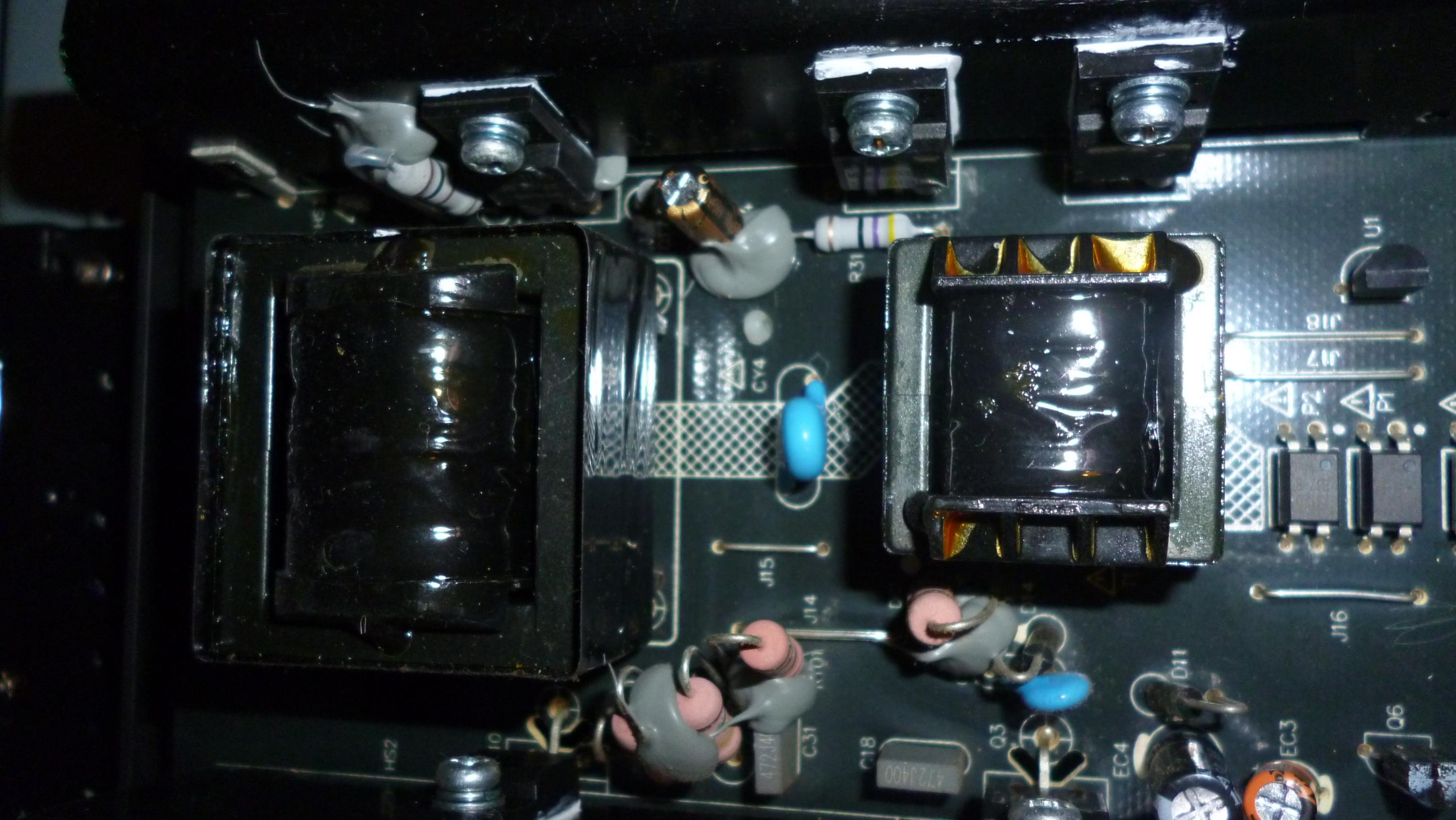

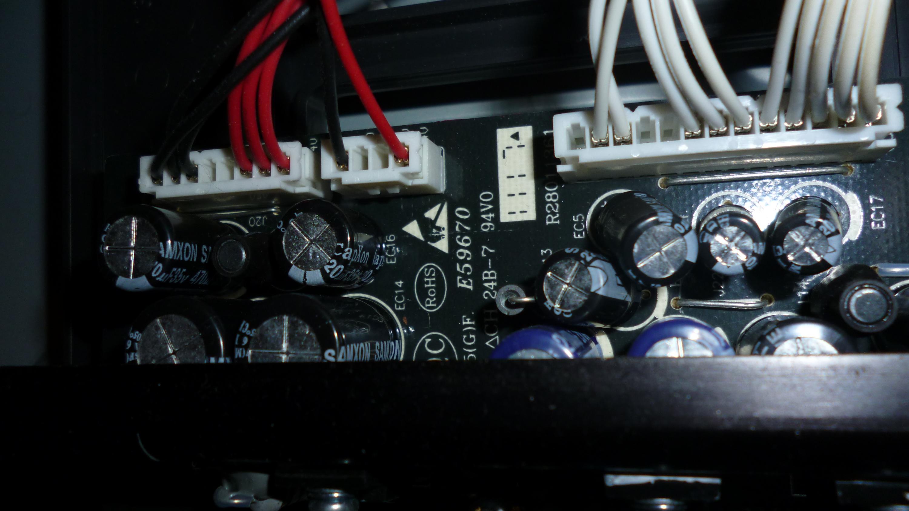

    Re: Baird JO37BAIRD(A) No Power
    heres a couple of pictures if it helps, get no red standby light or anything just completly dead, there is a power switch on the back switched on and off, changed power lead to make sure its not something daft like a blown fuse or anything... ideas please
      Check the voltage across the capacitor in this picture marked with the green "ROHS 2002/95/EC" sticker, top right.

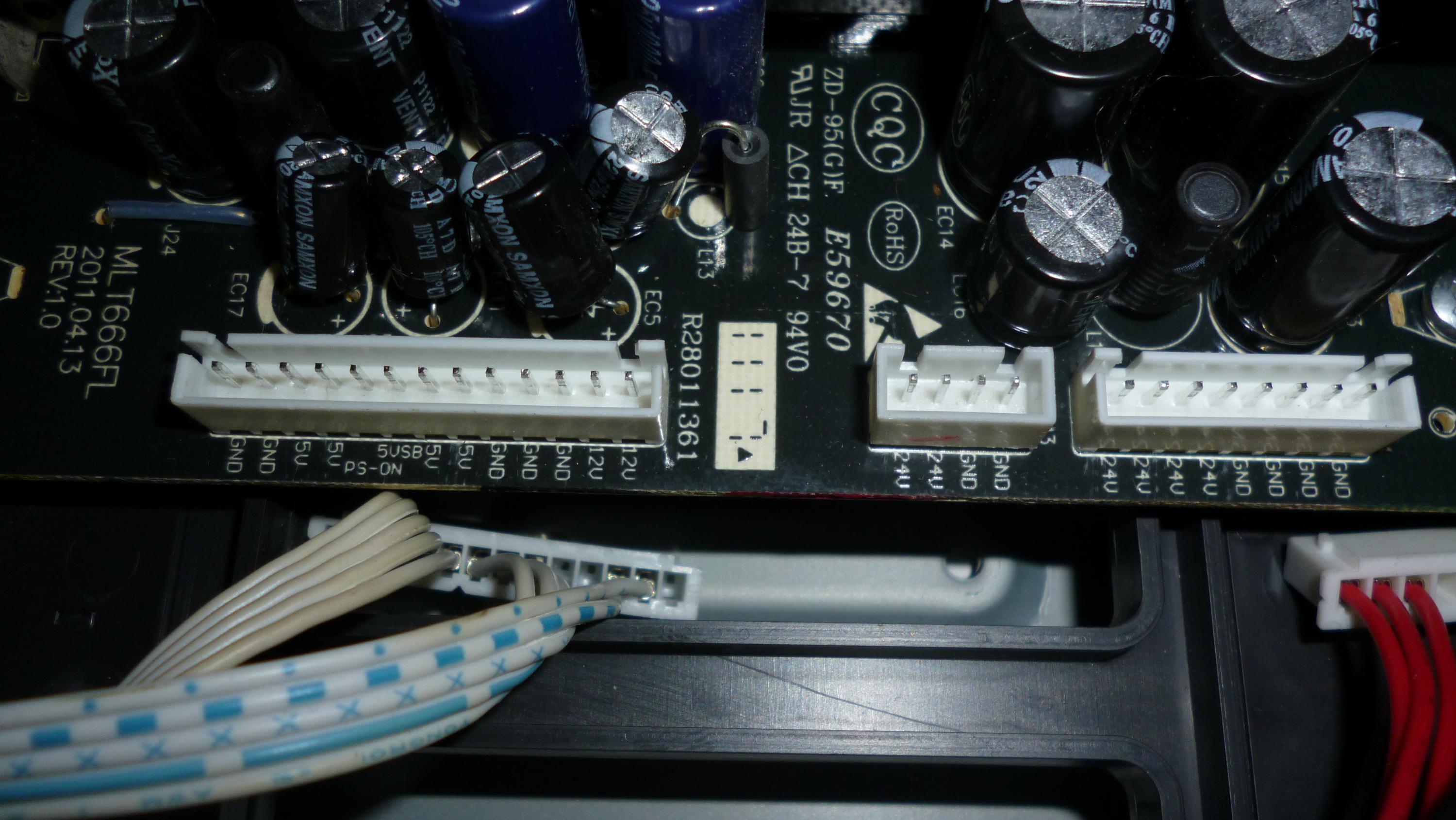

                    That's about right. So, check all the voltages along these connectors:
                    https://www.badcaps.net/forum/attach...4&d=1363021788
                    along with the voltage label written next to it.
                      in pic 4 the white plugs does it say any voltage readings by them?
                      black multimeter lead to a mounting screw by the white plugs then push red lead down the side of each wire in the white plugs then take readings.
                        sorry Tom66 how would i go about doing that ? and Vinceroger 69 i attached a picture for you, if you need the voltages written let me know
                          Black probe on frame, red probe on each successive pin, meter on 200VDC. Record and post each measurement next to how it is labelled.
                            ok i put the black probe on the metal chassis and the red probe on each pin but there all reporting back 0V, got multimeter set to 200v DC
                              only 1 pin is reporting back 1.7V
                                    Which pin is @1.7V? Label?
                                      circled the pin mate, thanks
                                        Are you sure it is not 5VSB?
