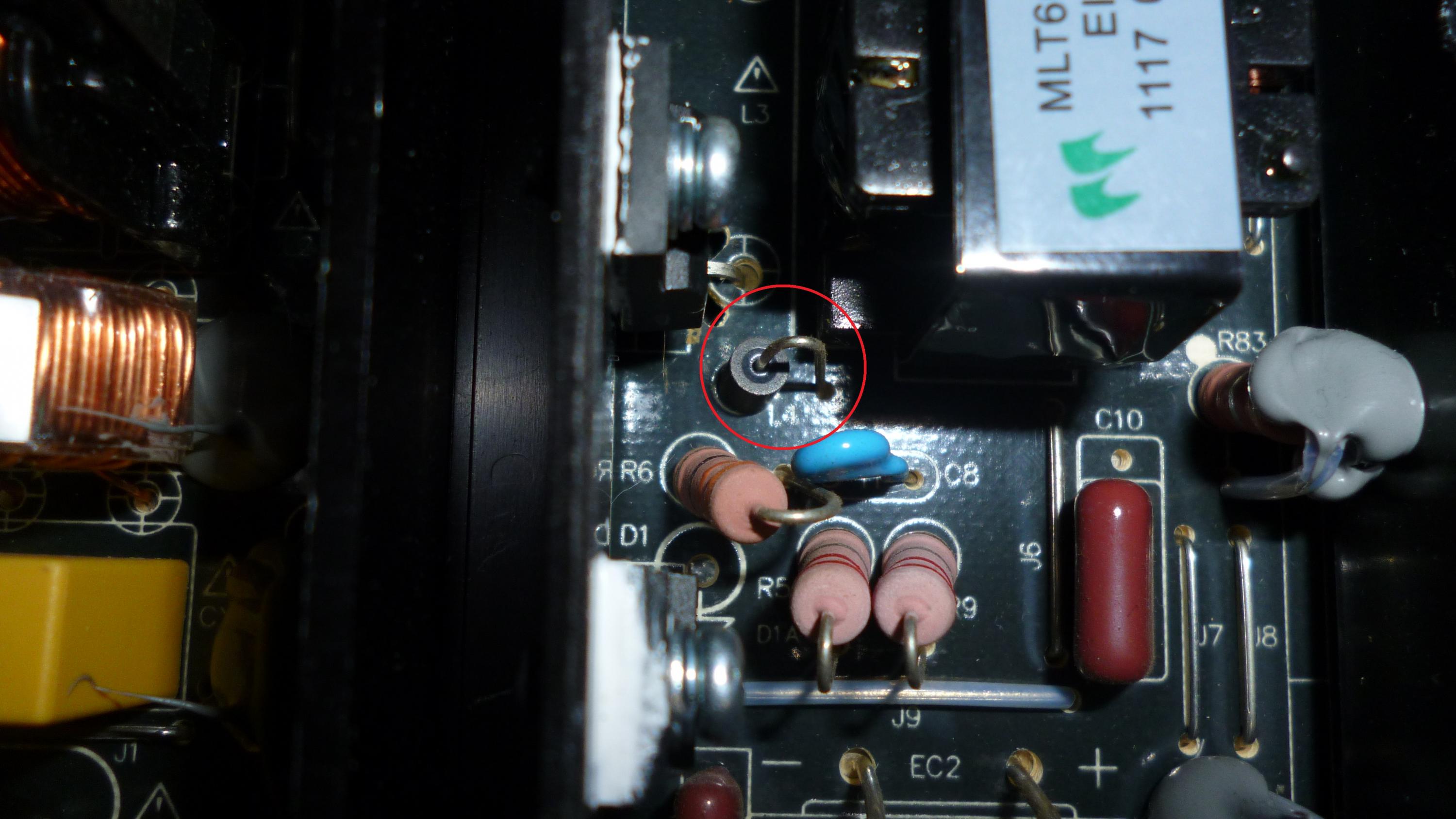

    Originally posted by Mikeyboy2007 View Post
    circled the pin mate, thanks
    sorry its actualy the one to the right hand side of the one circled

                                          Re: Baird JO37BAIRD(A) No Power
                                          ok readings from them are 281, 568, 567, 631, 590, one was reporting back 0 no matter which way i put the probes. had to do it from the underneath of the board as i couldnt get into any of them on top.. have a picture to show which one was reporting back as 0 both ways
