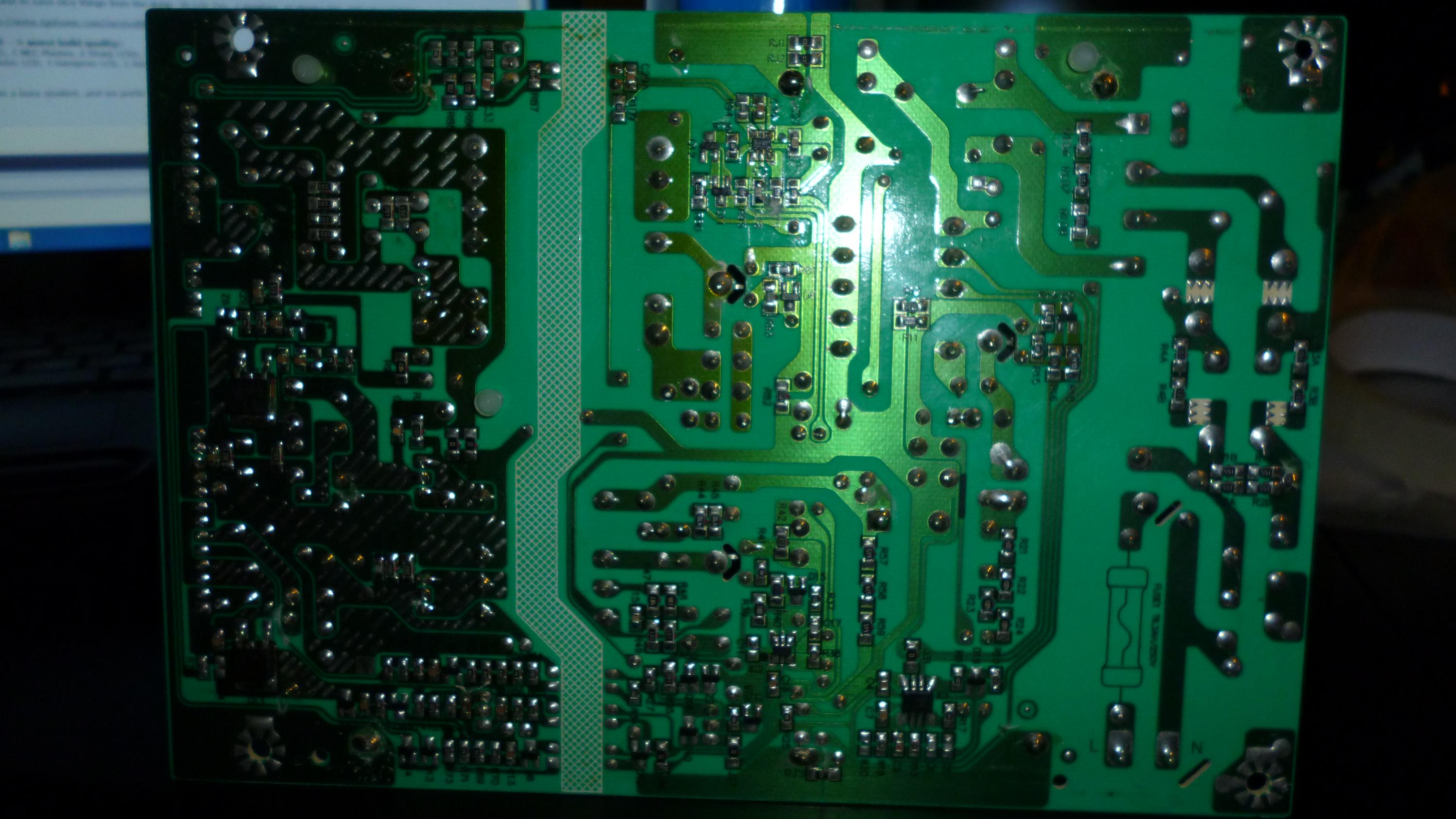

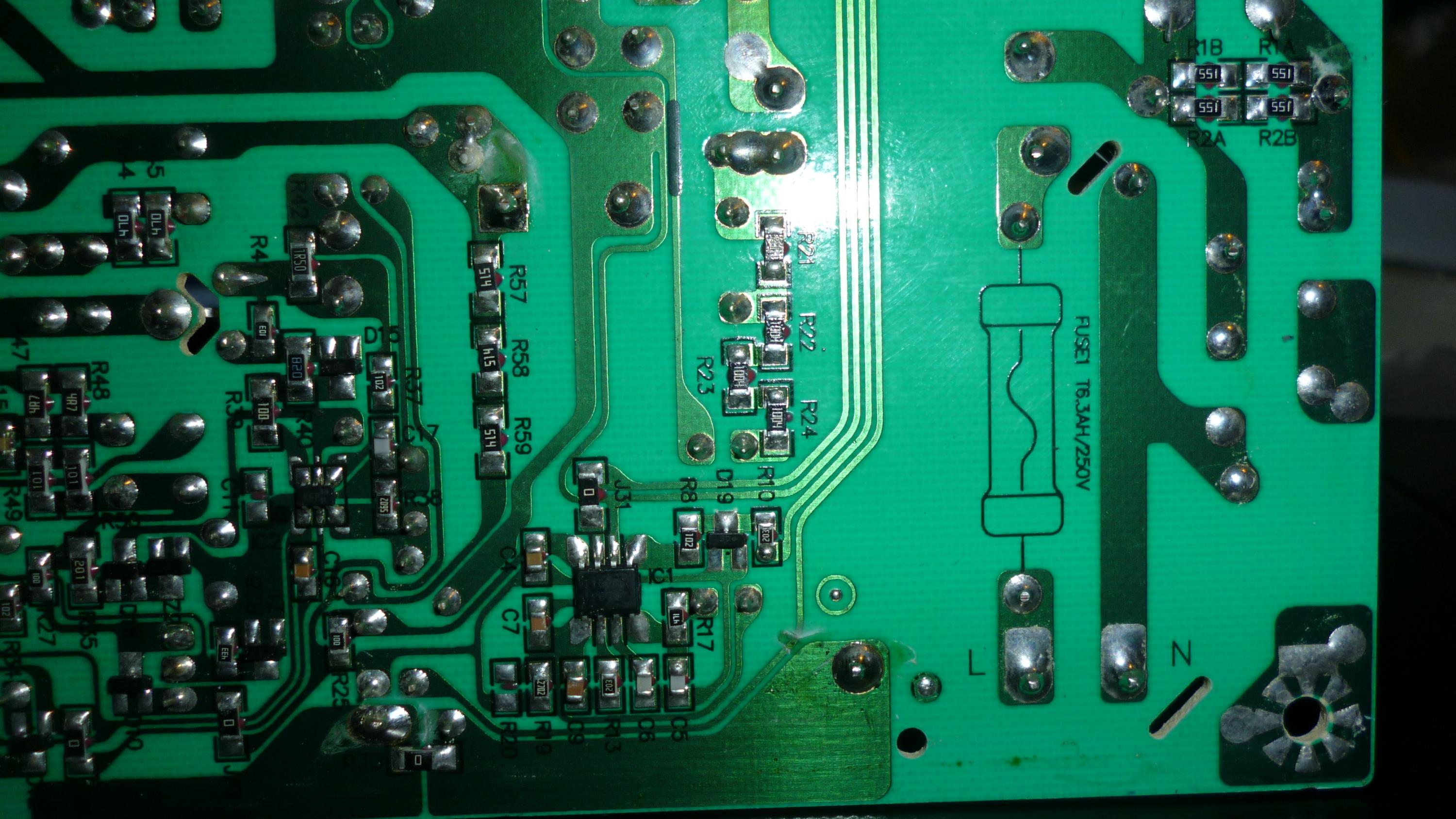

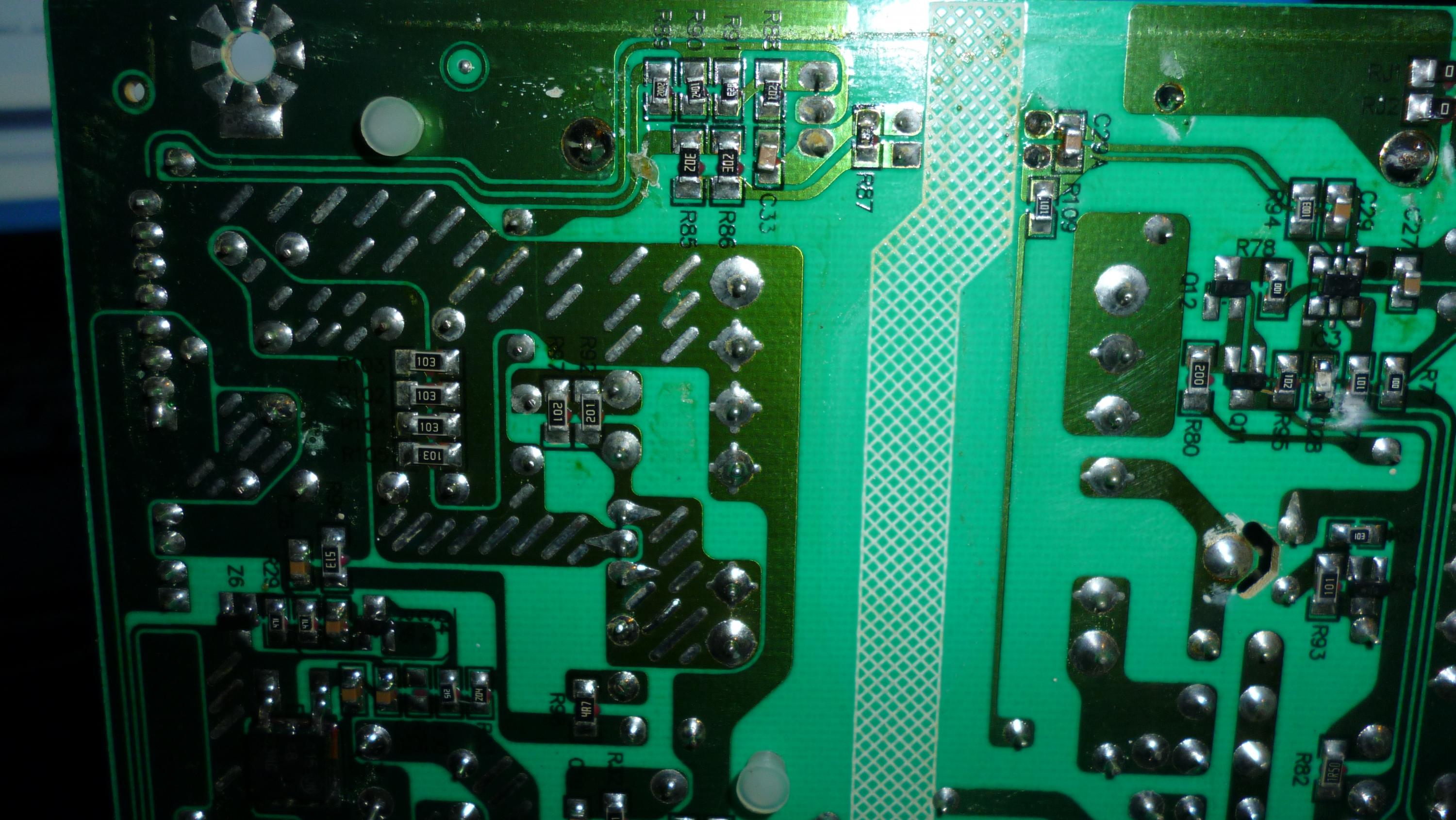

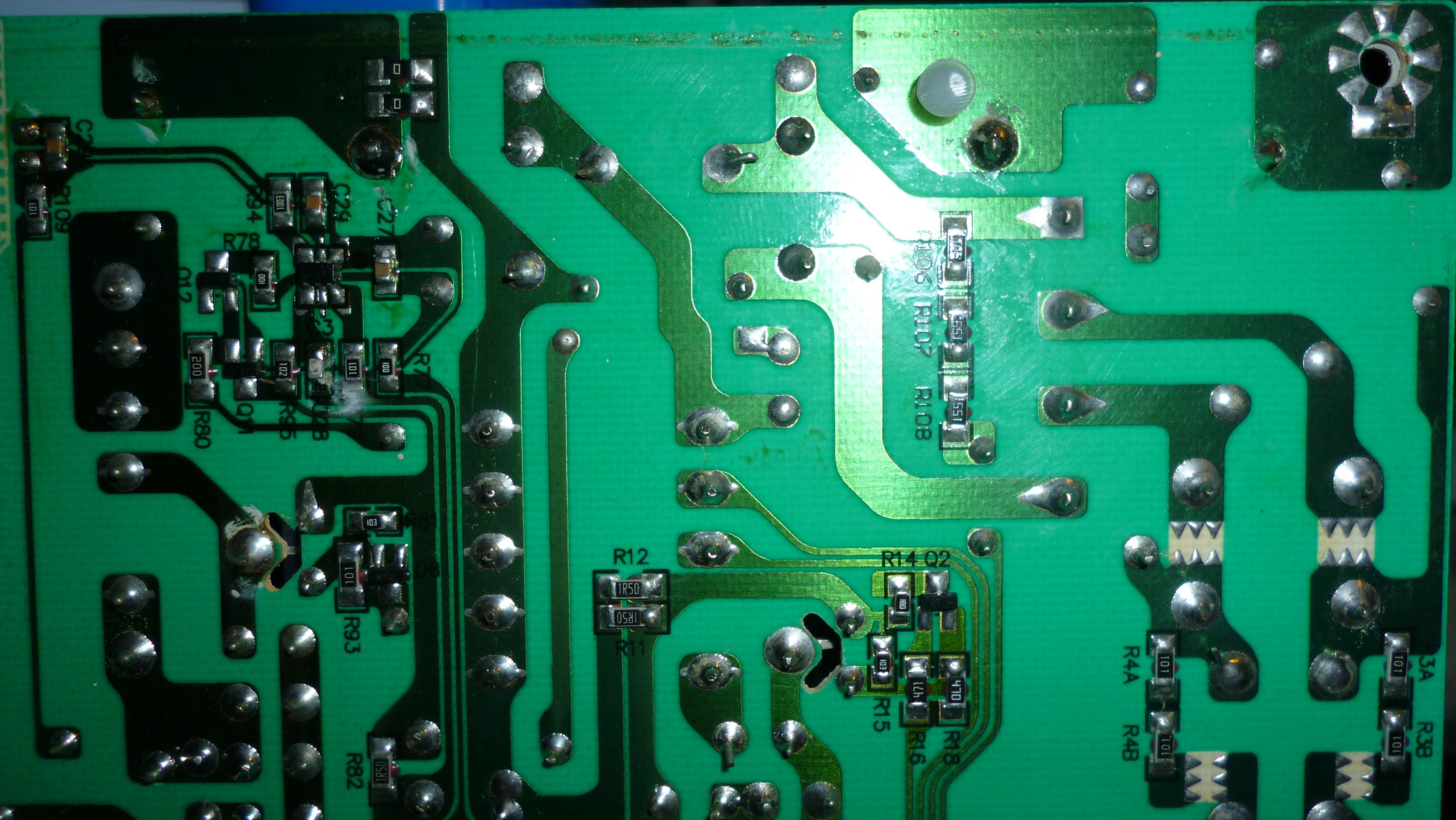

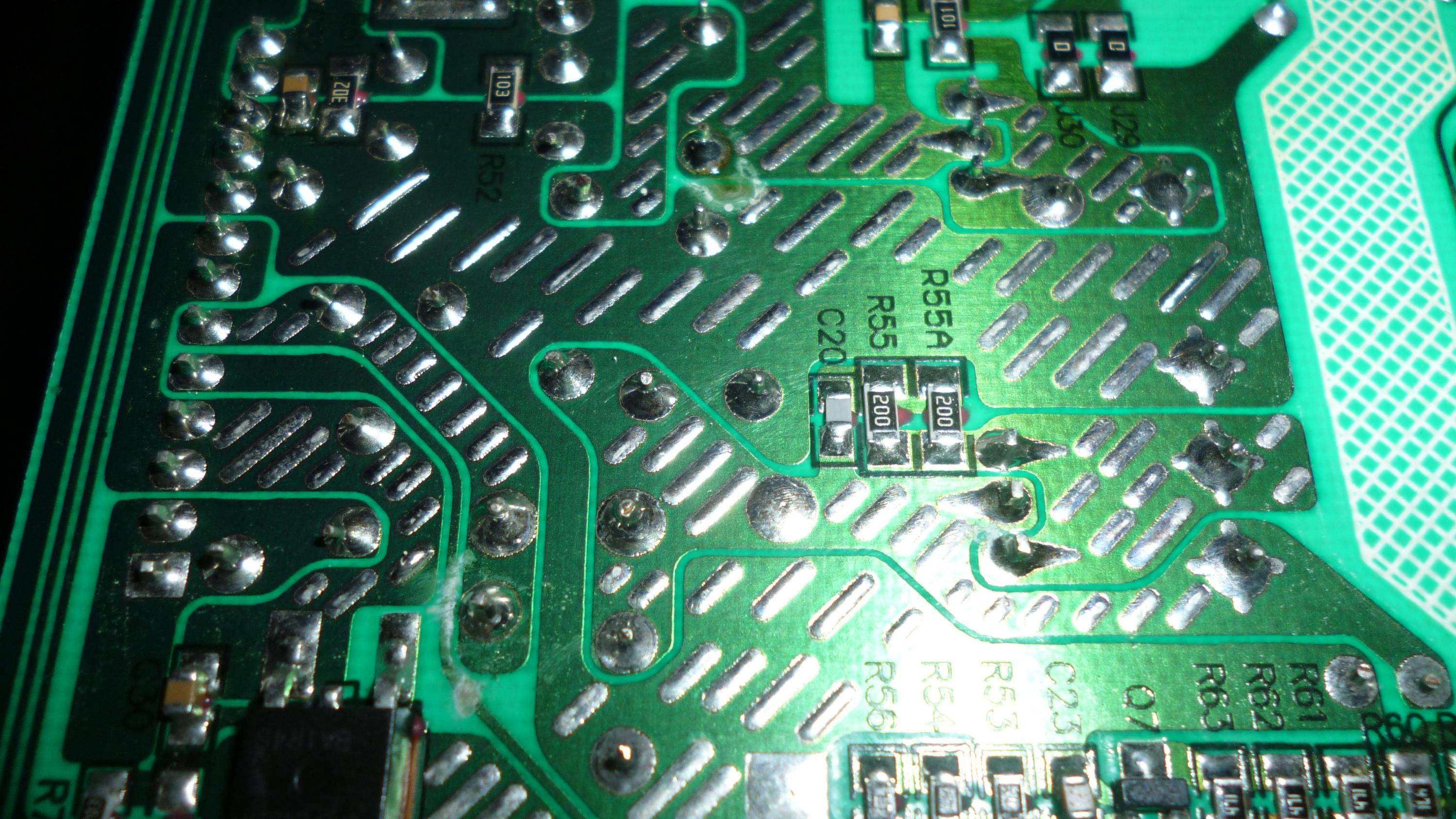

    L4 isn't a diode, unfortunately. Can we see pictures of the underside of PSU (green side)
      #42
      Re: Baird JO37BAIRD(A) No Power
      hope these pictures help
        #43

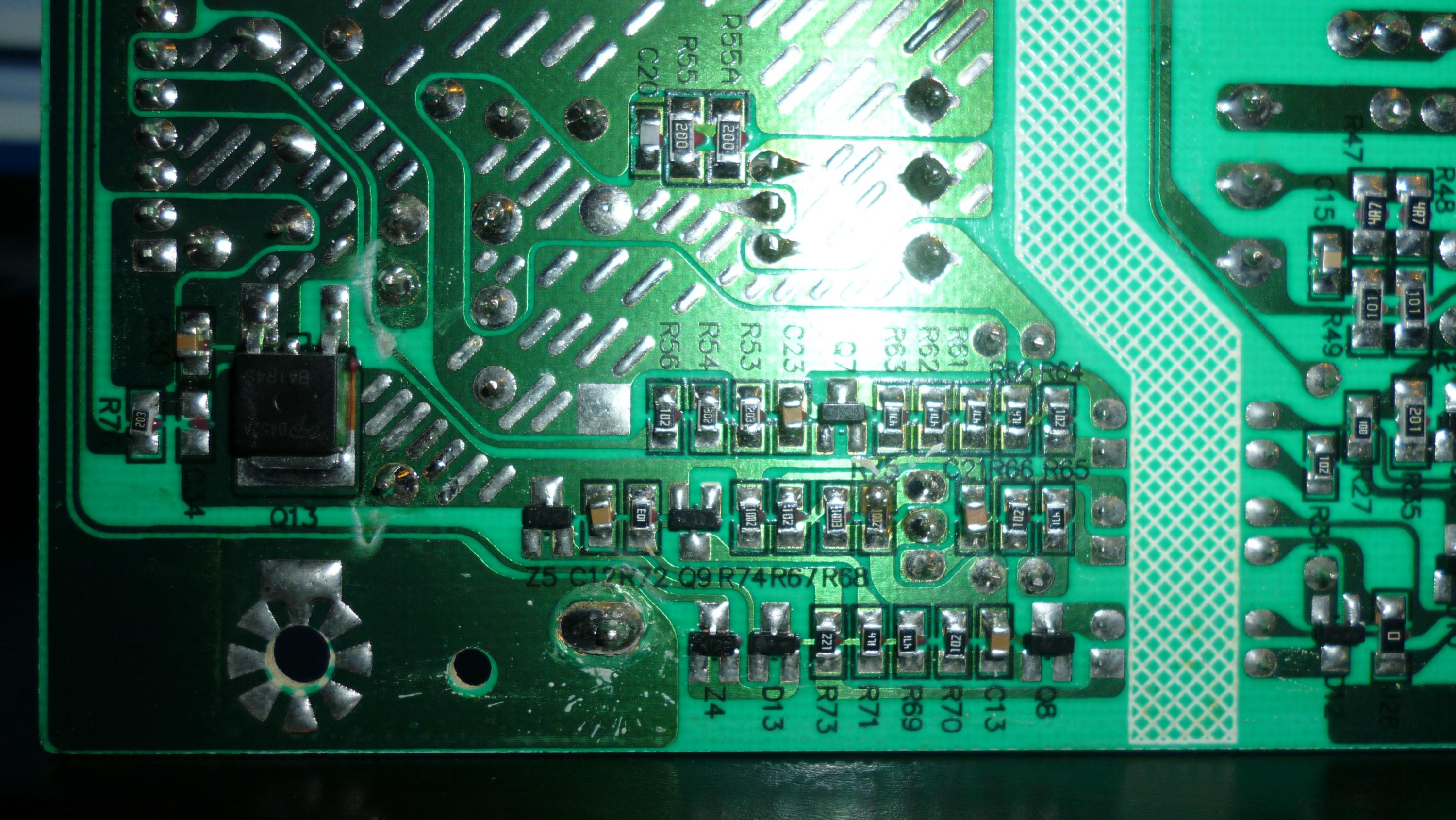

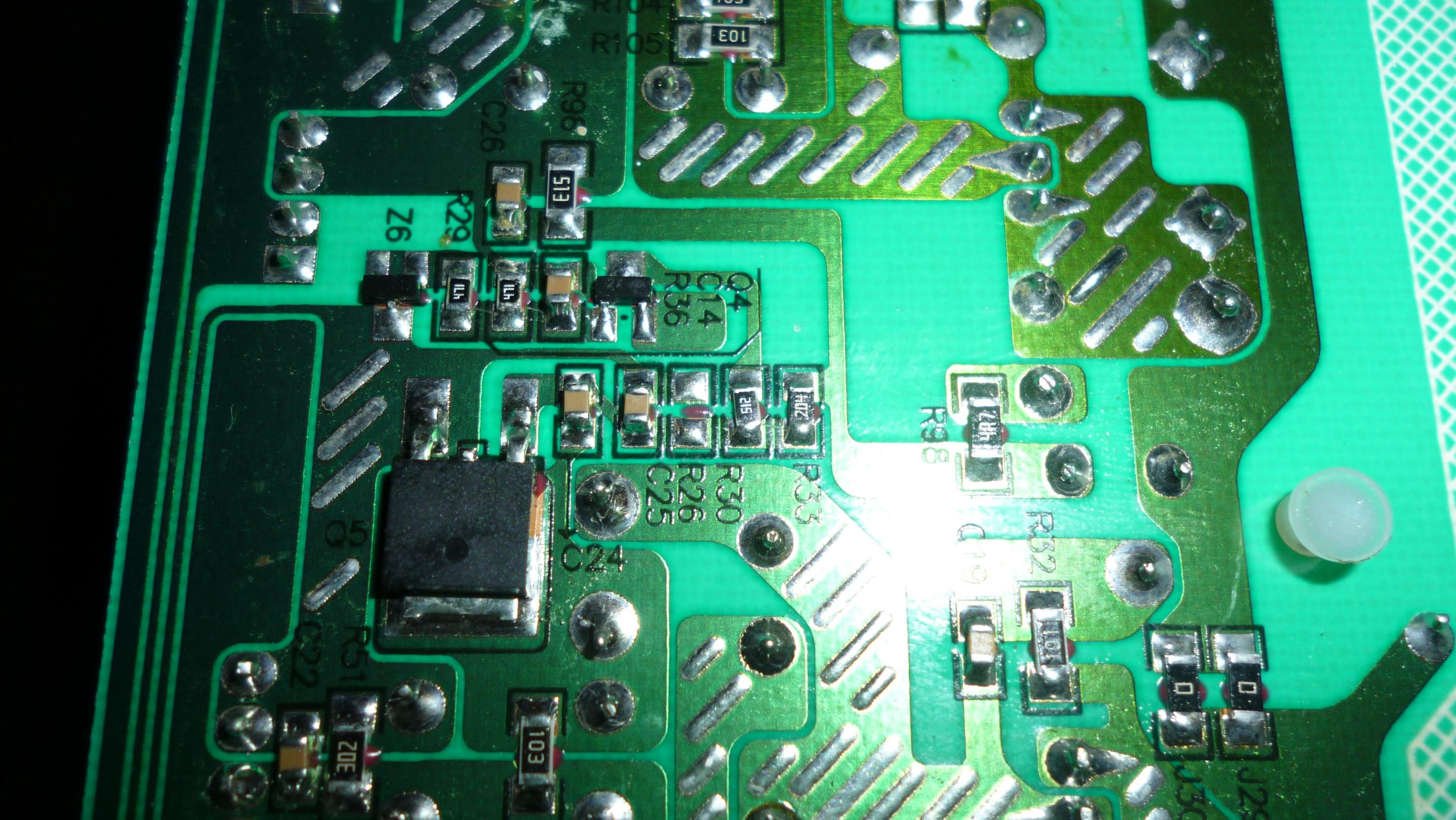

        Can you read the part #s off these ICs?
          #44
          just aswell ive got magnifier lol 1st circled is KFP then has something very very small beside those enitials then second is 16068 PBUS OR FBUS cant realy make it out
            #45
            Can't find data on either of those. Are you sure of those markings?
              #46
              1st one could possible be VFP ?
              nope deffo starts KFP
                #47
                1606B PBUS and and the KFP one is too small to make out whats beside those enitials
                  #48

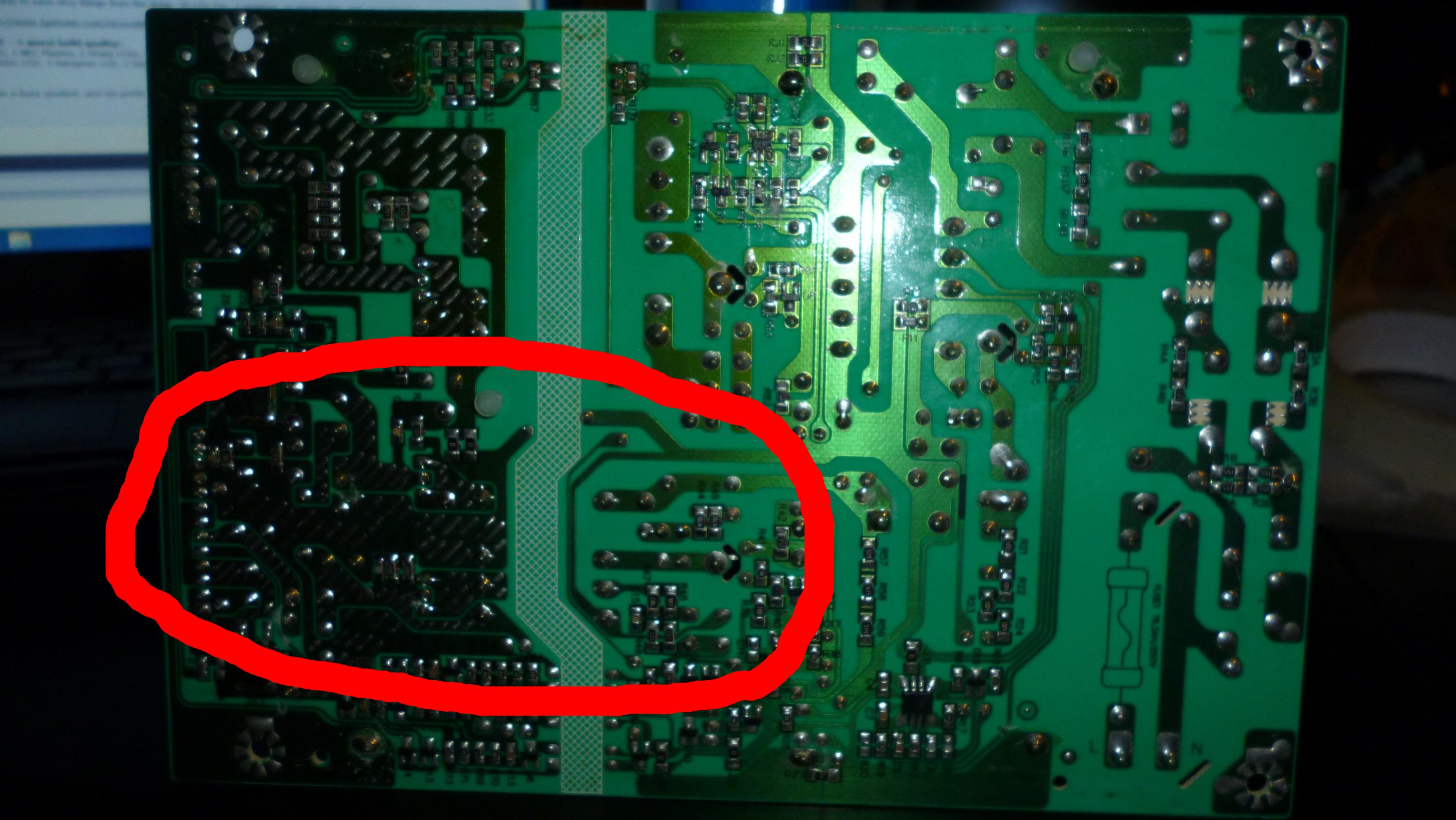

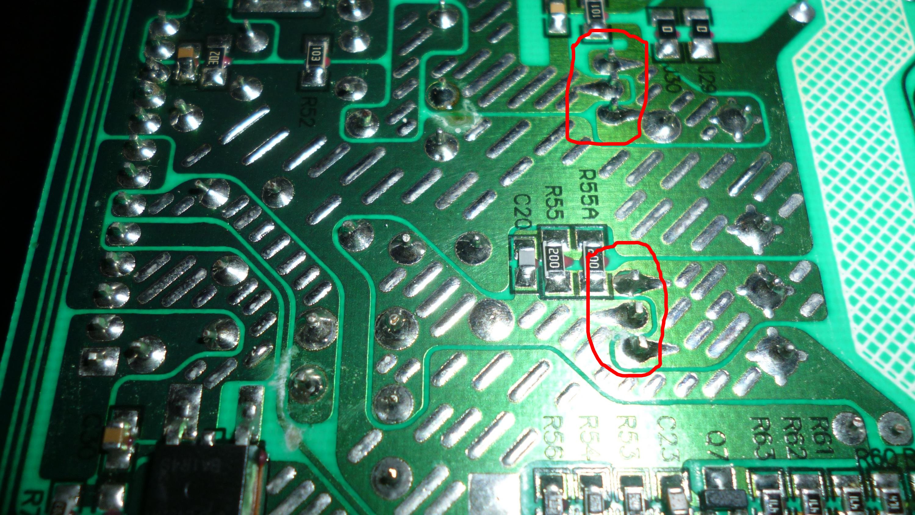

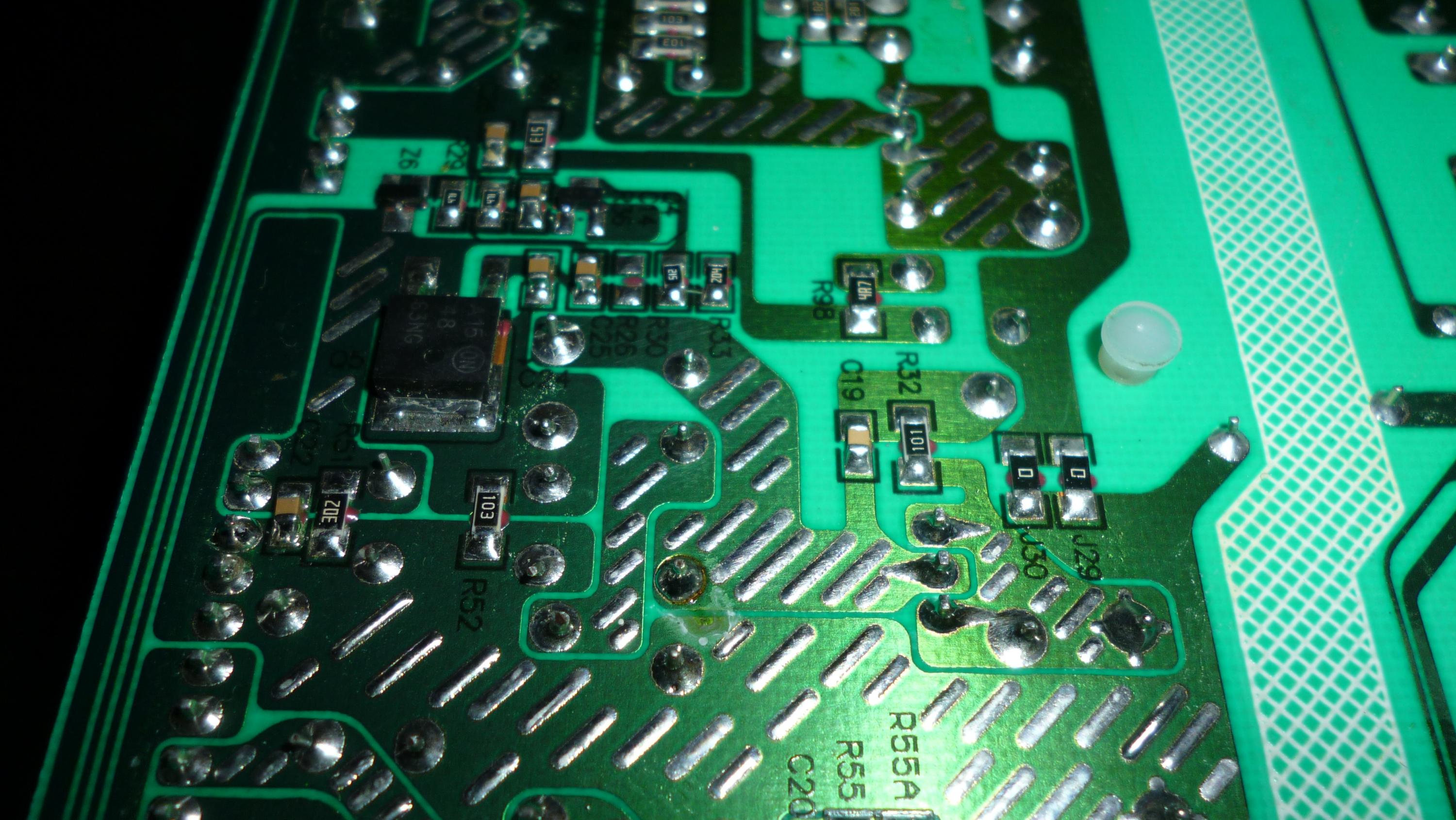

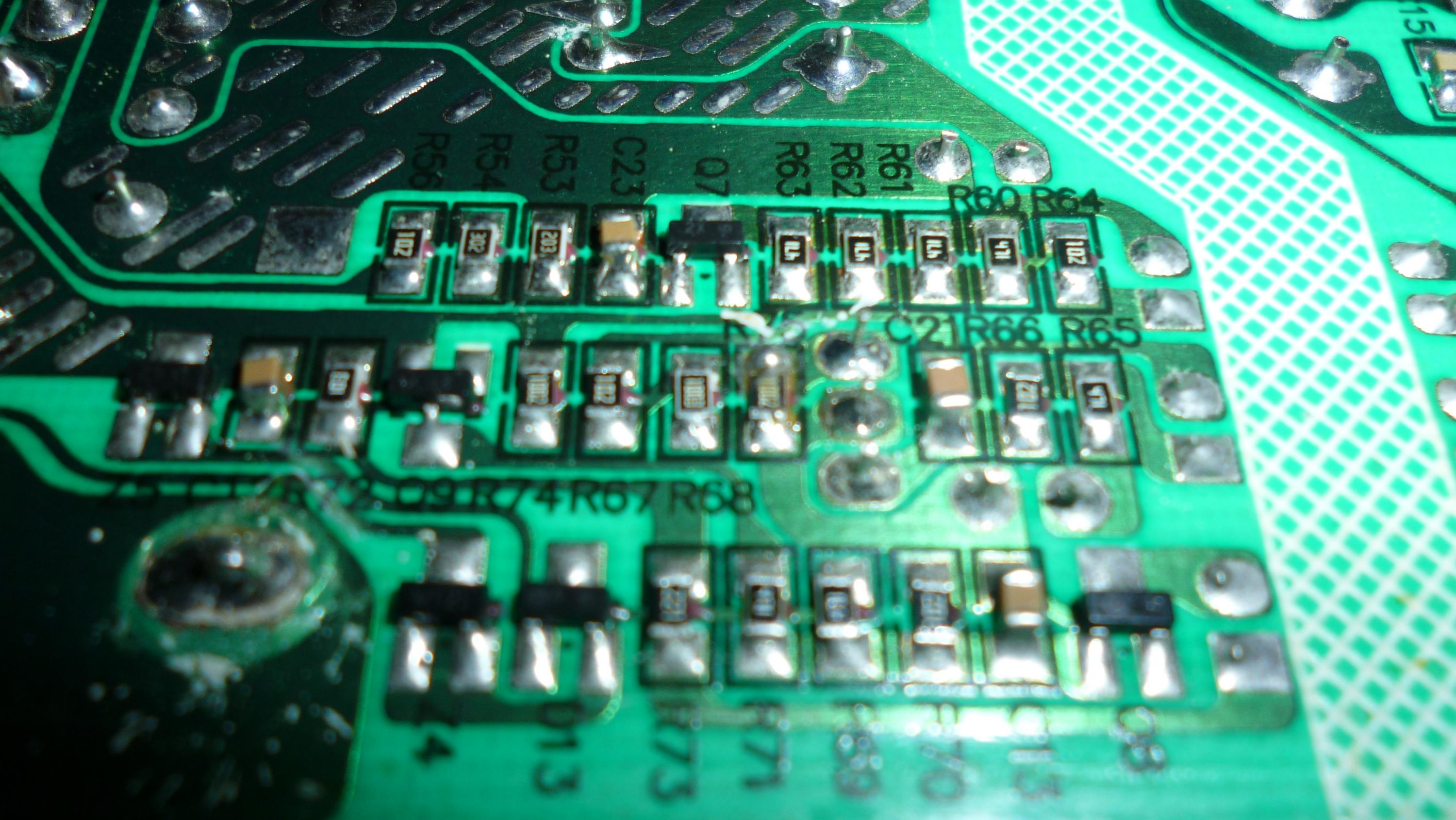

                  One is probably http://www.onsemi.com/PowerSolutions....do?id=NCP1606.
                  The other we will have to reverse engineer.

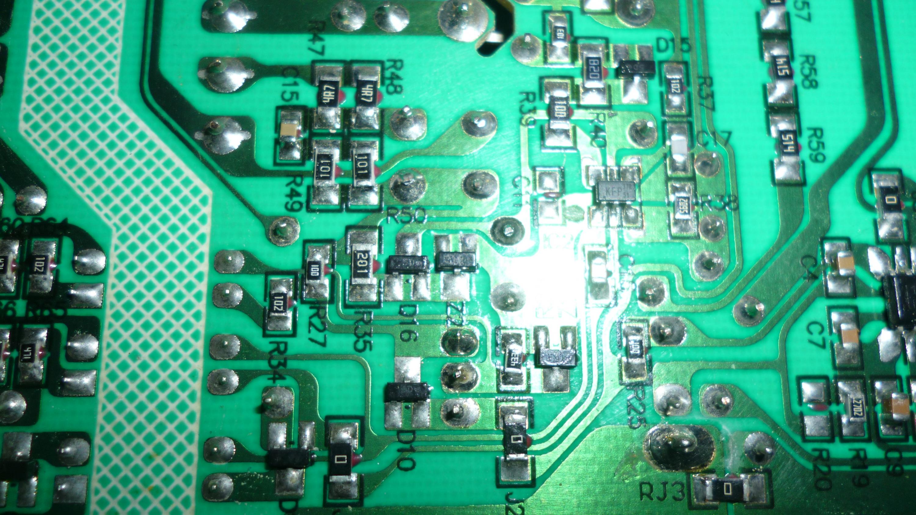

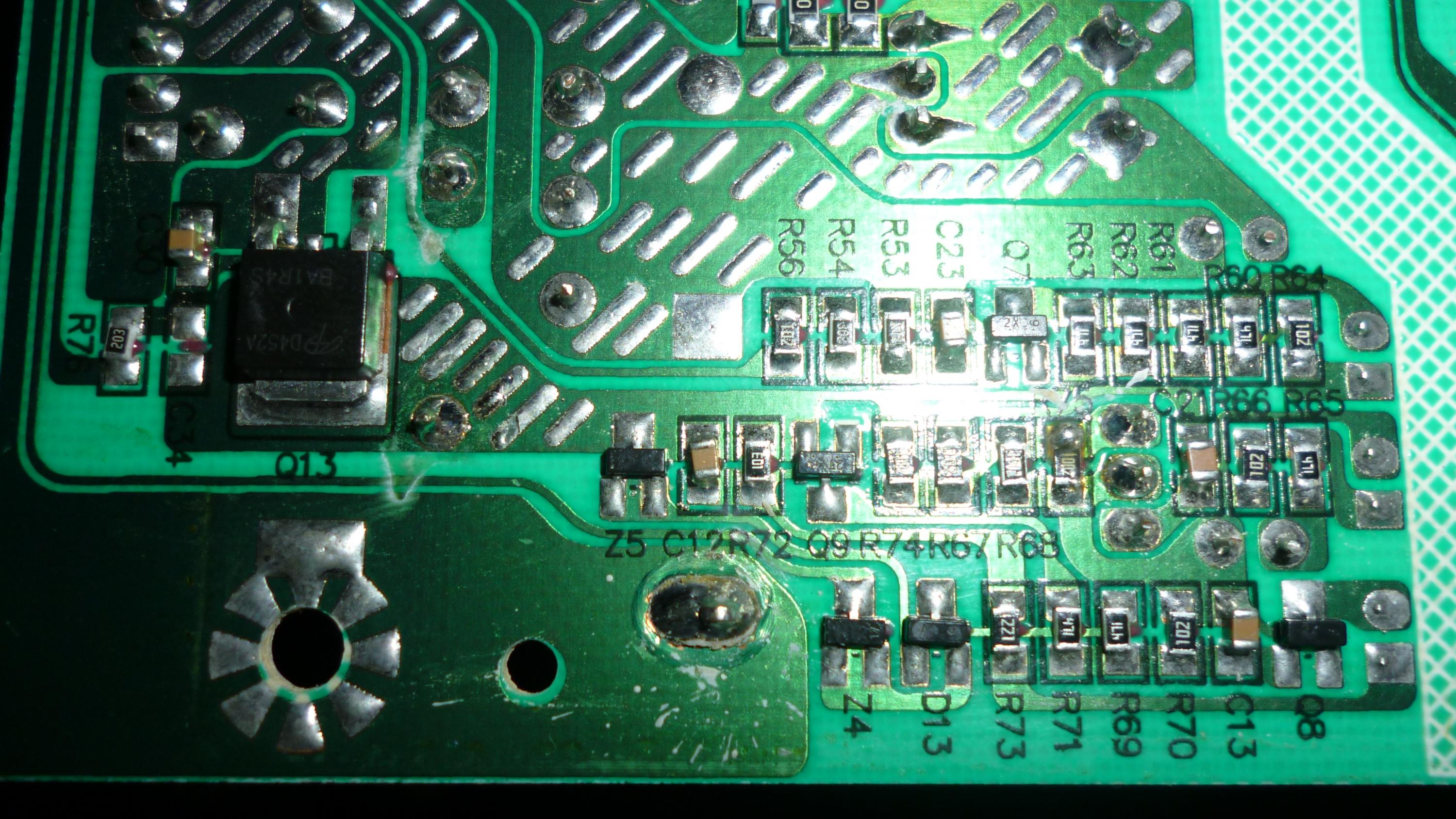

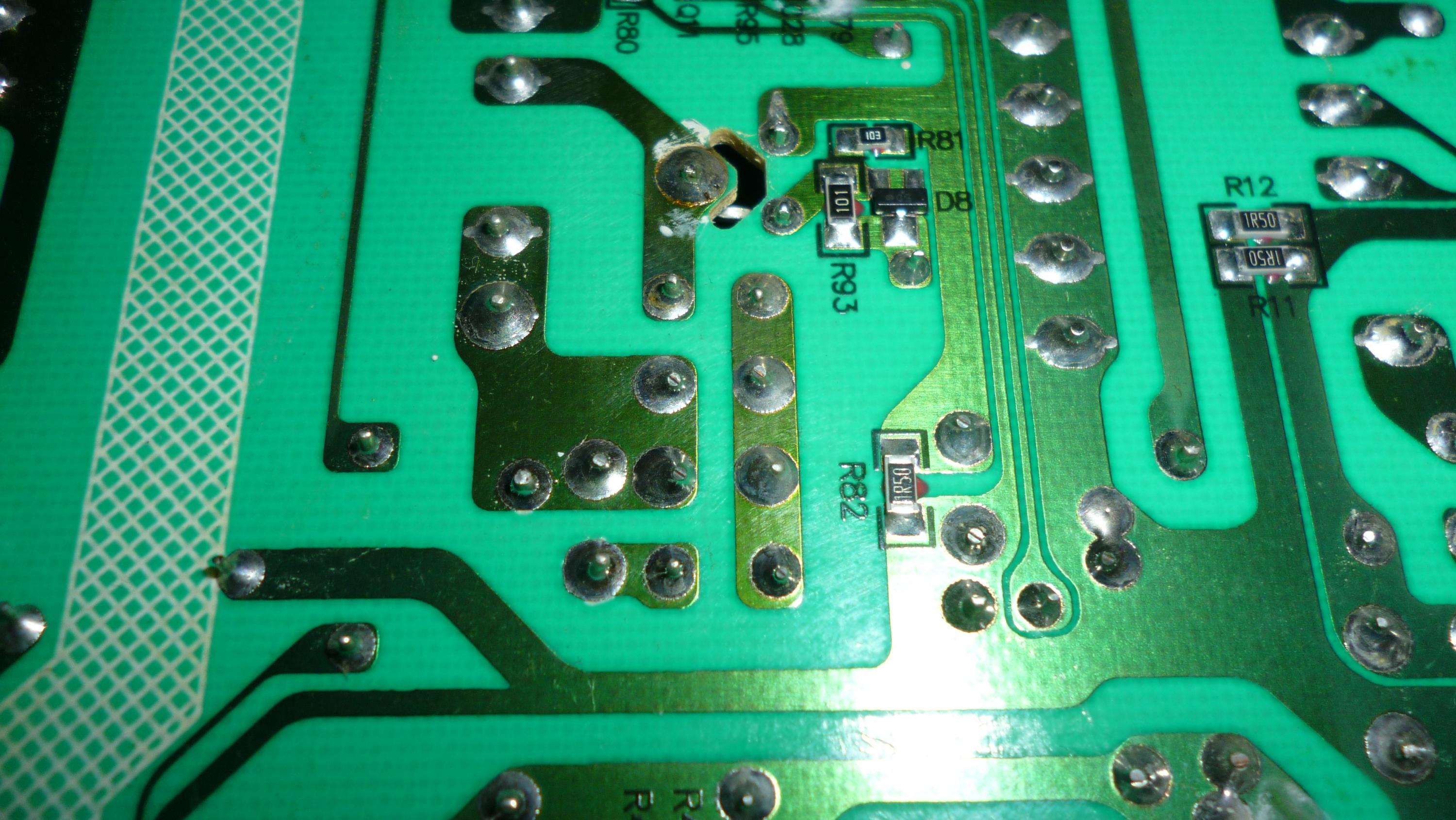

                  Can I get a closer shot of this area, preferably in several pictures?
                    #49
                    hope these are clear enough
                      #50
                      Test these devices. To test:
                      - Meter on diode test
                      - Middle pin red, black probe on one outer pin, note reading
                      - Middle pin red, black probe on other outer pin, note reading
                      - Middle pin black, red probe on one outer pin, note reading
                      - Middle pin black, red probe on other outer pin, note reading
                      Power must be OFF.
                        #51
                        as followed in that order
                        1
                        1
                        277
                        163
                          #52
                          Did you do both?
                            #53
                            yeah sorry should have been
                            1
                            1
                            277
                            277
                            1
                            1
                            162
                            163
                              #54
                              Both diodes appear OK.
