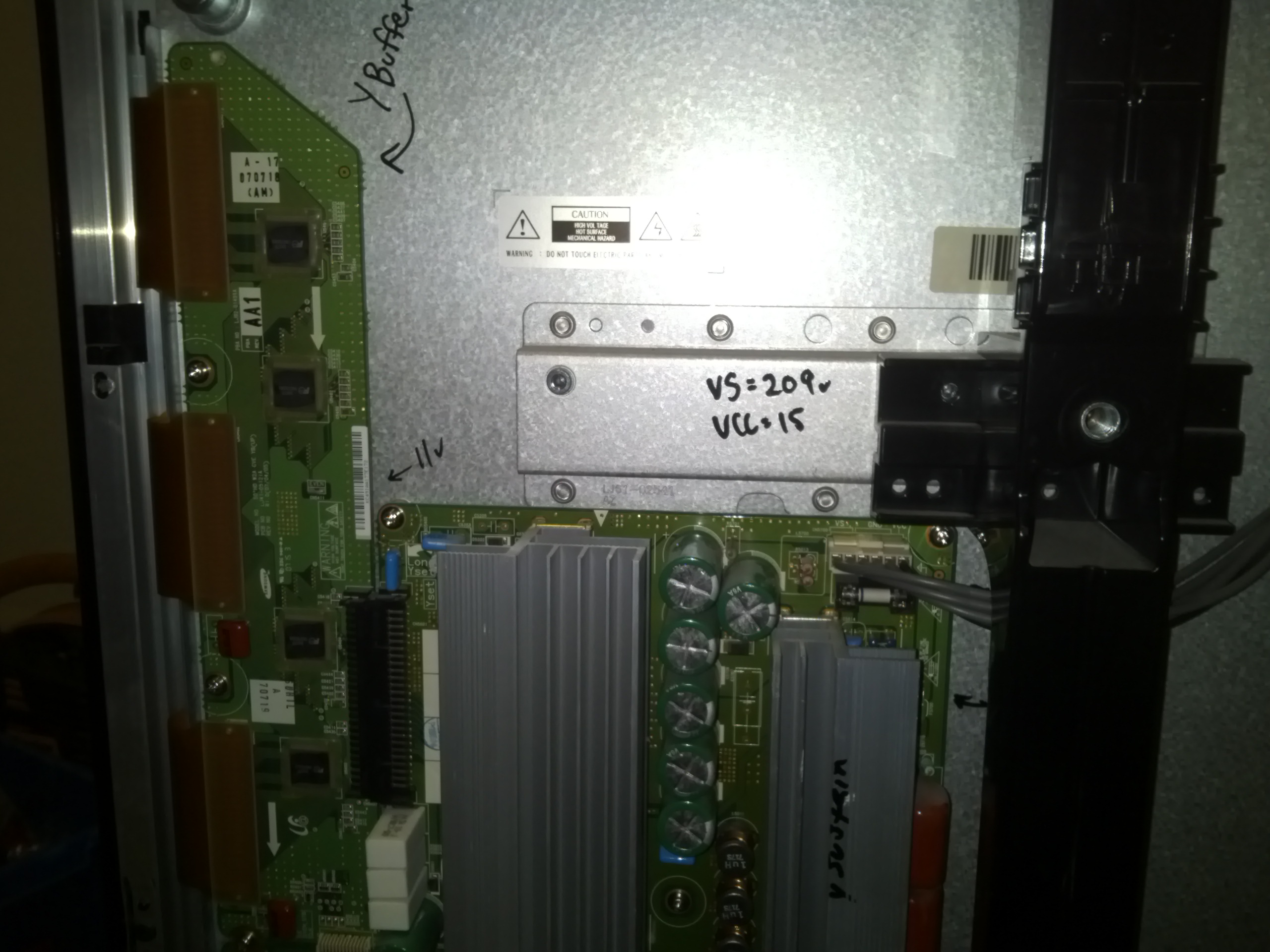

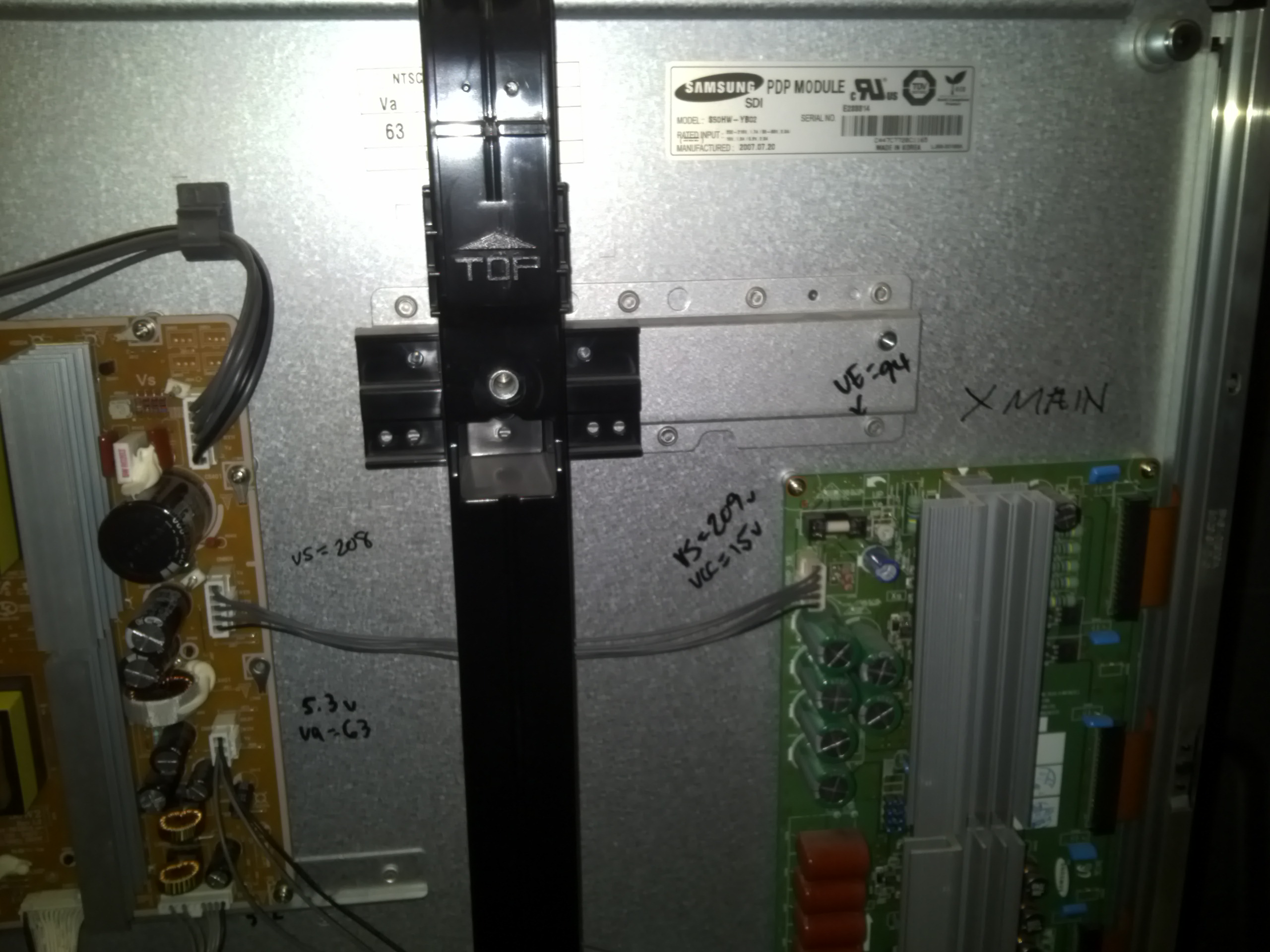

                          Re: samsung hpt5054 plasma no pic with sound
                          Here are some pics i took of the back side with the voltaged Im getting on several spots of each board. I have the correct voltages that are listed on the label but can seem to figure out why I still have no pic. Is there a spot I can check voltage on the y buffers? in the first pic there is a black connector that connects the y main to the top y buffer. Can I check for power off of one of those pins?
                            Have you gone over the ymain at all and checked for any shorted FETs, possibly Q5500
                            Q5501 ,Q5302,Q5303,Q5304,Q5306 ?
                                Well it's kind of all tied in together. Obviously the PSU generates the various voltages but the xmain,ymain and buffers drive the panel. There also needs to be a panel on(PON) signal for the drive boards to initialise the panel. Pretty sure the logic board is involved for panel on as well.
                                If someone has suggested the main AV board as bad, i see a number of people have jumpered pins 3-4 on the small logic ctrl board with the LVDS cable disconnected from the MAIN AV board and the logic control board and it should turn the panel on autogen some test patterns.
                                    Tested the top y buffer according to the buffer test video and found shorts on the first two chips on the y buffer (top). Lower tested fine
                                    • Glitcher
                                      • Mar 2013
                                      • 673
                                      • USa
                                      Replace the top y buffer board, and test for shorted mosfets on the main y sustain board
