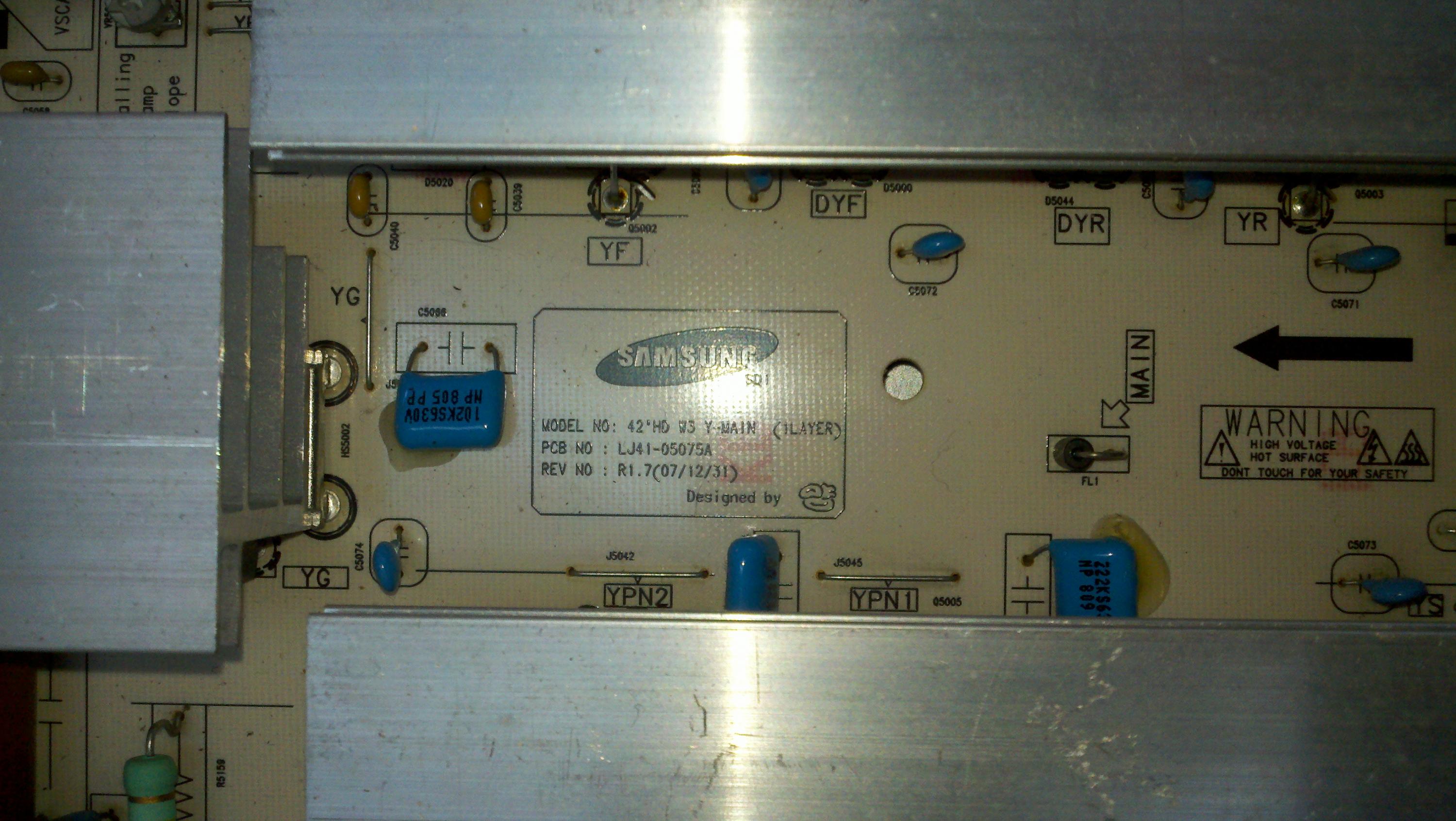

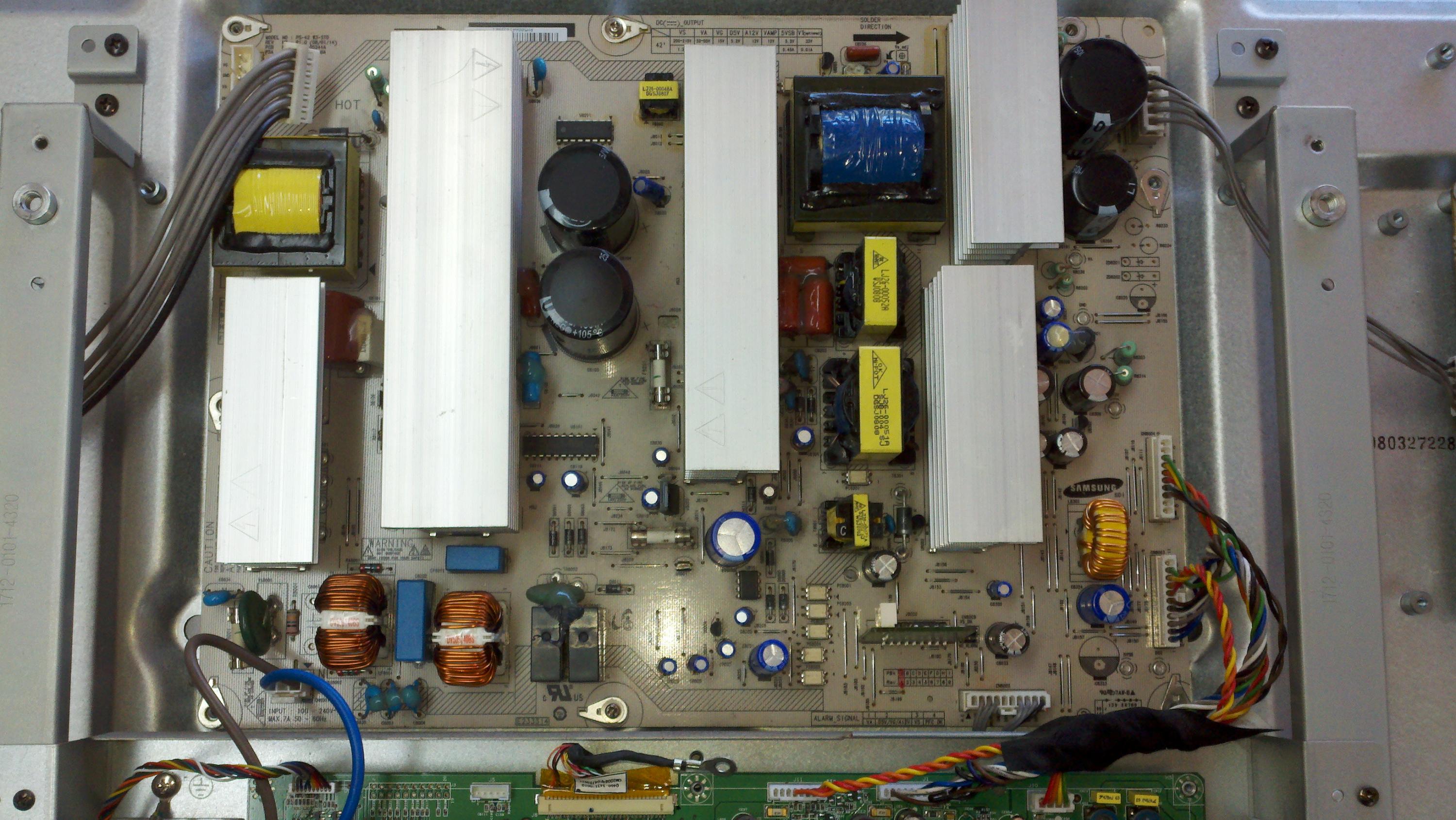

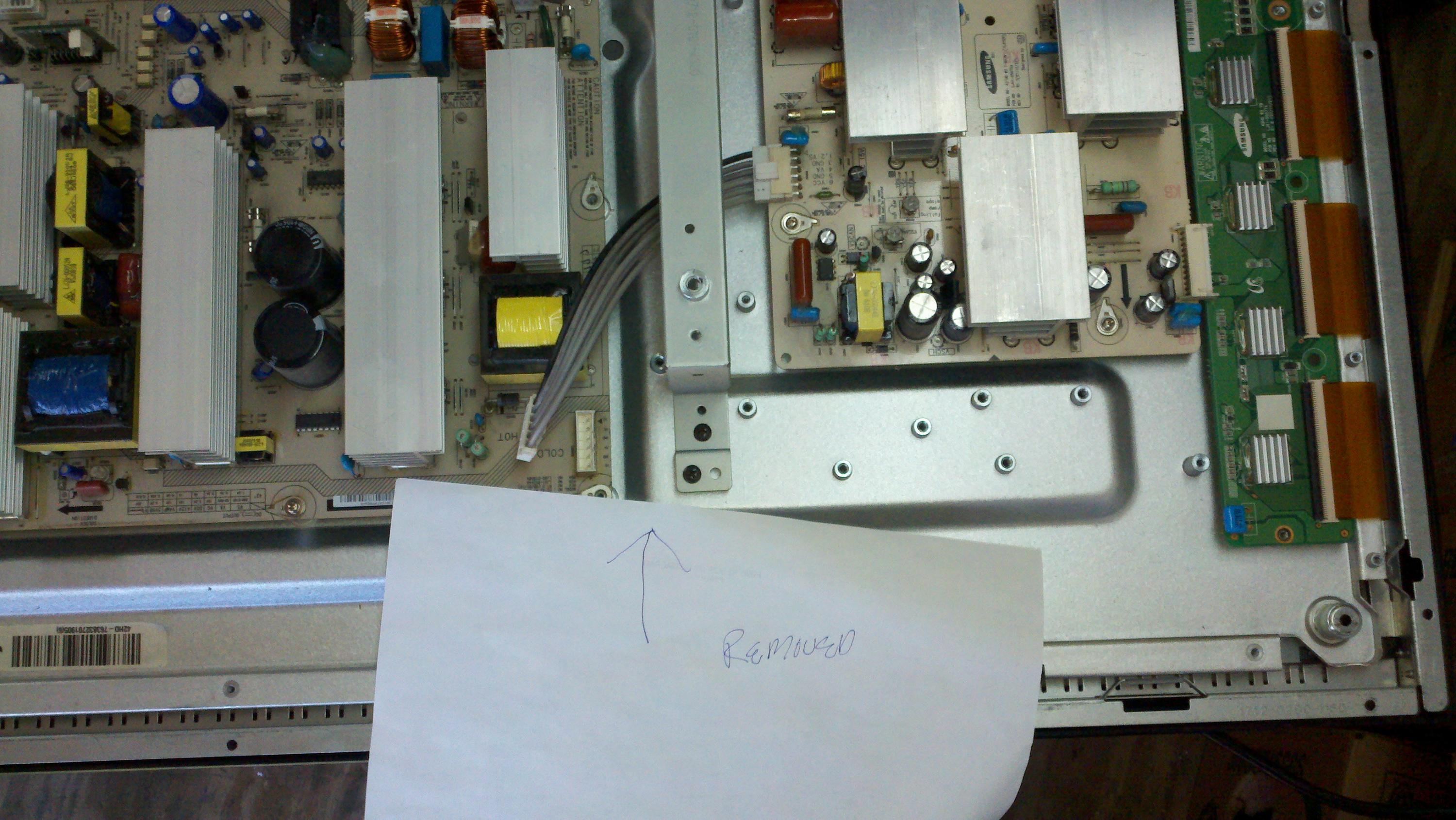

    hi guys,
    got the tv to come on for 20 mins..then turned itself off
    cant get it back on now
    has 3 blinks got its 5v stb ..relays click then the 2-3 second click shuts down the tv...for fault blinks 3 times

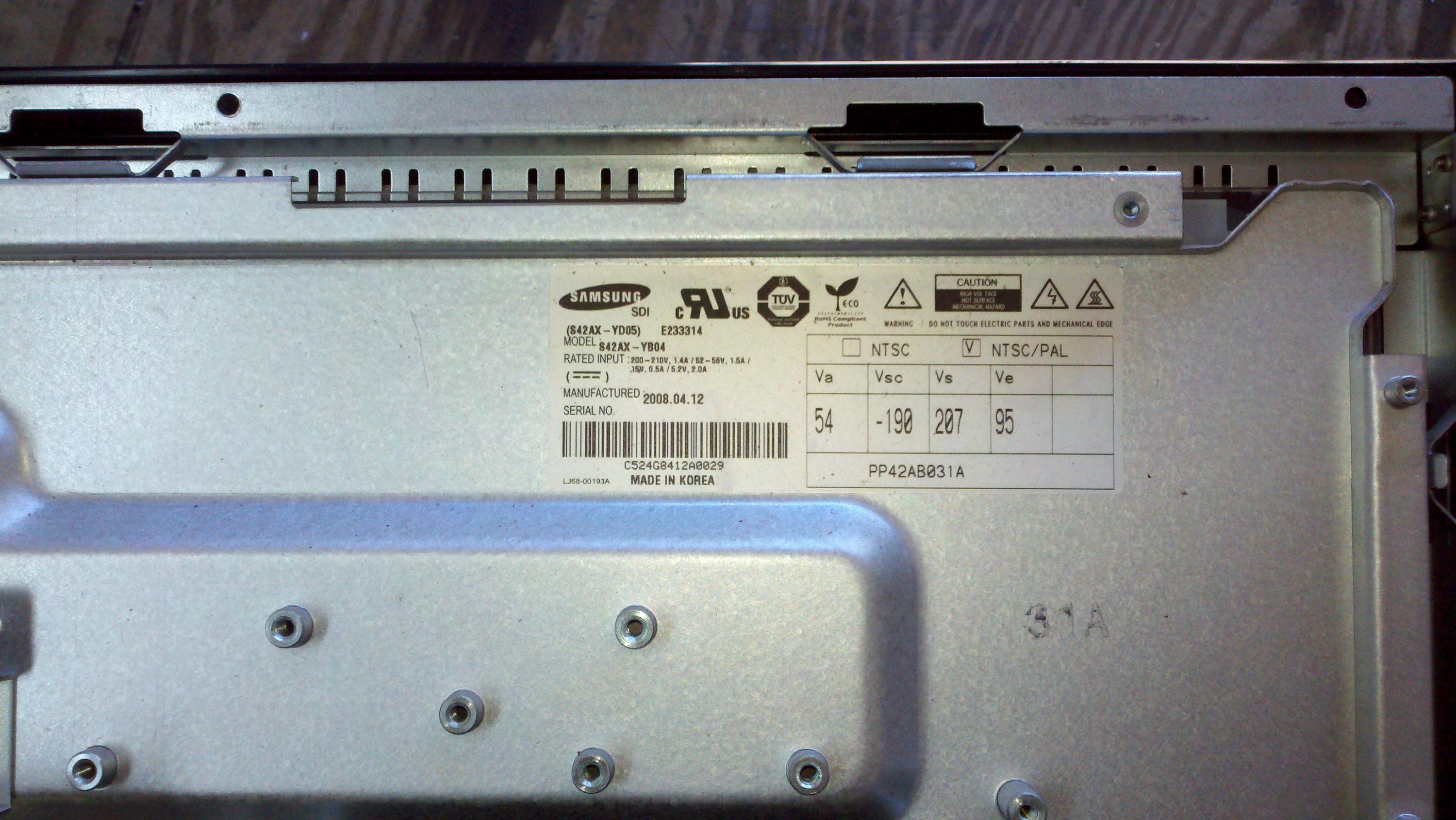

    ok no va-vsc-vs-ve volts
    disconect power to x main no change

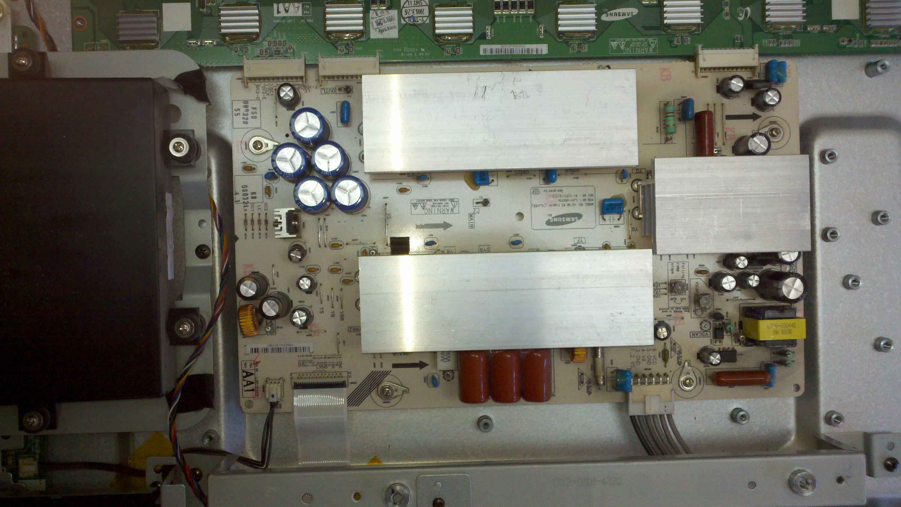

    diconect power to y sus main then get no codes and the VA=54V VSC=200
    VS=207 VE=95
    plugged everything back in...disconected the buffer board still got 3 blinks.
    guess the y sus board is bad? or am i missing something...
    cant find the blink codes for this tv?
    thanks for any help see pics

          3 indicates VS fail.

              vs fail ...yep it ok till you plug in the y sus board...unplugged its 207v plugged in 0v and 3 blinks
